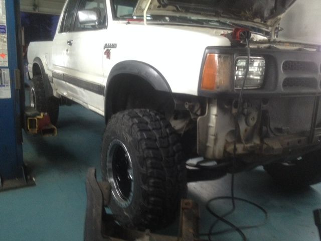

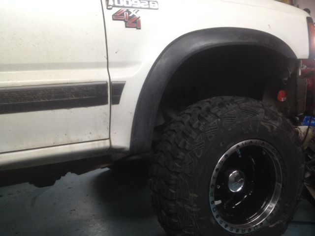

Ok, today I got my wheels and tires.
31x10.5R15 Kumho KL71 and 15x10, 3.75" B.S. Ultra Rogue in black.
While they stick out more than I thought,, it's not really crazy. No rubbing at all - I have my front torsions all the way up and am putting 2" blocks in rear to level it.
At this rate, I may not even do a body lift or if I do maybe 2" instead of 3"

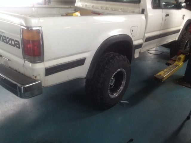

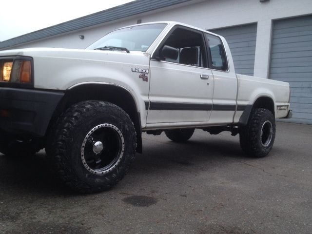

Here it is, I put two flares on so when I get the flares done, I will take more pics.
This is the 2" blocks in rear and torsions cranked so it's just about to touch the upper stops.
