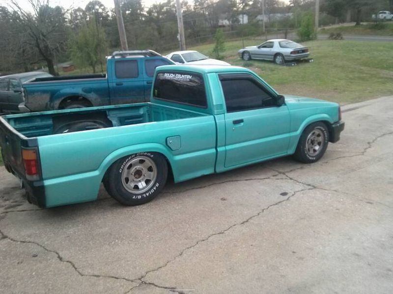

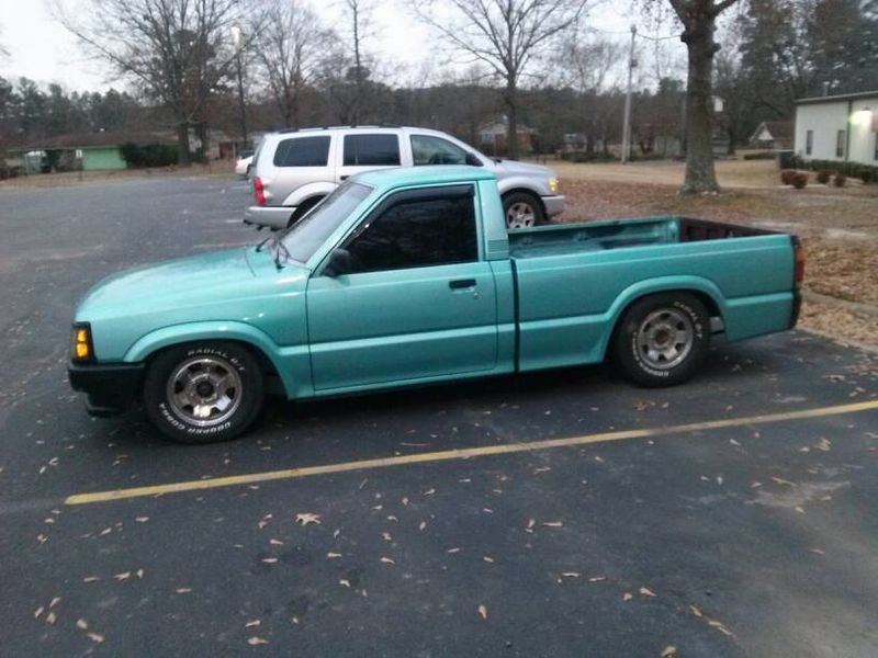

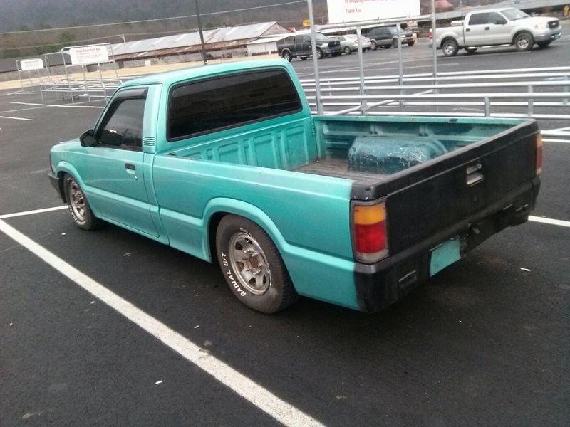

Ok so I bought this truck for 500. Put a headgasket on it and have put radio, exhaust, lowered it and changed wheels. All this has been done in the past 4 weeks I have had it.
Mods:
Weber,
Paceseter,
Raptor Exhaust,
B2600i rims,
cleaned up drivers side fender well,
electric fan,
Soon to come:
Air bags (front setup already ordered),
Step notch,
body drop
z71 rims (as soon as I get tires I already have the rims),
roll pan,
ranger headlights,
blacked out tail lights,
raise bed floor up.
I work on this every weekend so I will have weekly updates to the truck as money persists.

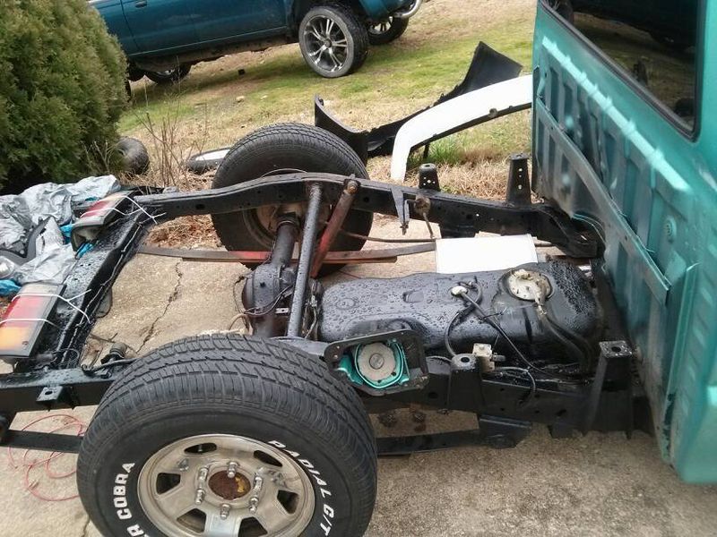

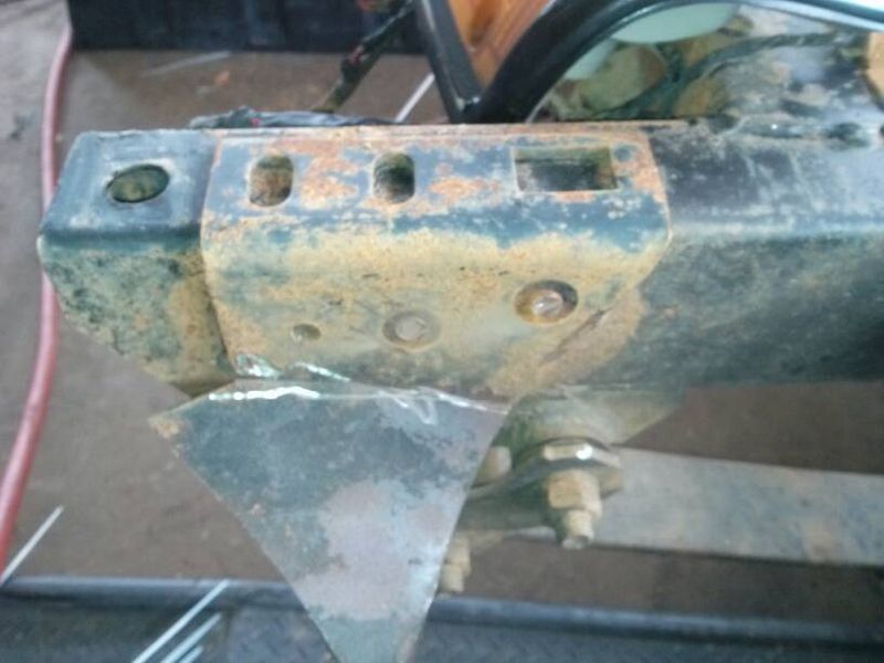

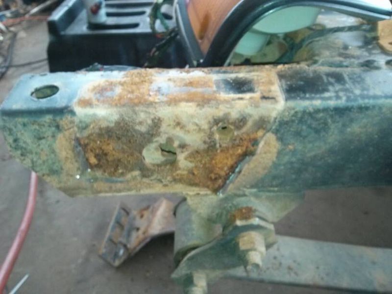

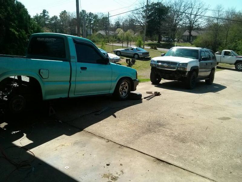

after the ball joint flip, shock tower trimming, about to start cutting bump stops next as it is required before air bag install. Air bags will be here today but valves are still a few days out so come the weekend I'll be ready.

Cool truck, Are you bagging the whole thing or just half for now?
mymmeryloss's avatar
mymmeryloss
Trimming bump stops for bag job? Dont u mean removing bump stops and mount?
kylesj6033

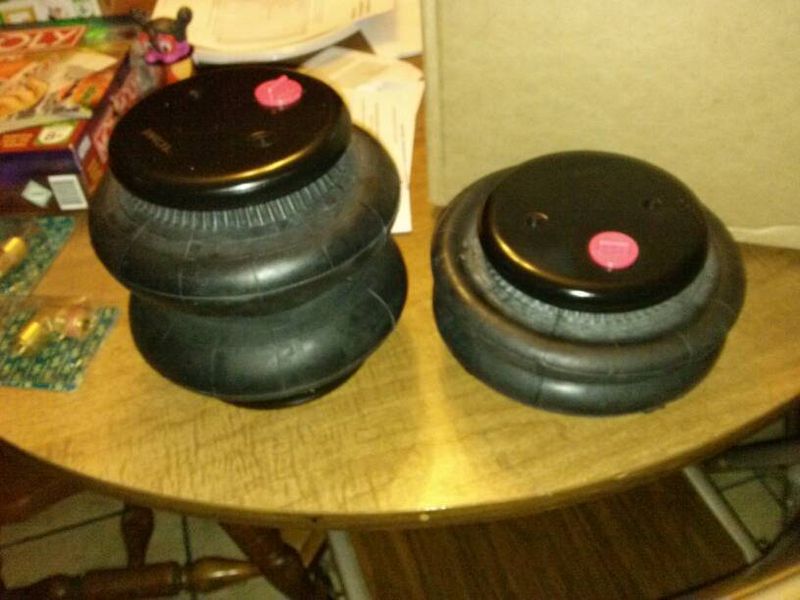

yeah man. I said it in post two. I was just saying I'm sitting on trimmed bump stops for the time being. I have to get the bag plates made and get the lower arm shock bracket removed next. then remove all the upper shock mount and possibly notch the frame if needed since someone had to go buy 2600lb bags. Im putting the bag over the edge of lower ball joint what lift should I have at the wheel? I'm setting it up to run 16s on low pros. I got z71 rims already. I have 2600 bags with 6.2 inches of lift. 2.8 compressed and 9inches fully aired up. Anybody with the same setup have an idea of how much lift I'll get at the wheel? I have the front pretty well ironed out but the rear is another story. I have never installed a 4 link but I'm going to on this. I'm going with bag on bar setup so the lift is fairly high but I'll slide it forwards so I can get close to same lift at same psi. I'll get it tho.
Sent from my VS950 4G using Tapatalk
mymmeryloss
You will have no problems clearing z71's with that setup up front
kylesj6033
ok thanks. that's about as big as I really care to go honestly. I got big rims on my other truck but I don't want to hack this up to bad.

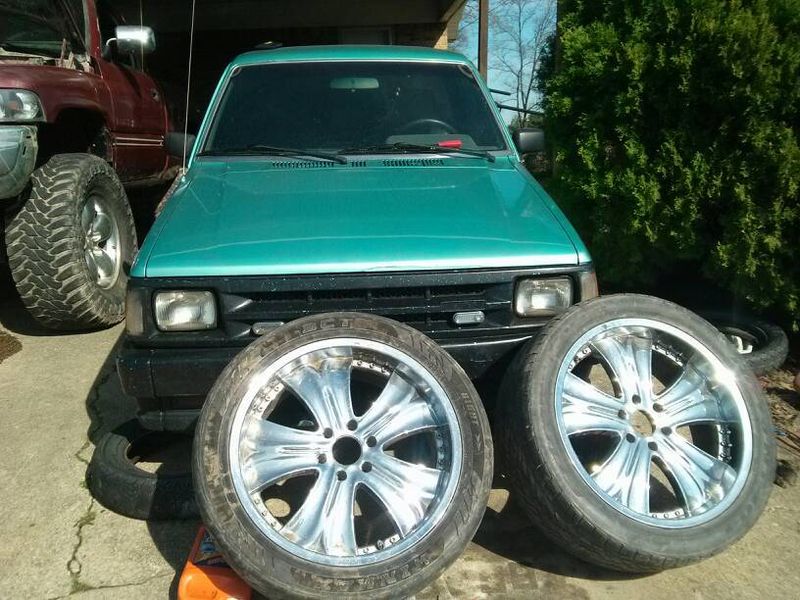

kylesj6033
look what came in the mail today....
