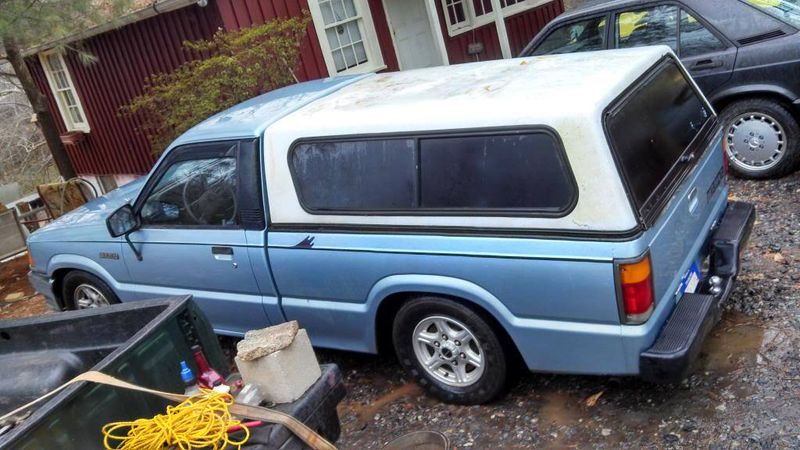

This is my recently acquired B2200. I traded it for an audi that I couldn't figure out what the no start condition was.
pictures as promised:

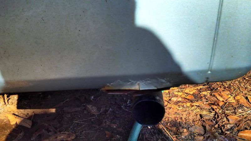

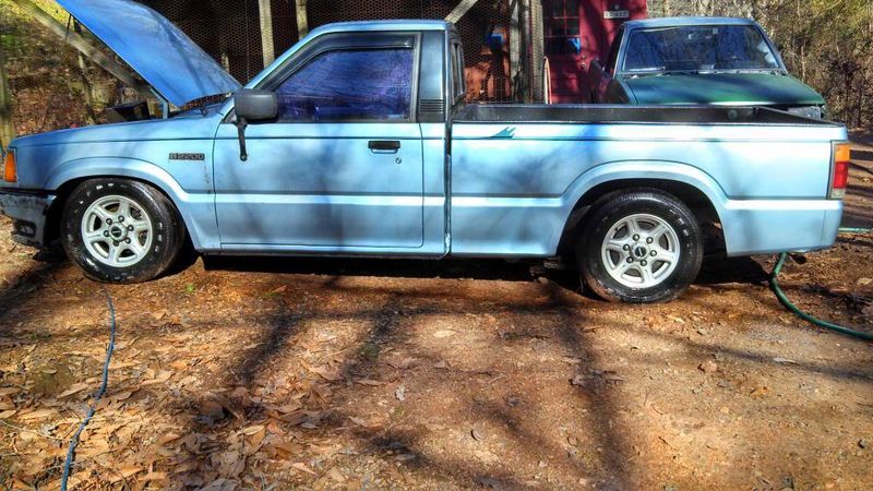

A bit of rust on the truck bed, near the exhaust

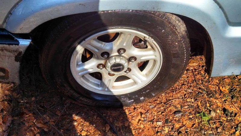

Factory aluminum wheels

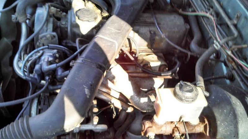

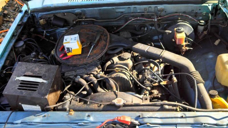

engine bay, very stock with a few things I need to iron out

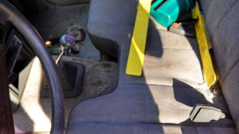

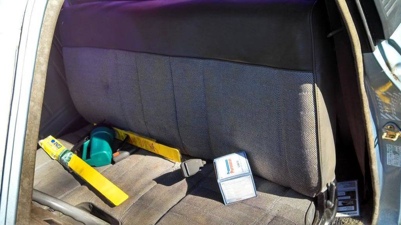

Bench seat, this will stick around, at least for a little while. Still might swap in some benz bucket seats

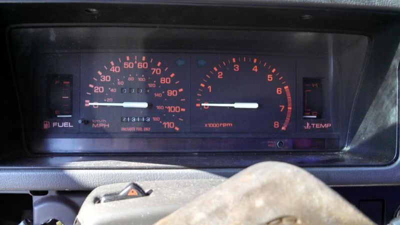

Tach cluster, missing a couple pieces but it is largely intact

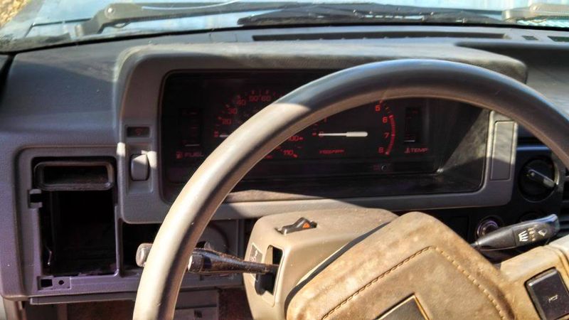

missing the plastic trim piece, someone before me installed a push button ignition due to a stuck key. I gotta undo this whole mess
Needs torsion bars (previous owner removed) and overload spring, and of course a fuel system overhaul. Plans are to keep it simple, maybe install my camper shell on it and to use it as a daily until I finish with Redemption.

For me, the Weber 38 made this truck run SOOO much smoother. I put it on, got rid of ALL the old vacuum lines (brittle, cracked, split, etc) and all the emissions stuff went BYE BYE.
For the time being, I am going to be using the adapter so I can use the stock air cleaner. The sole purpose for this is because I am too lazy to touch the exhaust until I get my 'new' header from R90Baron. I did not install the Holley fuel pressure regulator as of yet, I don't know if I am going to.

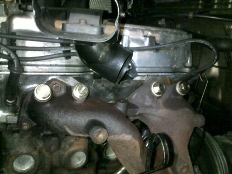

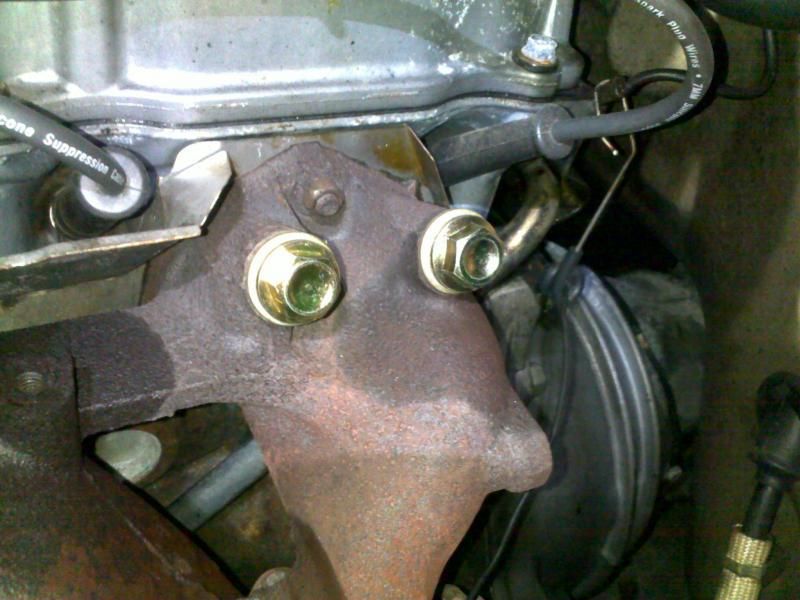

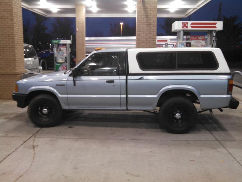

Well it rides like shit with crap tires and no torsion bars installed, but man what a difference a weber 38 makes on the otherwise stock 2.2. I went ahead and started my pair delete, will finish when I change the oil. Currently have lug nuts in 2 of the hoses, pinched and welded the pipe on the exhaust manifold closed.
zanzer's avatar
zanzer
Go to AutoZone (or any McParts store) and pick up 4 Honda oil pan plugs in the M14-1.50 variety and get the shortest ones they have. I used Needa Part PN 652946. These screw right into the thermactor holes and makes for a clean tube delete.
