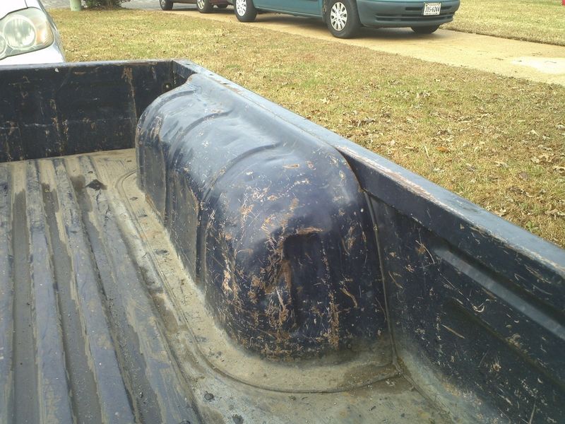

I got to work on the bed some more today, got it down to a total of 6.5" on the body drop. I finished in the dark so Pics suck, I will take more in the daylight when I start to weld it in place.
crazykzar1
Getting it tacked down, after flipping it over there is quite a bit more cutting to do but here is a shot of where the final resting place of the bed floor is

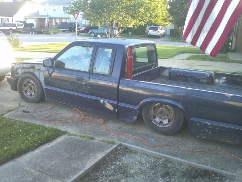

So you are going to section the body?
crazykzar1
probably not going to do the body, might tub the front, have to see how well the wheels tuck, I've had a lot of buddies run into too much body damage on a full BD. as long as I can lay frame I will be happy.

Well that was confusing. U said a 6.5" bodydrop and now u are saying no bodydrop just laying frame?
crazykzar1

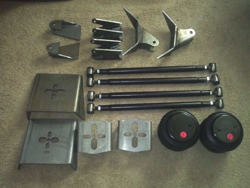

the bed is dropped to make room for the frame, new mounts will be made to get it all to line up again, and make space for airtank, relocated fuel tank and what ever else i plan on stickin under there. I may do the cab next year if its just not looking low enough. I was checking to see where the body sits on these Mazda frames and it looks like about 2" stock.
either way I plan on pulling the engine for a rebuild last, if it needs it, thats when I will knock out the cab.

I think u mean u raised the bedfloor. Im assuming the bodylines will still match up therefore u didnt drop the bed.
Just trying to put it all together in my head
