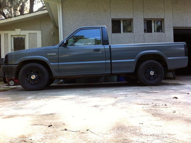

I am wanting to do a static drop on my 2200 with 3" blocks. I've heard the horror stories of people destroying their U-joints and what not. Could i lower the front and back 3" and the pinion angle remain the same? Is the pinion angle really not an issue? If it is what degree angle shims are recommended? My truck is currently 3" front and 6" back, tire to fender. Wanting to do 3" and 3" or (0,1,2)" and 3".
