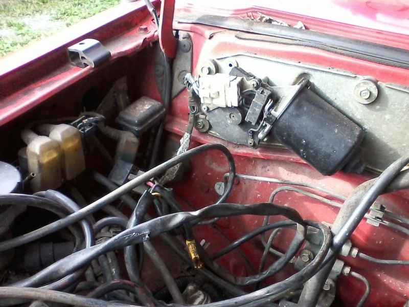

just so i know what is this little black housing on topside of the firewall. ( older pic before cleanup but still just wondering what it was)

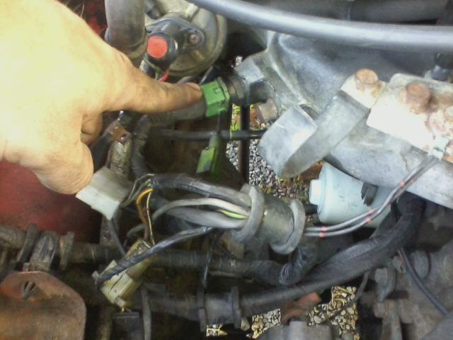

Can this sensor be removed? I have a mes of wiring hanging down in that area and this is tied in with it, does it need be there? An if so how is it removed, i couldn't find any pull back clips or anything on it.
and if so i'm assuming this can go with it as well seeing as it's just a ground in that nest of wires ha

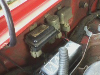

and final question, these three little boxes behind the fuse box, what are they and can they be removed?

First pic is the windshield wiper motor.
Second is the coolant temp sensor for the ecu, if you have the original carb you need it, if you have a Weber you don't. It wont effect the temp gauge working.
Third, I would keep the ground wire. Grounds are far more important than most people think.
Fourth, leave the relays. The one on the far right is for the horn, I don't know what the other two are for but leave them there.
