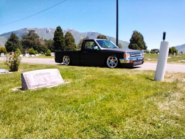

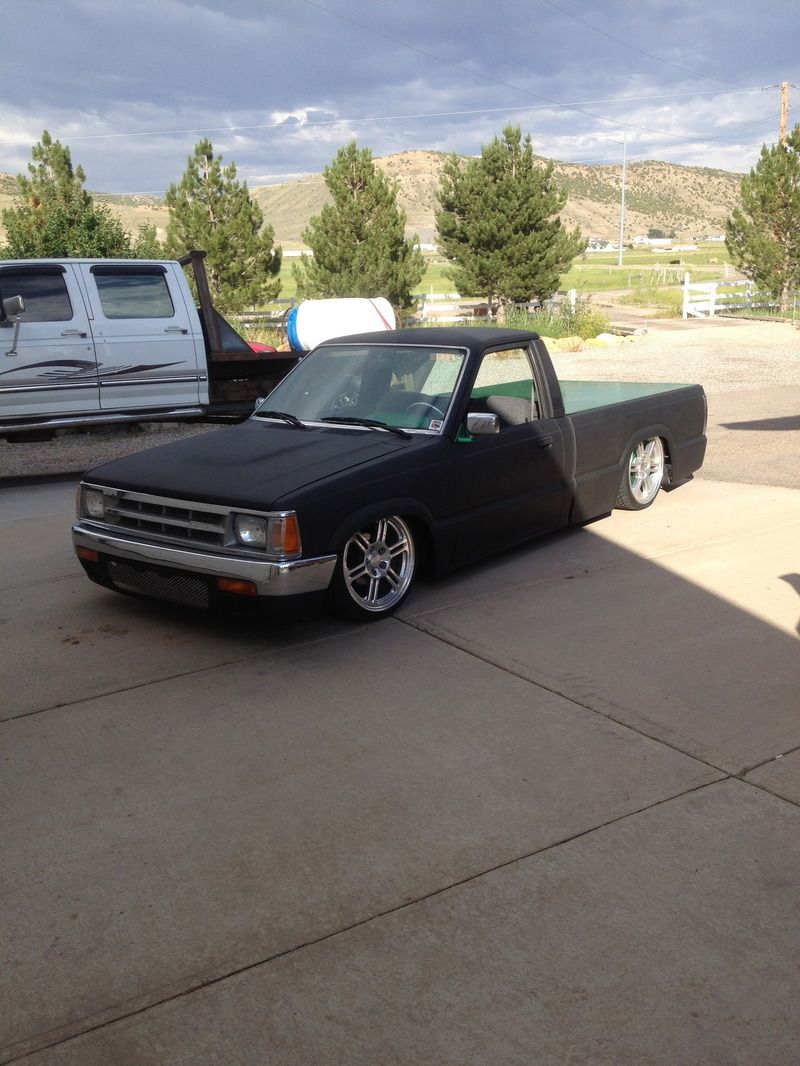

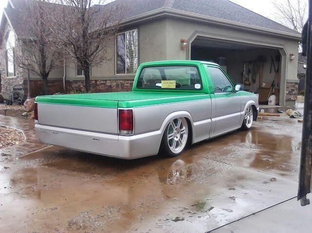

Fixed a few of them for you, Cool truck. It looks good but it used to look great, It's too bad the body isn't as nice as it was back in the day...
