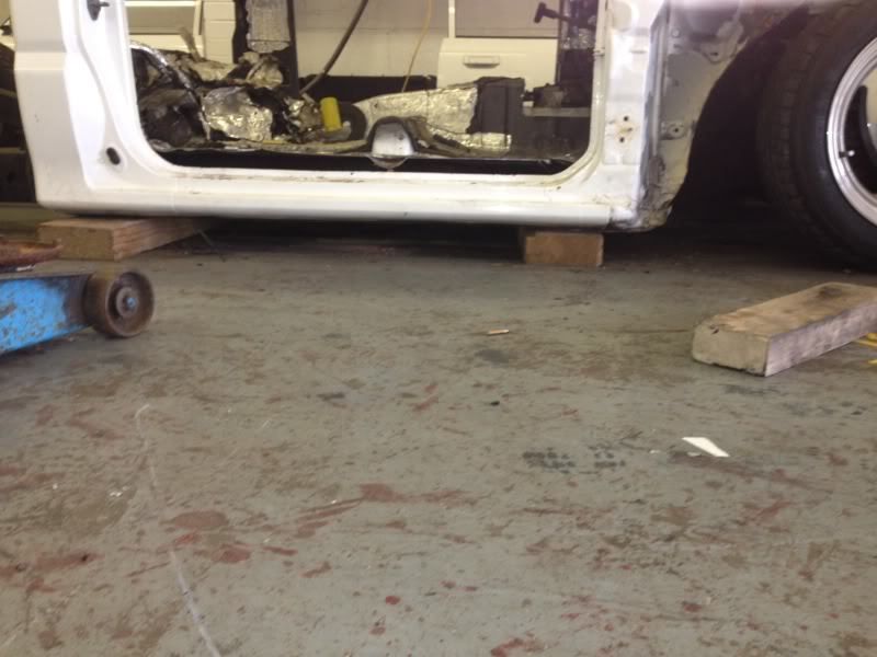

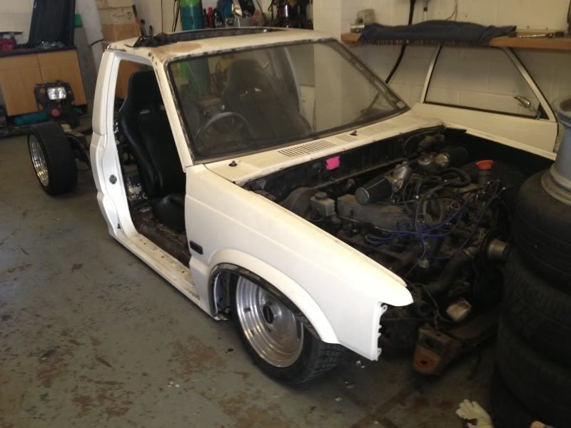

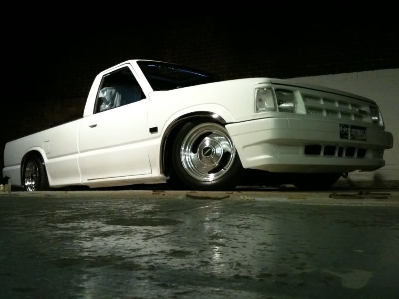

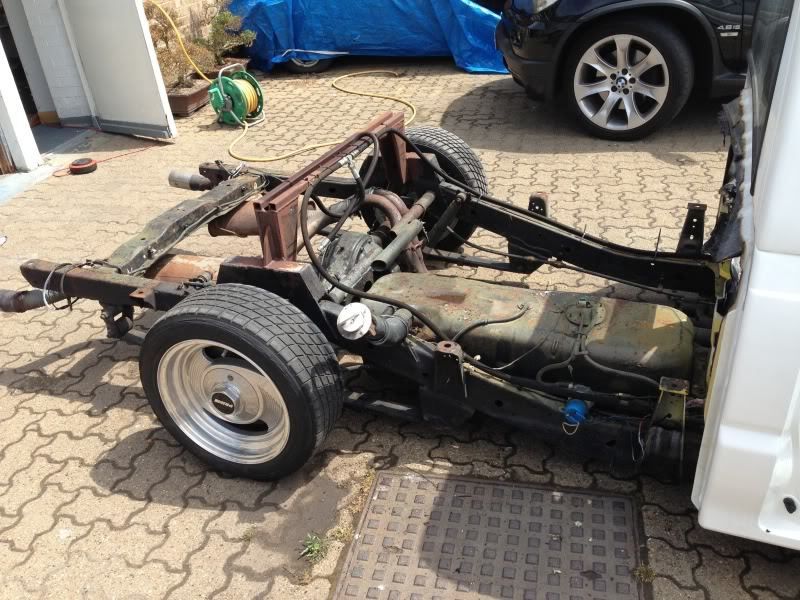

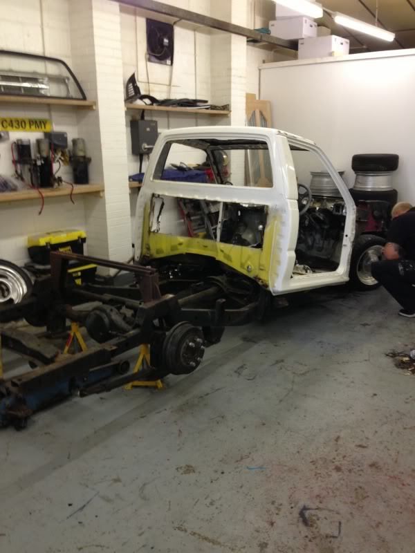

Here's how it was a while ago on full drop

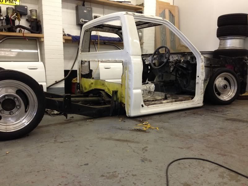

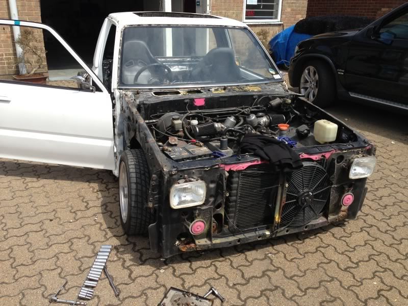

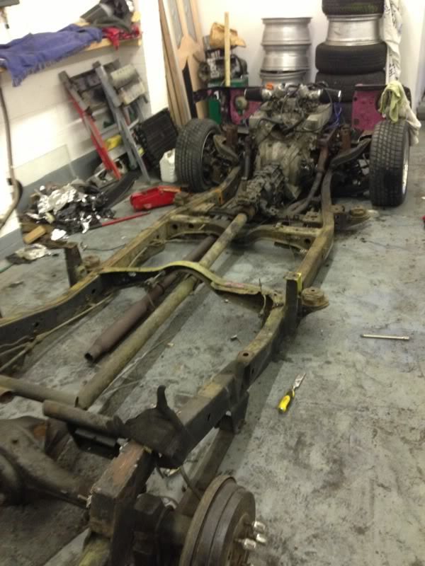

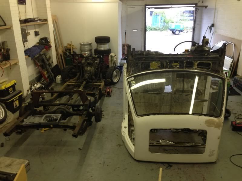

Here's how it looks in my workshop today

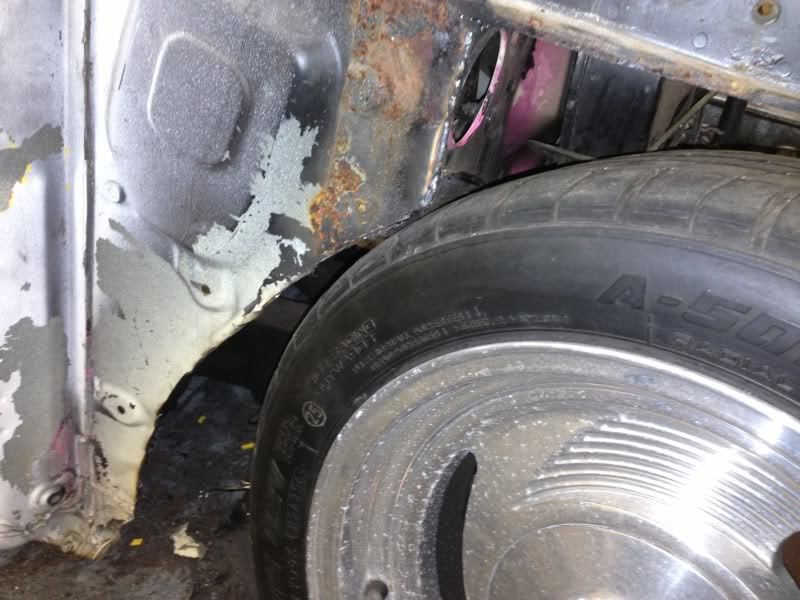

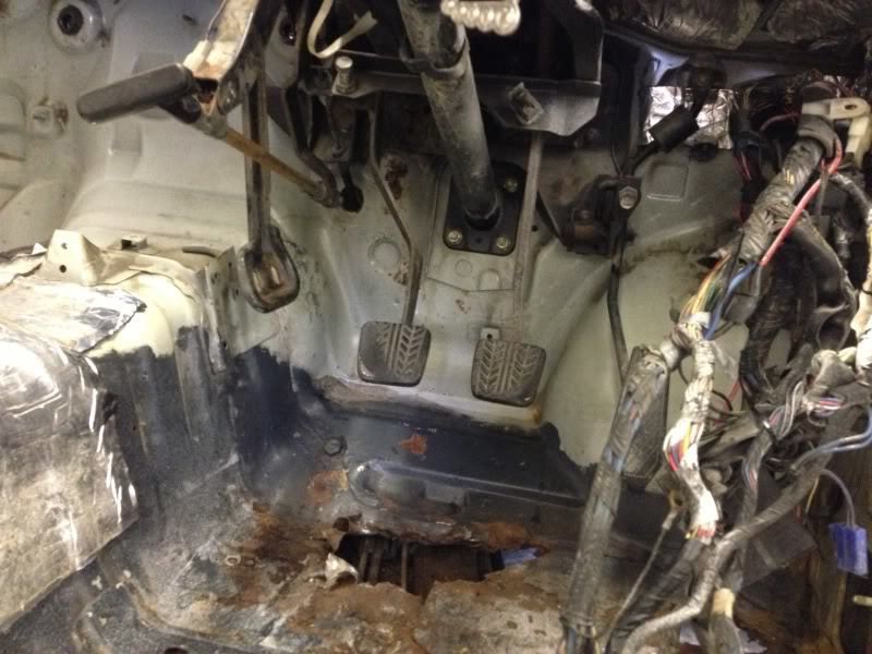

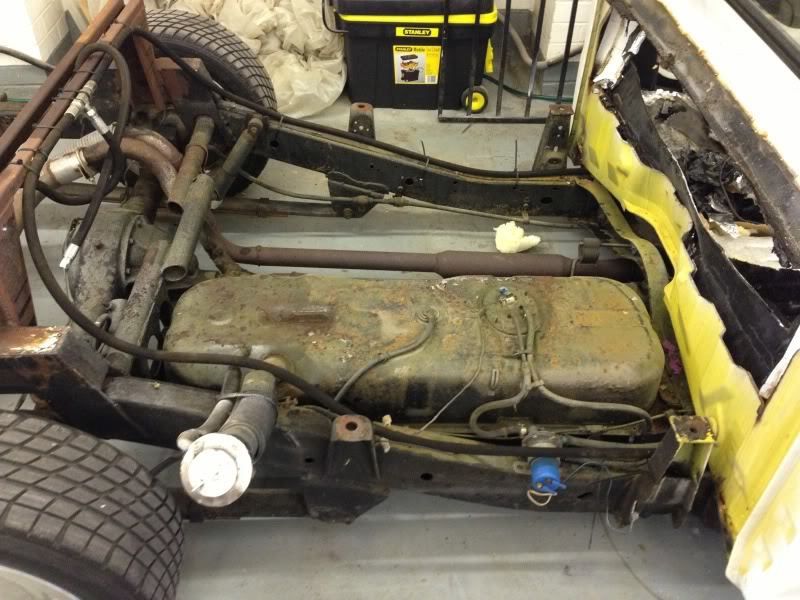

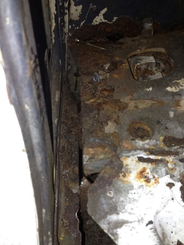

As you can see there's a slight rust issue, some shocking previous frame work and nasty wiring to go with it.
The aim is to get this done before aug 2014 so I can be taken to my own wedding in it...... Oops!

I had the same rust issue on our project truck.. and posted a lot of our progress with pictures in my build thread on here that may be able to help you out. We cut the cab when we body dropped it to keep the heater box but we have the stock mazda engine and the firewall was stock when we started.

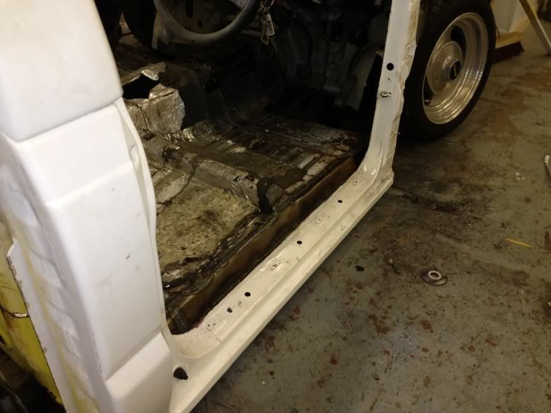

Managed a few hours on the old girl today.

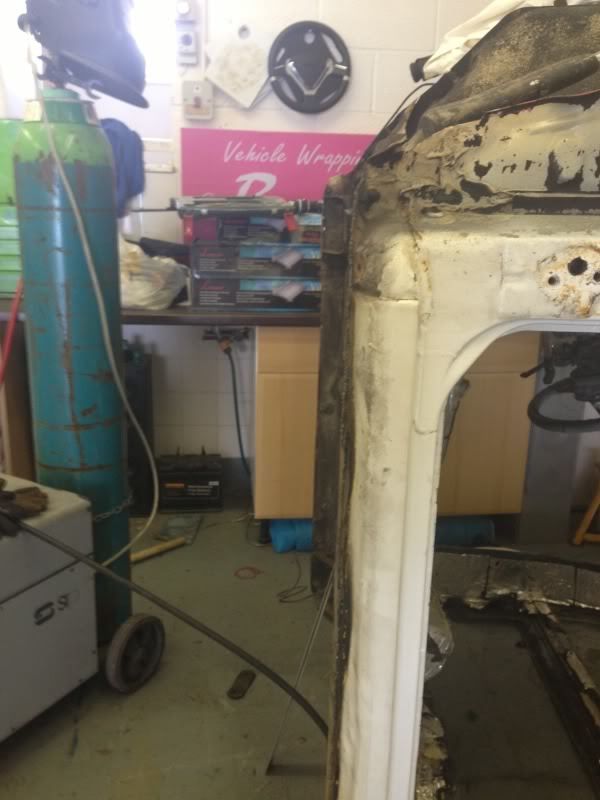

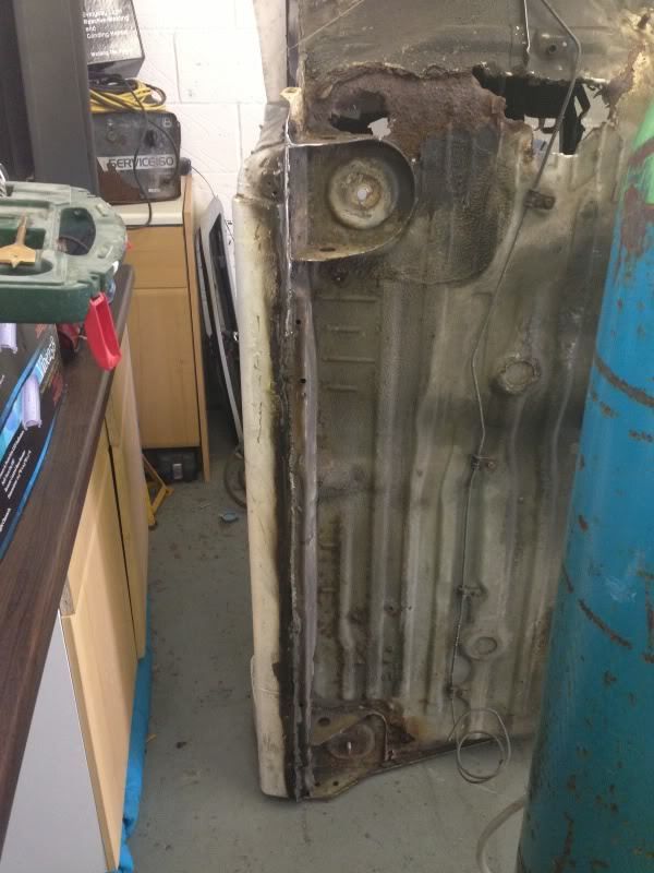

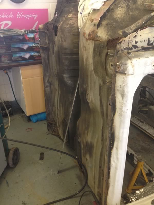

I wanted to see how much tin worm the cab was suffering from before doing the body drop and wanted to cut and weld the pinch off to allow the max drop.
Once the cab was off we set about cutting the old ram mounts off with a petrol disc cutter.
My new bottle of argoshield should be with me tomorrow so I can cut the pinch off.

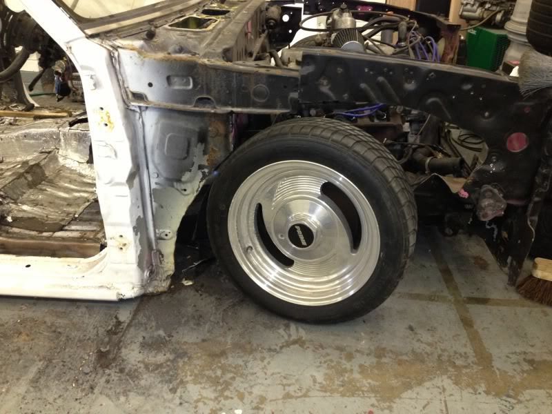

Moving right along. Now is a good time to strip that frame down and paint it

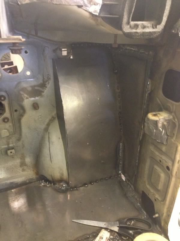

It helped a lot to have the cab on the back like that when we did our body drop to cap all of the holes that were left to the inside of the cab after cutting for the body drop, much easier than laying on your back trying to weld over head.
Also it might be easier to cut your firewall for the wheel tubs when it is off the truck... just a couple tips that may help. Oh and I like the term "tin worm" I may just have to use that one from now on
DC
daddy coole
Cheers lowlyfe, I started cutting the tubs out today whilst the cab's on its back I can definitely see how its gotta be easier to do it this way.

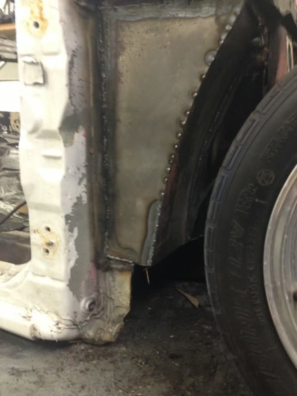

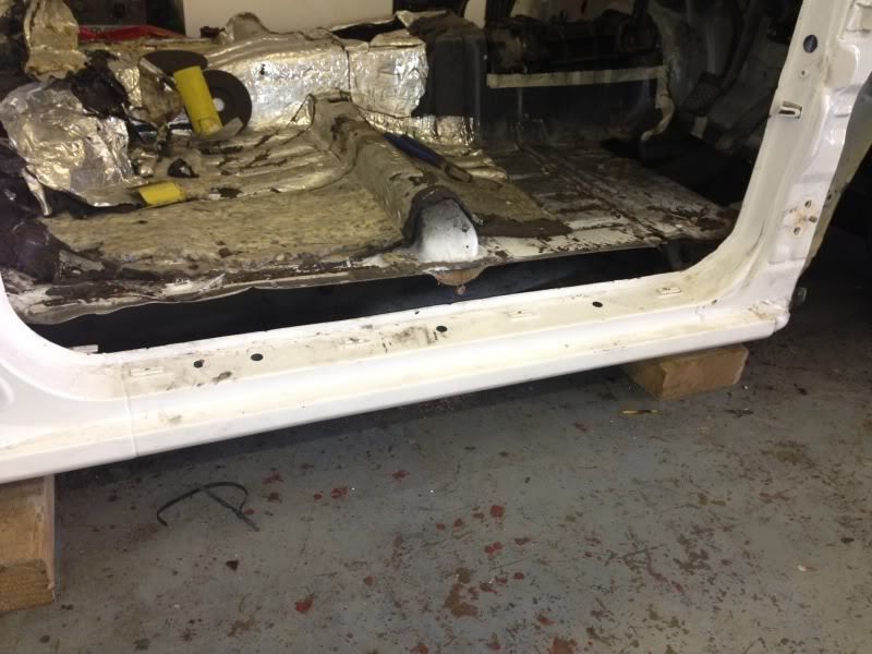

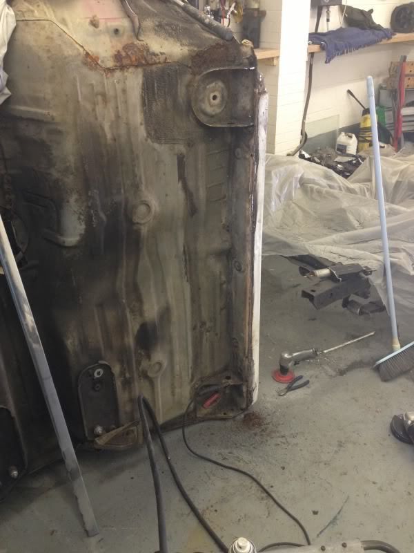

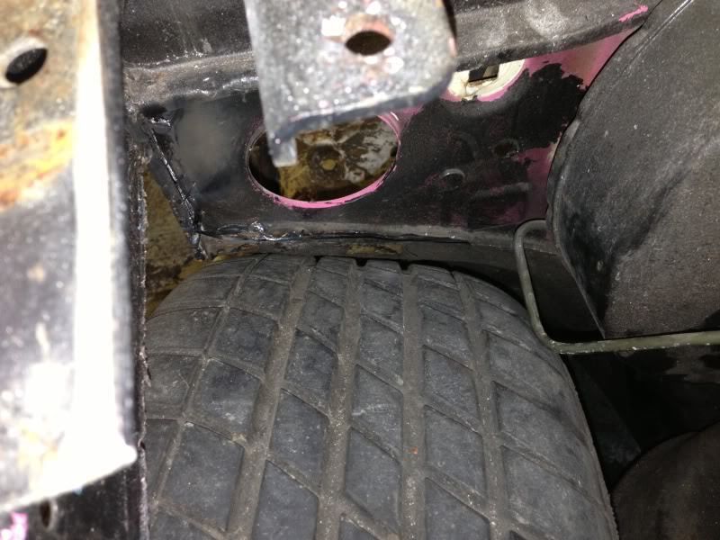

So... After finally managing to find the time to pop round the local welding suppliers and pick up a new bottle of gas ($300!!!) I managed to cut the pinch off today and seam it up. It seems as though I may have a few issues with the welder though (budget SIP mig) so it's going in to be sorted on Monday.
Even though I'm not at all happy with the look of the welds its still penetrated well and is solid enough to put the cab back on ready to do the cut for the bd next week, providing of course I can get the frame to lay flat first.
There's not much to show but here's what I managed today

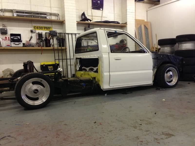

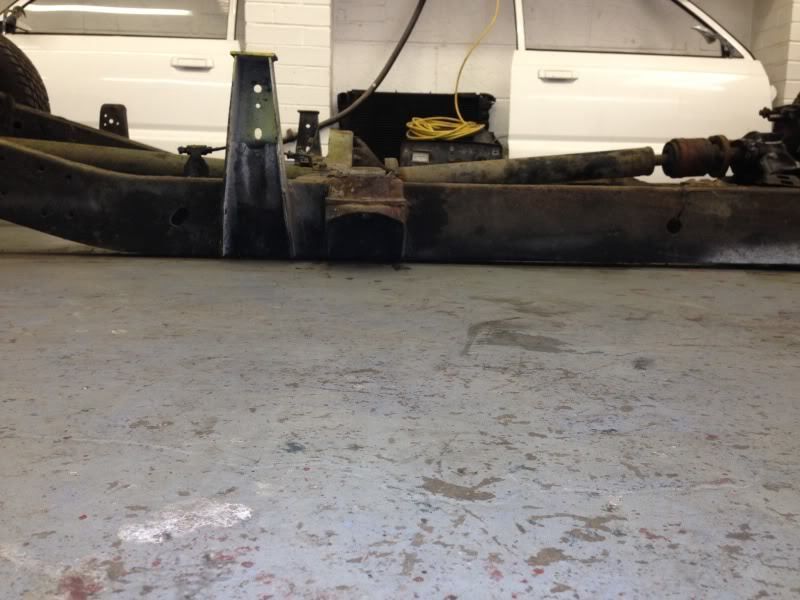

Small update

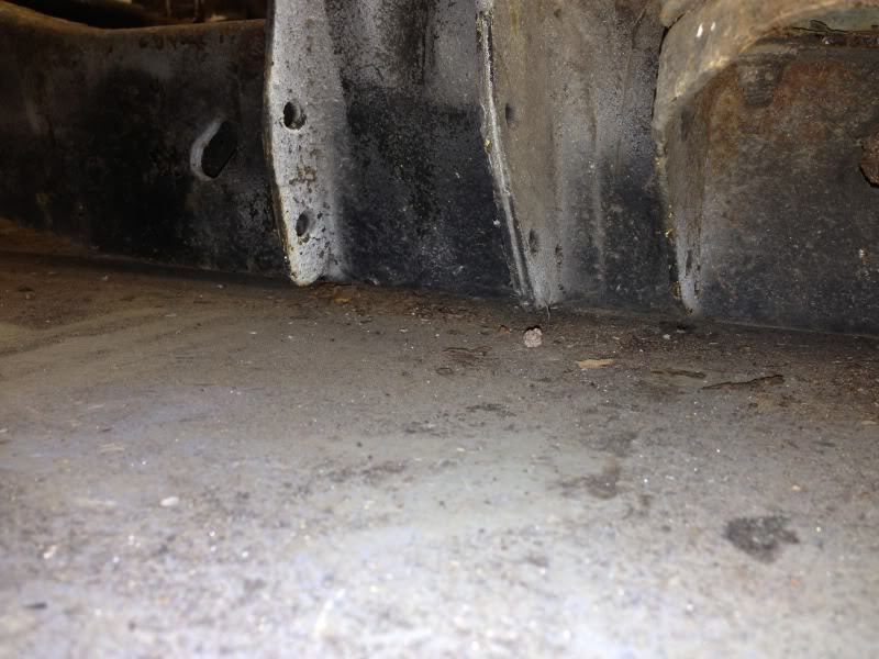

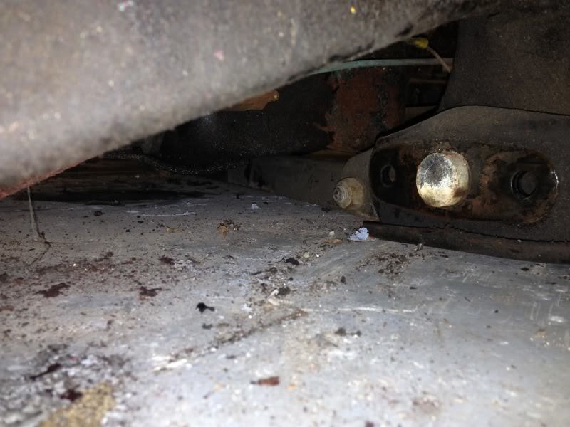

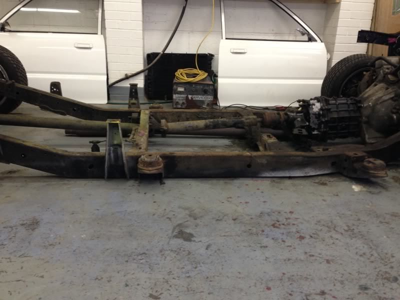

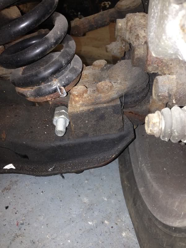

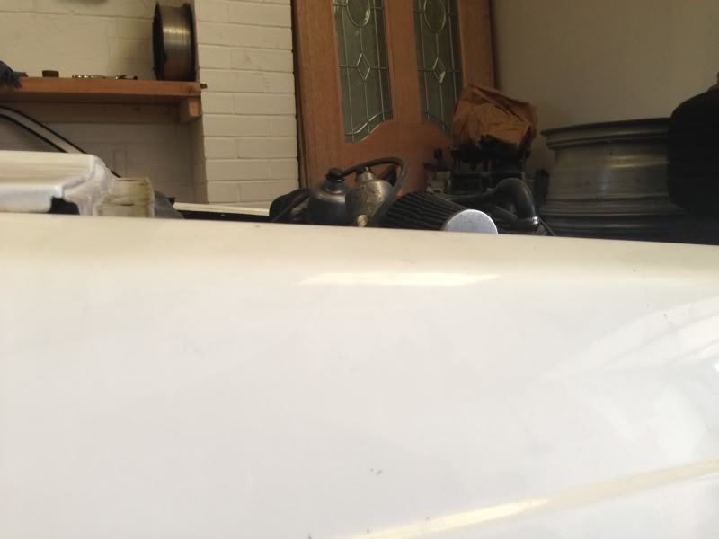

All the original rear suspension has been cut off and the front torsion bars removed so its sitting pretty much on the floor now. It's got the usual quarter of an Inch gap on the front of the frame due to the x member but I'm really not overly worried about it.
You can see how close the sump is to the x member in that shot which could be an issue as I have to drop the motor a good 1.5 - 2" lower to fit under the hood.
This last shot is of the lowering blocks fitted to the lower arms. I only remembered having them after reading the "how to flip your balljoint" thread and thinking "yeah il go and do that now" lol.
Cab will be back on tomorrow so I can start dropping it over the weekend.
I do have one question if one of you could answer for me please, with the front part of the frame not quite reaching the deck do you prop the front of the cab up so it matches the frame height on full drop or do you run a slight gap all the way along the cill so the frame hits just before the body hits the floor??

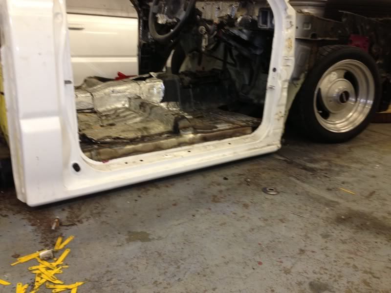

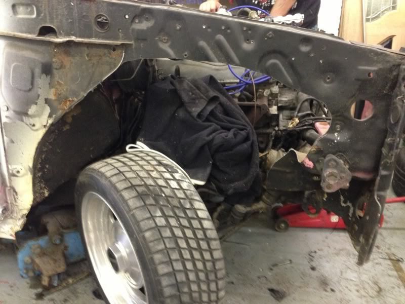

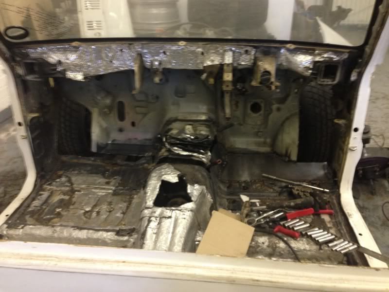

Well today was an eye opener.
I thought "just cut it up with the air saw and angle grinder, how hard can it be?"
Cutting through those body mounts was a complete c#*t! I must have snapped 30 blades and worn out 5 cutting discs!!
Still... its done now thank fuck
Snags so far are

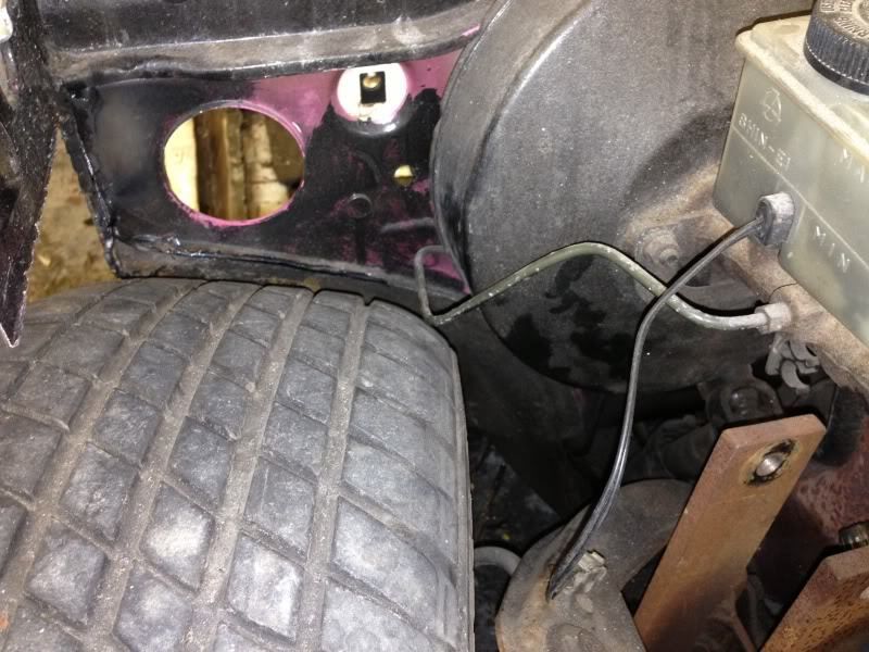

I didn't cut the floor close enough to the edge of the cill and I'm getting some fouling against the body mounts.
The gearbox is too tall to allow fitting of the original heater box

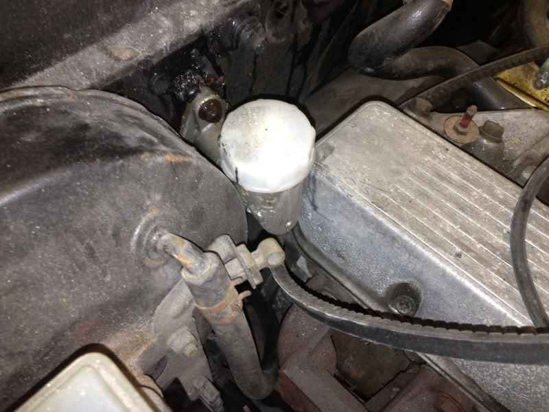

The clutch master cylinder wedged itself between the brake servo and engine rocker cover so it will need to be re mounted somehow
