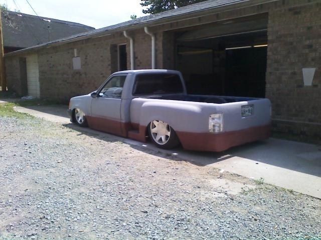

lapresa7
I found this one on craigslist I believe the bed is from a ranger idk if this is what you were looking for
spacemonkee23's avatar
spacemonkee23
This looks like a newer Mazda B-series bed not ranger although similar, this is not a step side which look like this
" target="_blank" target="_blank
edited*-- Googled this one
Here is the link to his Cardomain page
That truck is actually MazdaMan, he's on here.
For the newer Mazda B Series Bed let me know if you are interested, I have one I'm trying to sell complete with the tailgate and tail lights. It's all metal though, no fiberglass.
