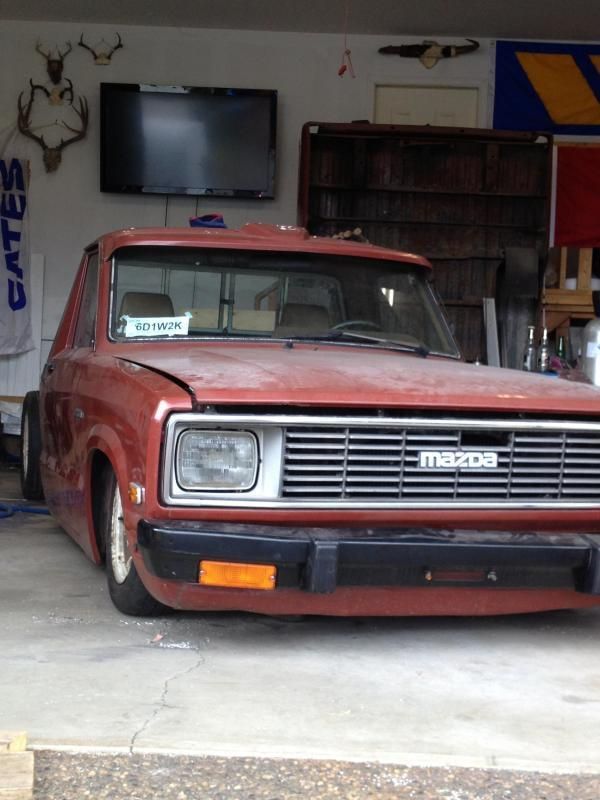

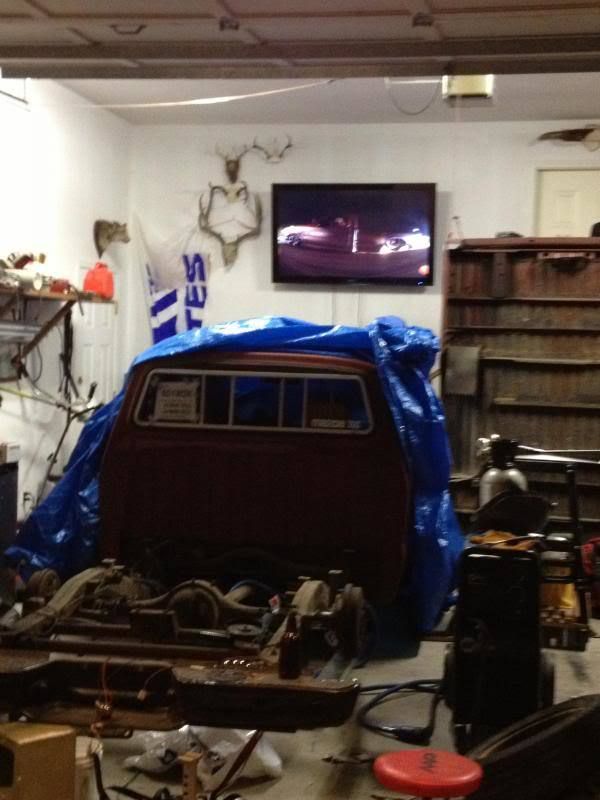

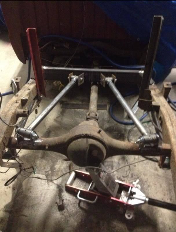

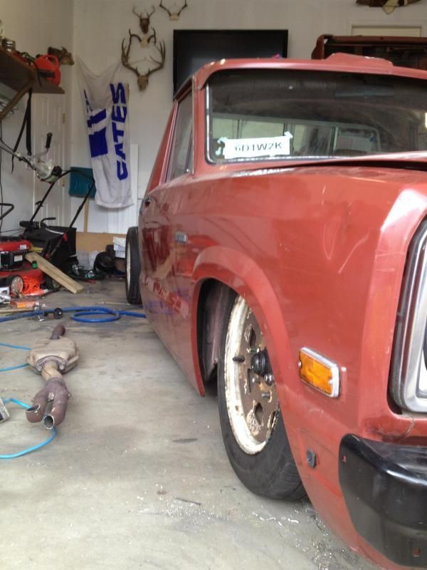

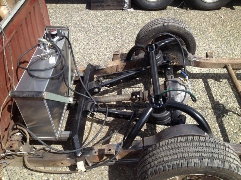

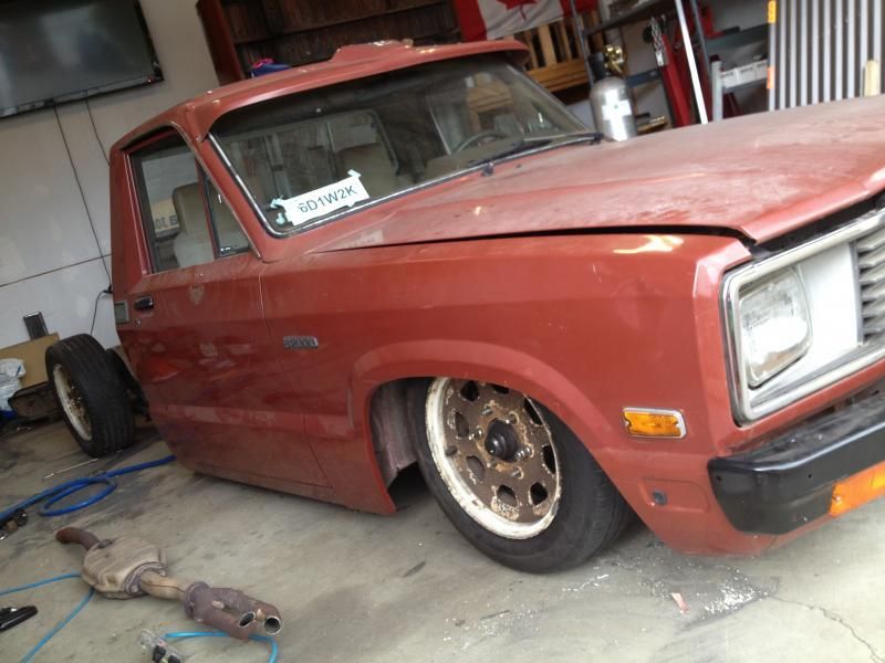

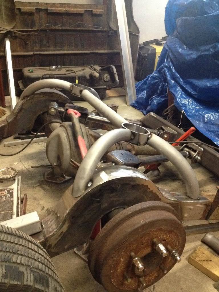

This is my 1983 mazda b2000. picked it up for $300 many years ago. just waited till i had my own house to bag it. iv owned one bagged truck before but i didnt do the bag set up. this is my first time trying it myself. im not trying to do a crazy extreme setup . just leave it as stalk looking as i can but let her lay frame. here is a few pictures of the precess now!!

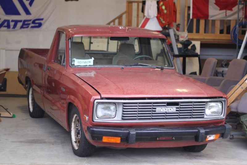

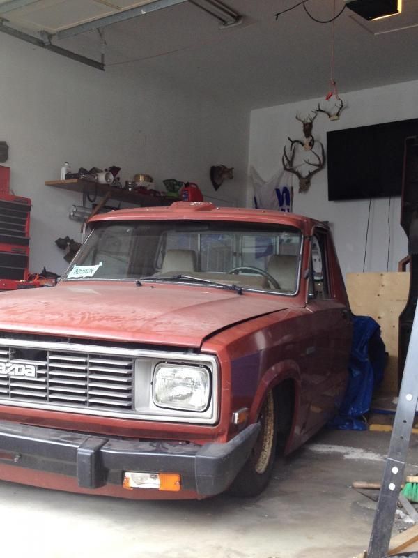

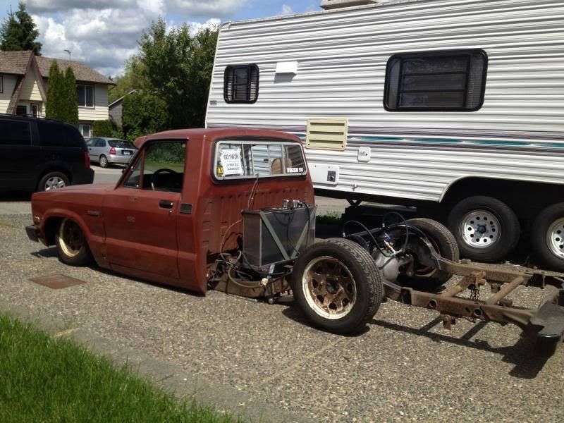

Before:

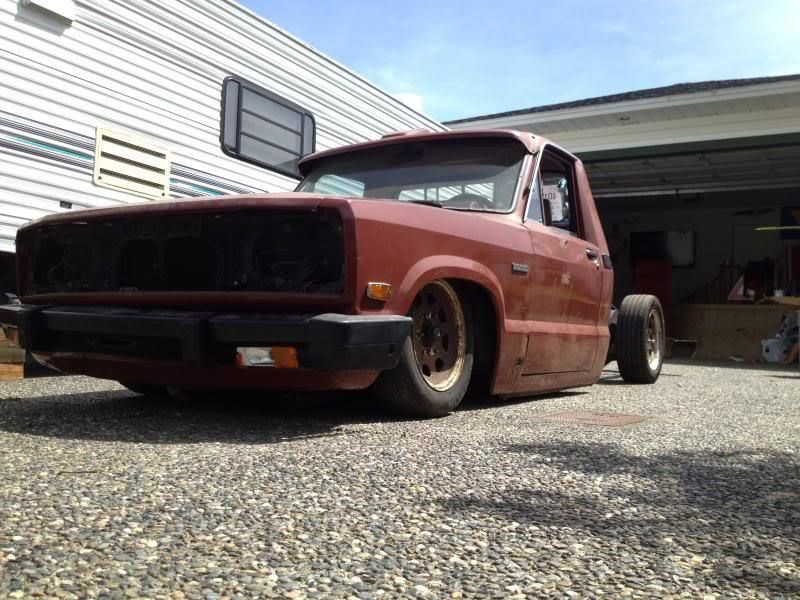

After:

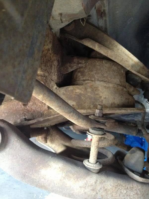

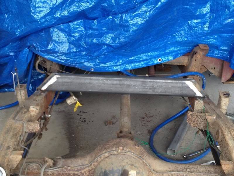

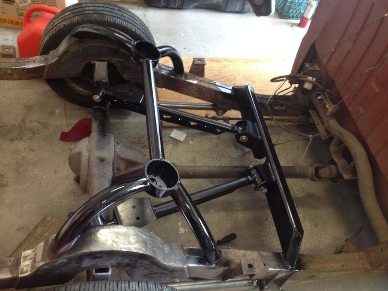

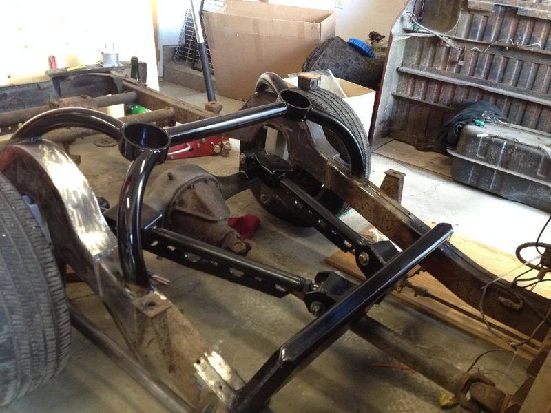

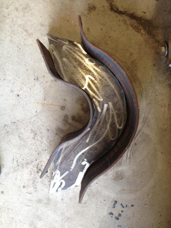

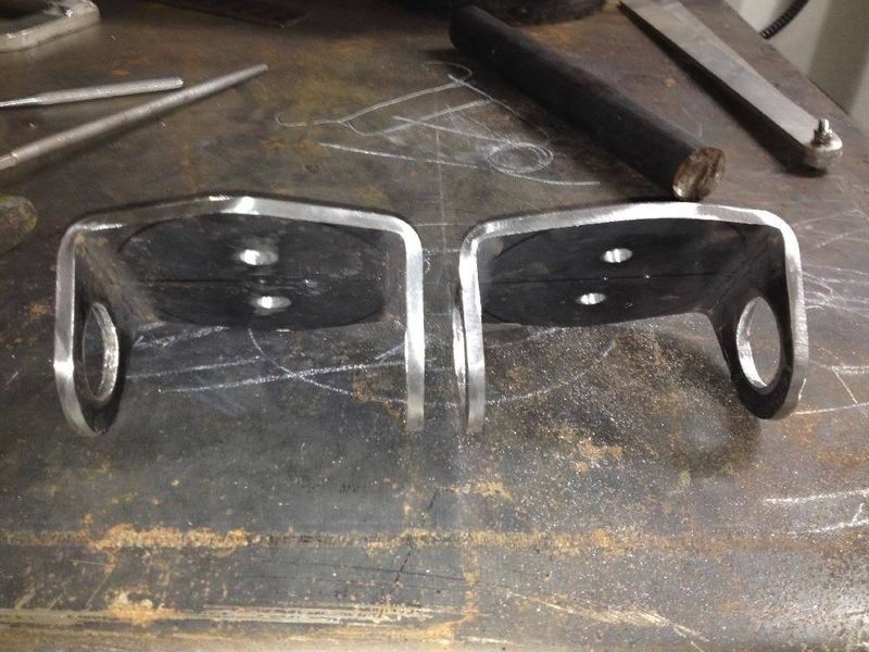

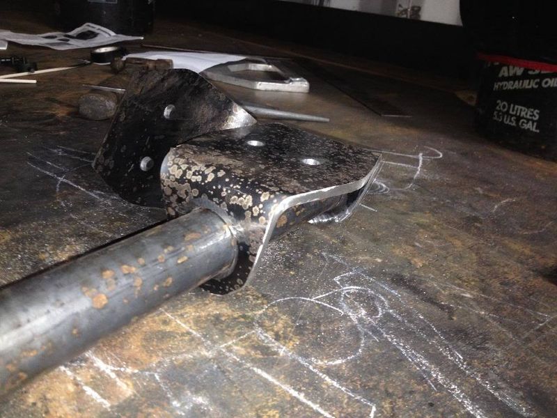

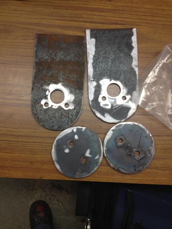

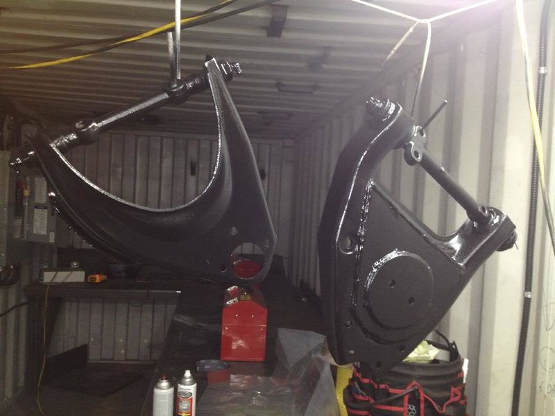

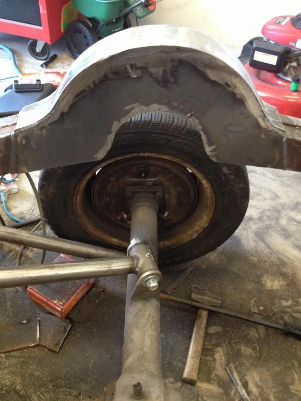

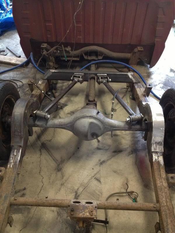

These are the bag plates i made at work:

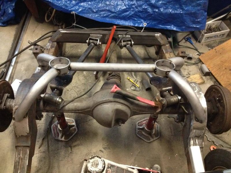

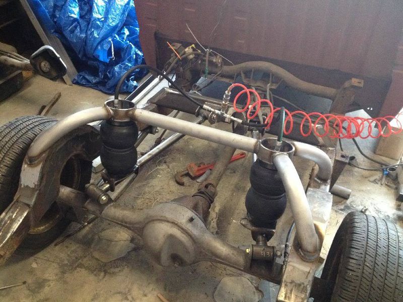

Built an aluminum spacer that is the height of the bags when compressed:

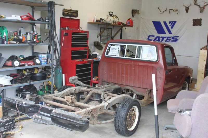

Before anything was cut out:

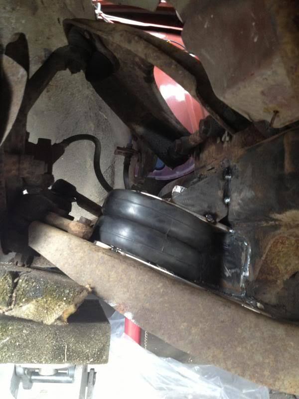

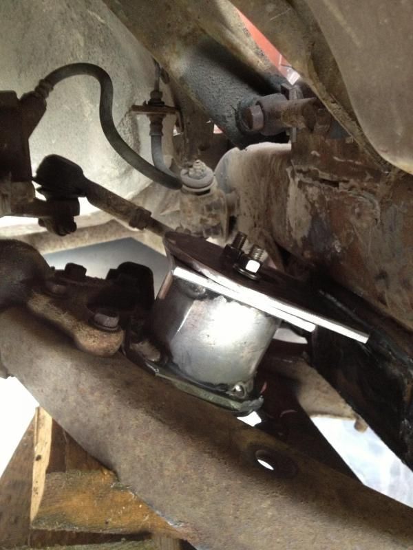

The spacer worked good and helped line up the bolt holes on the bag so i can use both bottom ones instead of just the center. :

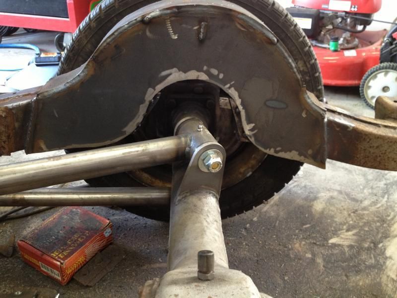

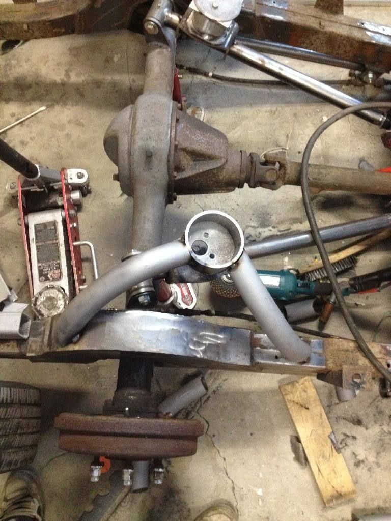

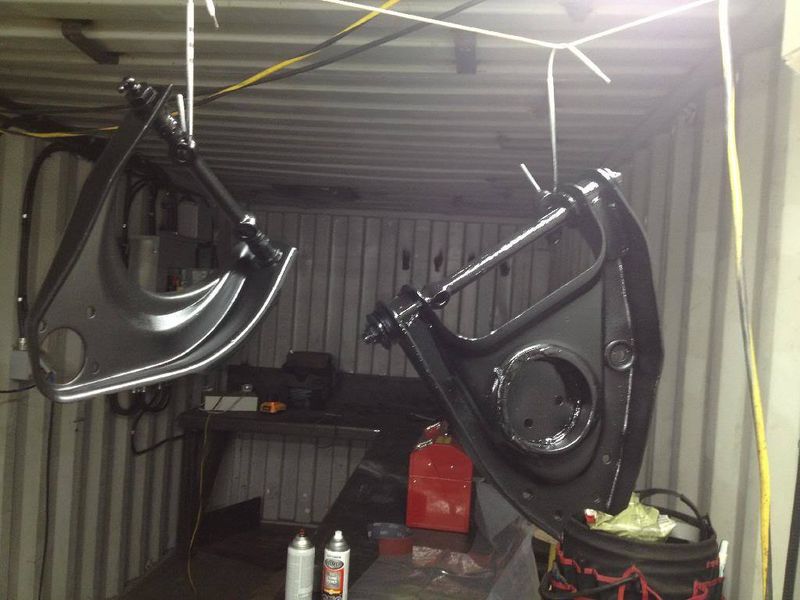

Had to plate the top of the lower arm to life the bag up so keep it from laying on the raised parts when layed out:

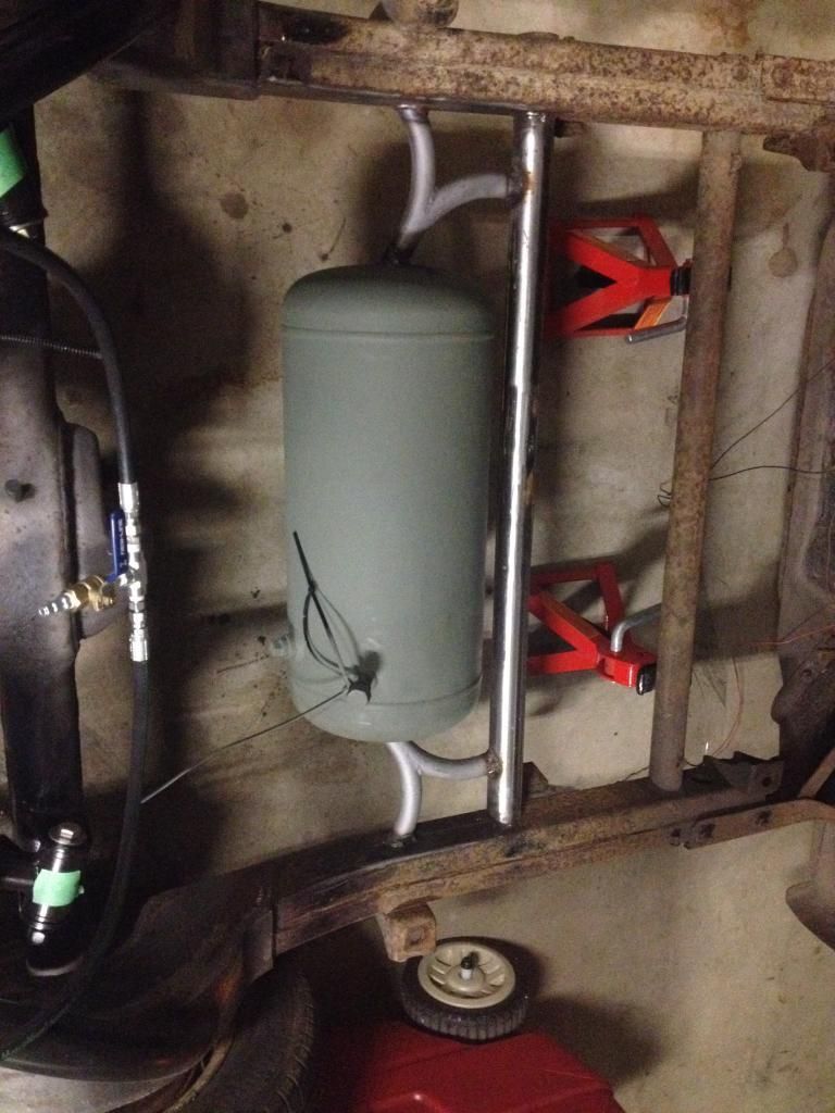

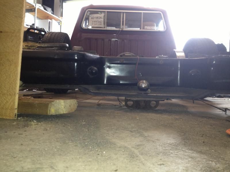

Here is the truck layed out in the front. the exhaust hits and gonna have to cut it out and the frame isnt notched yet. :

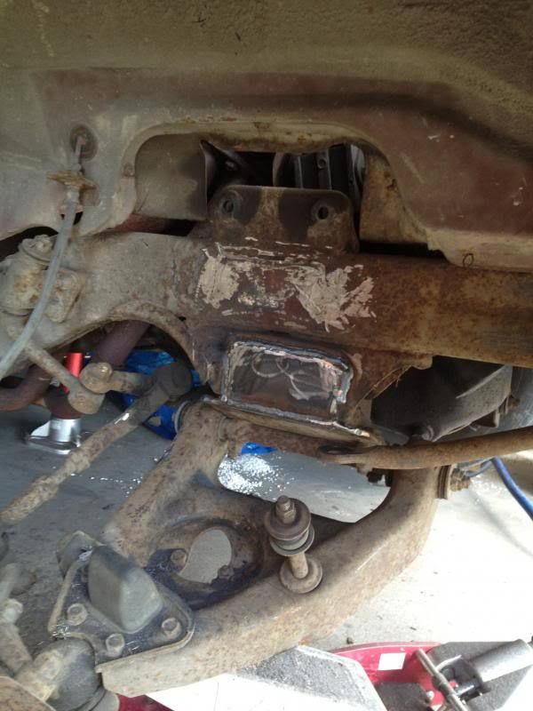

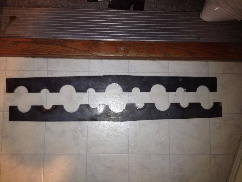

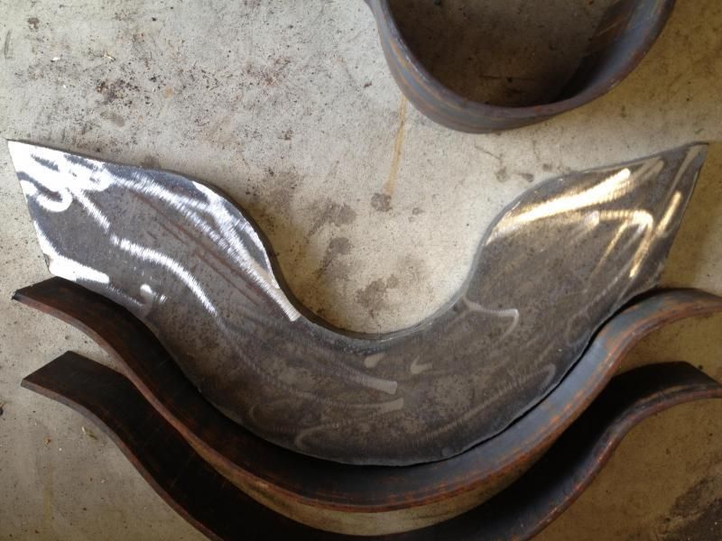

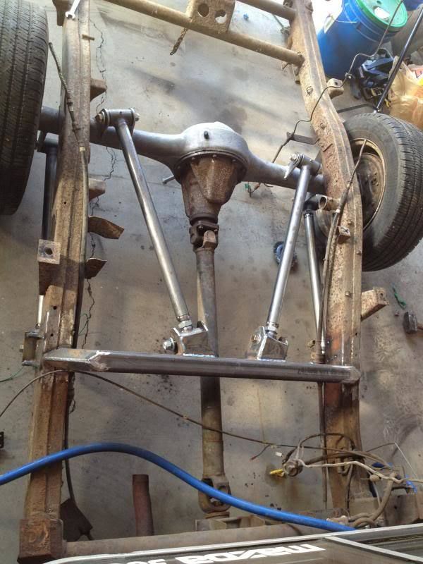

The notches i made:
