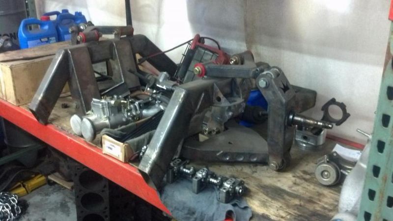

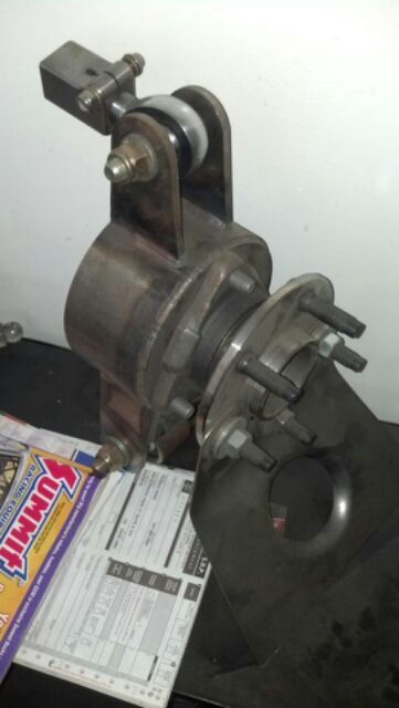

here is the start to my full frame build for my Mazda.. it's completely one off from front to back.. custom built spindles in the front and custom one off rear knuckles for the independent rear suspension.. the rear knuckles utilizes 4wd ranger front hubs cuz they are the same spline count as the supra shafts I'll be using.. not building this to tuck huge wheels but to handle more like a pro touring hot rod... It'll be ls powered and have sway bars front and back ect... Hope u enjoy what's been done this far.

So i take it you arent worried about weight?
X
xgolferdude
Worried about weight? What do u mean?
mymmeryloss's avatar
mymmeryloss
The front looks super heavy. If you want it to handle and be fast then i would just assume you would be watching weight at every corner.
X
xgolferdude
