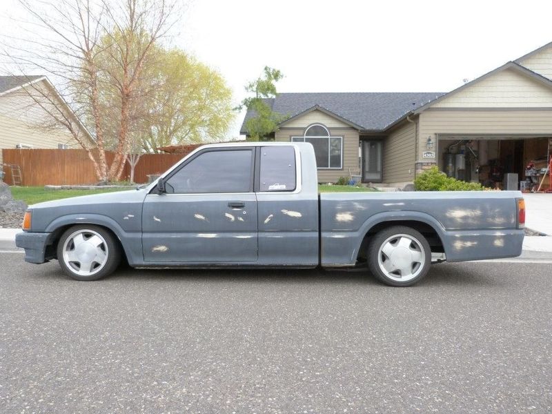

Here are a few pics of the truck when I got it.
Sitting at POs house

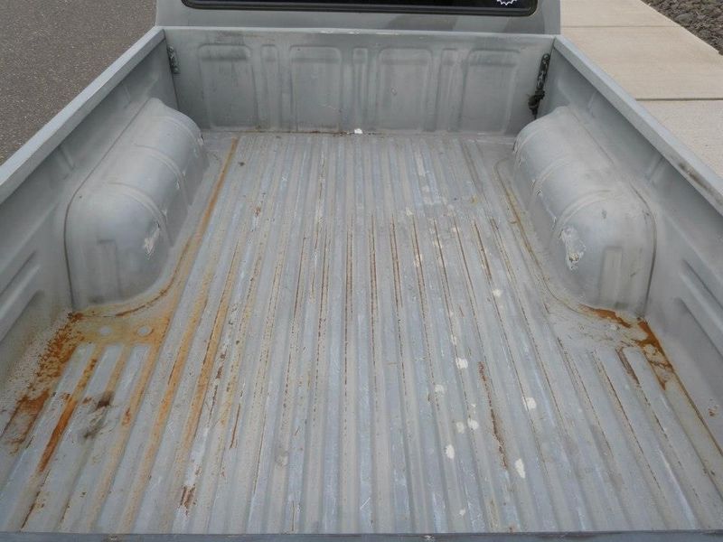

The truck looks better in person, the paint is a two tone primer, the spots that look like bondo are actually the original color of the truck. There's one spot on the rear part of the bed that has a dent. Other than that the body is really strait.

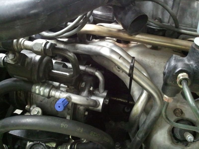

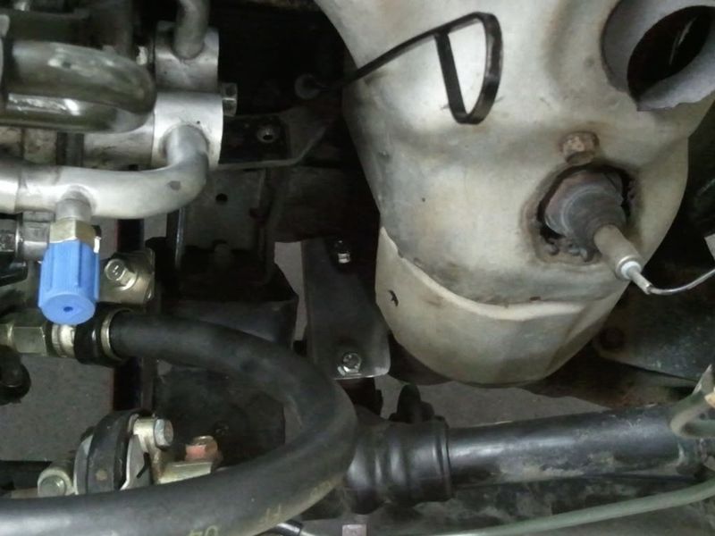

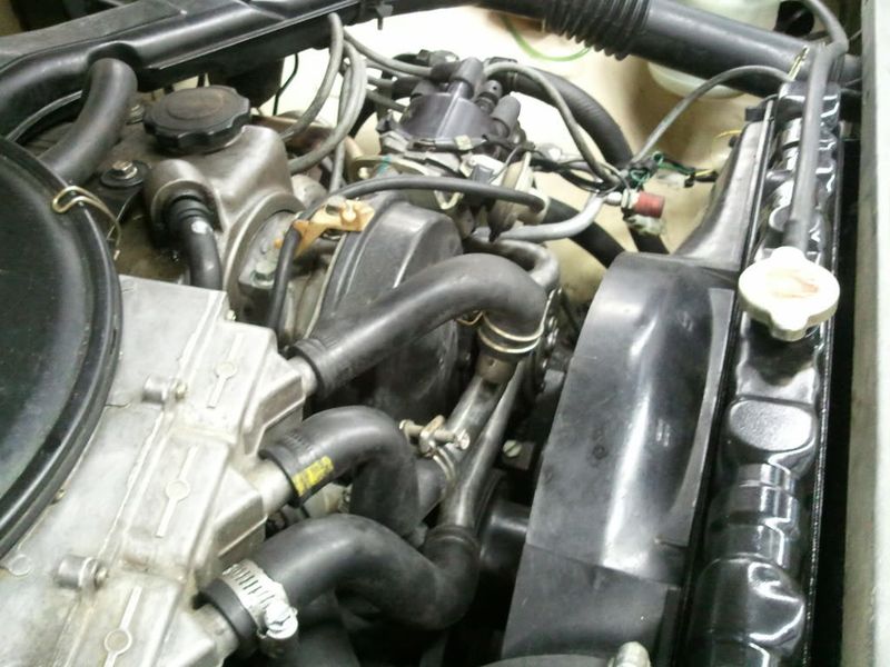

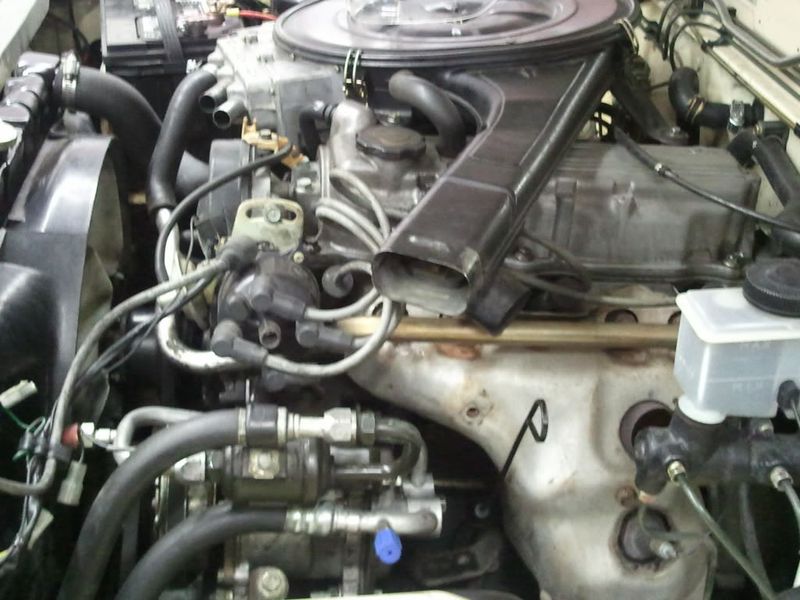

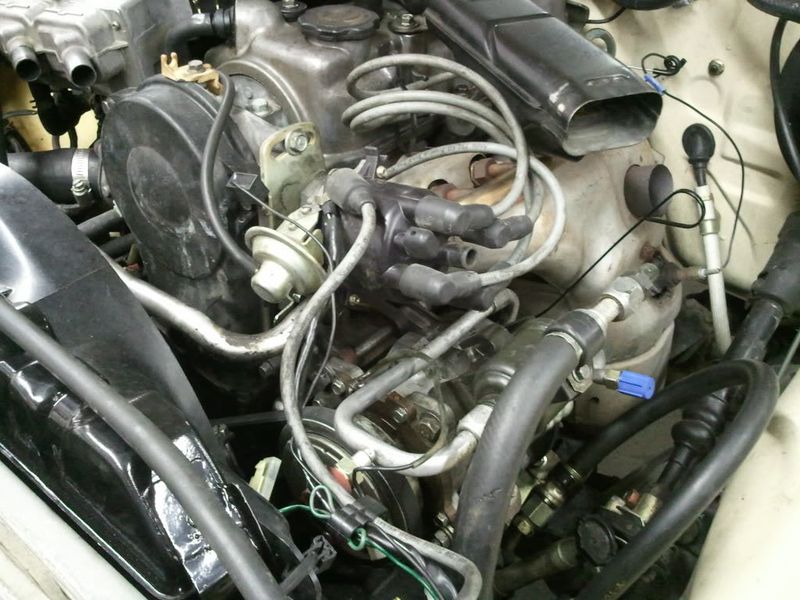

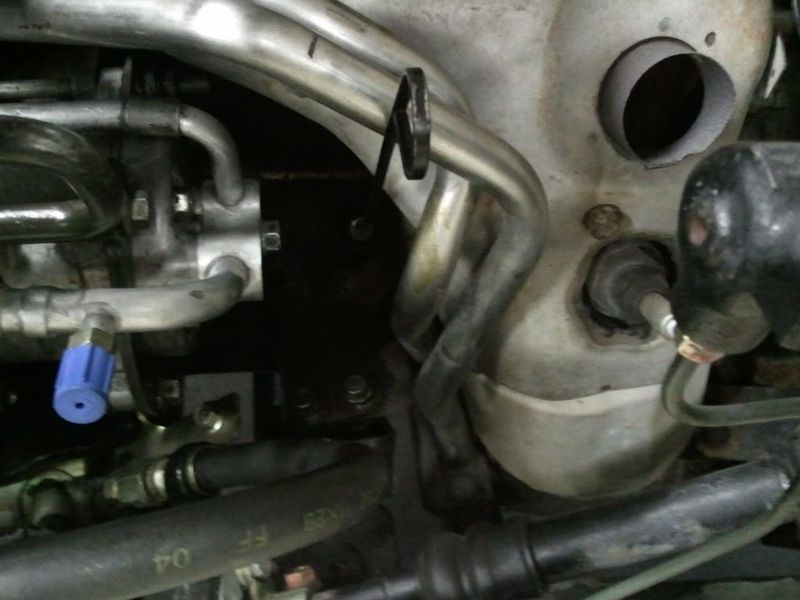

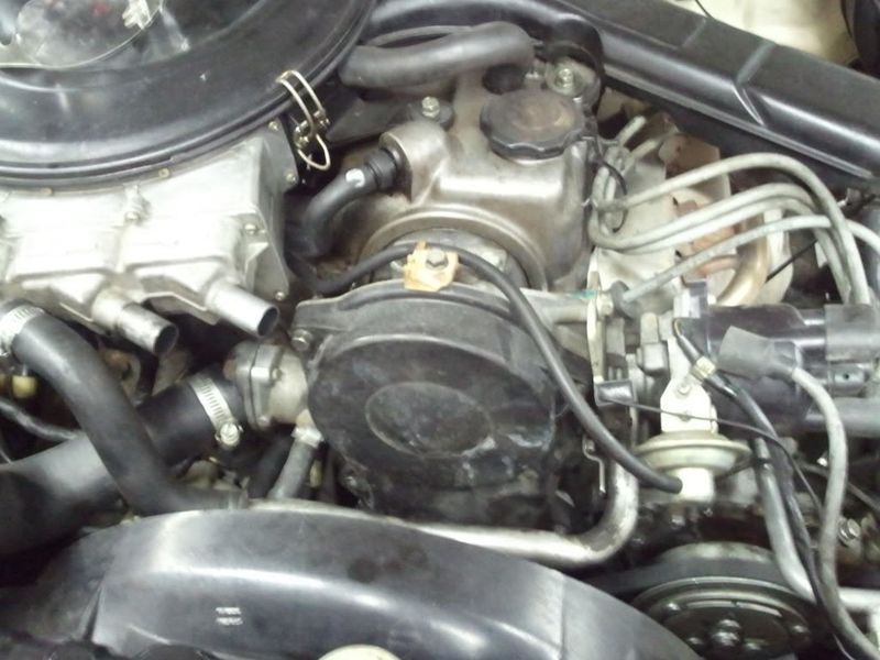

well i got the two EGR tubes that run to the lower half of the manifold blocked off today, pics to come later (just have to upload them).
also set my idle speed, was running around 1500 rpm, since i dont have a tach i had to hook it up to our gas analyzer machine to read the RPMs.
Pretty please with the way everthing turned out. The engine bat definitely looks less cluttered.
91b22's avatar
91b22

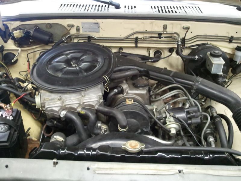

here are the pics
before
after
heres a shot of the block off plate I made

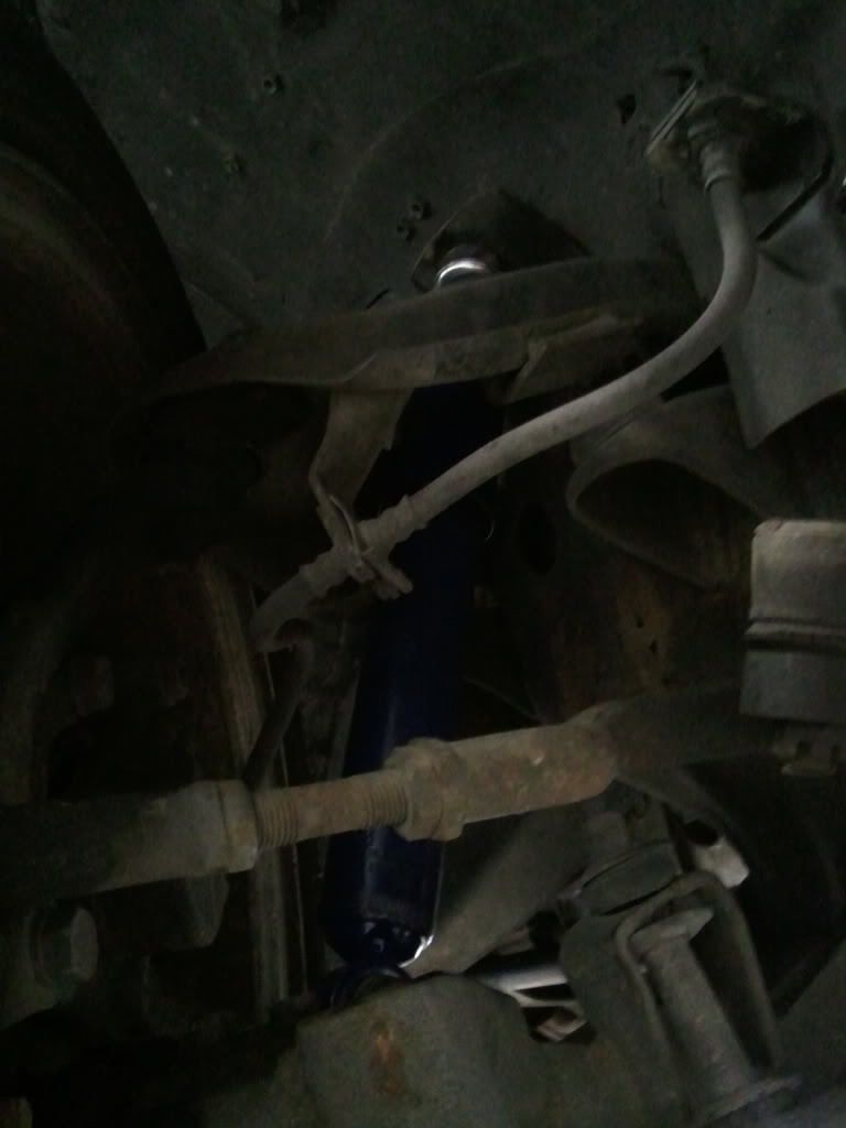

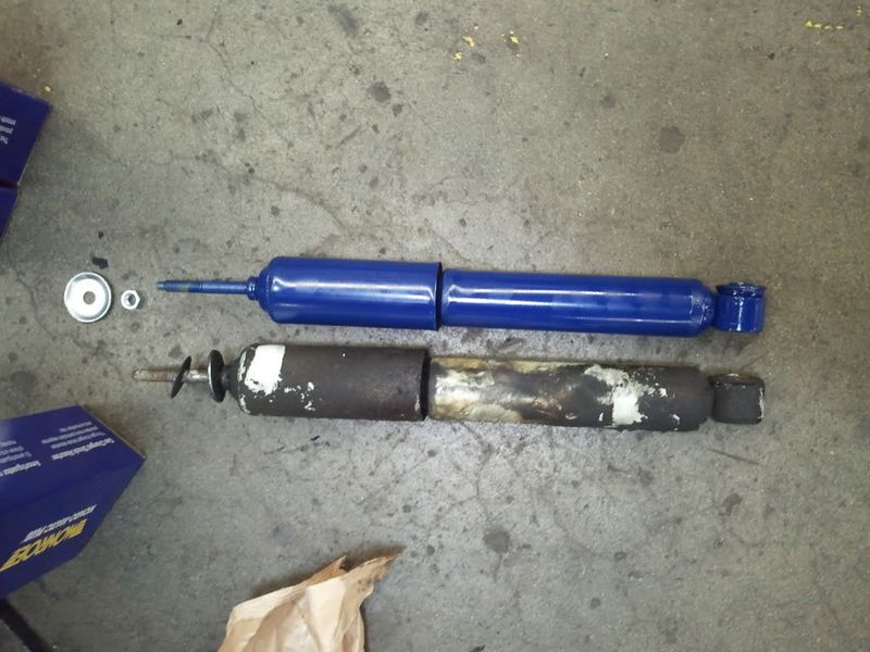

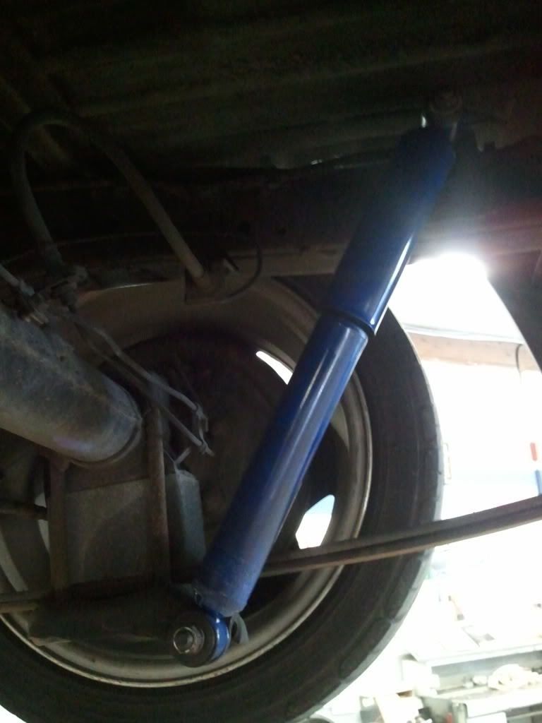

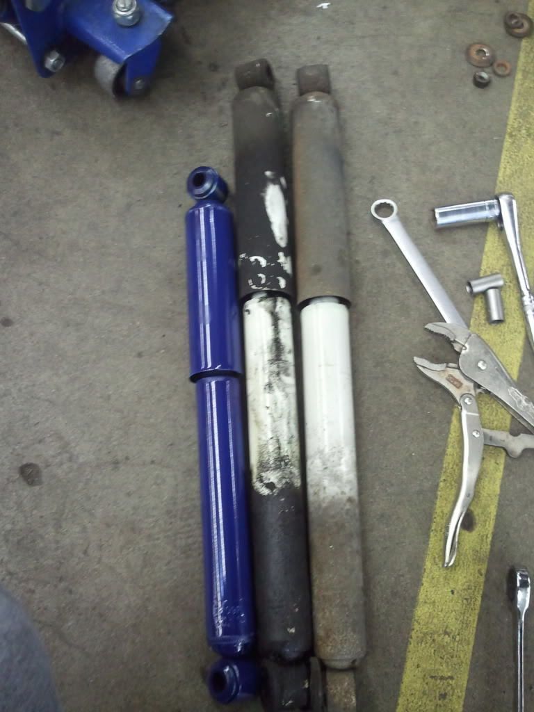

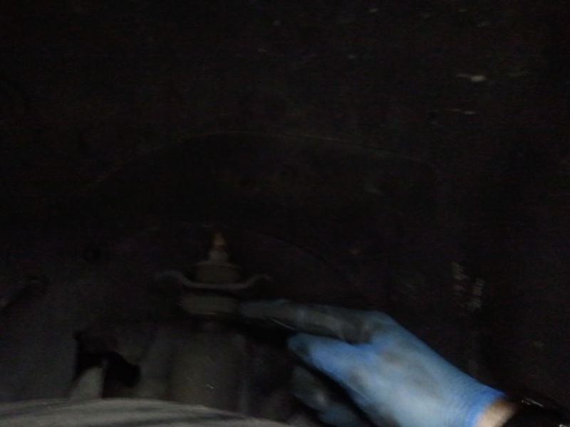

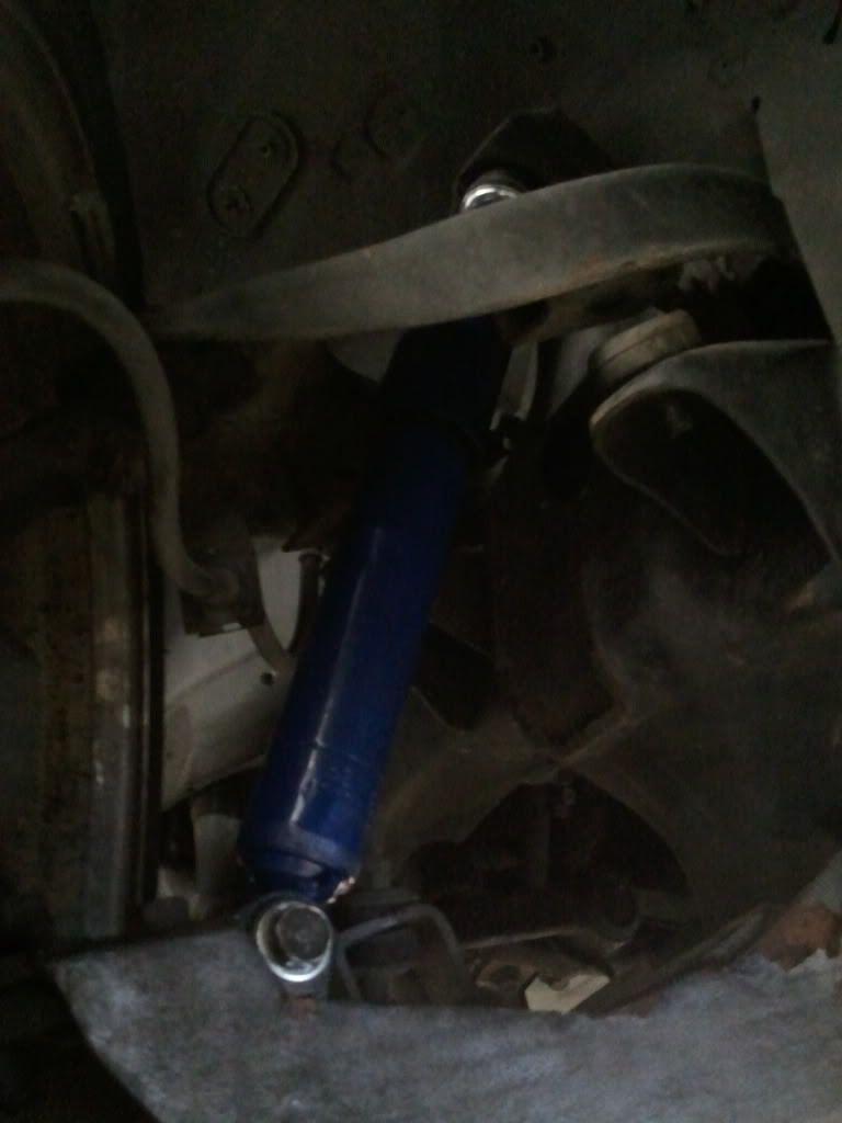

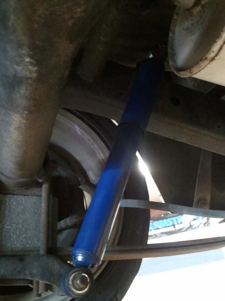

Got the new shocks on today. Turns out 3 of the 4 shocks were blown out, and my front passenger side was missing a bushing causing a rattling noise. I used the Monroe shocks from O'Reillys with a lifetime warrante. Here's what I used
Front:
1985 Isuzu pick up 4x4 shocks
Rear:
1993 Nissan Quest
Uncompressed they are shorter than the factory mazda shocks. My truck rides so good now. And what's amazing is that they bolt right up to the truck with no modification necessary.
I also replaced the PCV grommet. Mine was definitely worn out.
Now for the pics.
Front comparison
Rear comparison
Kind of hard to see but I'm pointing to the bushing that I was missing on the opposite side.
Installed pics
Kind of dark but you can see it in there.
