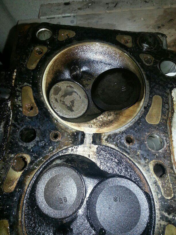

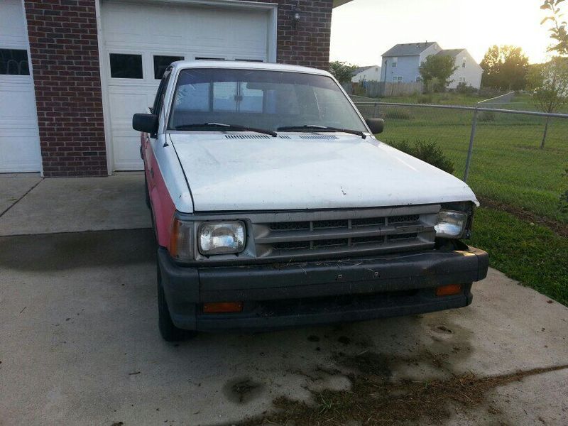

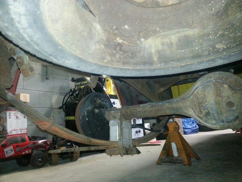

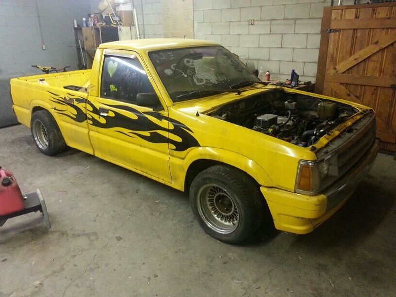

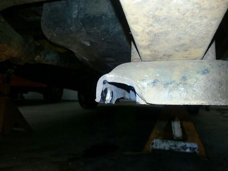

My first mini. Neighbor offered it up since he was tired of hearing my reverse grind. $300. Head gasket is blown. Plan on fixing the head gasket and putting on a Weber 32/36. Nothing fancy. Leave the suspension as is. Kind of a back up truck.
It appears to have 4 inch blocks in the back, and my guess is torsion bars adjusted in the front.

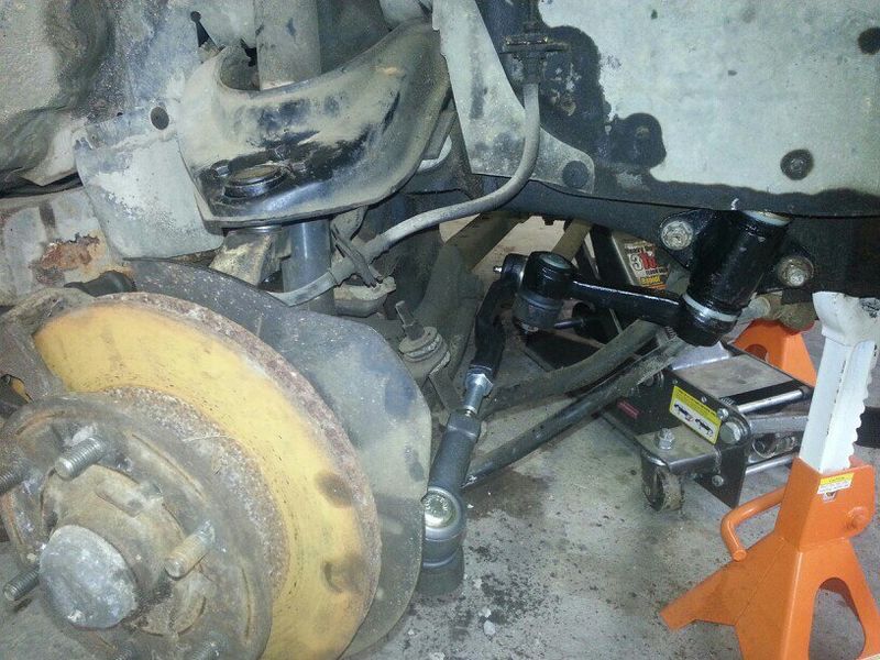

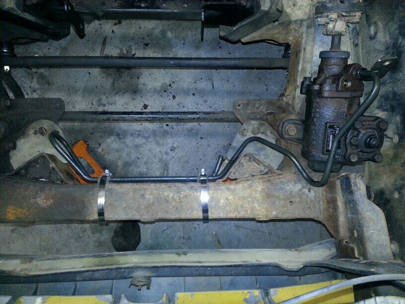

Next, steering joints and power steering swap.

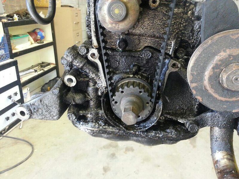

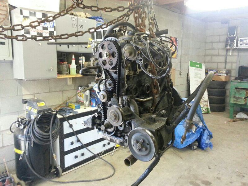

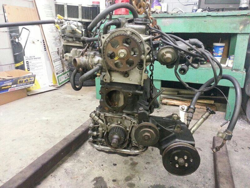

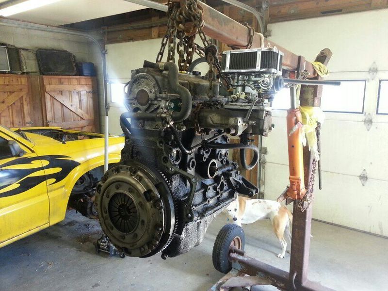

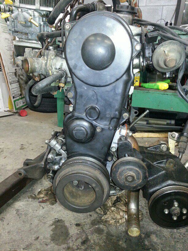

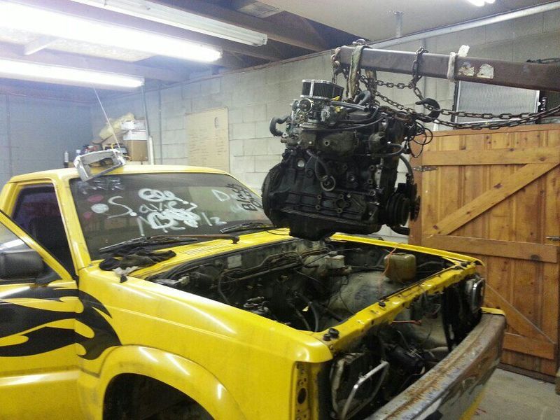

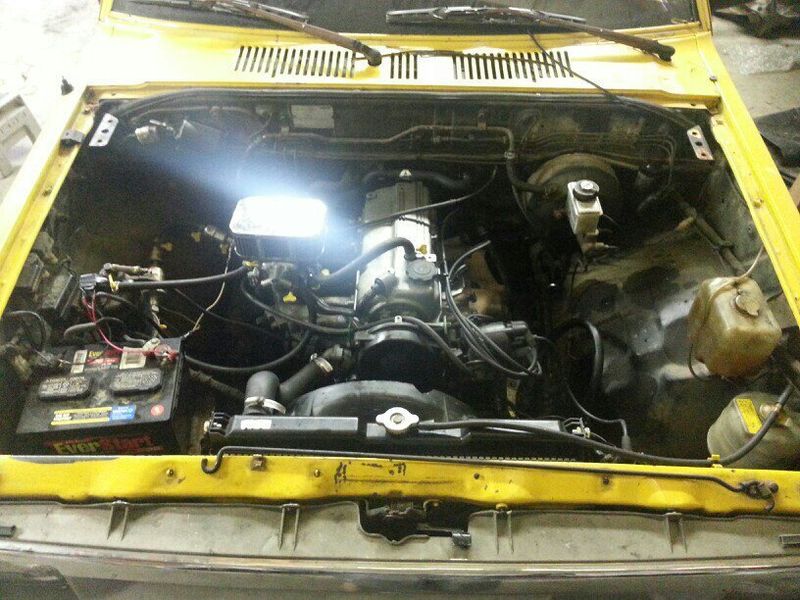

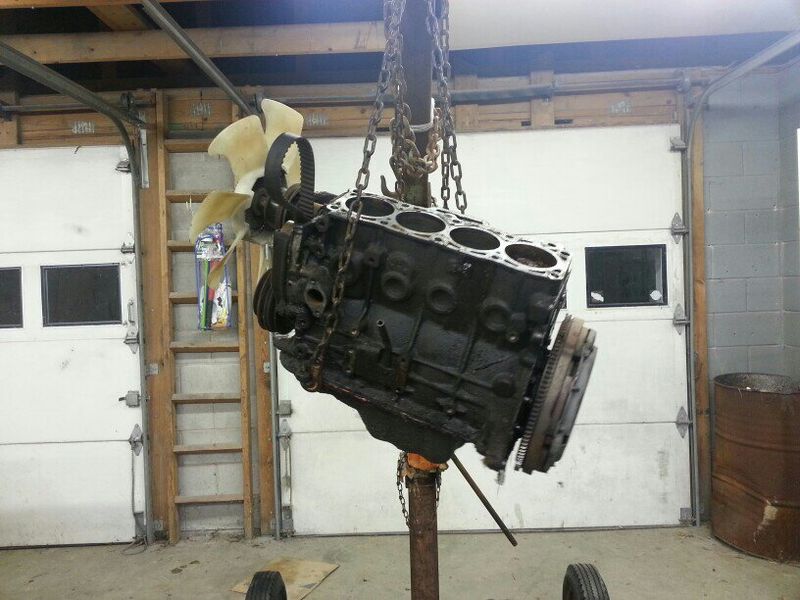

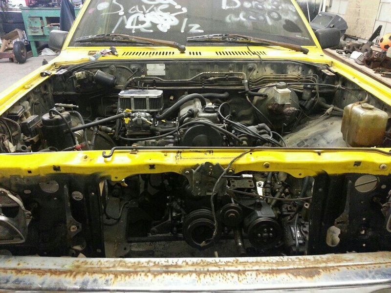

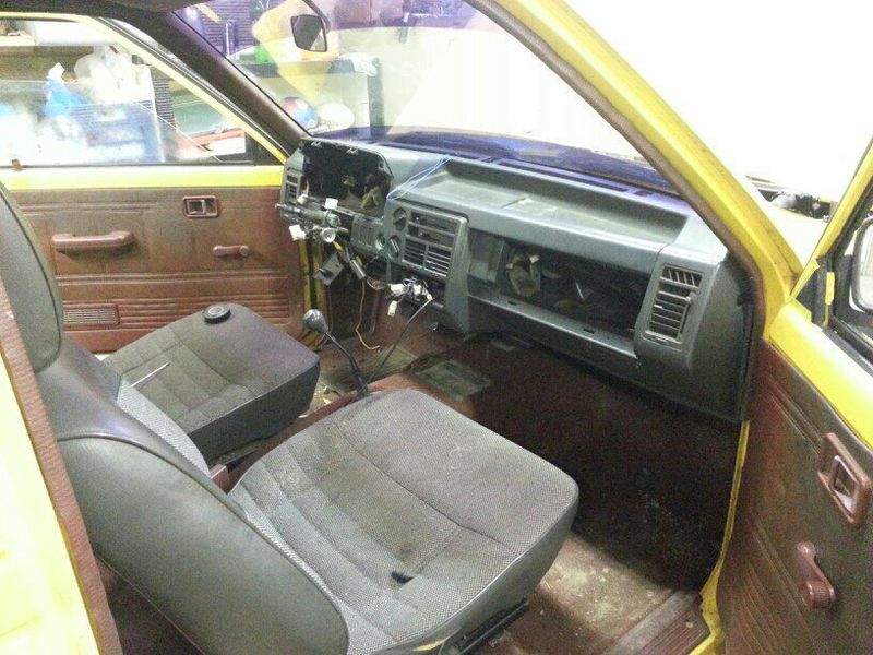

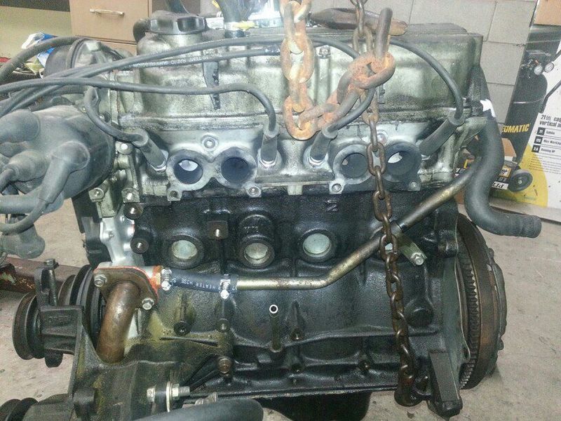

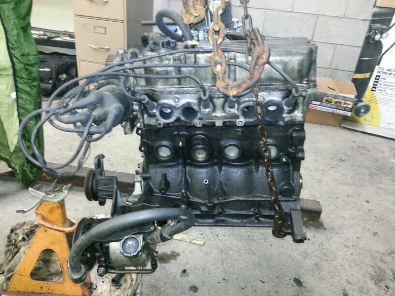

This is where the motor is coming from. The trans is close to death. Thinking of leaving as is, and making a sleeper with just a small V8 inside.

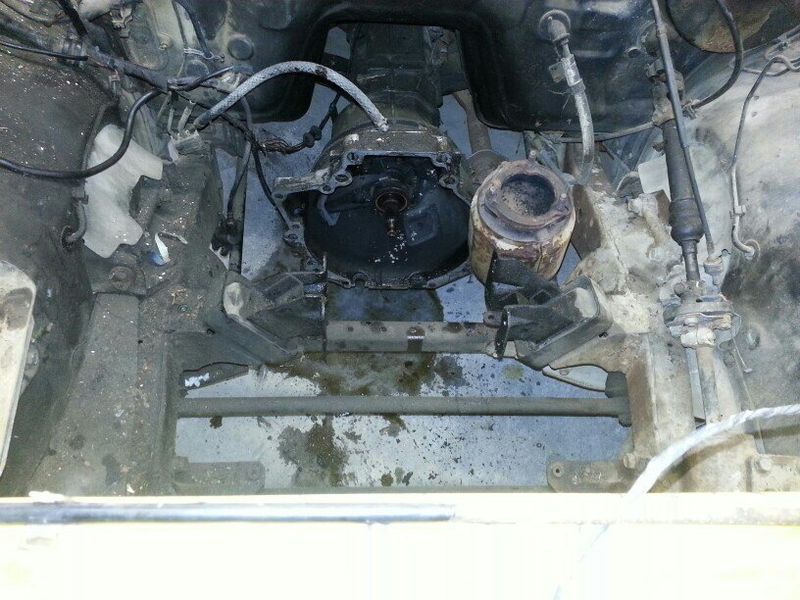

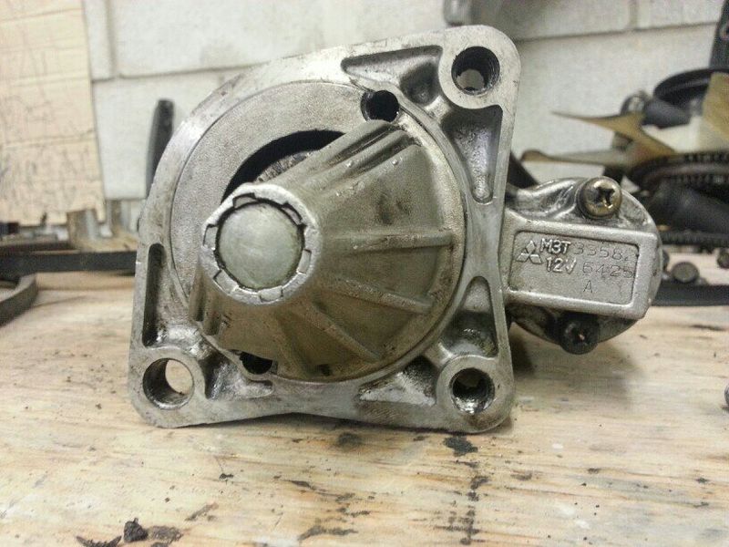

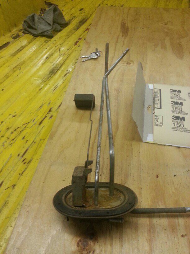

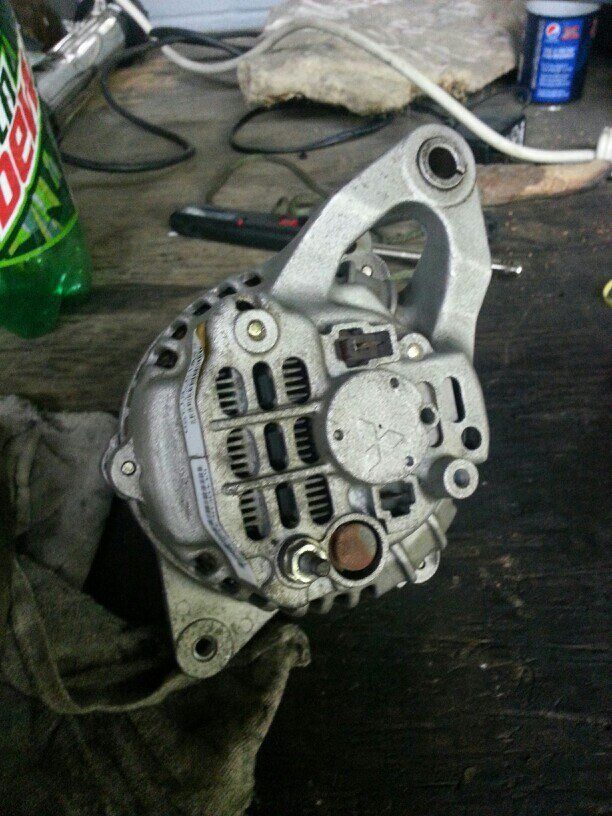

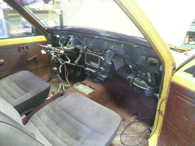

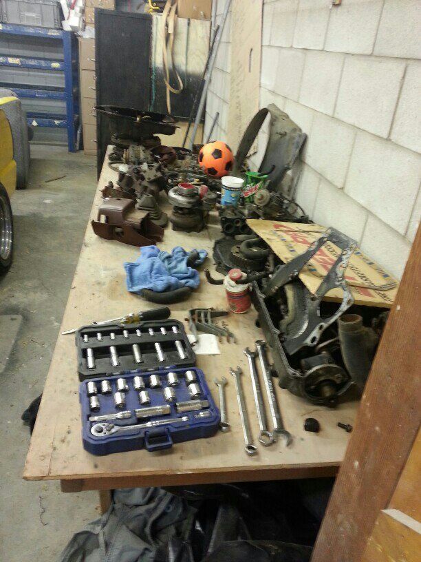

All the stuff that came out:
It'll definitely be a slow build. Not really even a build so much as a revival.
Sent from my [url="]Slimmed Garnet Red SGS III using Tapatalk 4

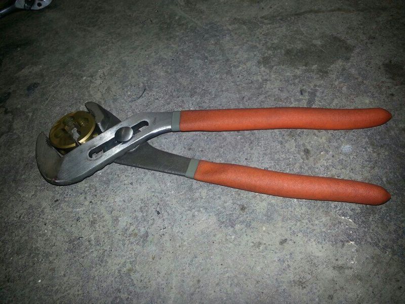

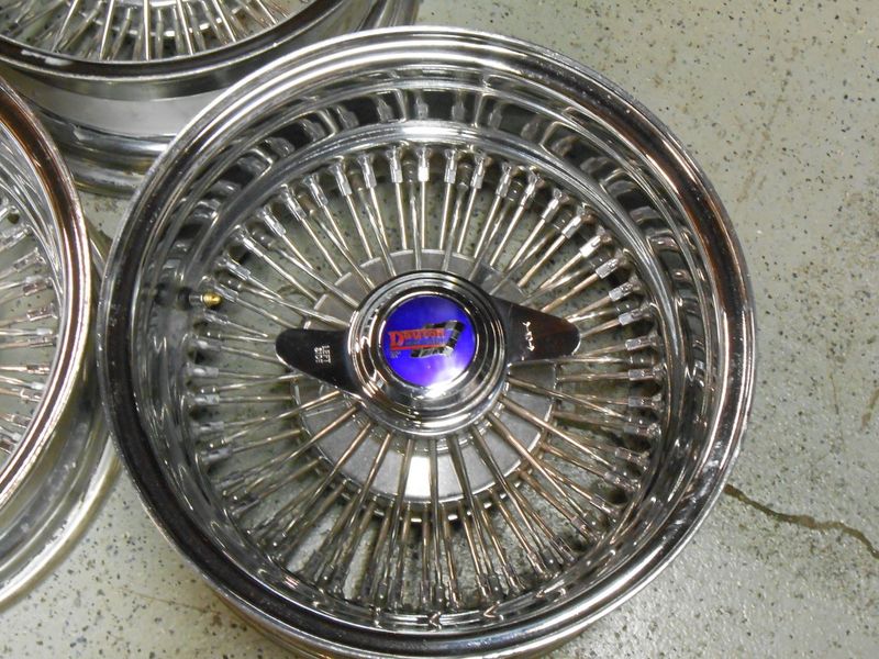

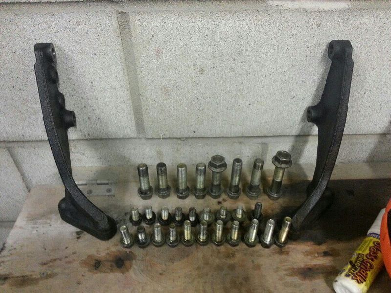

Here's the second mechanic. He took off the center cap holders/braces.
spacemonkee23's avatar
spacemonkee23
Yeah mine had some wheels that stuck out when I got it too. Changed that out quickly.

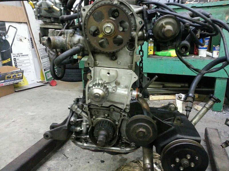

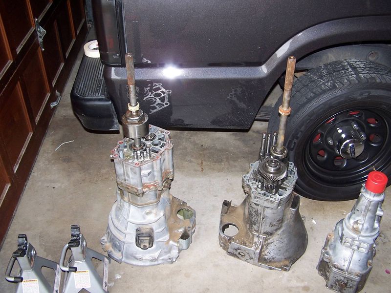

The 5th gear in the transmission is what I swapped out with an RX7 tranny. same internal design just different gear ratios. I dont remember the exact gear ratio but on the freeway at 70mph my engine used to be around 4000rpm! now it sits around 2500rpm at 70mph.
the exposed gear on the right is the 5th gear. center and tail shaft housing were removed to get to it and swap it out. Did it about 5 years ago and this is the only pic I have left.
