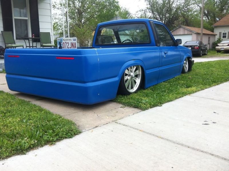

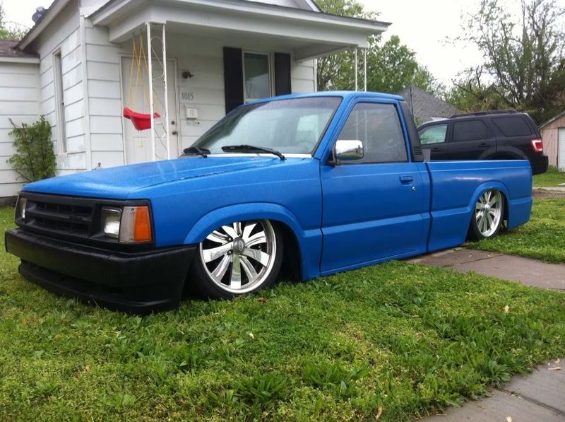

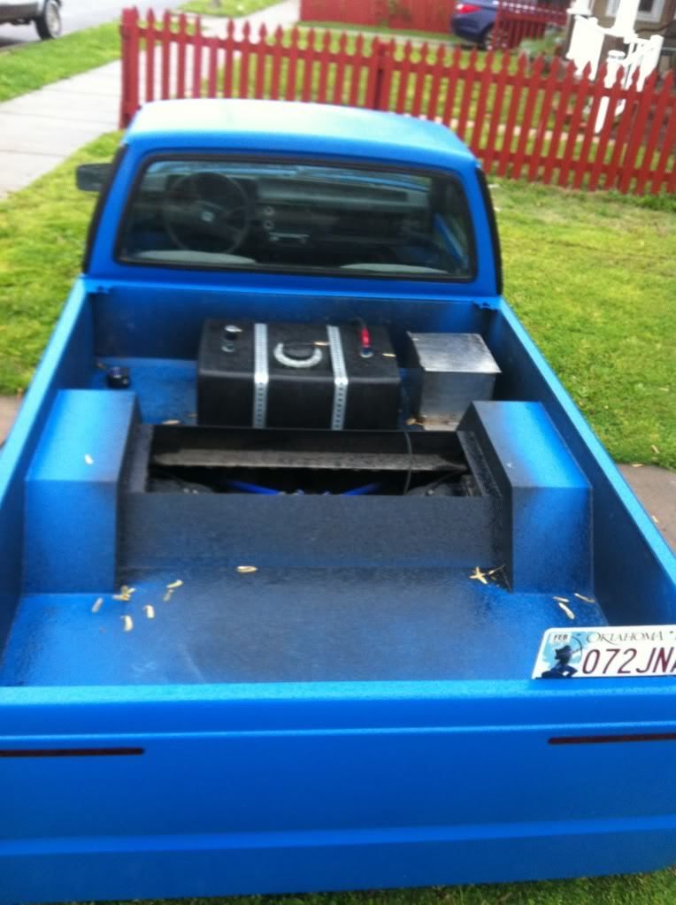

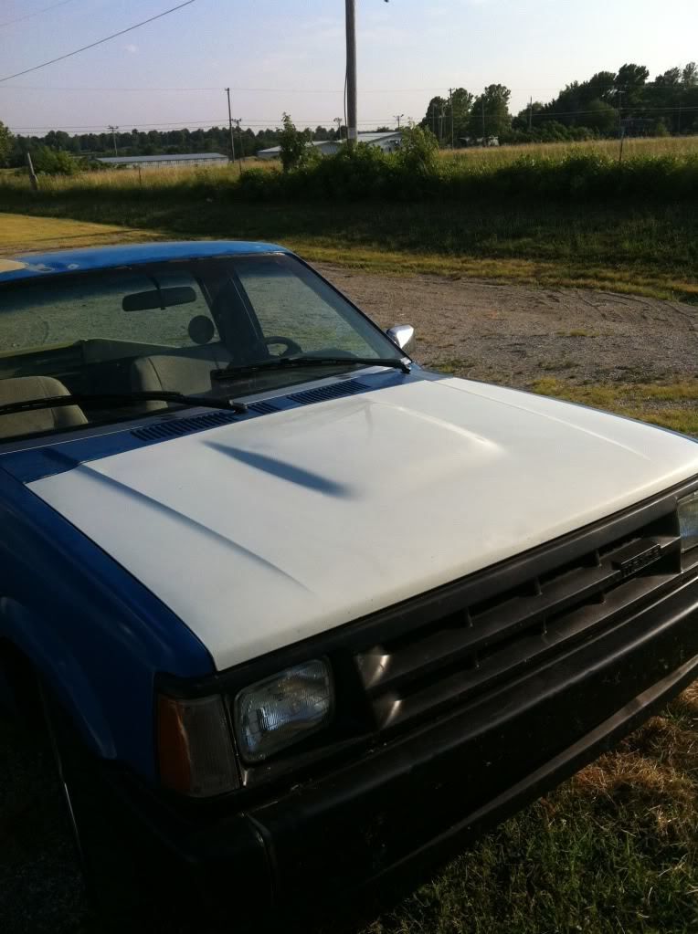

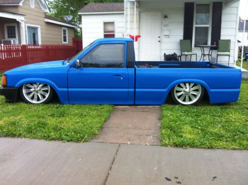

That's some of my more recent history but back to the Mazda. I've been wanting another mini to use for a daily for a while now. So when this old school build came by I scooped it up. It was built in the 90's if I had to guess and someone has attempted to updated it and done more harm than good in some areas. Mostly the interior and bed floor area are in need of being redone and a couple other little things.
Someone has already body dropped it to the pinch and bagged it although I'm planning on doing some work on the bag setup. It's wearing a set of 18" Boyd coddington shoes. The air management system is a big part of the air bags I'm going to redo. It only has a single Viair 380 compressor and a single 3 gallon tank. The previous owner did install a new set of 1/2" valves to replace the old manual paddle valves right before I got the truck from him. I just wish he would have done something different with the valves besides throw them between the seats lol. He also left the 1/4" line for the system for some reason even though the bags are 3/8" and the valves are 1/2". So like I said I'm going to be redoing most of that. Ill quite rambling now and show you guys what I'm working with.
Let me know what you guys think. I haven't messed with a Mazda in years and the last one I had was just bagged and an extended cab so if anyone sees anything out of place or odd let me know so I can check into it lol.

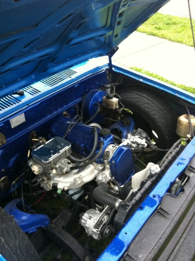

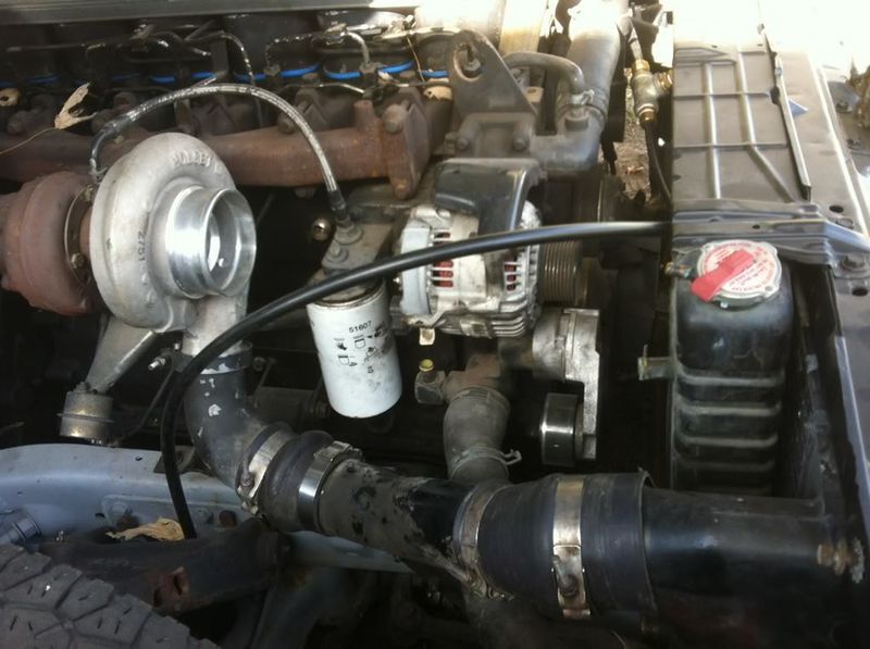

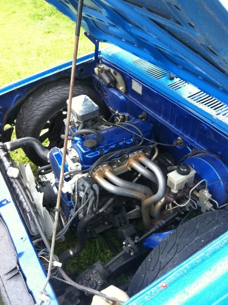

The engine on the truck is the first thing I got up to where I want it since I'm going to be driving the truck everyday pretty soon. The engine and trans are done now unless something else pops up and the color on the firewall and engine compartment is the color the entire truck is going to be. Planning on that blue with a bit if silver.

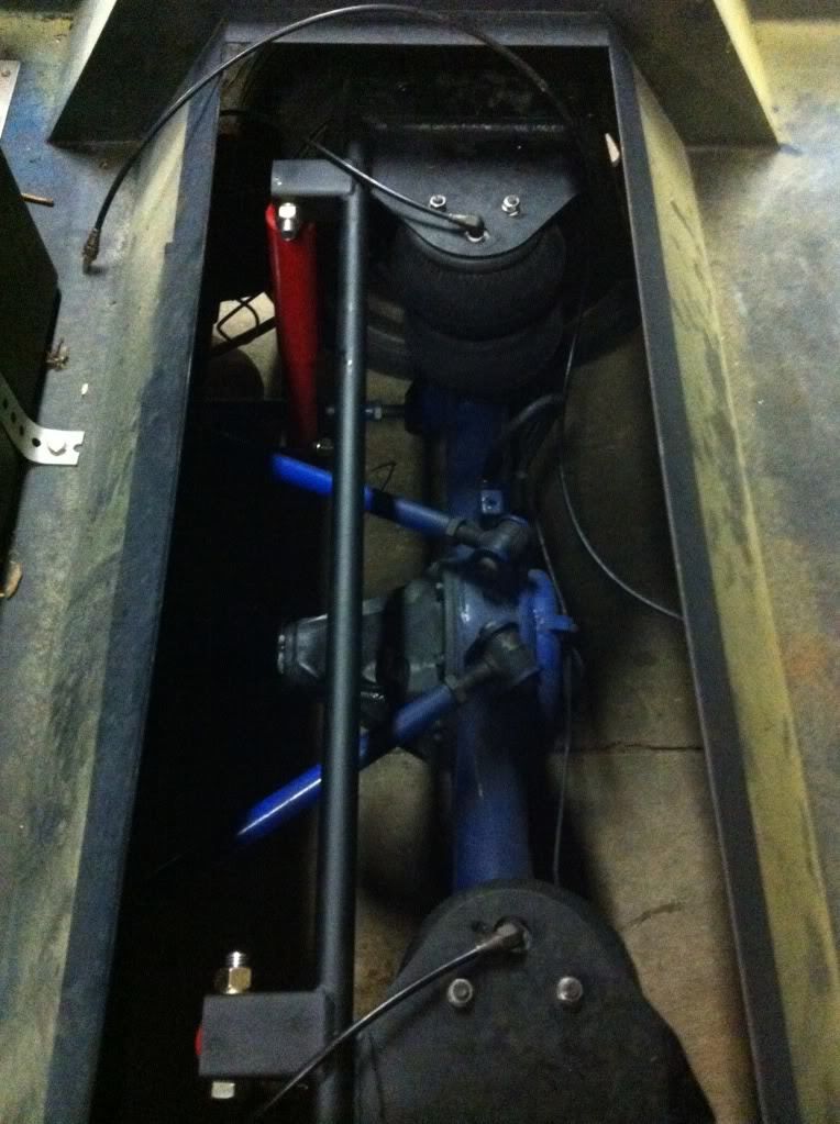

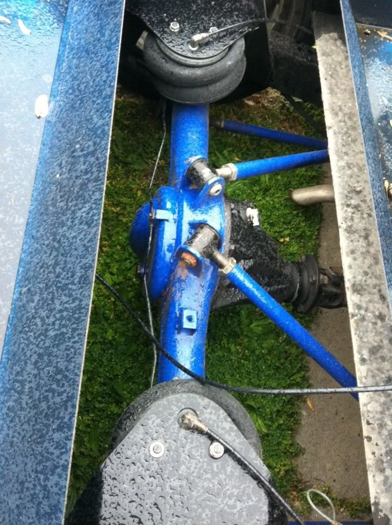

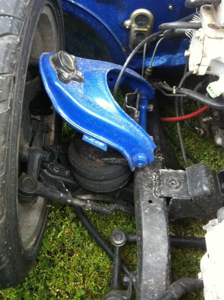

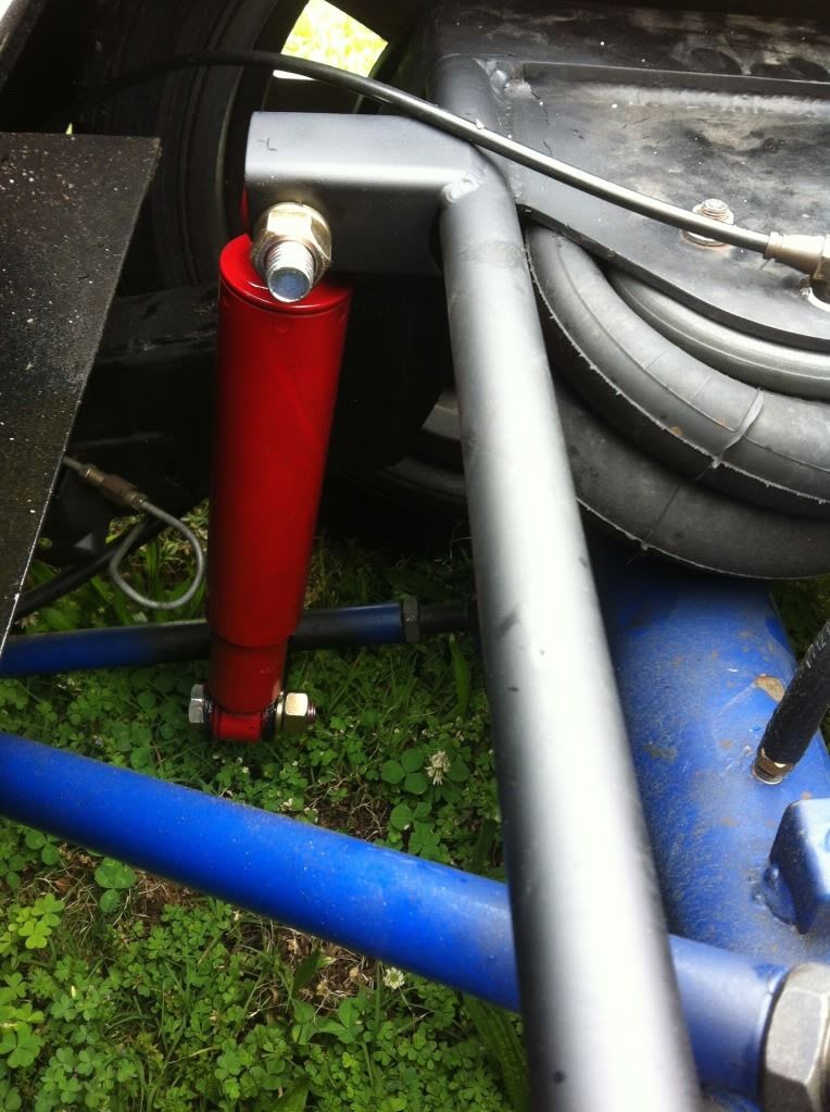

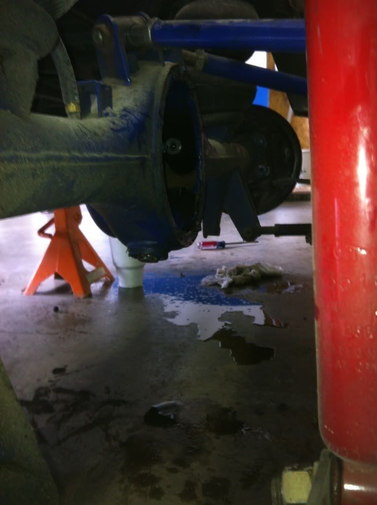

The suspension is what's going to get some love now that the engine and trans are done. I'm not sure but I think the front bags need set in closer to the pivot point.
If you notice there isn't even a brace going across the notch to keep the frame rails from twisting outwards.

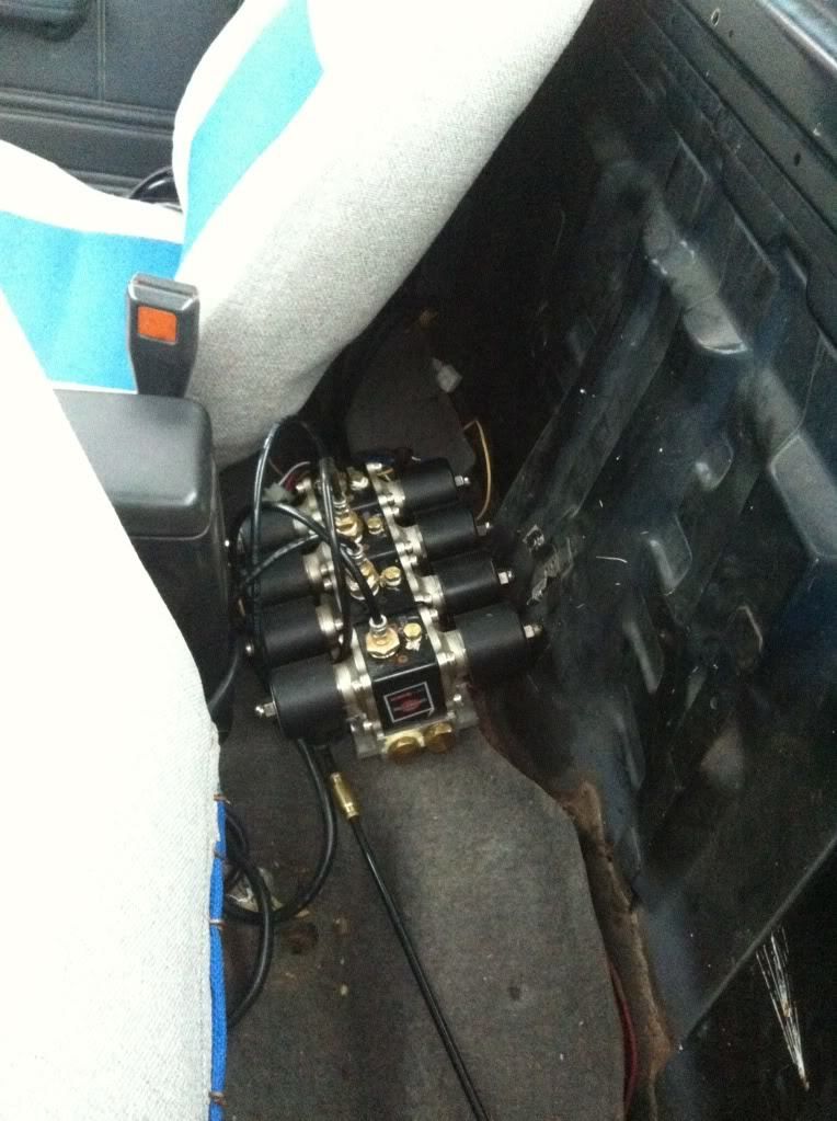

This is where the guy before me decided to mount the valves. Is was crazy loud in the cab when you let any air out of the valves. Just to not go deaf temporarily I just ran a piece of 1/2" dot line out the back of the cab till I get the parts in to redo all of my lines and move them to outside the cab

After the bag setup gets brought up to my liking I'm going to cut to bed floor out and redo all of that. I hate these squared tubs. Their just not my thing and the plastic fuel cell is pretty janky also. I can live with it for now though until more important things get updated.

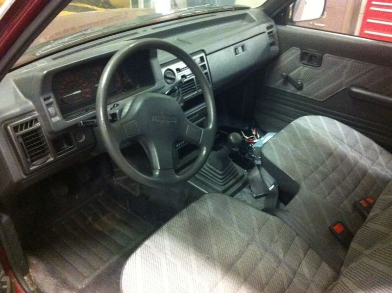

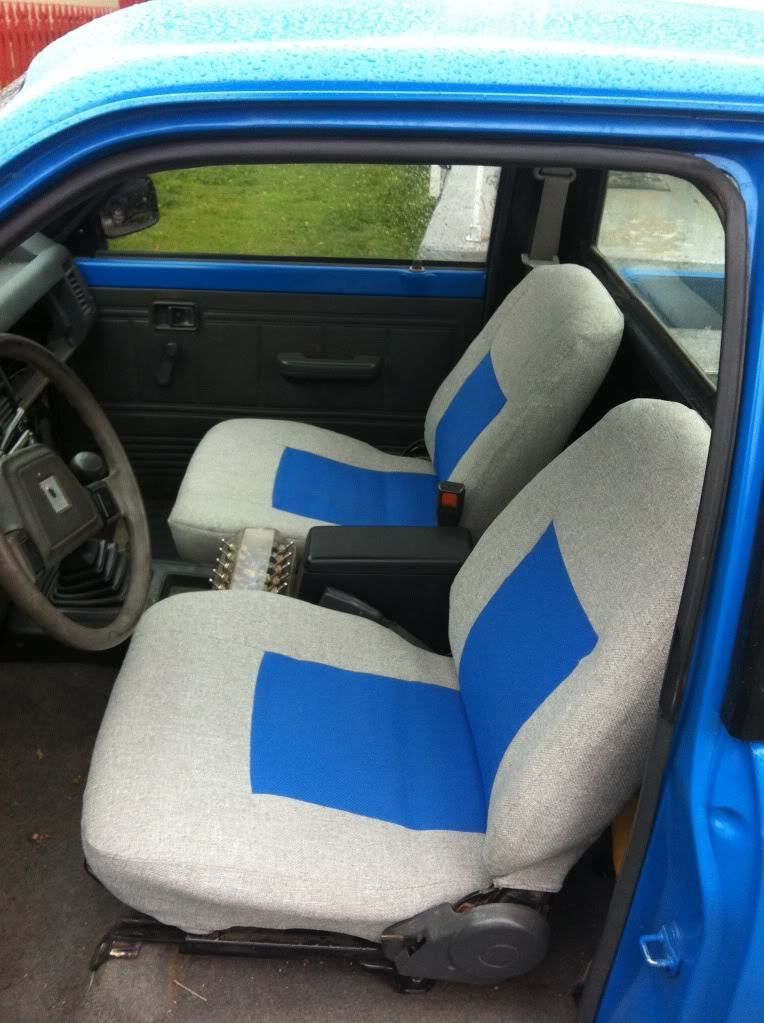

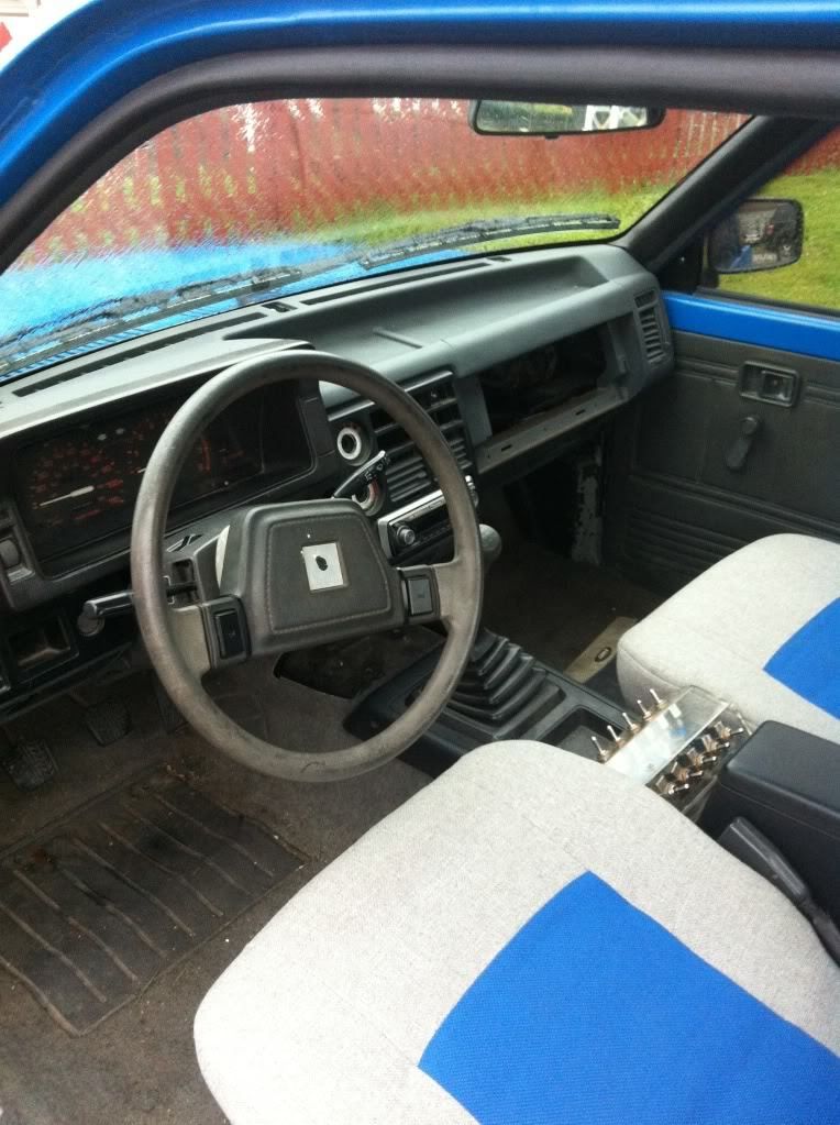

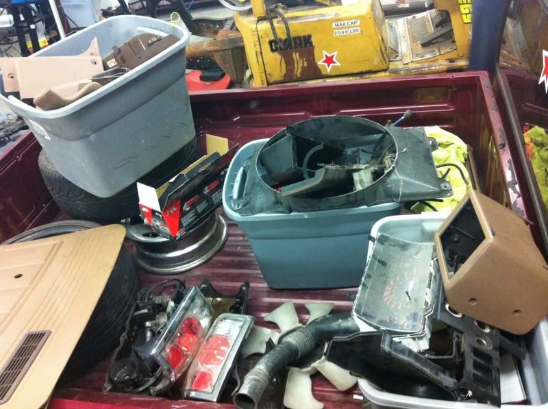

The interior has been started on but needs a lot of missed parts found and installed. For example someone decided to throw the glove box and lid away. Not sure why but its stuff like that I have to go find. The up side is the seats are freshly tweed wrapped in the colors I want to do the interior. The other good news is I have a friend up the road at Guilty by Design give me this bad ass factory center console he had rat holed away. I was stoked to get it.

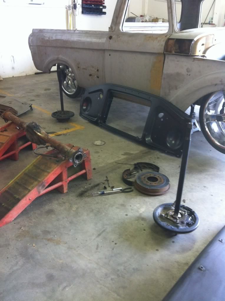

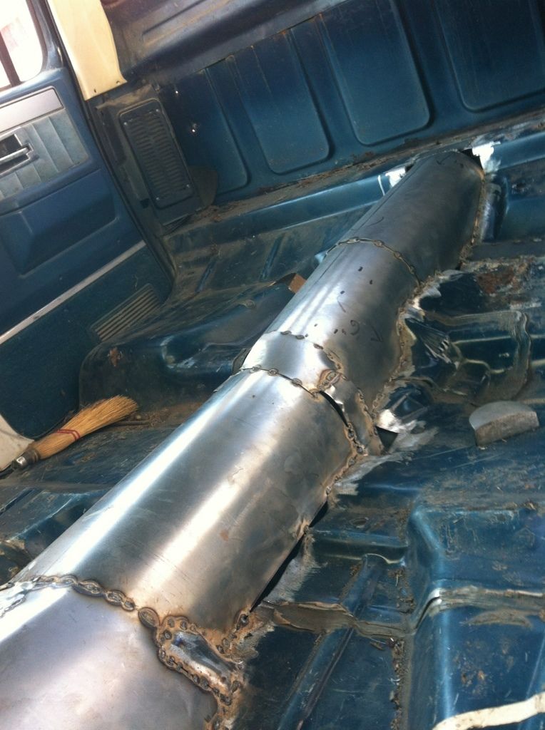

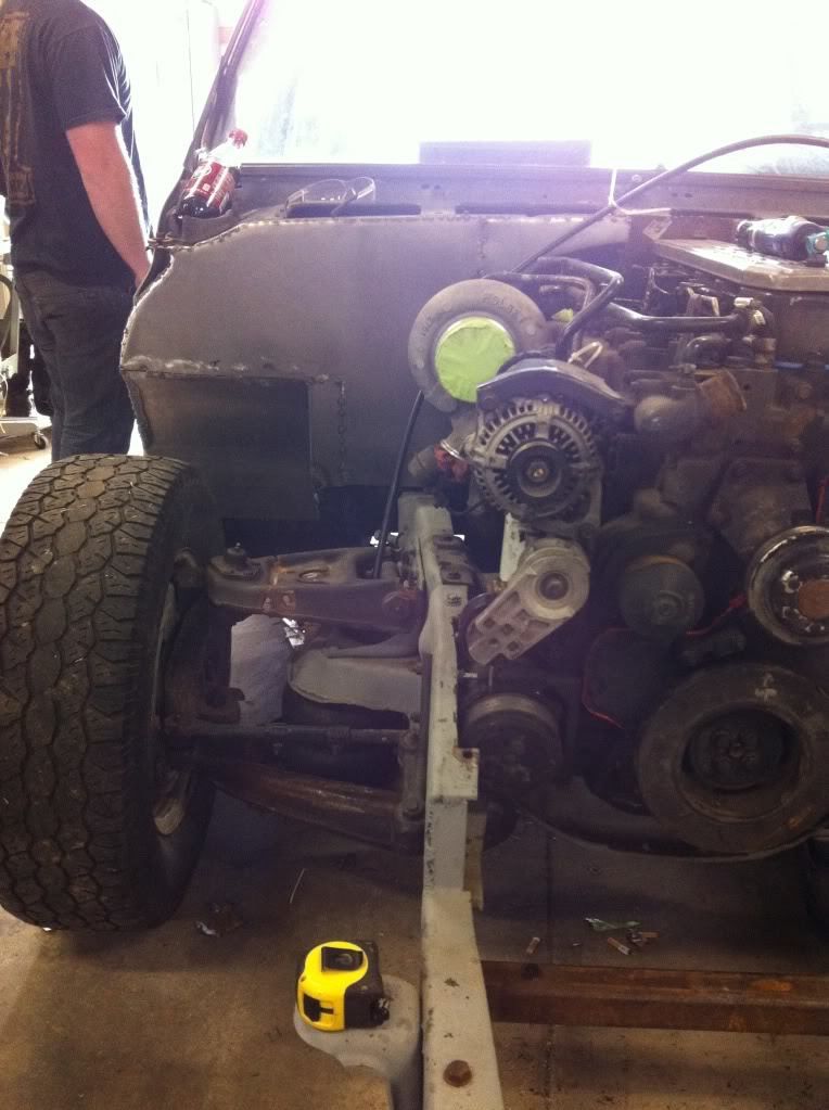

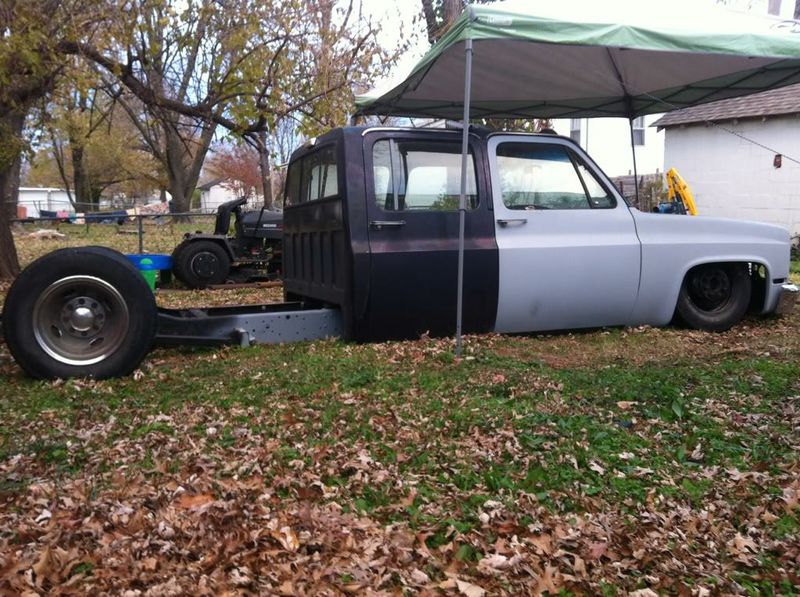

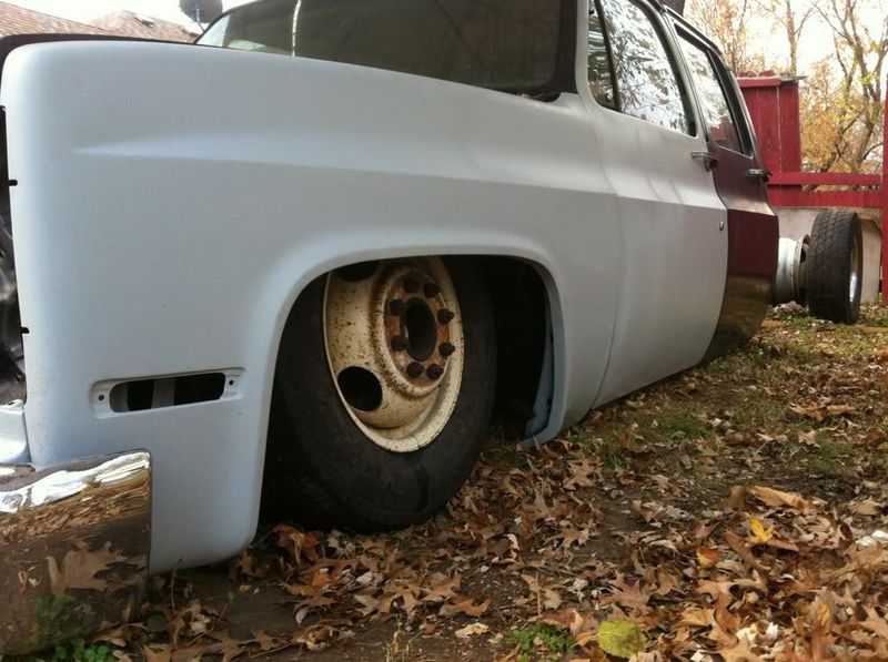

Well the Dually is in pieces once again and I really don't have many good ones but ill post a couple that I have on hand. I basically setup all the bags, did the body drop, and mocked the engine and trans up along with everything that goes along with that including build a trans tunnel and driveshaft tunnel just about big enough to use for a center console lol. Now that all of that is done we pushed it back into the shop and started stripping it back down. We're going to finish weld all the new chassis sections, paint all the chassis and suspension, paint the firewall and cab and put it all back together for good. Anyway here are a few pix I do have.
This was right after the cummins got set in it and we were making the floor pan.
The huge driveshaft tunnel
Getting everything done on the cummins swap
Doing the firewall
That's about all of the random pix I have on my phone of it lol. Gives you an idea of what it'll be when done anyway. The cummins got a healthy stack of go fast goodies before I took it out of the donor truck so it should be ready to go as soon as everything is painted.

The only real hard parts I may replace is my front bags. Not sure yet but I may move the ones from the back to the front and than use a set of chassis tech denominator II 2600 pound bags I have laying around for the back of it. I'm still thinking about adding some gussets to the lower bars and mounting my bags on the bars. Other than that about all ill have air ride wise is a bunch of old 1/4" air line.
