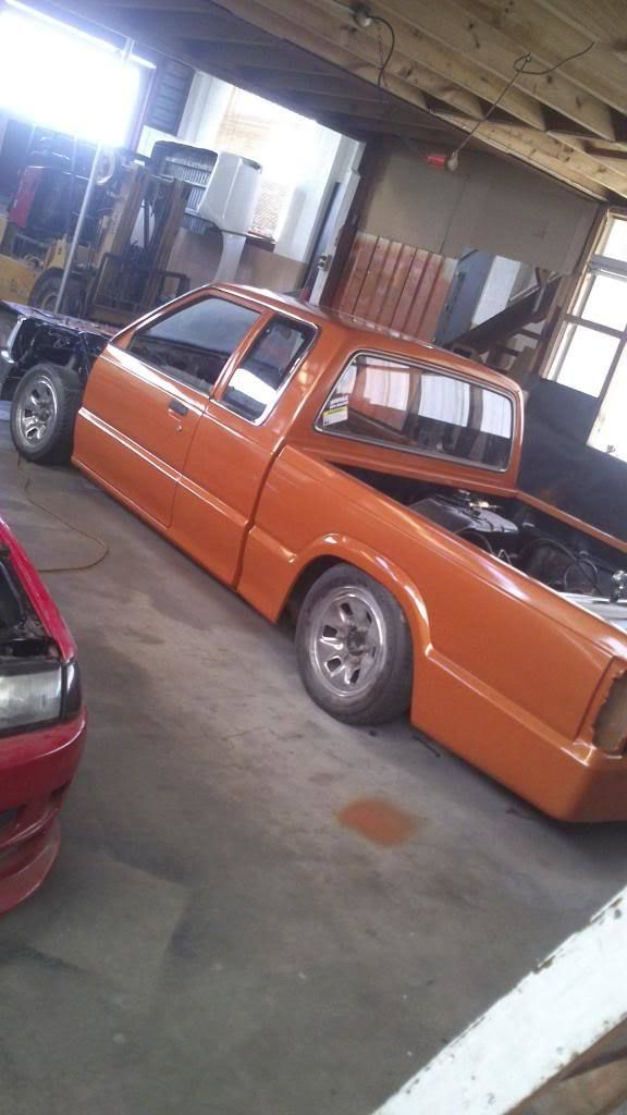

im from New zealand and this is my build thread. its not a mazda but still same family Ford courier

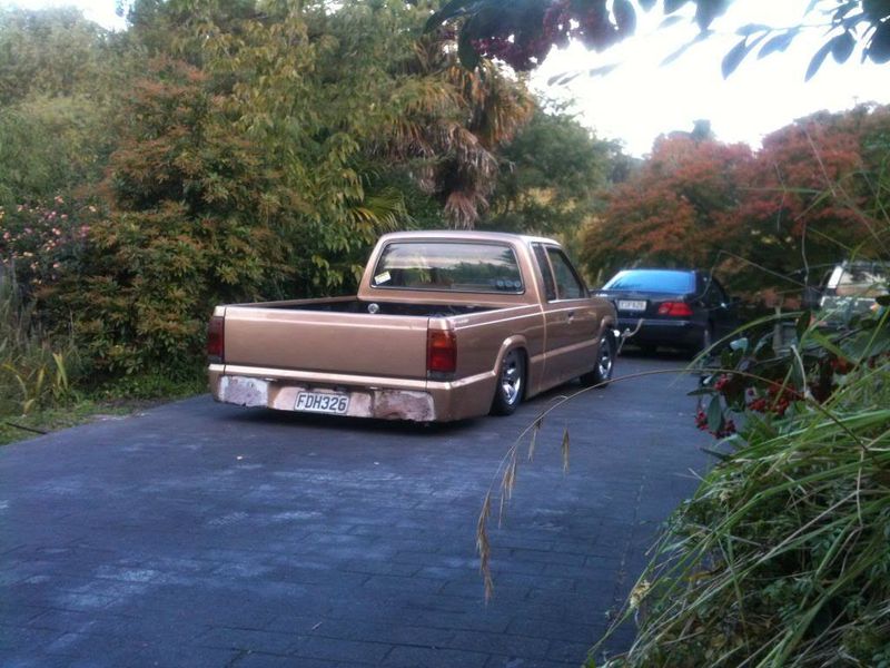

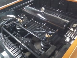

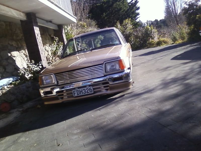

i brought it bagged with standard 2 litre engine paint was custom but average condition and same with the interior
droped main bearing in the ute 3 years ago been of the road since but been through a bit...
started of looking like

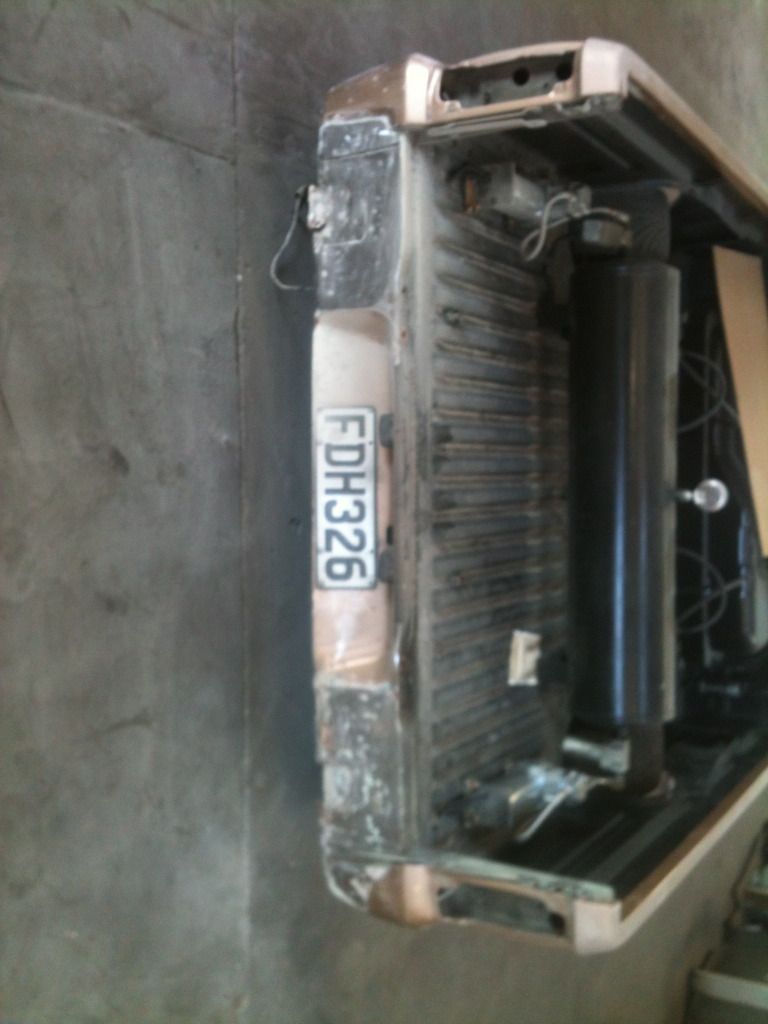

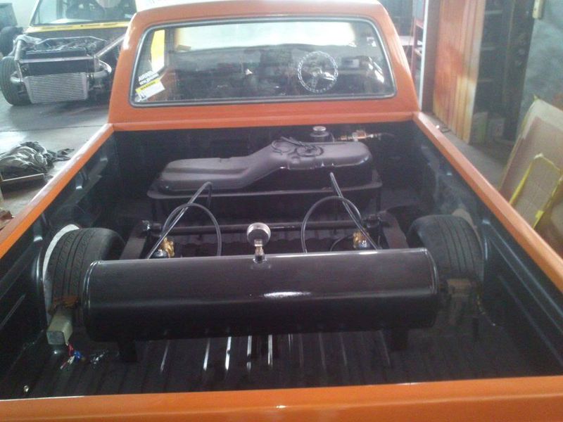

rear, seen bit better from cats eyes

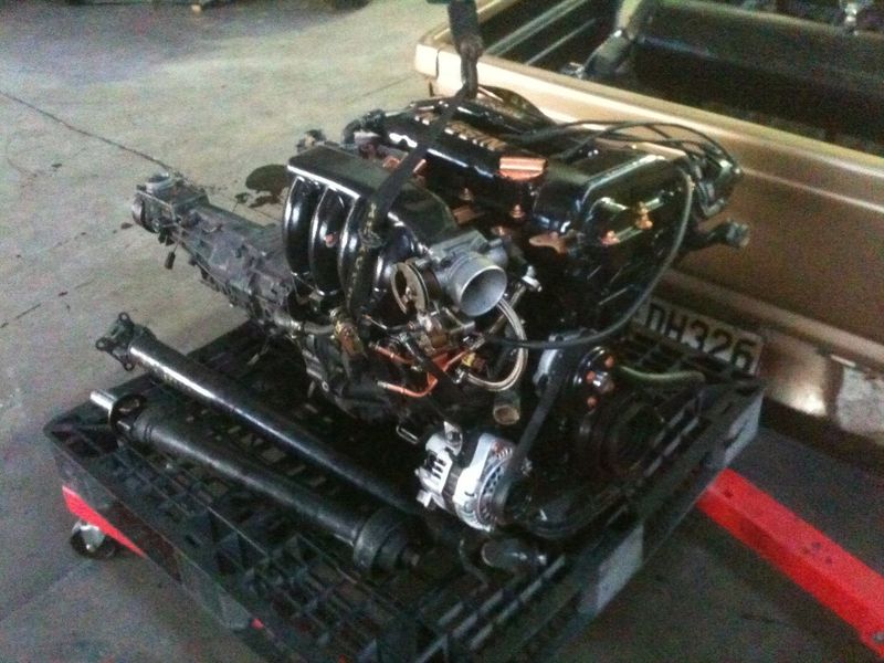

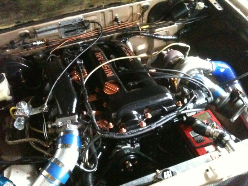

after bearing going i had always liked the sr so i ended up putting an sr20de+t in ute, pics as follow of stages
sticker i found on net =)
pretty much how it ended up but then was quoted $3g to finish it as for tuning cert etc so i found a better option .....
package up the sr

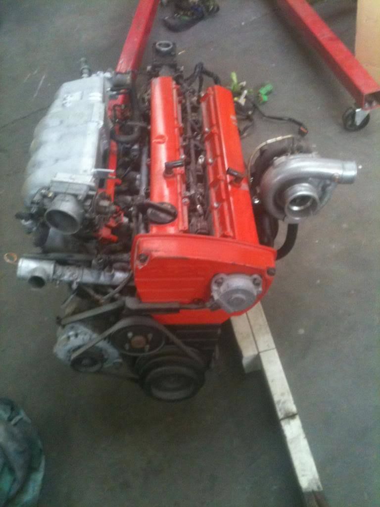

and replacement with the rb

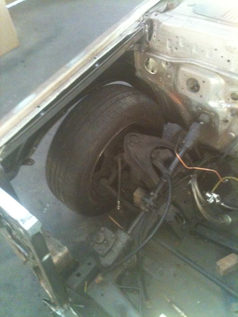

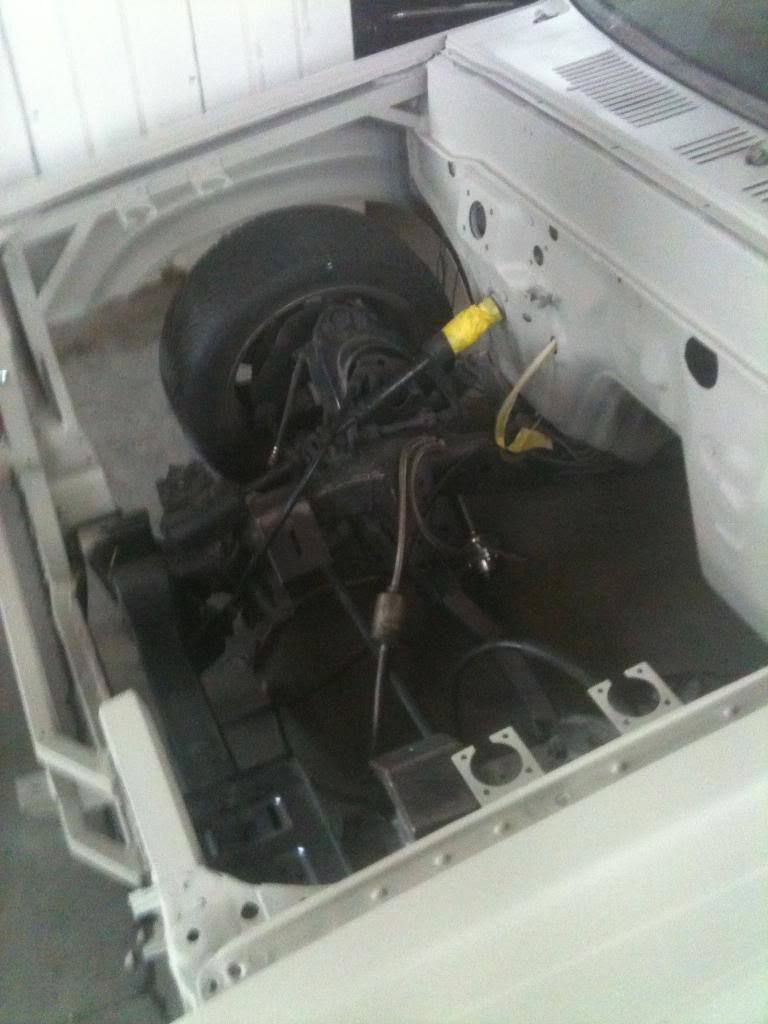

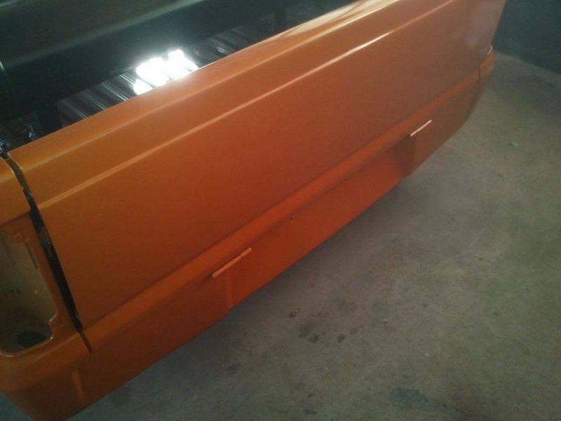

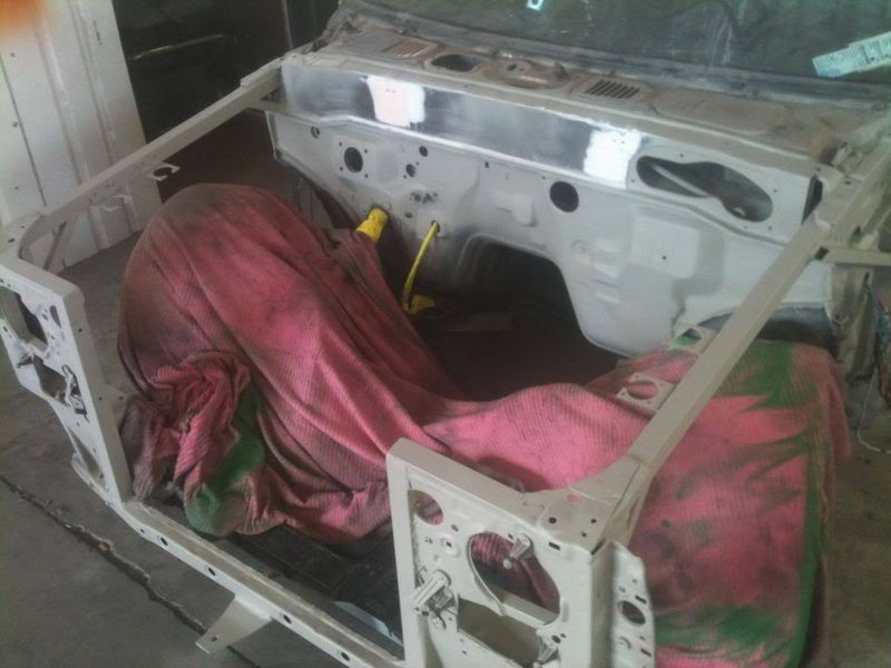

after the sr being in and the old engine the paint was looking shocking including tailgate shaved hande poping through, fuel flap shaved poping through, were old bumper mounts looking ugly and dents so took it to my mates workshop were we got stuck into it

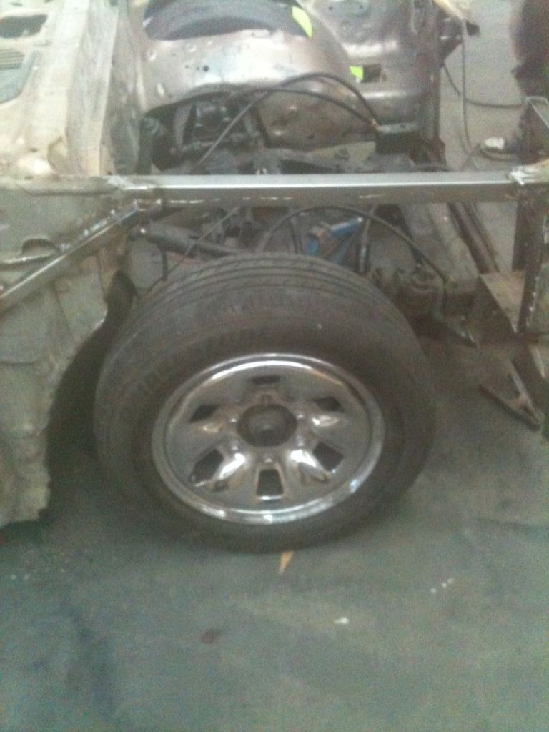

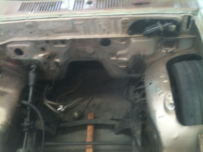

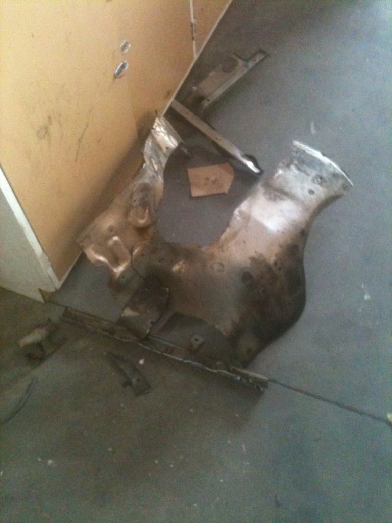

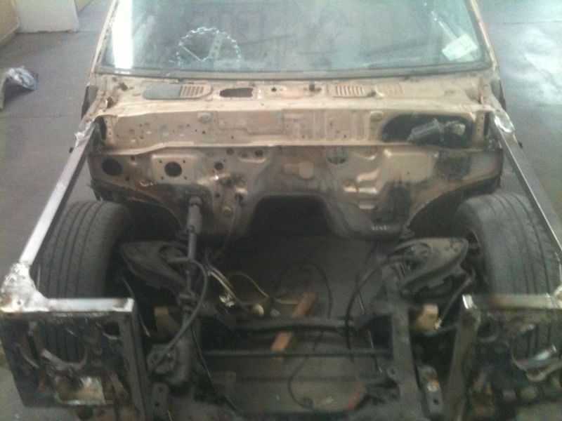

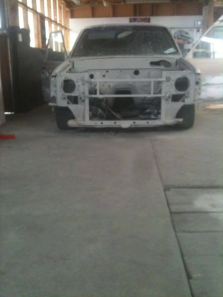

hacked out whole front and started front box section
final result

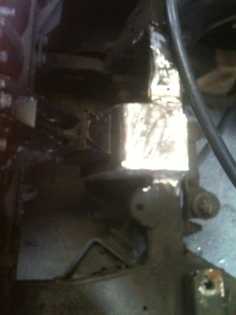

made new engine mounts 7mm plate steel

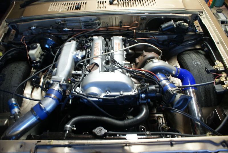

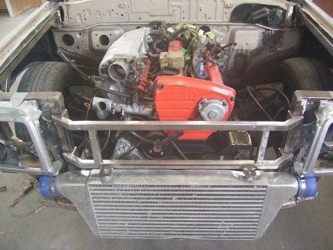

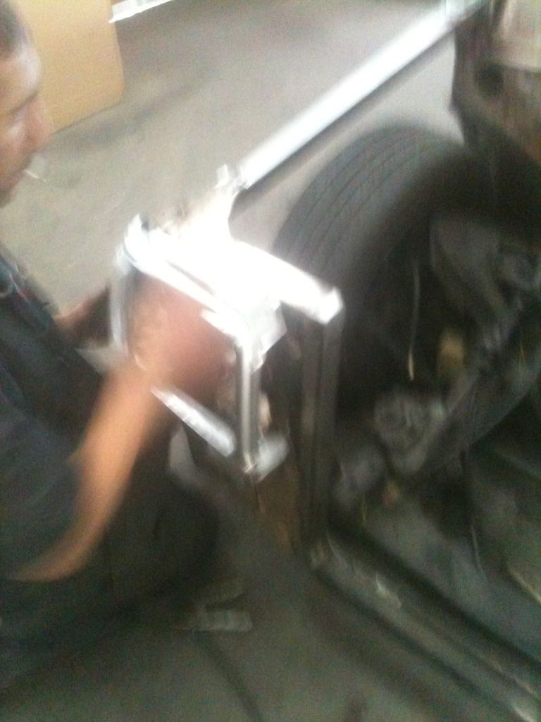

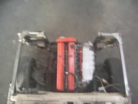

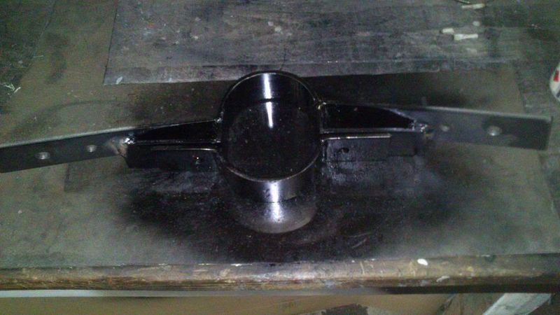

as rb sticks out bit more than sr had to cut of front and make up a new radiator mount and intercooler mount as you can see engine test fit also

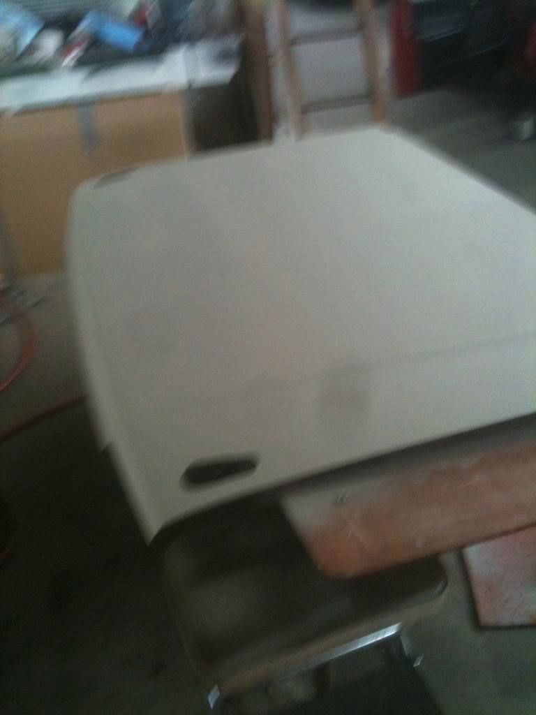

bonnet primered and cut out for flush mount locking bonnet pins

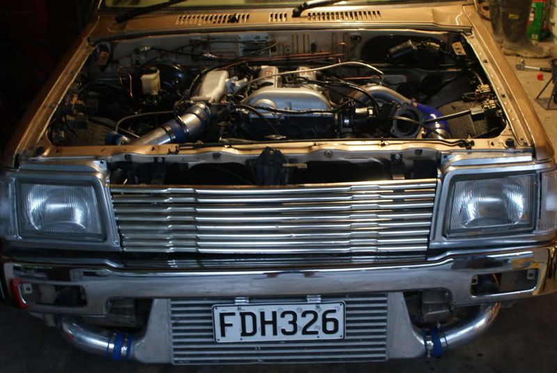

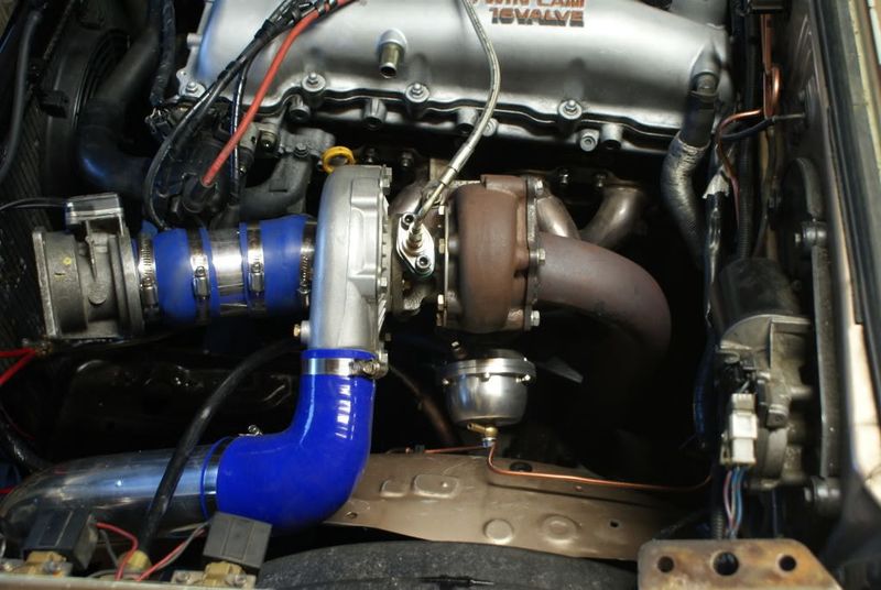

new manifold for engine pretty stocked, brand new t04e and 38mm tial waste gate

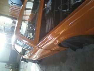

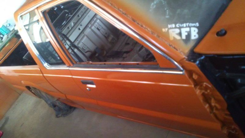

first body paint just done clear, (sorry have none that i can find pre clear)

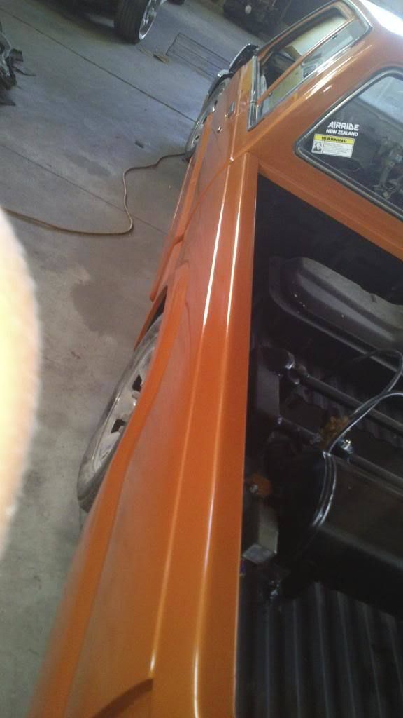

rest of ute painted...

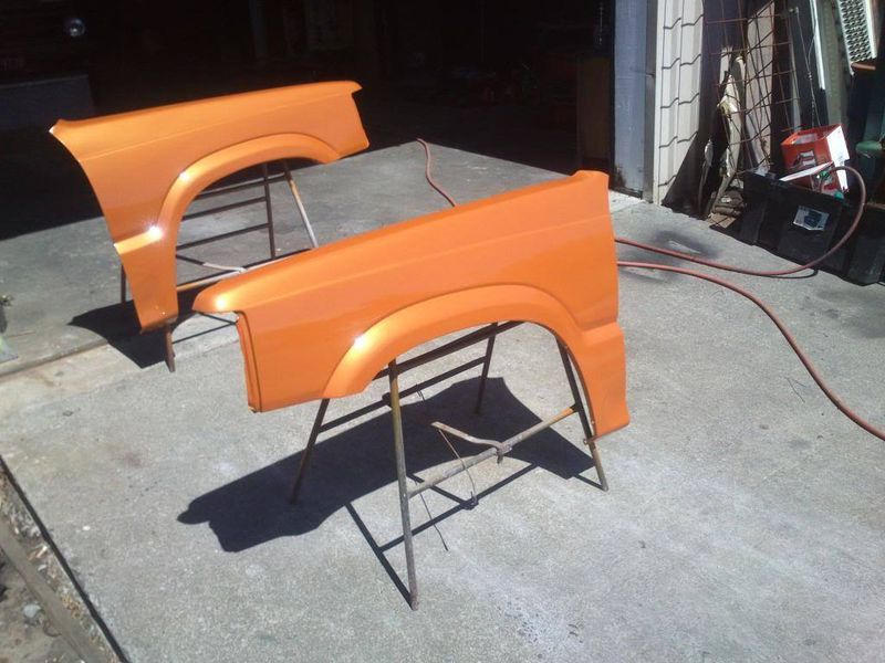

guards fresh paint and clear

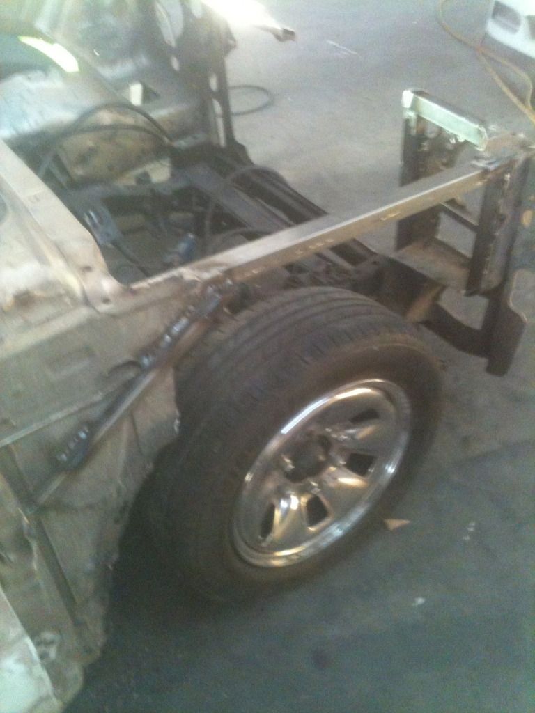

rear end, as from previous pics have fixed rear have put box section bar right the way around for strength, have a pic bit later

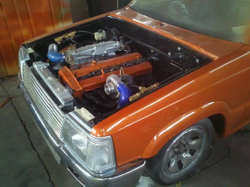

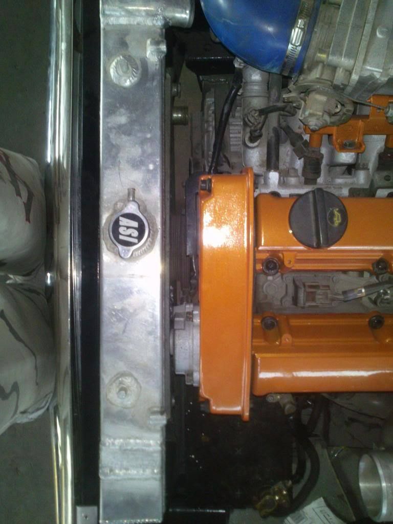

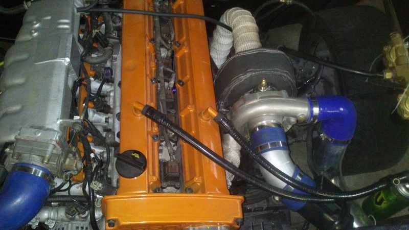

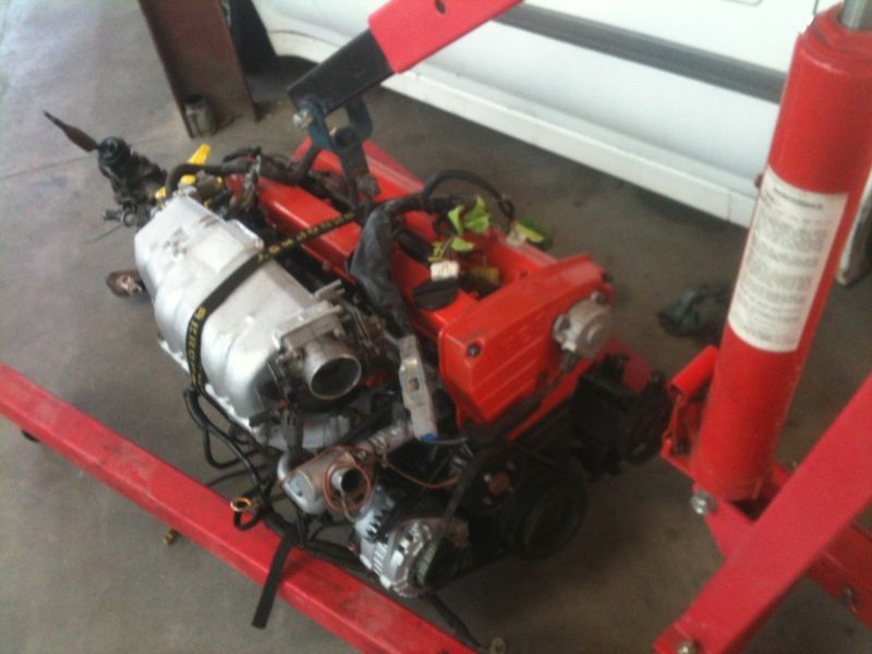

engine in and painted cam covers, fuel rail and belt cover

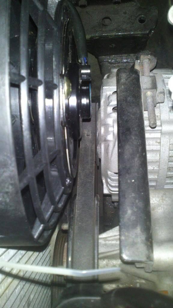

showing gap between front of engine and radiator, very close but still going to work =)

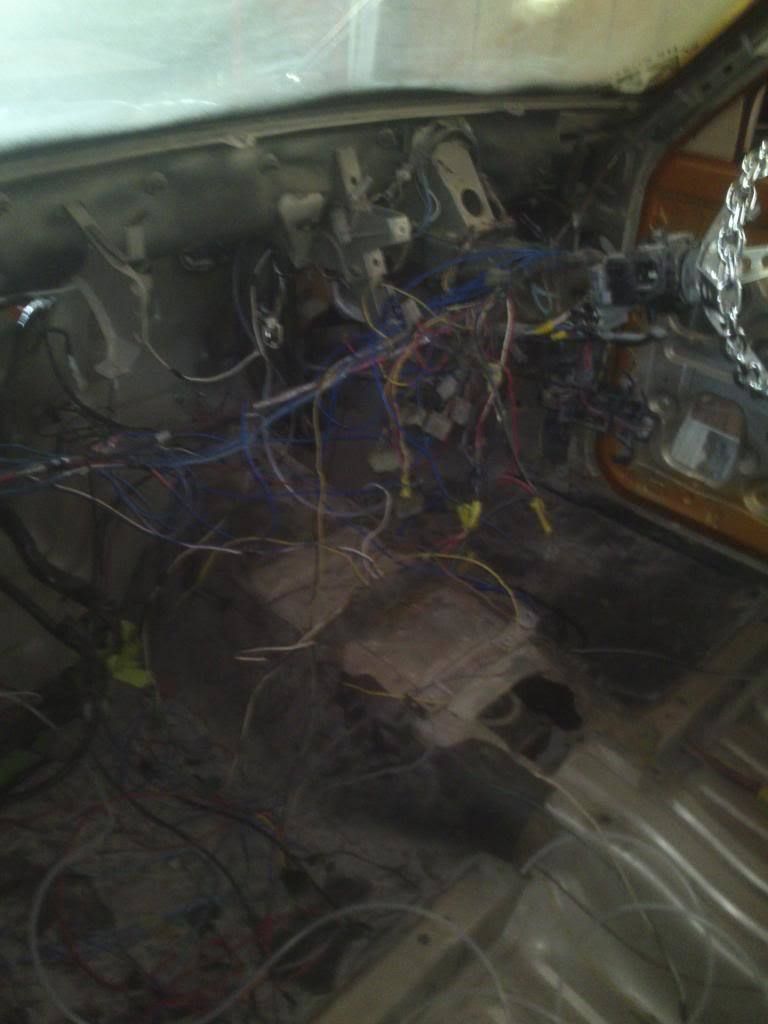

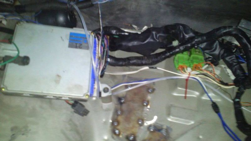

the wiring mess i had to tackle with...
got there adventually managed to position and wire in new rb loom and edu

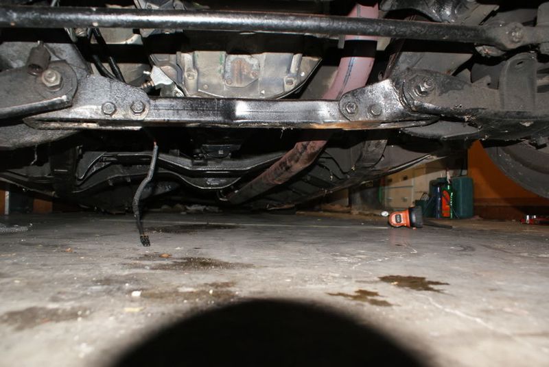

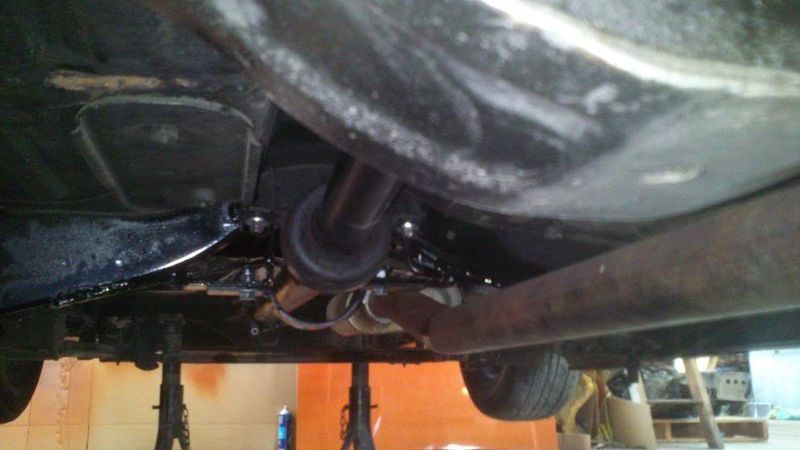

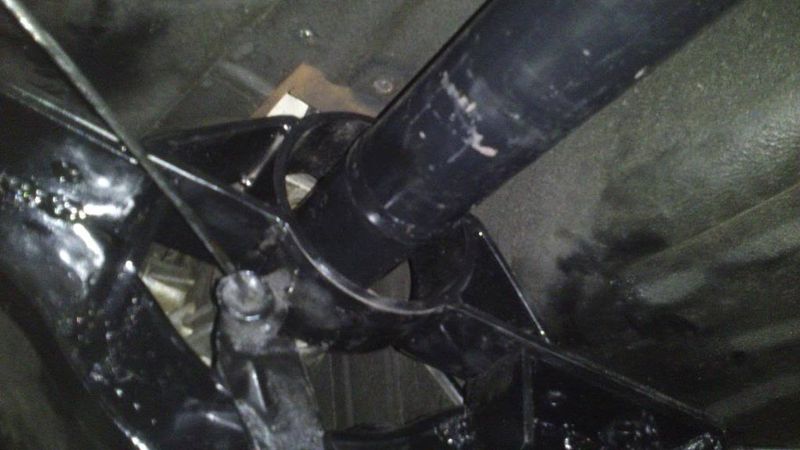

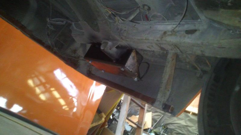

have been working on geting under ute finished so can all be ticked of. fixing break lines running drive shaft and doing the safety hoops. these have been a c**t and tricky but managed to make them
front hoop
rear hoop just been made
just have to finish break lines and get bolts for hoops and under neath will be complete

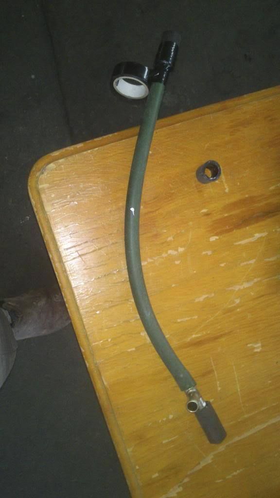

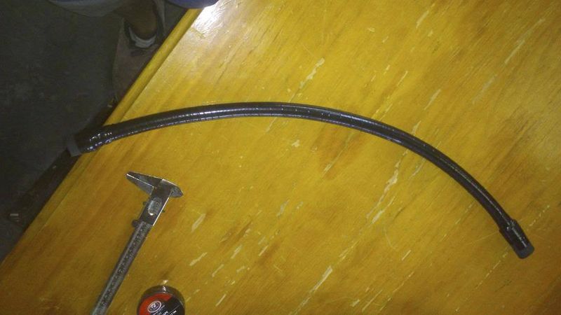

have my "V" energy catch can for breather 16mm inside diameter is quite expensive so found a cheaper way to do it from mate and looks good
old garden hose. finished result

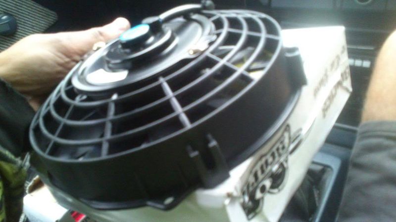

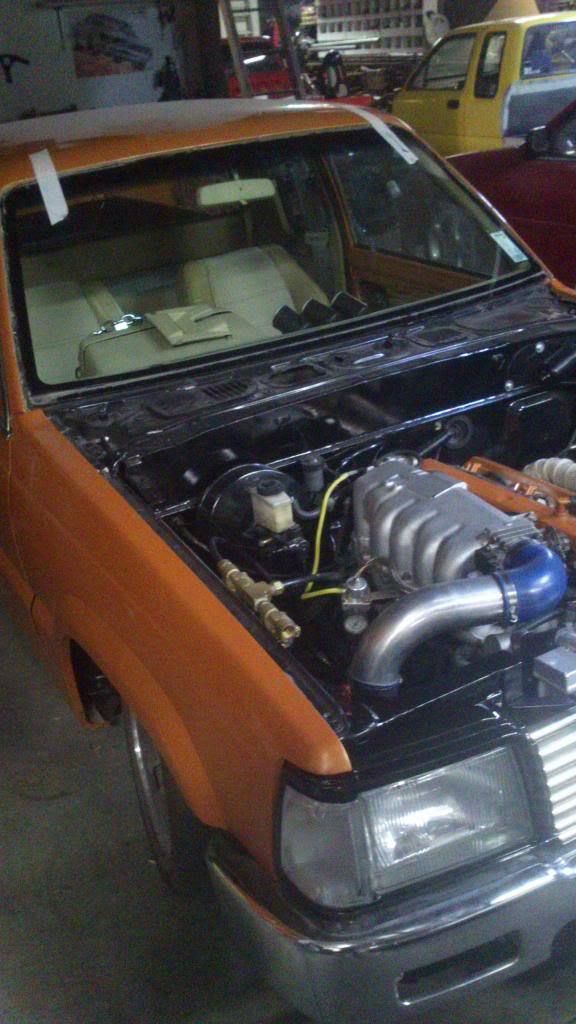

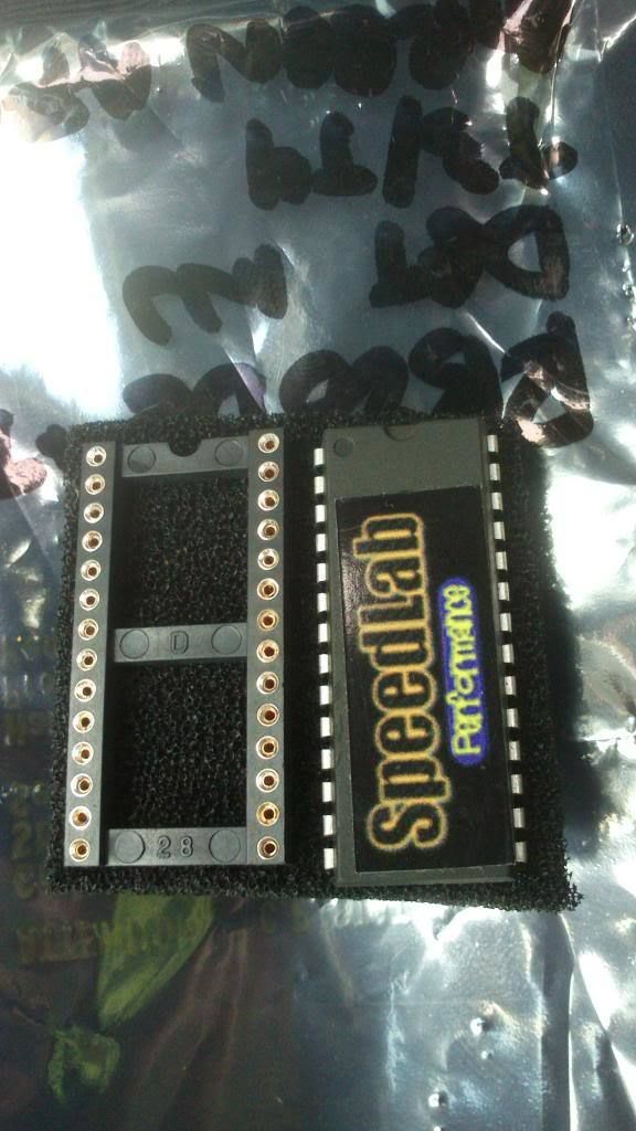

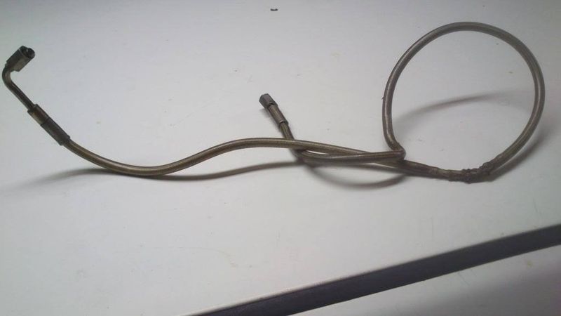

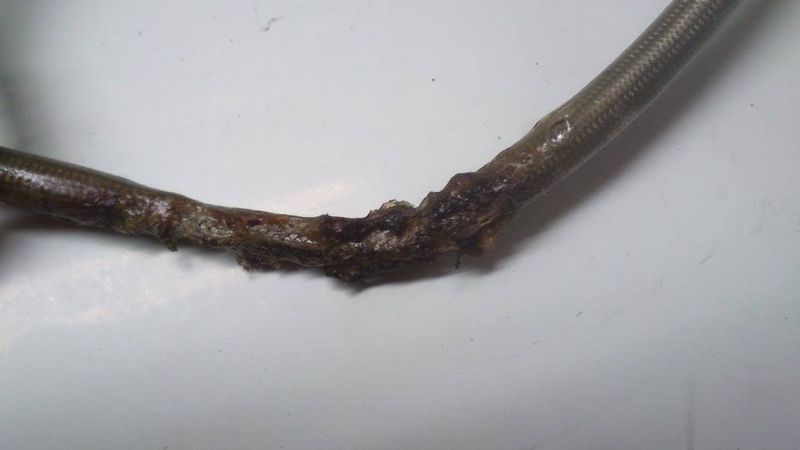

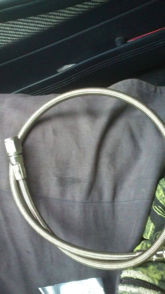

decided it was time to finish all of my under carriage all drive train etc so that i could take it for a test drive. but had a few problems. stalling when boosting, running to hot and melting oil feed line so was time to fix the problems. done a bit of shopping and got Turbo Timer, electric fan, New feed line, turbo beanie and a chip for the ecu.
Just got it all back together just working out idleing brought new spark plugs so just about ready for another test drive. Also just got window put in tonight. heres some pics anyway and a quick vid before chip was put in =)...

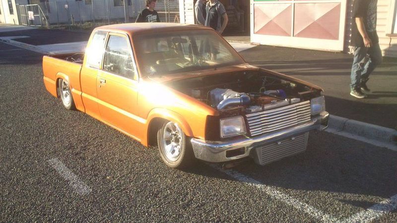

first time ute got sun since painted =)
