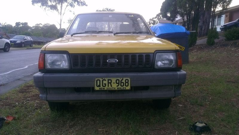

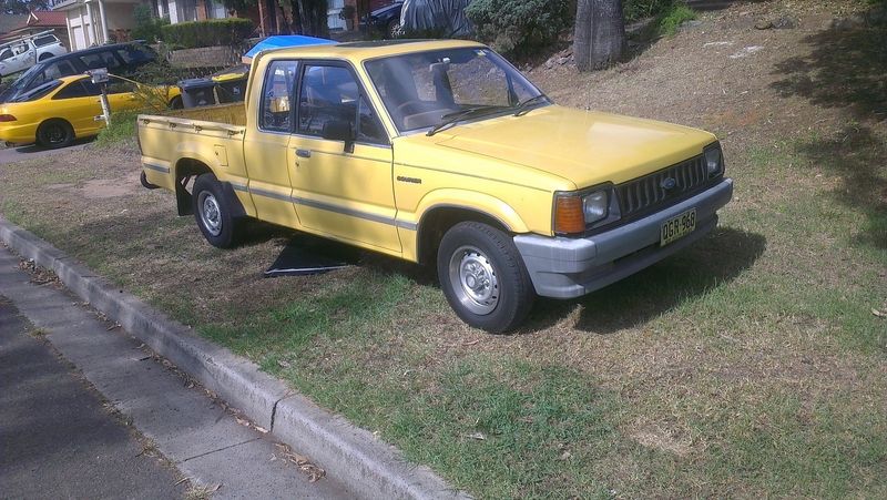

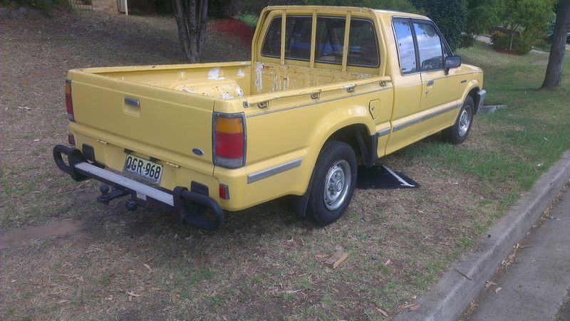

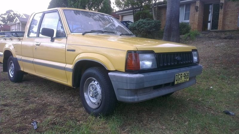

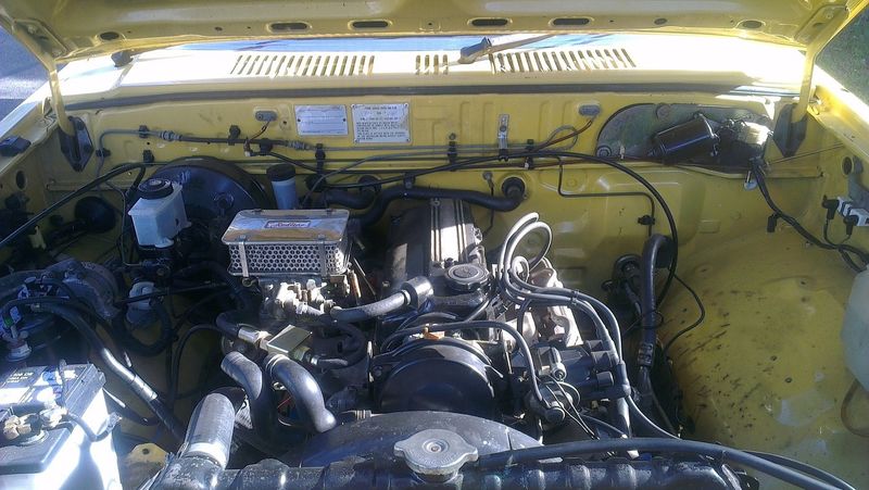

So I decided it was about time to get a new build thread going for my newish ride.
I picked this one up a couple of months ago and have been busy sorting out a bunch of mechanical issues, now most of that's sorted, I'm starting on modifying what was up until I got it, a very original ride.
So far I've overhauled the ignition system, overhauled the clutch hydraulics, redone the rear brakes, fixed my faulty fuel sender, got the air cond working and changed the gearbox oil.

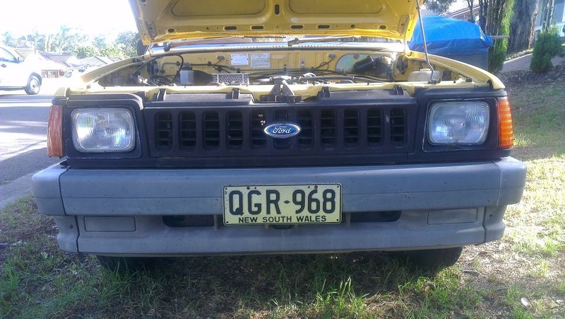

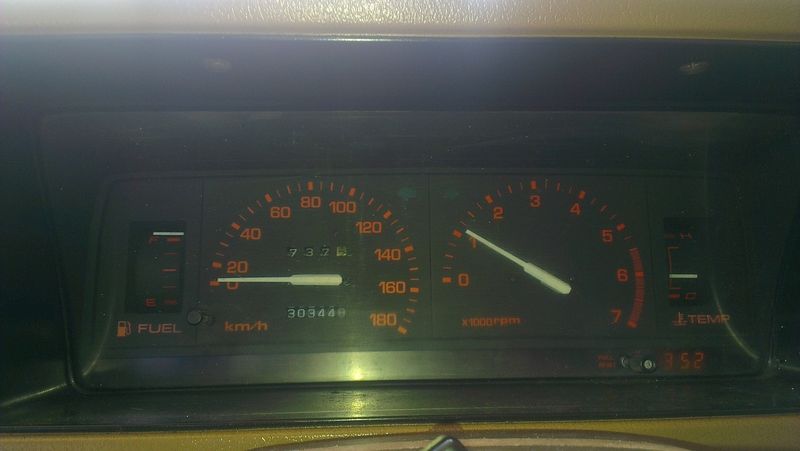

Also put in a new head unit as the factory one was stuffed, ditched the factory carby and fied a 180 Holley (weber 32/36), fitted a tacho cluster and last night fitted up my raider headlights and painted my very sun damaged grill plastics.
Plans are to keep it static, with reset rear leafs and drop lca's, 4x4 sheet metal and 18s, tinted windows, and something close to factory colour.

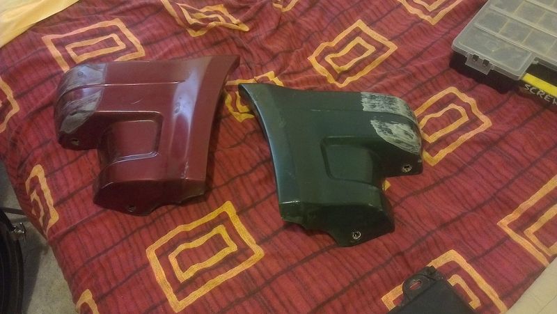

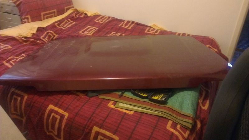

Hopefully now this is sorted I can go back to the body work, I have a raider hood (like a courier hood with a b2600i bubble), 4x4 front guards and bar ends all to be painted and fittedaas well as my pajero 18s.
