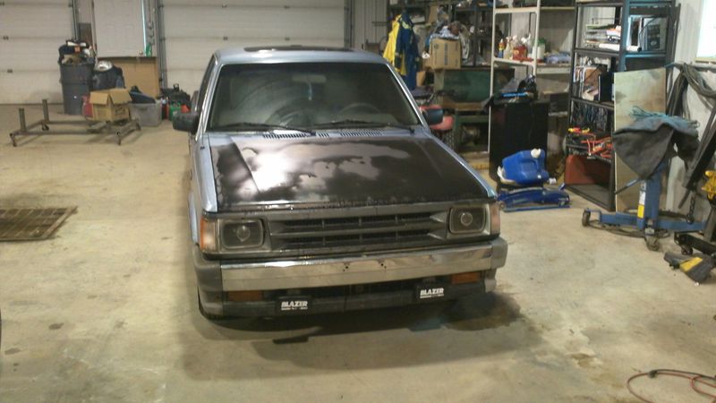

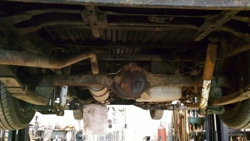

Bought a lowered 2200, converting it to a drift truck this winter.
drifttruck's avatar
drifttruck

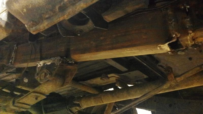

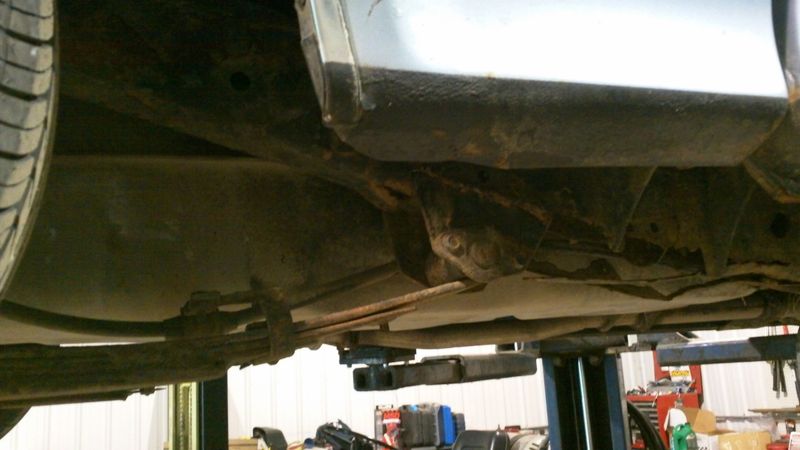

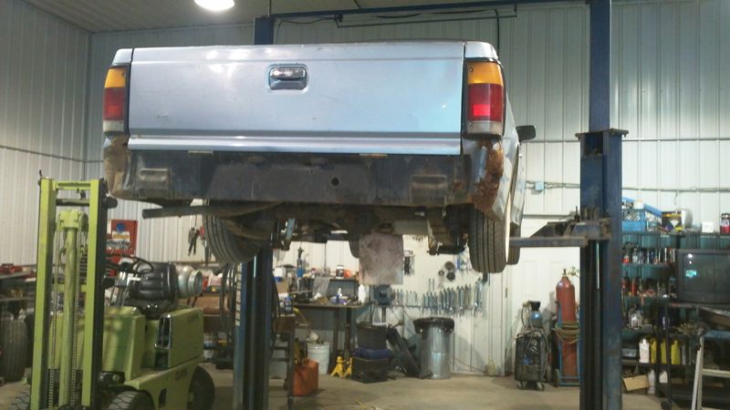

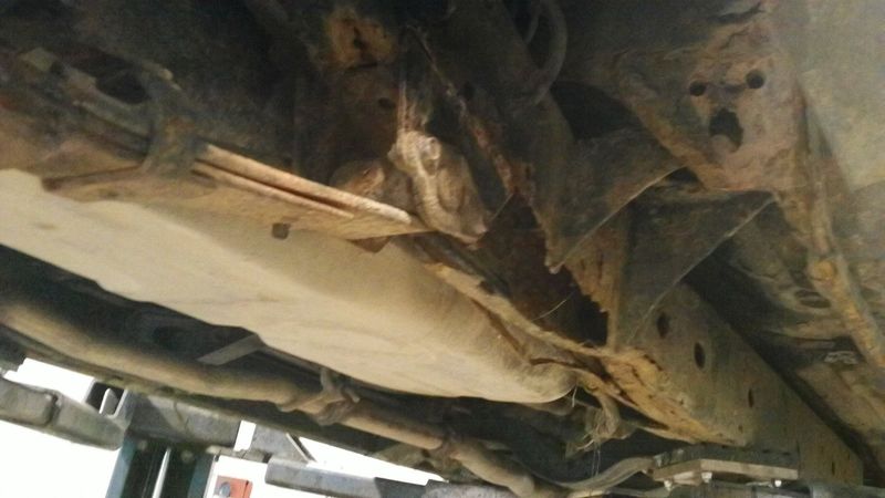

All that I've been able to do so far as i've had it a mere 2 months is fixed some rotted frame and welded the diff. I barely made the last drift night of the season, with a stock engine and bad suspension, didn't do as bad as i thought.

Cut out about 18" of the rotted frame and replaced it with 3/16 HSR tubing. Much stronger than the original frame, not sure what gauge but it was extremely small.
New rectangular tubing installed.

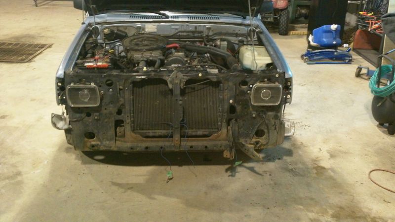

Weird? Thanks for mentioning this. I pulled the engine today and have pics yet unposted. Would you happen to know if there is a thread or someone who has installed a fuel injected V8? All i can find for engines is the fuel injected 302 but that is supposedly a nightmare to wire. Any advice?
Could do coilovers here or possibly replace the leaf with a heavy leaf acting as stiff suspension.
All I could pull off today. Going to pull the engine for a 302.
