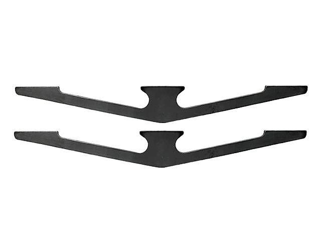

you can invest in some 4-link bar under gussets as ell. they make it so the bars dont bend when doing a bag on bar setup. they run about $35 and vary in size from 16"-34" long.

On 2x2 1/4 wall u don't need gussets... It won't bow... Bag placement is dependant on a number of factors... What u are trying to accomplish, what u have to work with as far as packaging ect... There are almost always some kind of tradeoff... I'll give u what I think about..
