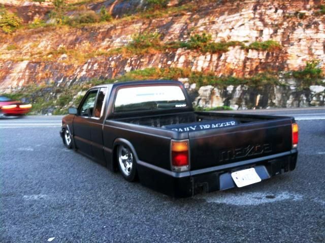

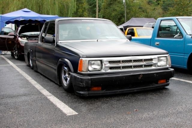

Here's some starter pics from Heritage 2k12 this weekend and I'll go from there with my rebuilding this fall/winter.

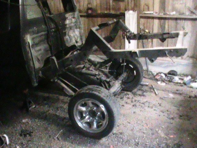

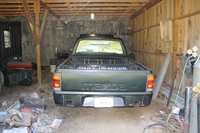

Alright, another update. Got a plan nailed down for the back half of the truck. Going for an under the axle frame, 4 link, custom tail light in frame, custom gussets, blah blah blah....i used crayon to draw it out, so no I won't be posting my measurements and blueprints hahah. But here's where I'm starting.

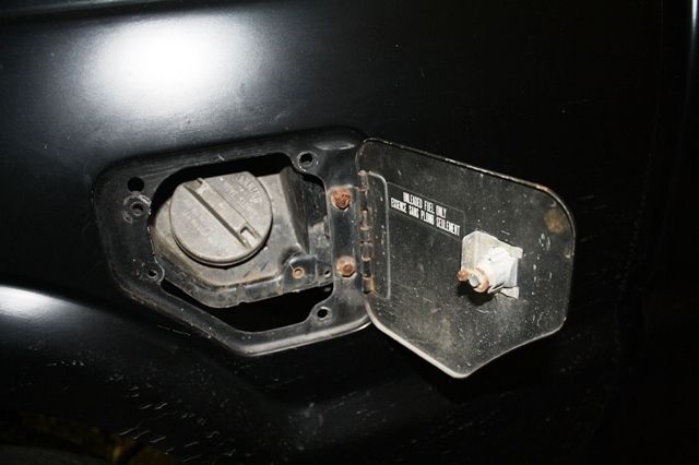

I started by removing the bolts in the gas filler door.
Then, I moved to the 4 bed bolts that were actually in the truck, there are six though. I just took a few shots for sake of doing it.

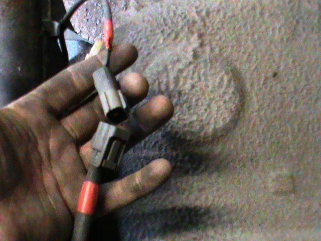

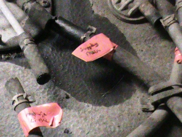

Then I pulled the tails and labeled the harness and removed the bed. No I didn't get pics, camera was being a turd. After the bed came off, I started by labeling and color coding plug ins.

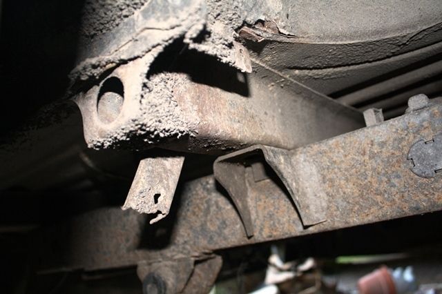

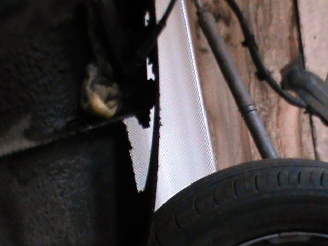

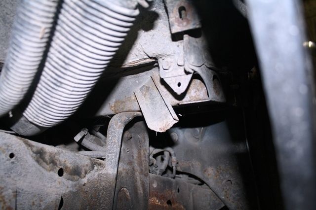

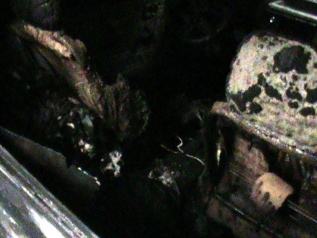

In this picture, what the heck is that brake thing????

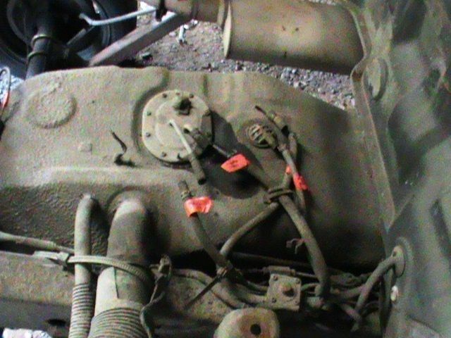

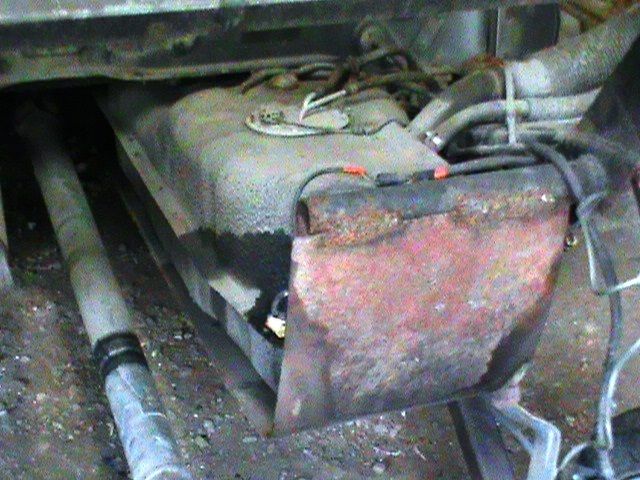

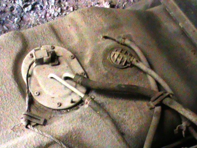

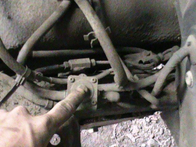

Then, I started figuring out the hoses for the gas tank that leaks...

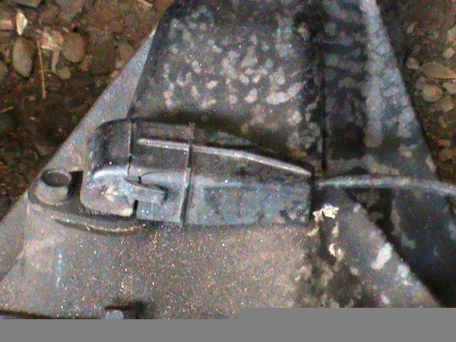

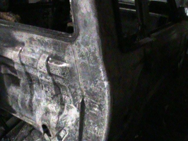

What the heck am I pointing at?
And what the heck is that on the rear end?

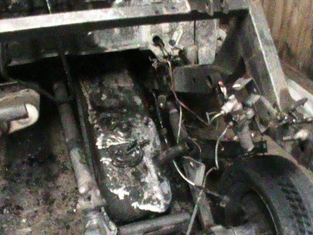

The fuel lines all labeled and cut away from the tank.

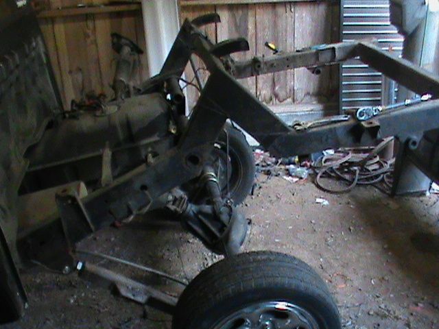

Where it's at right now. I have to cut two welds with a sawzall and then cut the tubing that holds that ghetto skid plate that the tank is actually bolted to so I can get the gas tank out. Then it's just ditch the exhaust and I'll be able to start cleaning up where I intend to put my initial cross member that the frame will be built off of.
emjay
that thing that you are pointing at is a safety feature. if your truck flips over a check ball blocks the flow of fuel to your carb.
h0tr0d's avatar
h0tr0d
thanks emjay! Fuel cell should allow me to delete that
