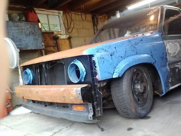

shaved the rad suport painted the lights and just one fender
lilmazda88's avatar
lilmazda88

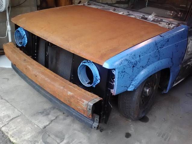

i rusted the hood and bumper but idk if i want to keep it let me know what you guys think..
rocknmazda
looks good. how do u rust the parts??
b22trk91's avatar
b22trk91
Looks good..will look good all rusted is it a primer or monocoat
lilmazda88's avatar
lilmazda88
its just salt vinegar and Hydrogen peroxide over 3 hours every half an hour spray but its just a coat i could scrap it offf if i wanted to or spary a clear over it

i took a grinder to the hood for some texture i was debating for close to 45mins if i wanted to take a grinder to my hood but a few more beers and here it is lol

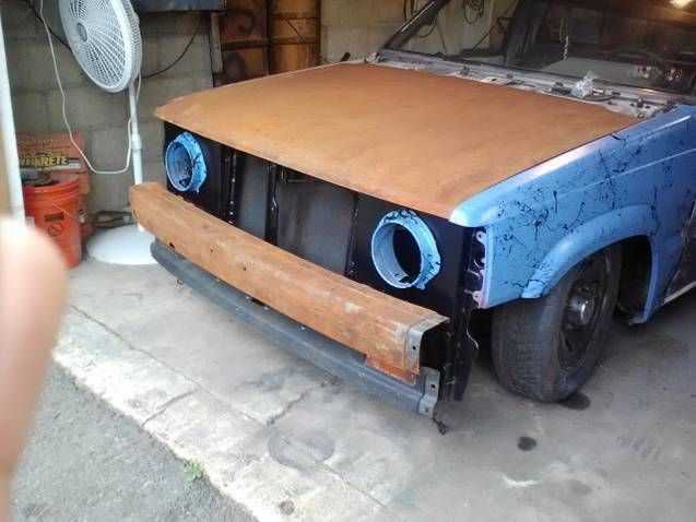

b22trk91's avatar
b22trk91
Its always a tough decission with a bonnet haha...id be rustin her all up clear coatin it would look tough as... We have a rust effect acrylic over here its worth a dime though lol
lilmazda88's avatar
lilmazda88
yea i was looking on the internet and they have almost like a piaint but its like 5 bucks for a 8oz bottle to and it take like 3 weeks for everything to dry so i said @(^$# it ill do what vw do lol
