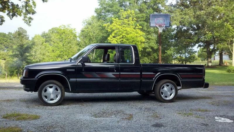

Heck even with it lowered about 3" in the front and 5-6" in the rear, it was quite capable on gravel roads, out in the fields and around the barn.
As low as the truck was it still had adequate ground clearance, everywhere except the long overhang at the rear bumper it would scrape at steep entrances.

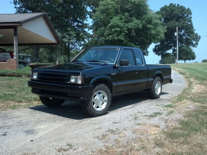

I returned the rear to stock, and reindexed the front torsion bars up about 6" (probably 2.5-3" above stock, remember I was lowered before). Reindexing the torsion bars up is the exact reverse of the how-to for lowering the truck by doing this. Look at that how to, and the direction they tell you to turn them to go down, turn them the other way to go up.
That resulted in this:
That is still on my "little" tires, that are really only about 1/2" shorter than the stock 205/75R14s.

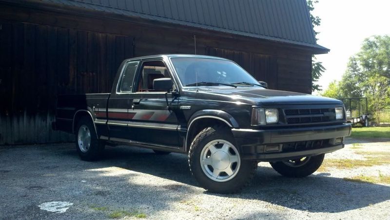

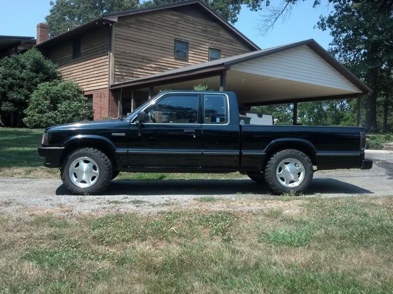

Then I added 205/80R16 Kumho Road Venture MTs. These come out to be 28.9"x8.1".
These are 2.8" taller than the stock 205/75R14, so by tire alone I gained 1.4" of ground clearance. My rearend is still stock, so that is the only clearance gained there, but at the front, by raising and leveling the front suspension I gained roughly 3" plus the 1.4" from the tires there.
The way my truck sits, my front end is about 1/2" higher than the rear, I plan to add longer shackles to gain about 1" of lift back there (to gain 1" of lift by shackles, you need 2" longer shackles). Remember that adding lift back there will gain you clearance at the frame and body, but the axle still sits in the same place. The only way to gain clearance at the axle and springs is to put bigger tires on. Also keep in mind that longer shackles in the rear will point the pinion angle up, you may need to shim it back down to compensate. Also longer shackles will alter the shackle angle, which has an effect on spring rate, though ever so slightly.
