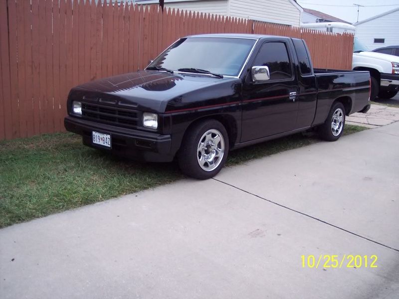

I'm a newbie here (& sort of to mini's also), this is my 1991 Mazda, that my daughter named "Ole' Blue" !lol
I bought it for $1500 the way it sits, I've fixed a few things on it-since I got it.(Exhaust was falling off & the convertor was clogged up/ door locks were broke/oil change/ tune-up/rear shocks & balanced all the tires).
I made those covers the other day, just to close up the holes where the bumper goes....
My plan is to get all the body work done & paint it(Its a 50 footer for sure!)lol , I ordered a chrome grill for it & want to put a toyota frt.bumper on it, the stock bumper on it is shot!
The way it sits now, it has a 3 inch block in the back & just turned down torsions , I think it looks & rides decent, but was thinking of Mono-leafn' the back & a ball joint flip up front(I've been reading the "tech" section on here )....how much lower would that sit it down? & change the ride?
I'll update this thread as I change things on it....

In my opinion, a good compromise between ride and height for a static setup is three inch blocks, remove the center leaf and put some air shocks ($40 give or take at autozone, each). Cut the bump stops about an inch in the rear and replace the front ones with universal low profile energy suspension ones. Reindex the torsions two splines and adjust accordingly. I'm not a fan of removing bump stops and letting metal hit metal. I had this setup on mine for a while, it rode great and I could air up the shocks and put my dirt bike + gear and tools. It was about 2 inches lower than yours. The problem with mono leafing is that the spring becomes prone to wraping.
