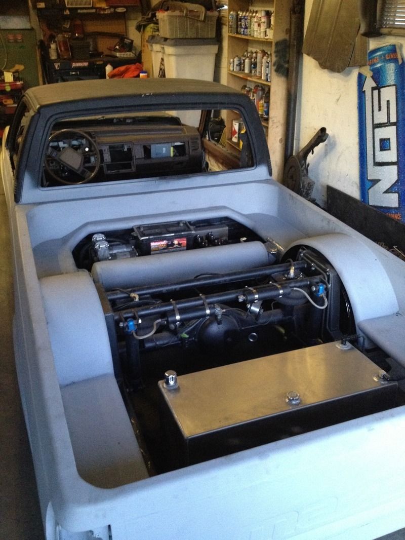

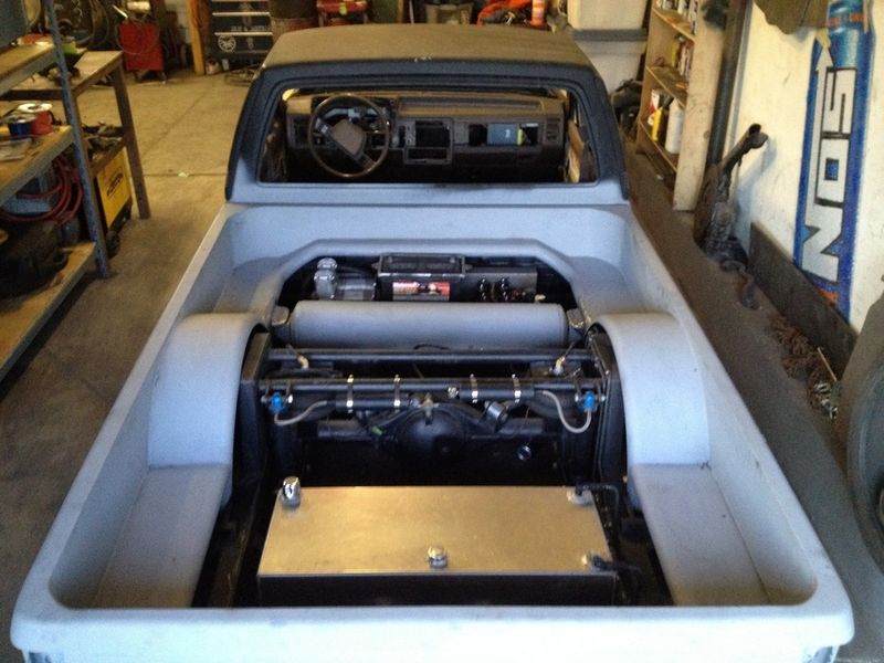

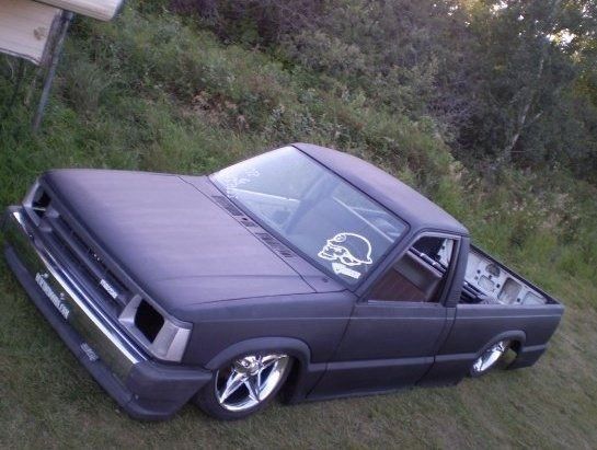

Im new on here, My Name is Dale, from Alberta Canada, and a member of Dropsicles car and truck club, but this is my on going project for the past few years. Thanks for looking!
86 std cab shortbox.

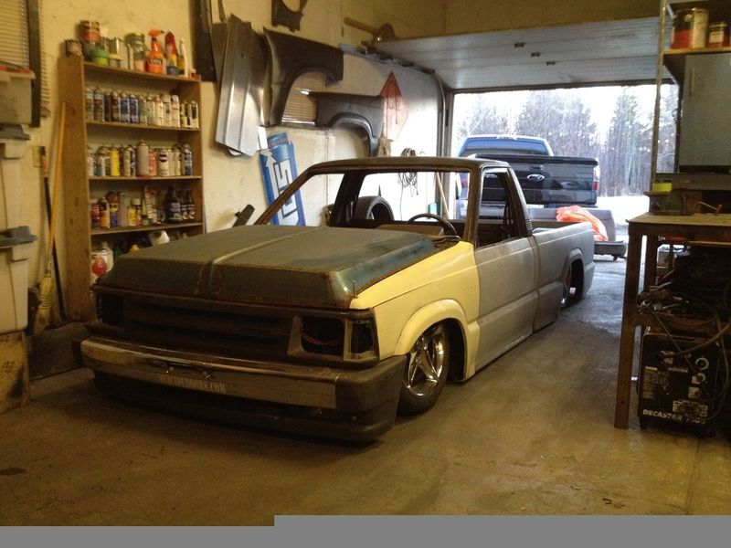

Body dropped 3"- no pinch
Tons of metal work, bed is all metal!
shaved handles, roll pan w/1/4" plate on the rockers on the bed. sheet metal'd bed and tubs.
69 gmc hood, chopped, sectioned to fit.

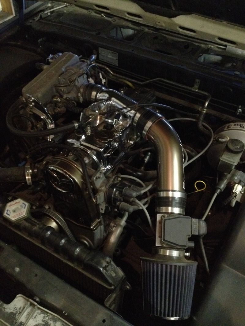

92 FI 2600 motor (painted and chrome)
Ported, polished, cammed', header
5spd trans, centerforce clutch.
Custom Fuel cell. 3/16" alum, aftermarket fuel pump, w/hardline.
Cut and Dimpled alum door panels.
Factory brown bench, carpet,st.wheel.
18" Foose Lusso wheels.
Toyota 5 lug conversion (spindles/rear diff)
All new brakes (lines/calipers/etc)

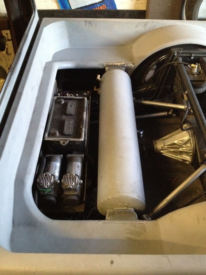

Avs 7 switch,1/2" gc valves,2 Viaair 380 comps.
plumbed with 3/8 copper hard line.
9" C- notch, Air ride Tech 4-link. custom lower
A-arms, and modified uppers. Fox resivoir shocks.
And Much more to come!!

I like the hood its not the norm. keep up the pixs.
beastbseries
hey bro were did u get that intake I've been looking for one for a while now
