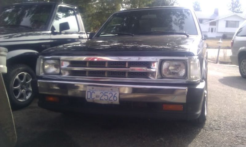

Well, I've named my truck Candi. Mostly due to the fact that this one is meant to be strictly eye candy, and not so much about function. She's a 90 B2200. Here's some pics as I first got 'er.

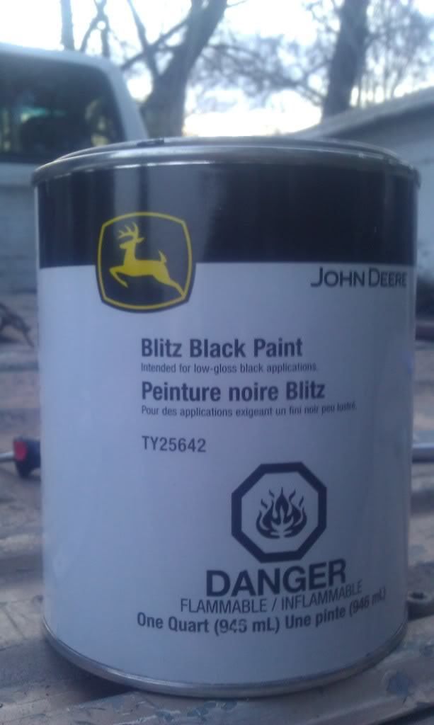

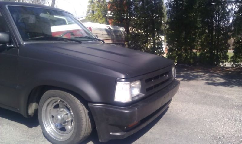

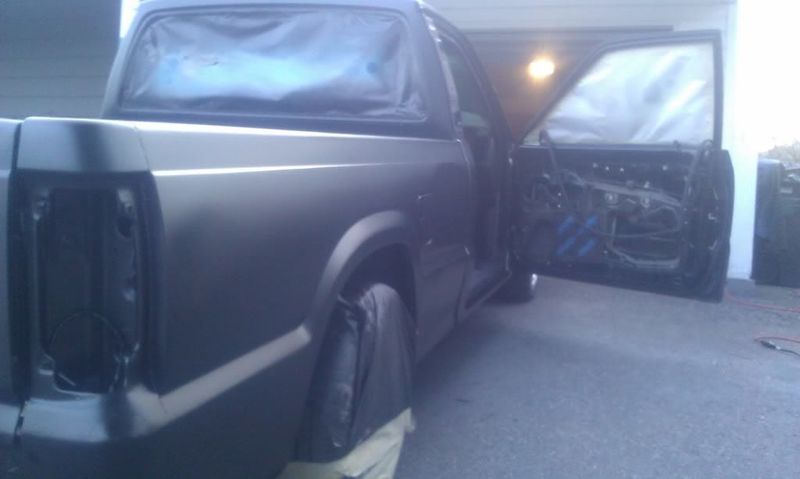

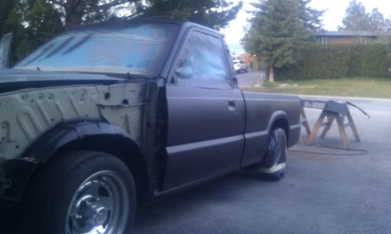

This past weekend, I knew I had four days off for Easter... so I flew at 'er with the orbital and the air sander. Got it all knocked down to bare metal in three days, did some filler work and a little bit of metal repair, and here she sits. I used PPG DP50LF Epoxy primer, then PPG Delfleet Evolution high build, and after that was all done, I went over it with this:

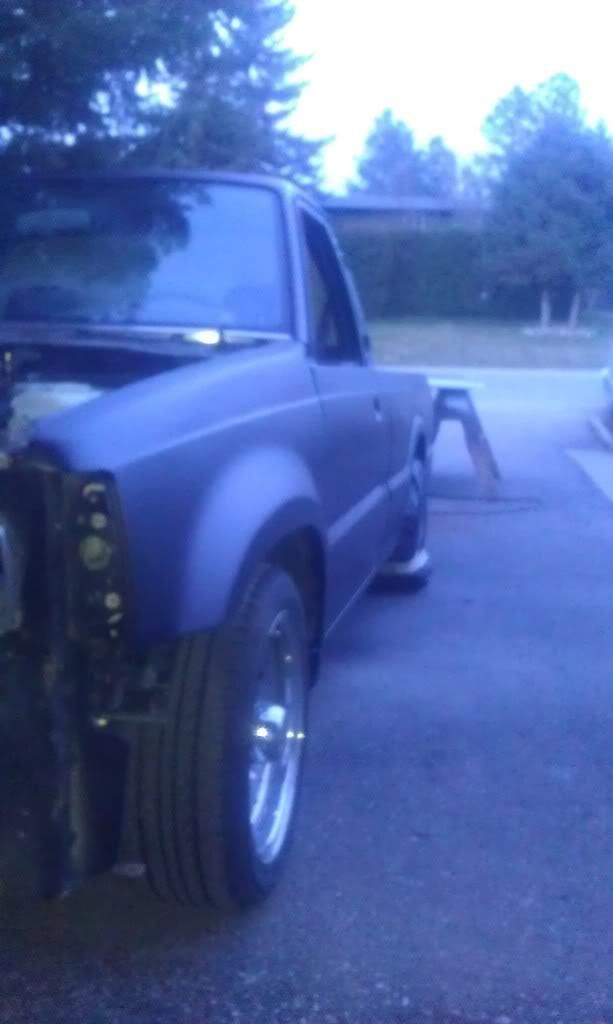

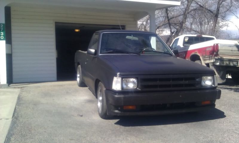

I did it all wet on wet. For those who don't know, wet on wet means spraying everything within the alloted open times, no sanding in between. Worked like a charm, everything laid out nicely. I sprayed it in the driveway, and it was maybe a little cold to be painting (15*C) but I just left everything for longer in between coats. Here is the semi finished product.

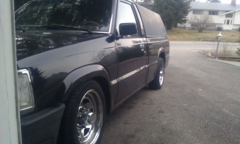

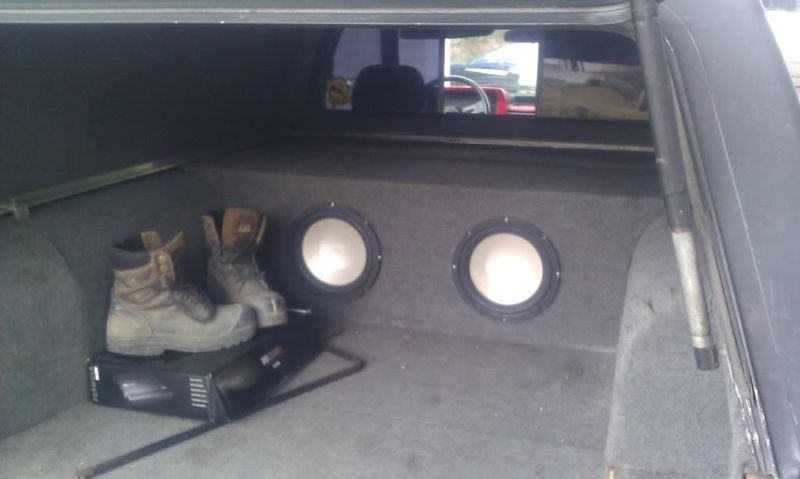

andres629

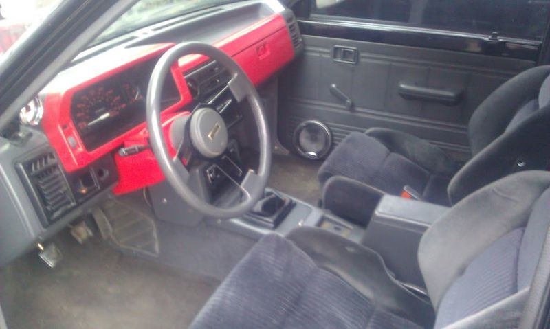

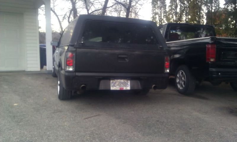

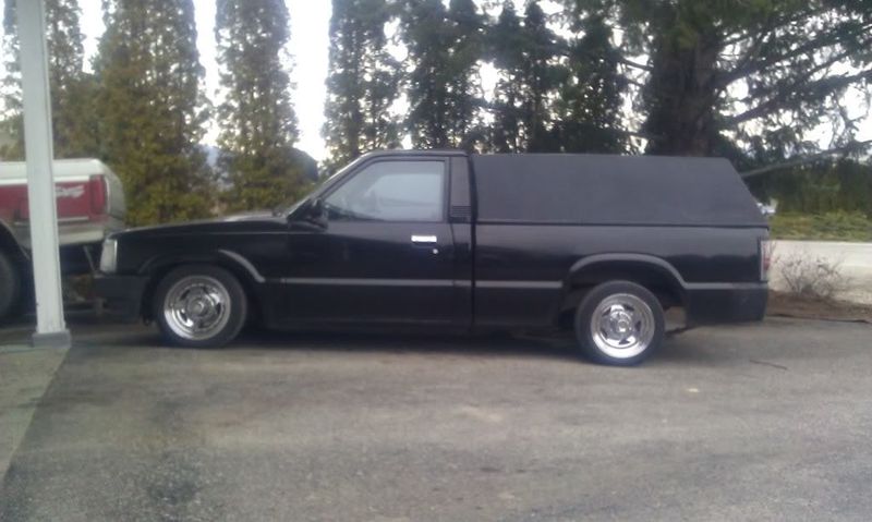

Well I got 'er all assembled today. Minus the canopy and stereo equipment. Honestly, if it wasn't for the fact it sounds awesome, I'd leave it out of there all the time! I love the look of it with no canopy. Anyway, here's a couple pics!
