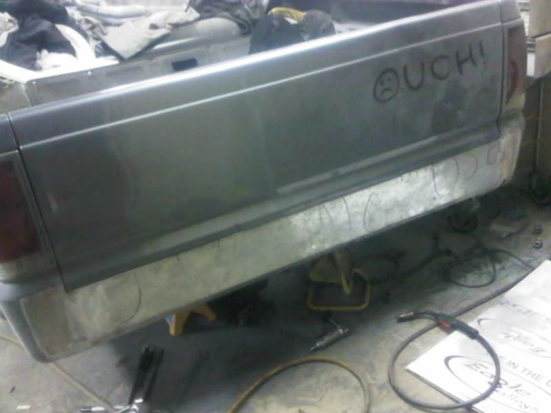

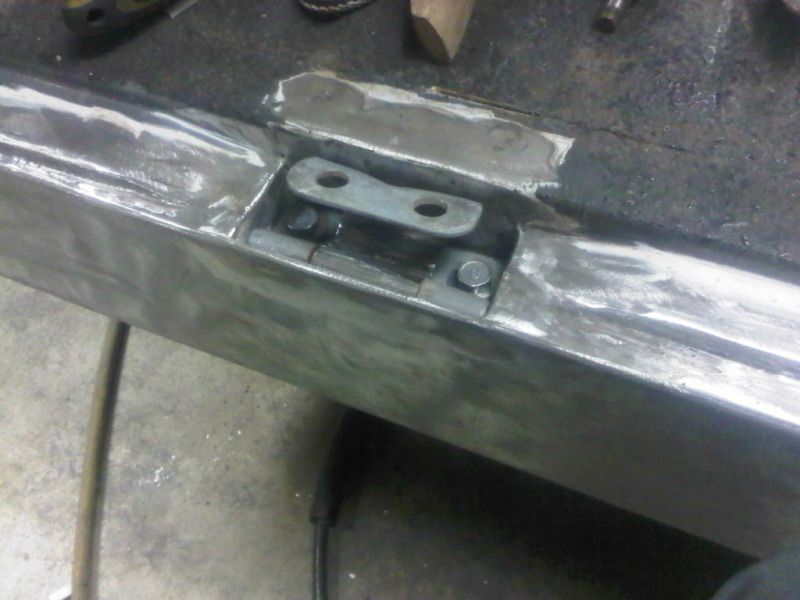

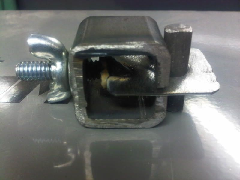

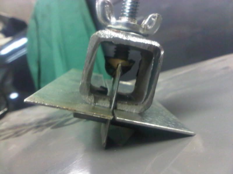

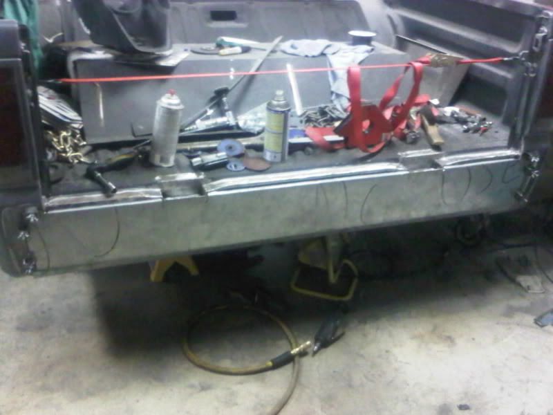

and now im on to the roll pan, but before i did it i decided i would make my own intergrip panel clamps so i looked up some pics and got cutting and drilling and made my own with stuff i had laying around the garage

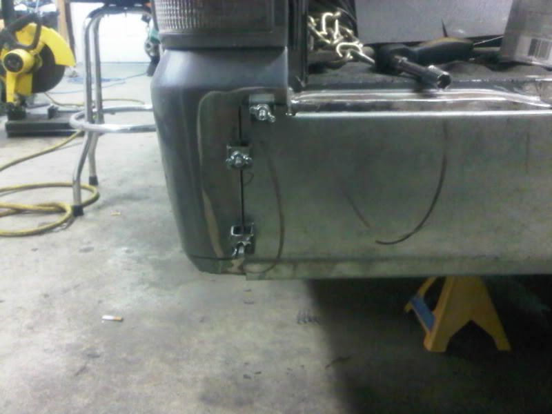

after i finished those it was time to try them out
yes it looks like its not lining up but that was all taken care of before i welded it

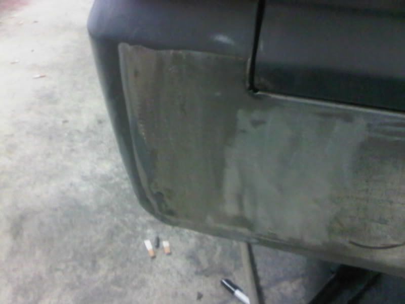

and here is the pan all welded, i didnt finish welding the across the top edge of the pan, its almost done just had to bail in a hurry didnt take a pic but heres what it looks like
all killer no filler
so thats where im at right now it will be a really slow process
when ever im in the garage working on it i will turn on the webcam and anyone that wants watch me work really slow can just click the link
enjoy
immortal1 (linn)'s avatar
immortal1 (linn)
Well, progress may be slow but the quality looks very good! The tailgate hinge is a clever idea for sure. And I can always appreciate less body filler.

That web cam is pretty cool. Looks like you are tac welding roll pan-right at middle of tailgate. SUPPOSE IF I TYPE LOUDLY IT STILL WONT BOTHER YOU LOL.

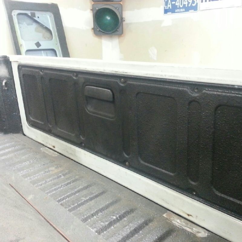

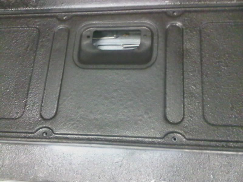

i forgot one thing i did to it
i flipped the tailgate handle,used a an old tailgate i had from a parts truck cut out the handle portion, lined it up and welded it, and i also pull out the latches and flipped the rods so the would line up with the attachment points on the handle,
just need to get a tailgate now, and have the liner resprayed

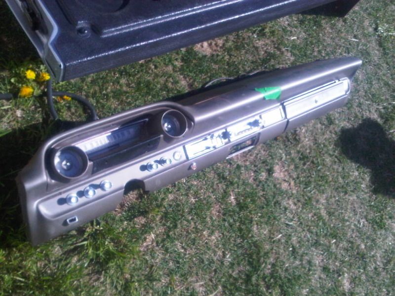

but i did go to the local swap meet, i wasnt expecting to find anything special, i was basically going for a carbide bit and all sorts of sanding discs.

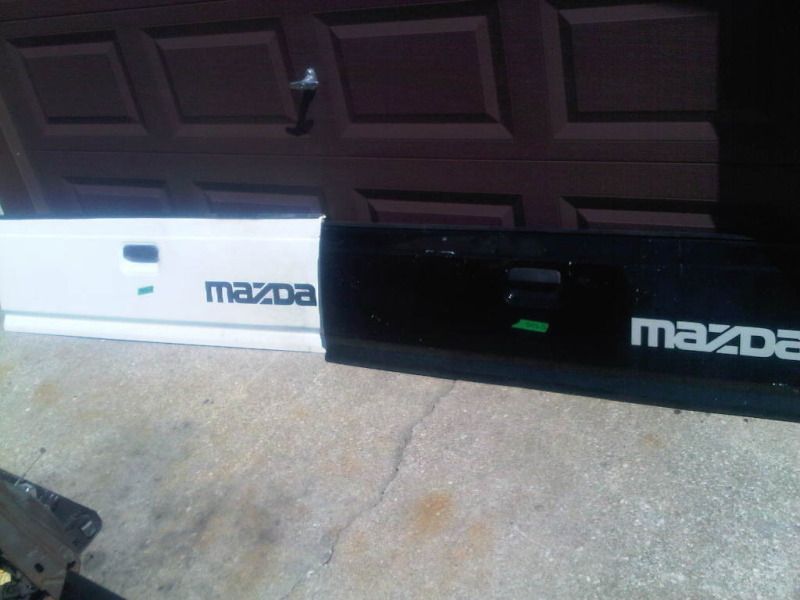

but i did manage to score a 60 something ford galaxy dash and 2 rust free tailgates all for 80$
and my buddy scored n.i.b. hardbody 4x4 fenders and street rod mirrors

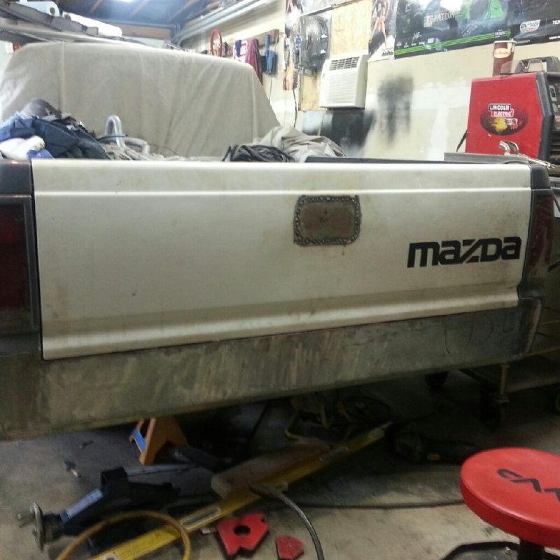

got the hinges and roll pan done
fresh tailgate mounted and in the process of shaving the tailgate handle

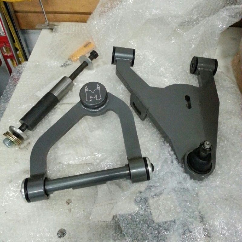

and i ordered and received my MMW control arms, powder coated and jeebus joints also got them shortened 1.5" to correct for the 3/4" the drop spindles push the wheels out and an added 3/4" for extra room for wheels
