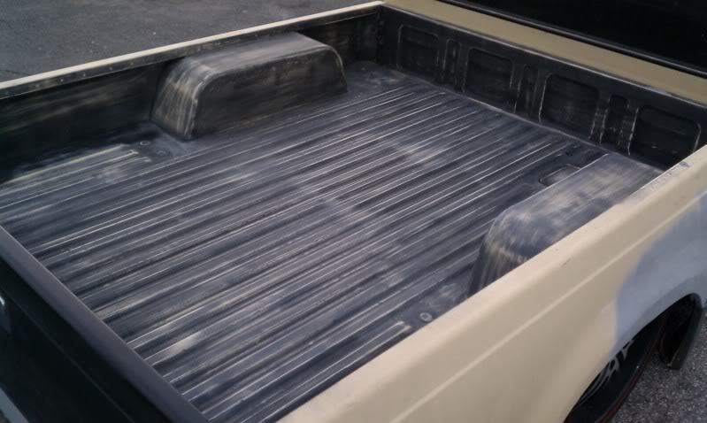

nopistons96's avatar
nopistons96
Mikeys is not the one i was thinking about but his looks great.
his truck bed.
this might be the answer i was looking for.
rotten
yeah... i mean sure u loose 6-8" of depth, but at least theres not a giant gaping hole in the middle of it haha

91extcab's avatar
91extcab
That is mikey's bed, he's got a 4in frame z hidden under it, I personally went with a z'd frame cause I wanted to keep a flat bed floor, and if I ever decide to pick up a regular bed I could easily put it on if the bed was body dropped...
