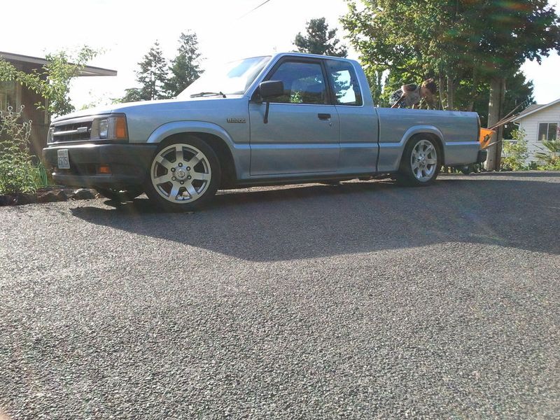

I've got h3 hummer rims on mine didn't have to grind tabs or bore the rims direct fit no prob there 16s though here's my number I can send a pic if any one wants to see 864 569 4551

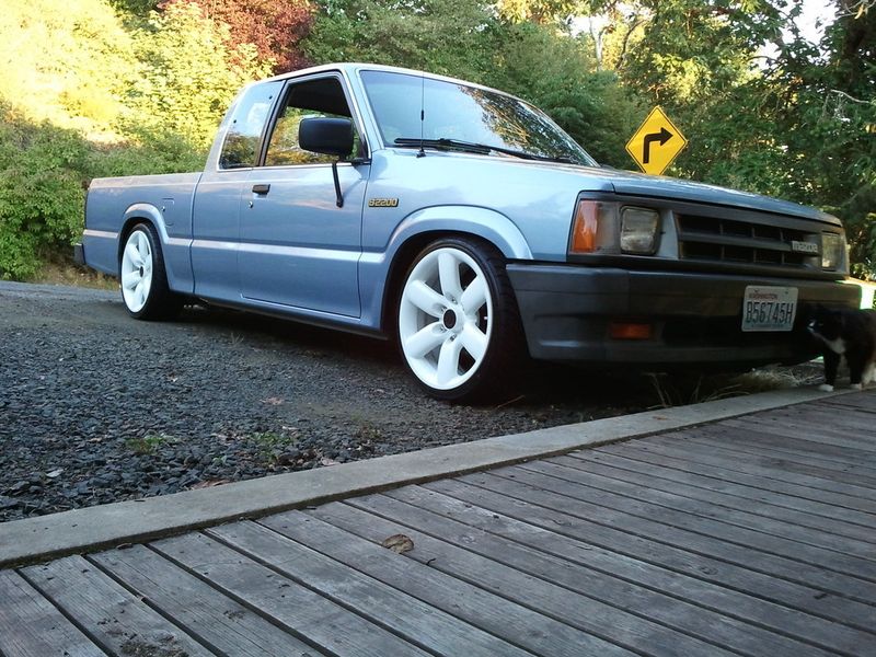

col. sanders
If you are going to bag your truck then the Chevy wheels are a better choice due to their offset. If static is your thing then the Nissan's will will work fine.
cms062407
Col. Sanders,
What size are those white titan wheels? What year titan did they come off of? Also, are you lowered in that pic?? Thanks!
