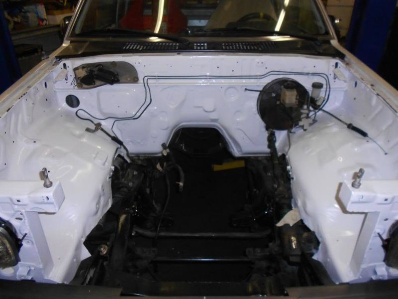

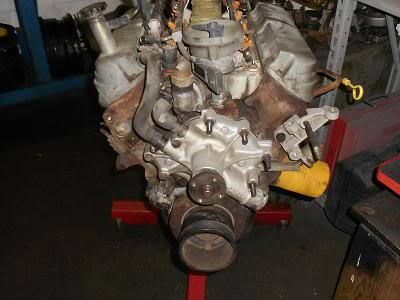

Hi everyone my name is Gorka. I drift a 1990 Mazda b2600i pick-up. I have been drifting for 3 years now with my truck and love it. I had a custom turbo kit on for the last half of this year till my motor blew on the last event so now i'm putting a ford 5.0 v8 in it. here are some pics of the truck and my progress so far of the engine swap and the specs on the truck.

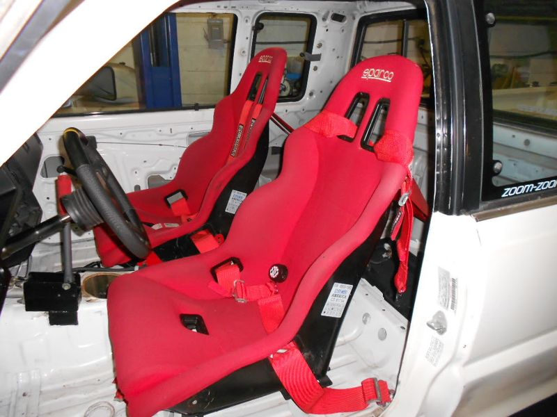

-Sparco driver seat
-Sparco passenger seat

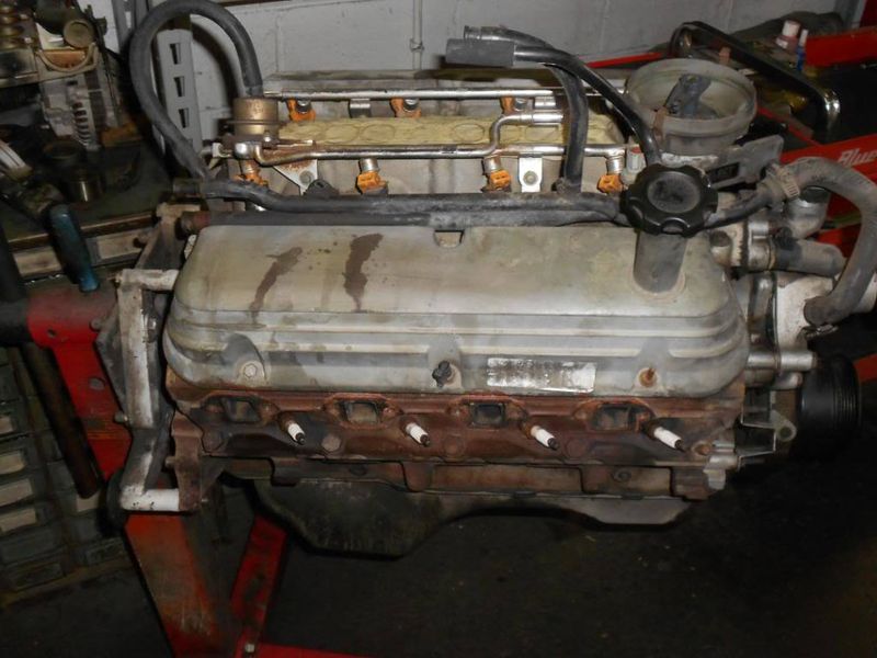

here the motor that i need to clean

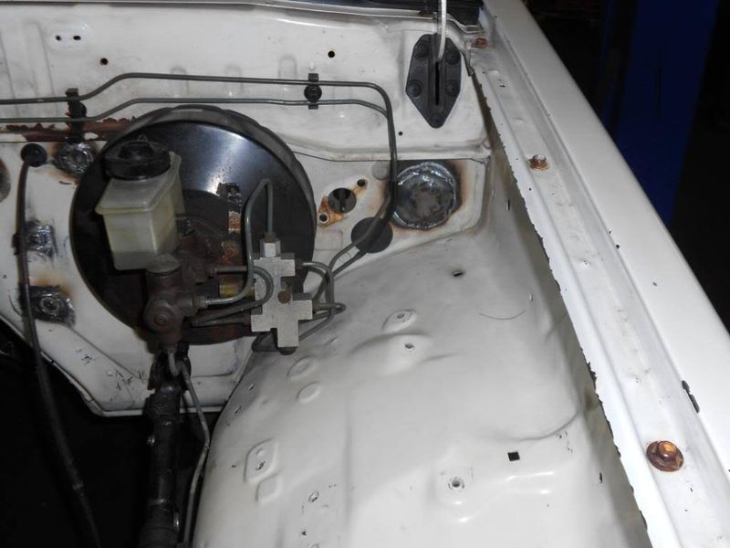

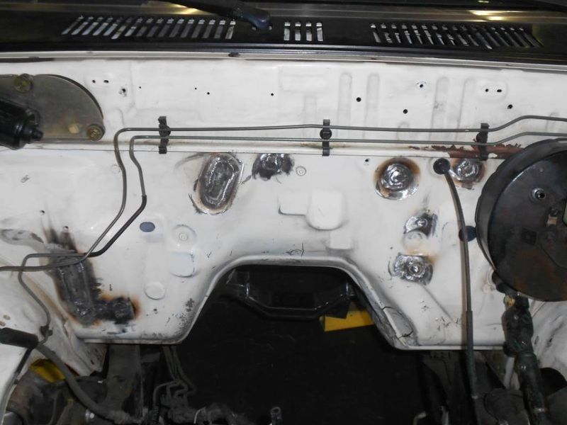

covered all the holes in the firewall

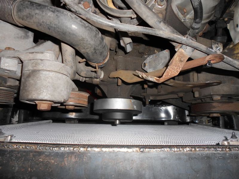

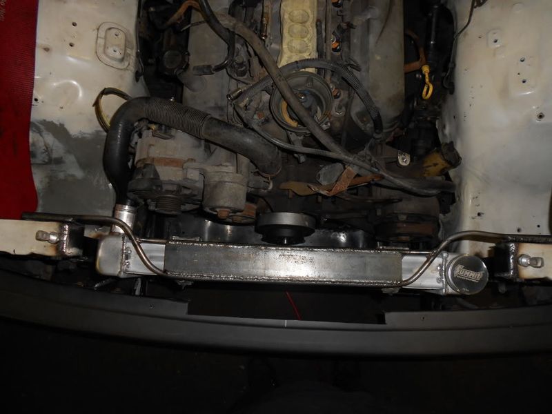

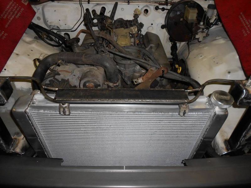

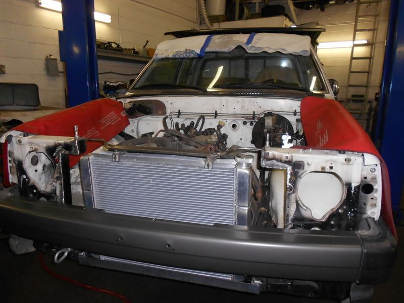

got the motor and trans in and stated mounting the Radiator

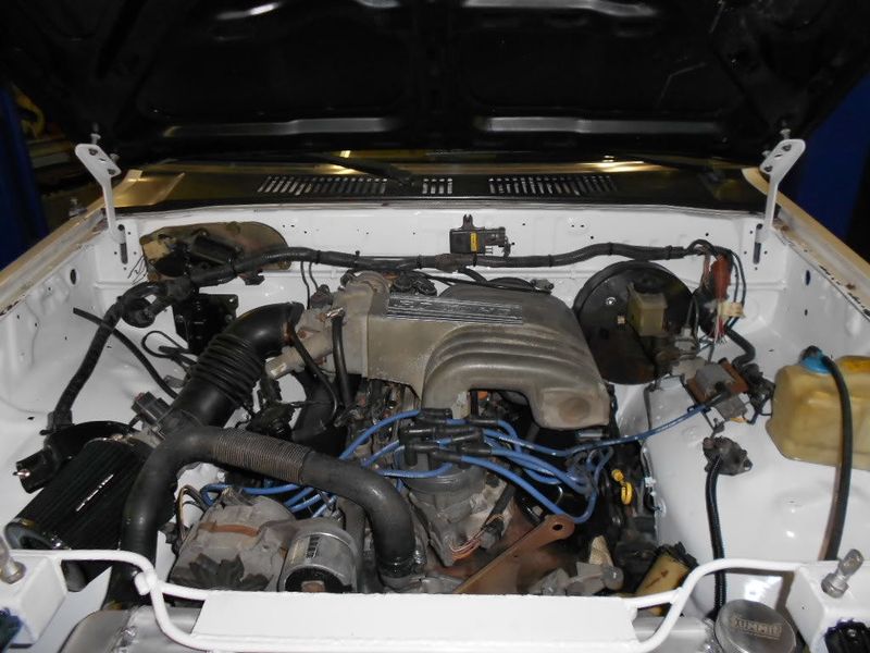

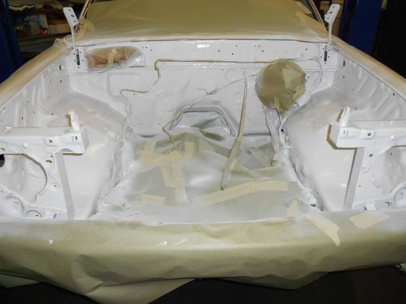

I got the engine bay cleaned and painted

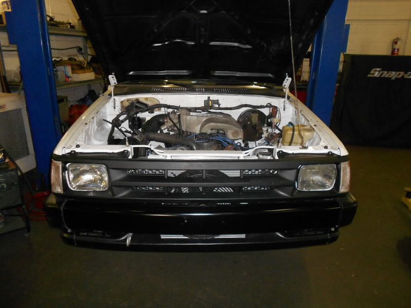

got some more work done. Took out the heater box,chassis harness and painted my dash black. I'm going to be making my own chassis harness.
I also got the motor back in the truck I will post up pics later

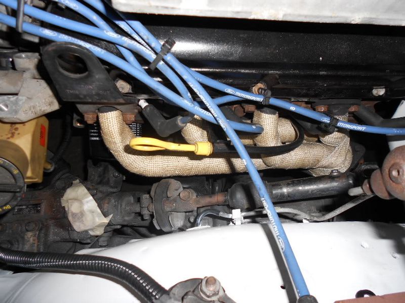

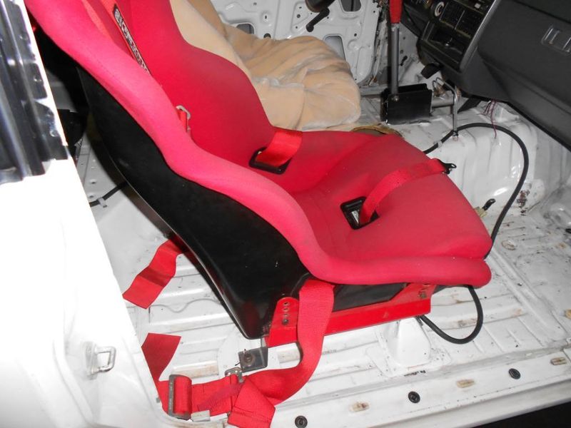

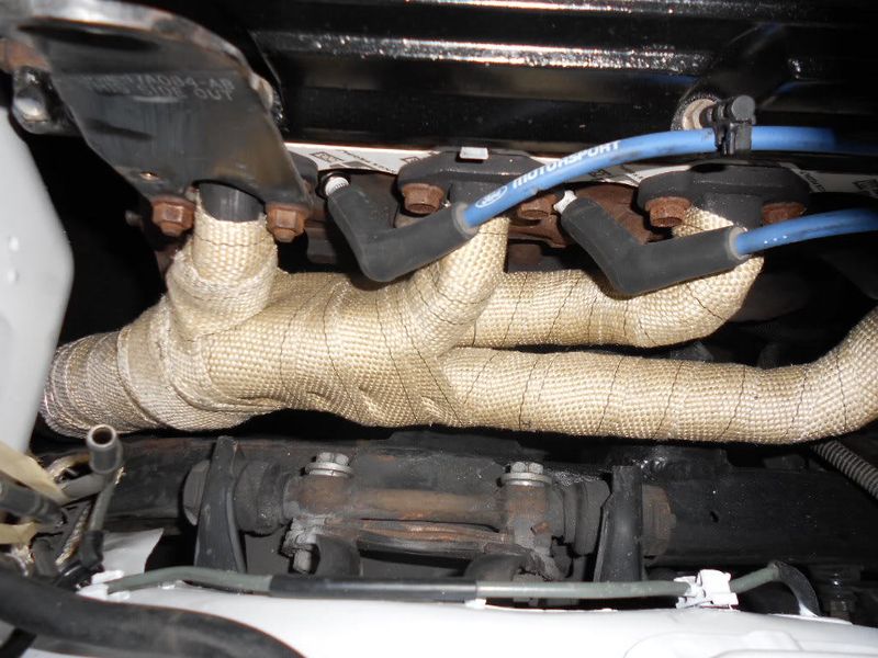

I got my motor is in. I also installed a sparco seat on the passenger side. need to start on the wiring not going to be fun!
there isn't alot of room for my headers

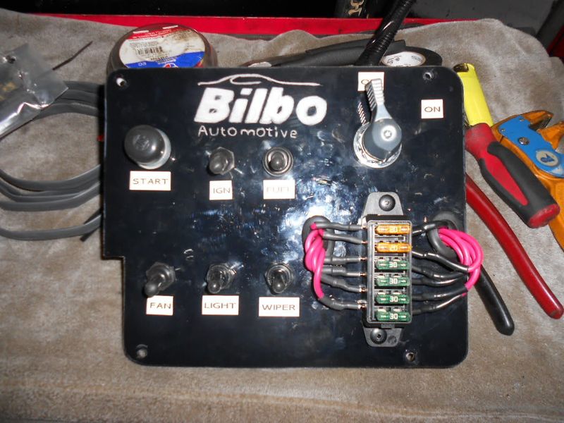

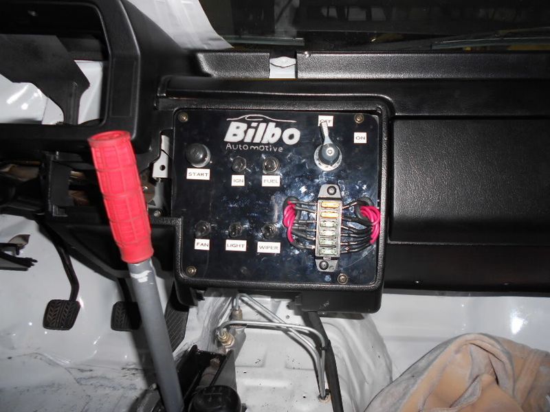

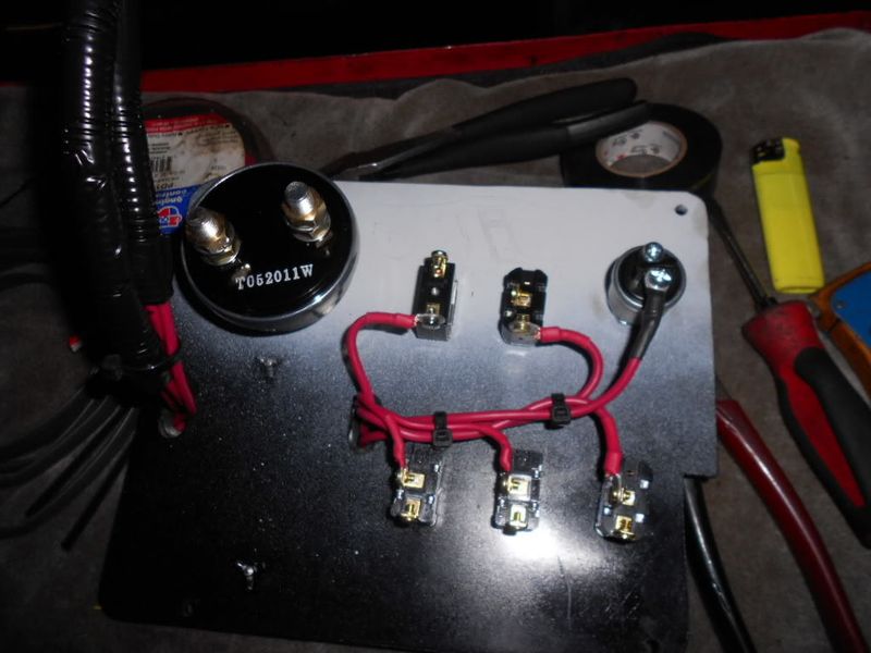

I got all the switches on the panel and started wiring up everything not long till I get it running .
it looks so cool with the switches in the dash and with my shops logo.
