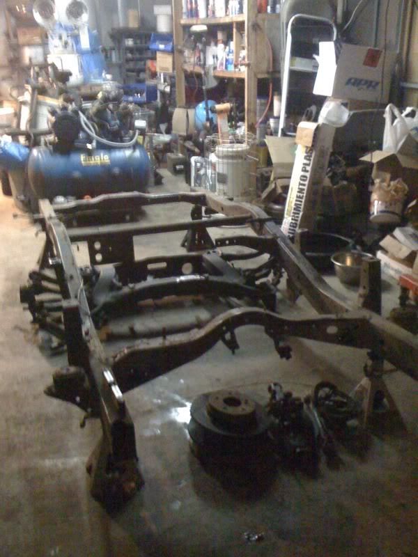

This is a "second phase" build. The first one was getting the truck together in stock form with all new wear items. It had sat as a bare shell, bare frame, boxes of parts in my shop's attic for 8 years. Drug it all out to go to Slamsession a couple years ago...Built it in the 5 weeks before the show...But a bad fuel tank kept me from going.

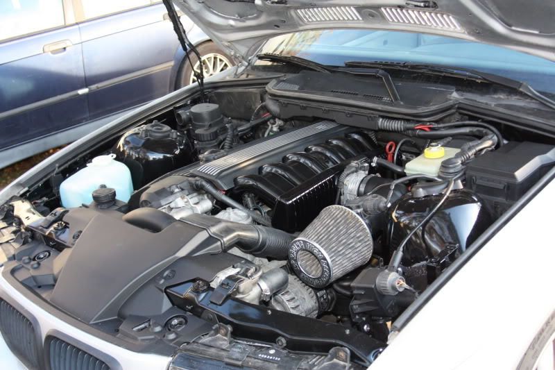

Well it was my BMW.

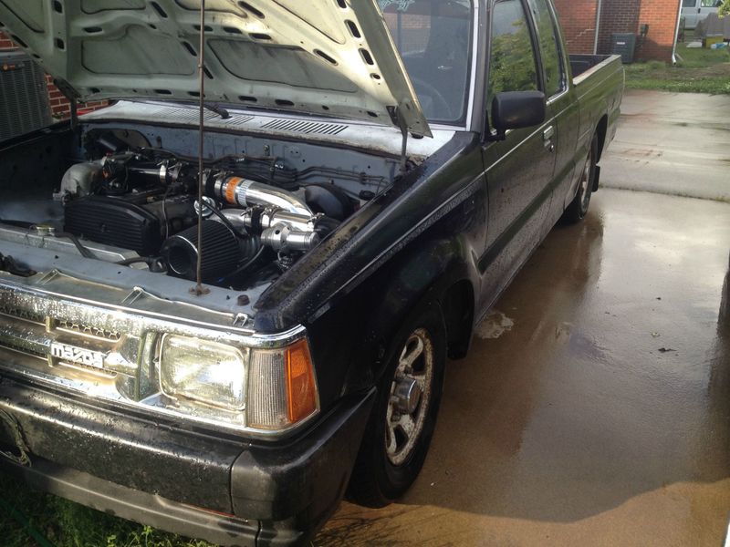

Its really a great swap. I average 28 to 33 mpg and it has quite a bit more power than stock. And more torque for hauling. Takes to turbo charging nicely with new engine management and a custom manifold.

More on my FE3 truck:

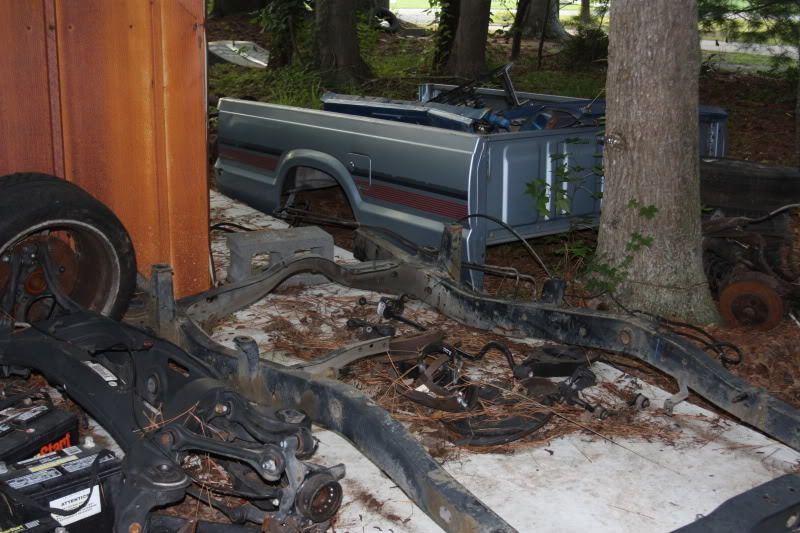

It begins long ago in a city far, far away...

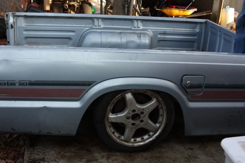

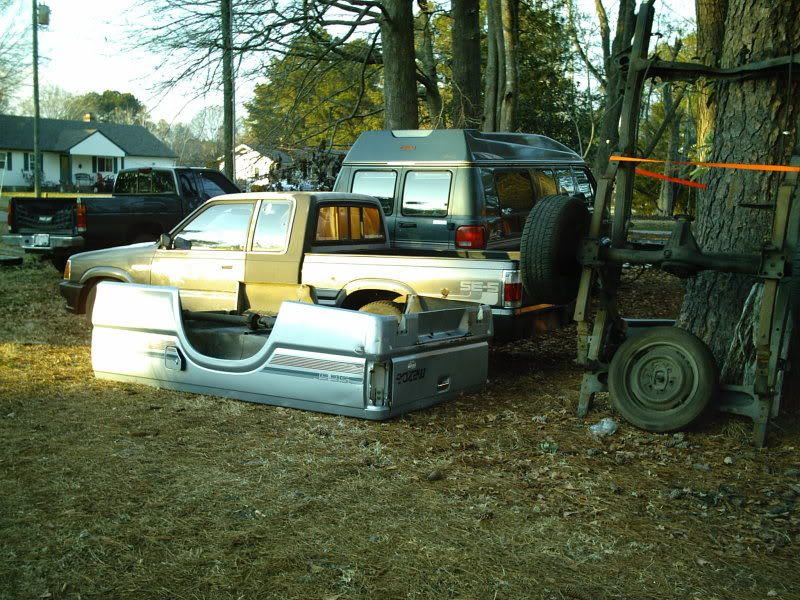

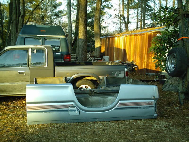

Got a long bed and frame from LSUMazdaTruckin in exchange for me helping him with some wiring on his current project lowrider.

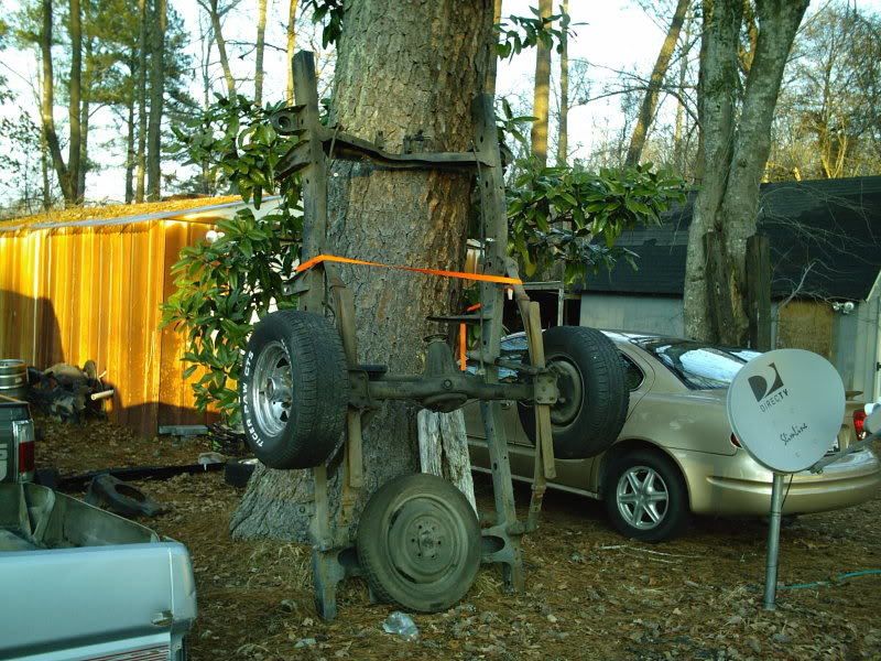

What better way to make your neighbors scratch their heads than strap a truck to a tree?

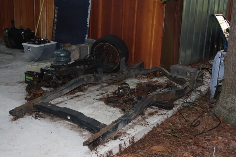

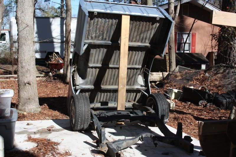

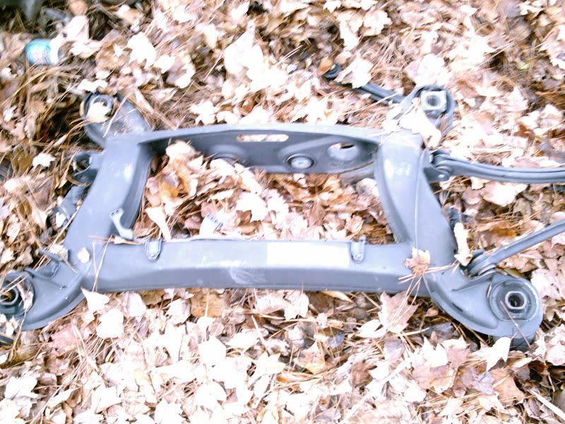

Mercedes W203 rear subframe from a C230 Kompressor. Its a 5-link setup. Damaged in a collision. Using it for initial mock-up

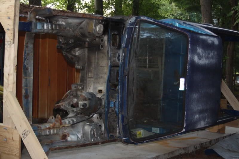

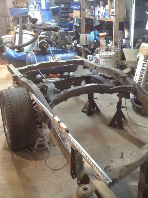

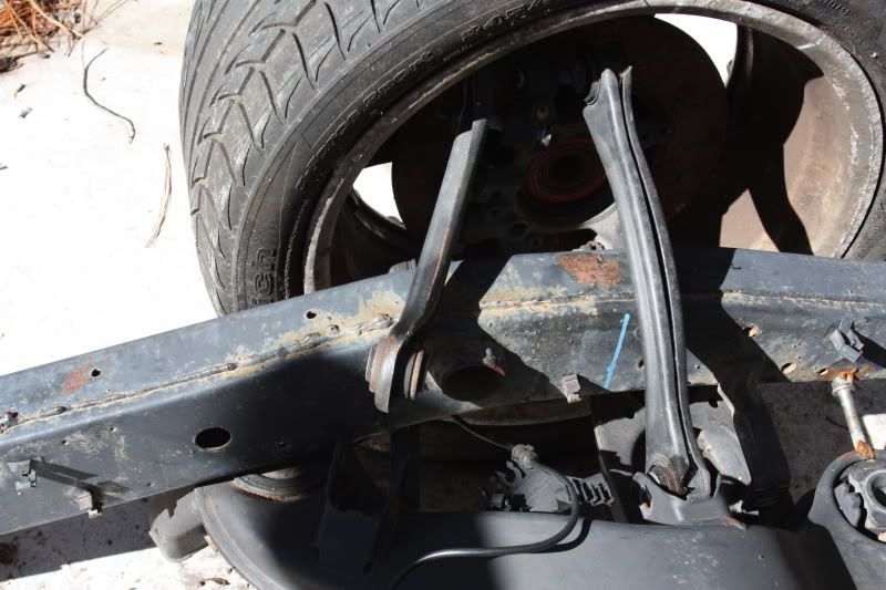

Frame setup and removing stuff in the way and no longer needed.
Neatish shot

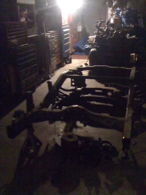

Sitting...Waiting for bearings and parts for the rear subframe.
Some progress! I got another hub and wheel!
Not sure why I don't have pics of the subframe tacked into place before I threw the bed on..But here is a video I took!

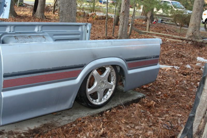

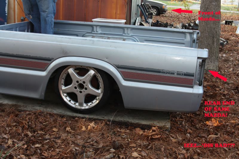

Bed test-fit. Frame on the ground. Frame is not notched. Bed is not cut or tubbed. Cool, eh?

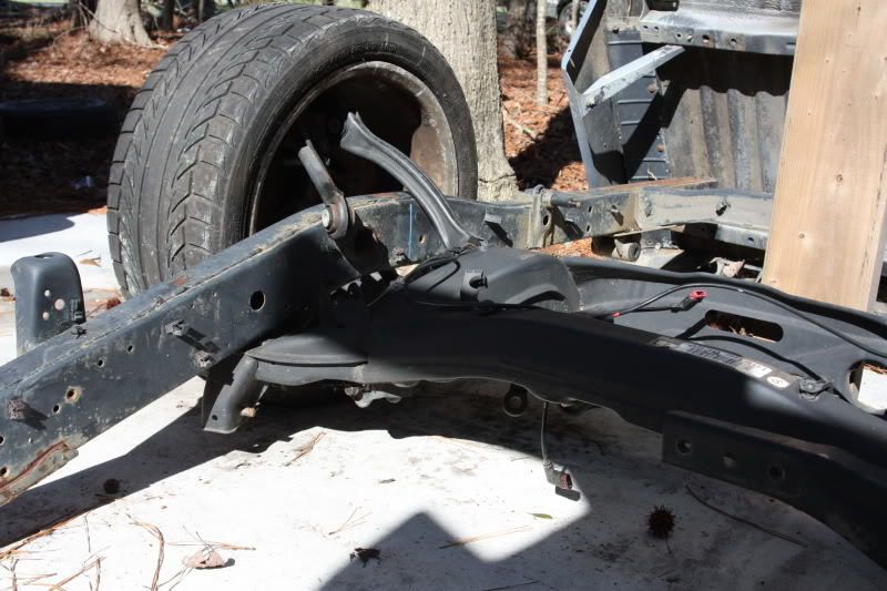

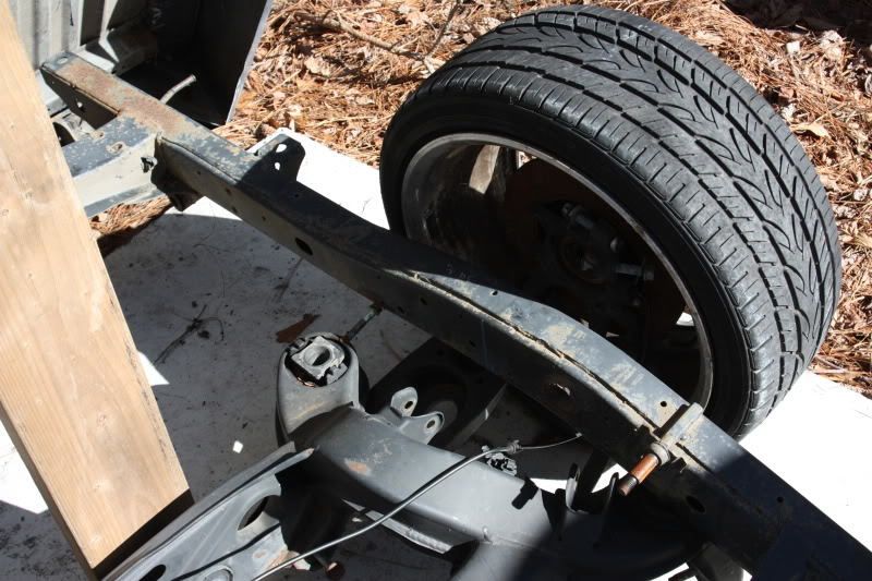

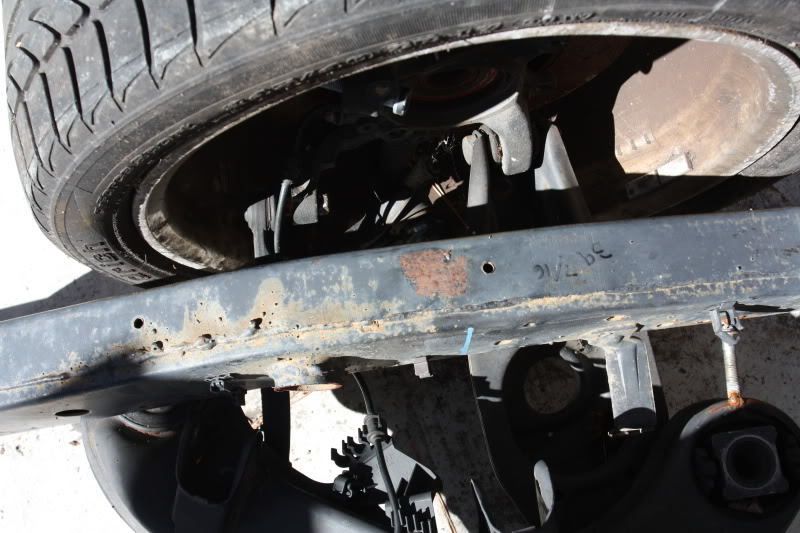

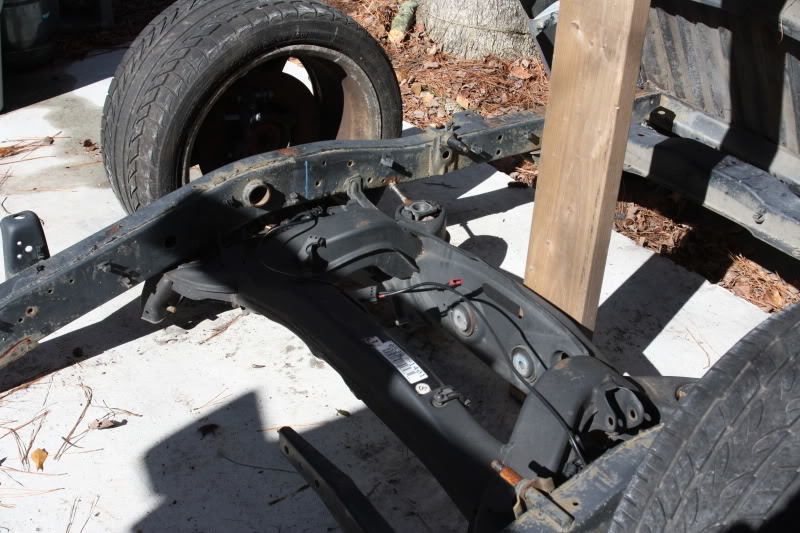

Here's what I've got.
Mercedes subframe tacked in pretty centered. Its sitting 1/8" closer to one side. Its hard to get square measurements, because it is slightly tweaked from a collision.
The three links on the bottom are on. I've got the two top links out, because the contact the Mazda frame rails.
I plan to cut away the Mazda frame rails between the two subframe mount points. Using the Mercedes subframe as a frame connector on the truck frame. Bracing the area as needed. That will allow me to use all 5 links and keep the stock geometry of the Merc. suspension.
I also plan to recess the subframe up another 3 inches for extra clearance for axles and diff. It will also get me closer to a neutral suspension position at ride height.
I still need to get a diff and axles to make sure I have no clearance issues with it laying frame. Also I want to check to make sure I've got the subframe parallel with the frame and getting a good pinion angle.
If I use narrower wheels and tires and smaller diameter wheels (17X8.5's on it now) It will lay frame without me cutting the bed's wheel wells, or cutting out the bed floor for a notch. The front will be another story, though!
So I need to get a diff and axles mounted in. Check for issues. Raise it up another 3 inches into the frame, flush to the bed floor. Then start cutting and making mount points for the subframe and the other suspension springy, shocky stuff.

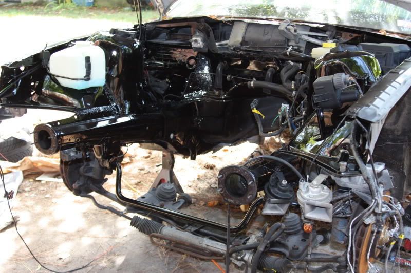

Video of me yanking the old 2.2L out of my B2000.
Cutting the un-needed harness bits out and starting on the FE3 install. The truck needs to be mobile, So its getting an FE3 for now. And once I'm ready for the next engine..I can sell the FE3 and transmission and whole harness to someone who wants a drop-in KIA FE3 in their Mazda.
I plan to do a full write up of the FE3 install...With using the KIA harness and computer.
