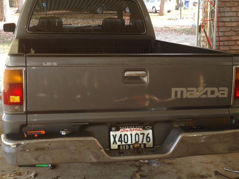

well i just got done dropping my truck now im getting ready to do a body drop this is what i have so far a 1990 mazda b2600i 3'' drop next is body then bags i have 2011 escalade 20'' rims im looking for a chrome grille and bumper anyone know where to get one cheap
