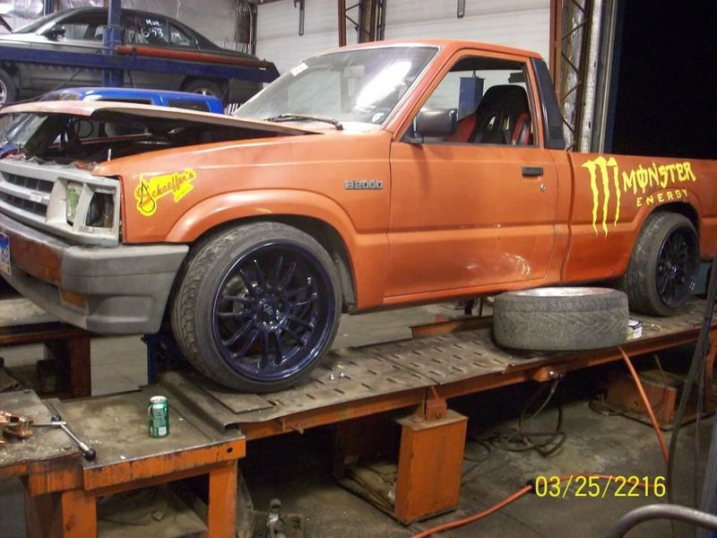

The Truck: 86 B2000
The Power: Small Block Chevy
The Trans: TH350 w/manual valve body
Suspension: nissan s14 coilovers for the rear, honda s2000 coilovers in the front.(under constuction)
No body mods yet, got get some wheels other than the stock chevy wheels, and im sure this will be a never ending project. Ill post some pics as soon as i figure out how

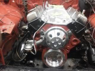

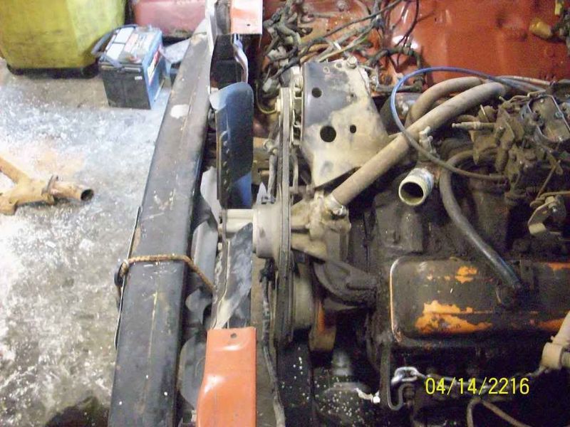

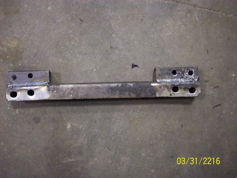

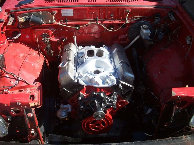

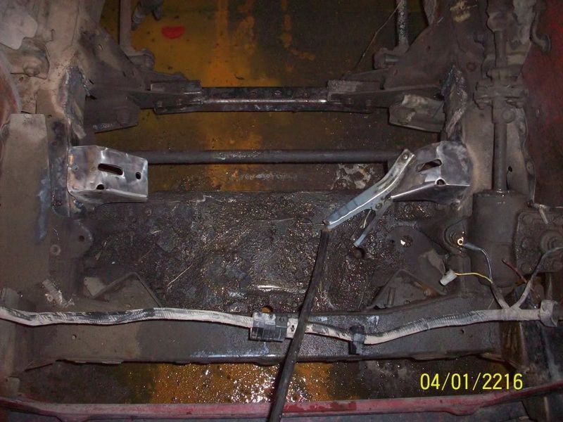

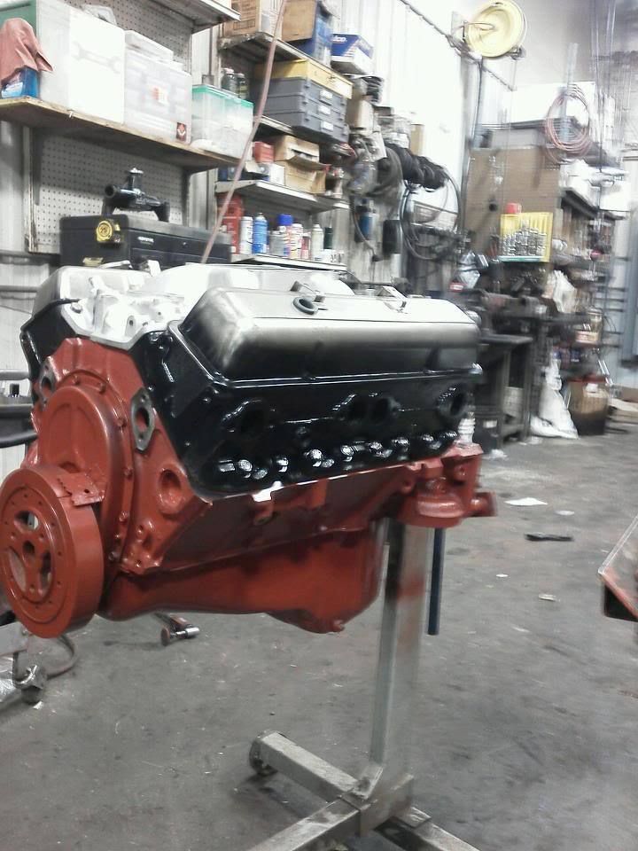

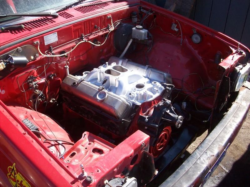

moch up for motor mounts
droped crossmember to make room for oil pan....so that i could keep the motor as low in engine bay as possible.

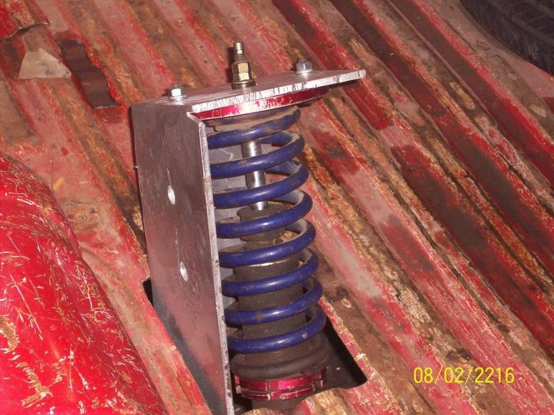

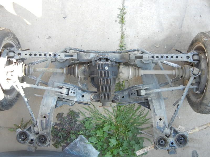

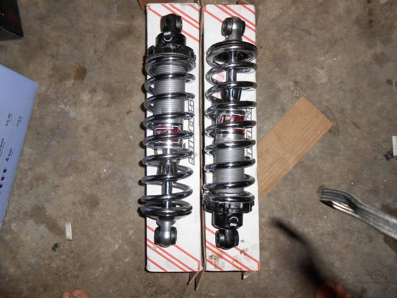

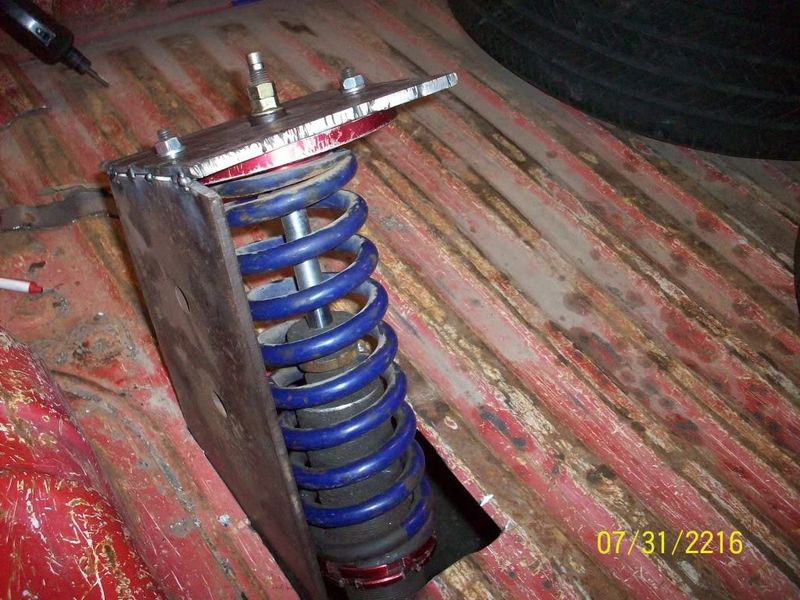

s14 coilovers for the rear.

I hope the back coil over mount inst 100% functional at that stage!

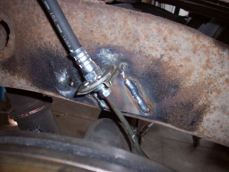

jc50942
nope...thats where i was adjusting to get the right angle. this is after i finished the welding

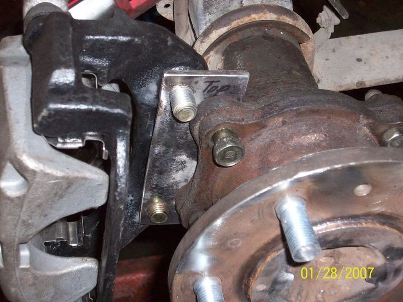

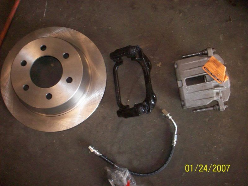

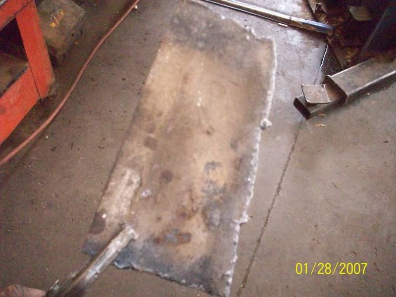

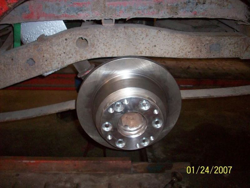

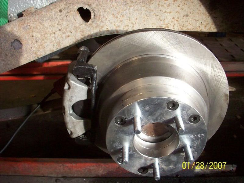

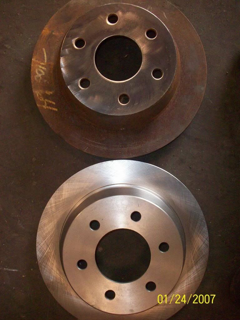

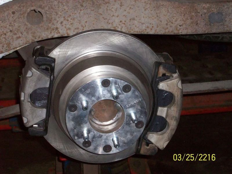

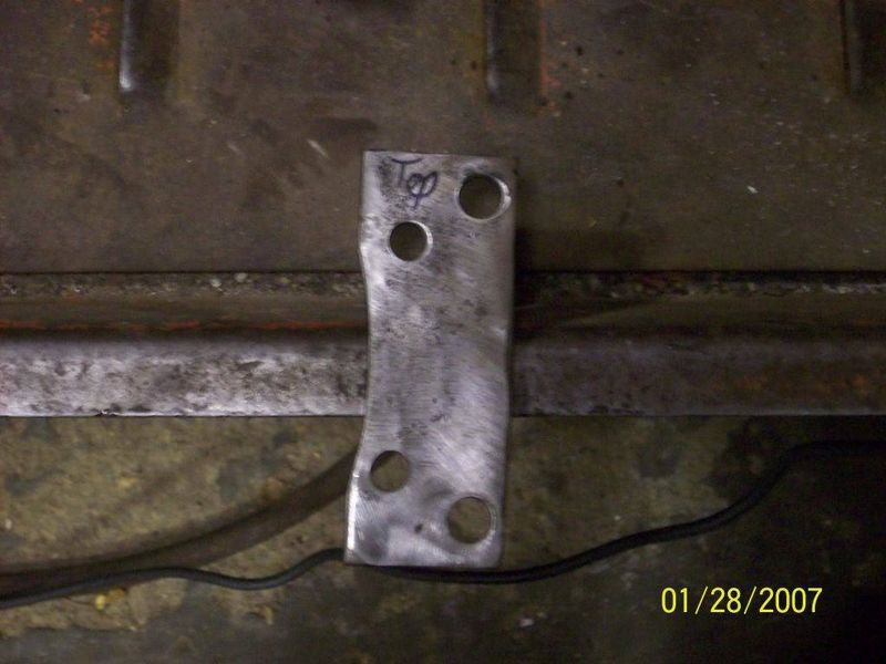

got some stuff rolling on the rear disc brake conversion. Using rear brakes off a 2000 1/2 chevy.
Before and after of the center hole. Had to be machined.
and on the truck...still gotta make a bracket to hold everthing on but it should be pretty simple

should have it done by the end of the weekend...may have to put in an adjustable proportioning valve...but we will see what happens
