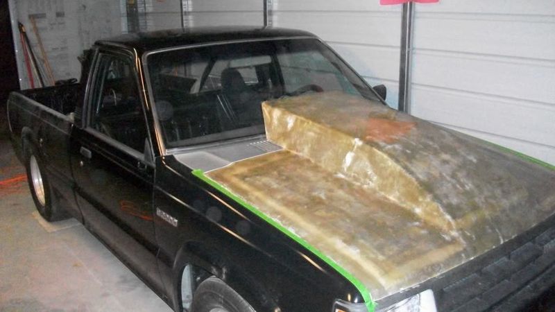

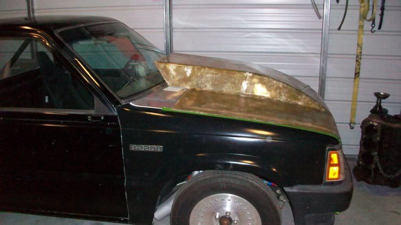

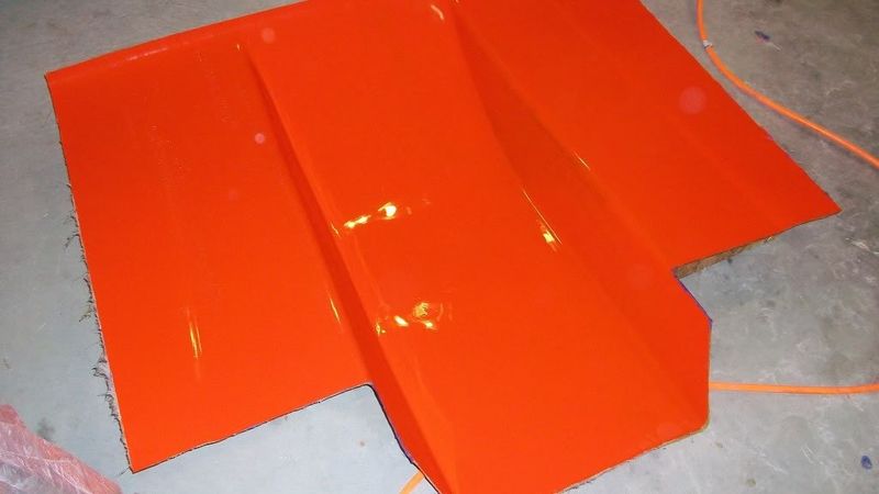

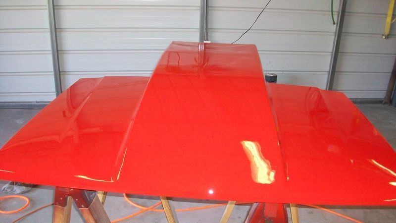

I needed a 6" cowl hood to clear my big block set up in th b2200 and after i found out you can not buy one I have built a plug so i can make my own lift off cowl hood. here it is so far. i should have the mold made next week then i can build all I want.

can you make the mold with changeable cowl size...that would be cool as hell and may sell better if you can make what someone needs
mazda454
if this works like it should i may build some with smaller cowls that will use factory hinges. this will be a lift off
mazda454
I got the mold seperated from the plug this morning before work. it turned out pretty good. I ordered the rest of the mat to build a hood earlier today. we are going to build one saturday.

Thanks. my material should be here today, takes a while coming from Florida. i am taking of friday to build the hood wish me luck
mazda454

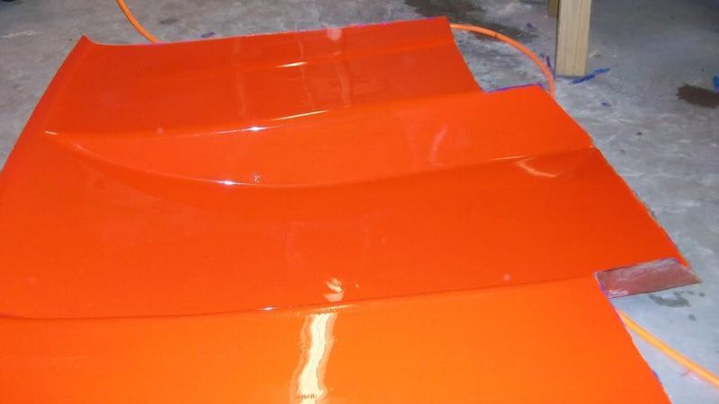

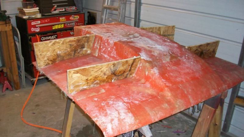

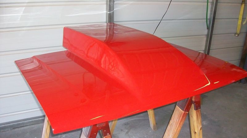

just got the first hood out of the mold today. it was not perfect but good enough i can do the body work and get some primer on it this week. i am by no means a fiberglass expert. it is done in clear gel coat next time i think i would use a colored one. here is some pictures

Damn fine job!

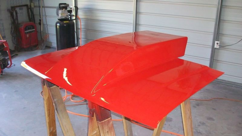

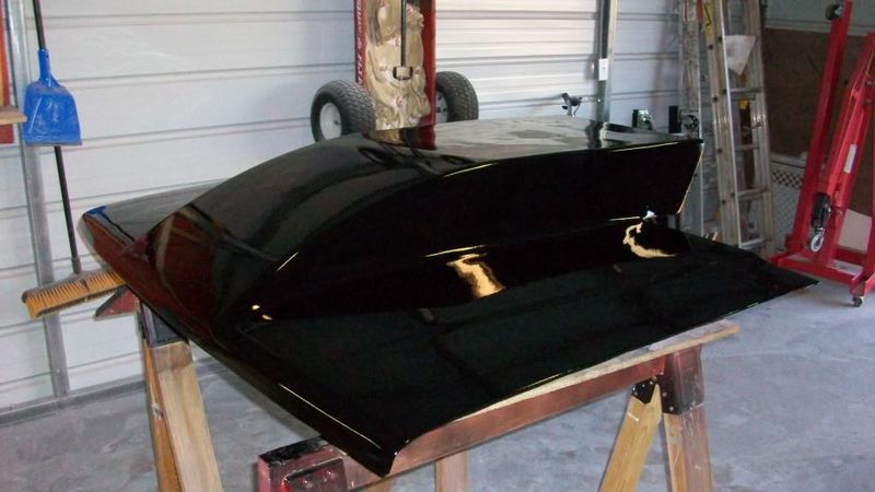

mazda454

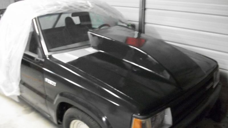

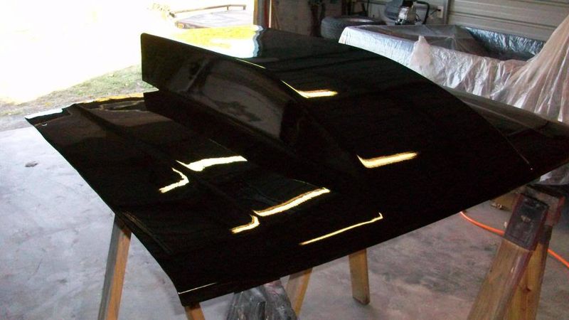

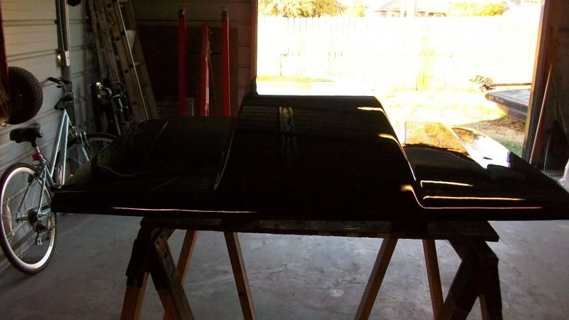

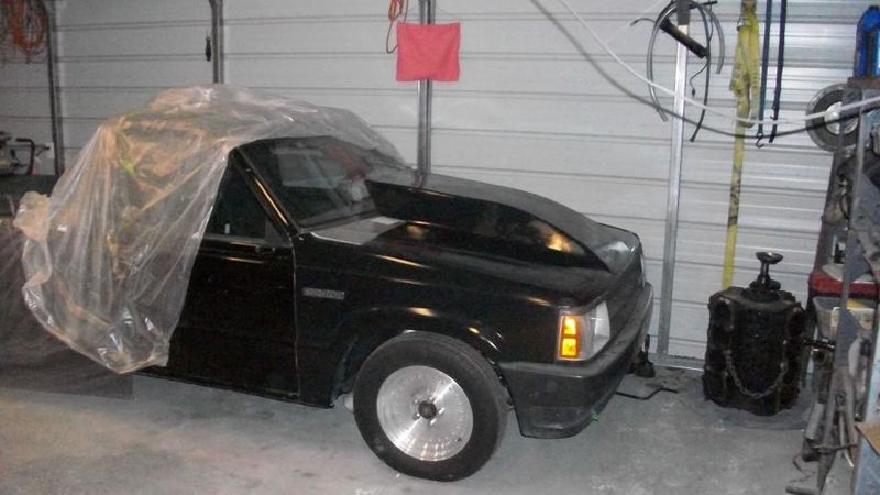

I got it done. painted cleared and ready to go on to the next project.
