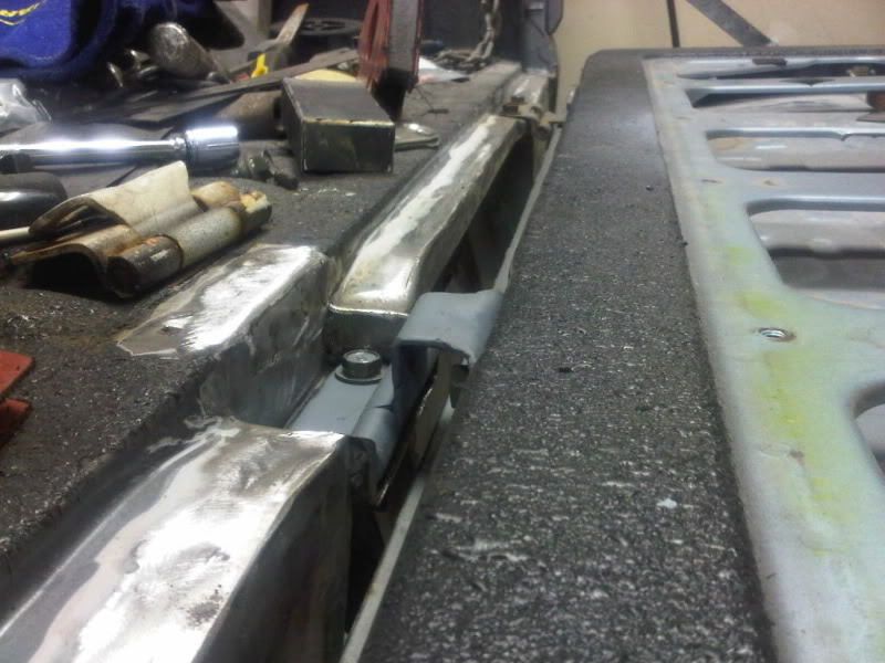

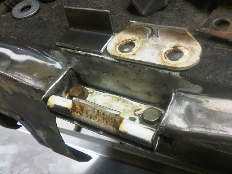

the tailgate mount in the bed was lowered an 1 1/2" and hinge cut up along with the angeled extention

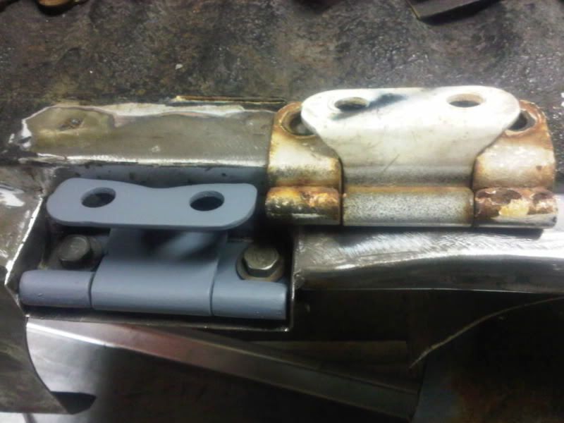

here is the hinge all welded up and in primer, next to the stock one

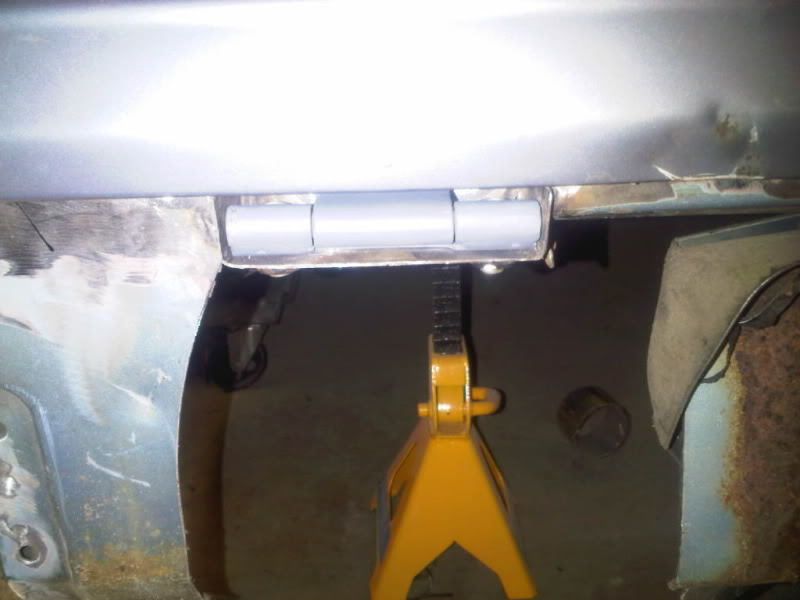

bolted in and tucked under the tailgate
the hinge working just like the factory one in every way

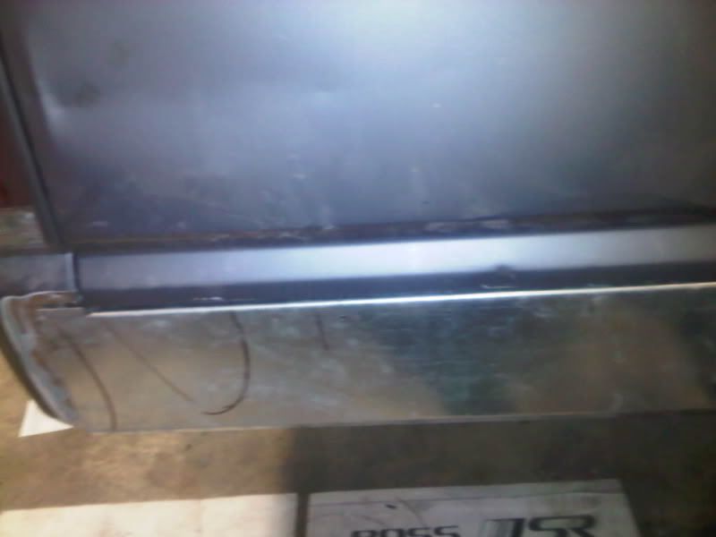

the rollpan up in place to show that the hinge is no more
