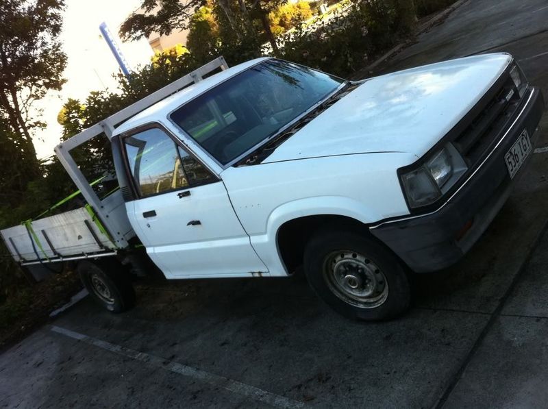

I thought I'd throw up some build pics of our new shop truck/parts hauler.

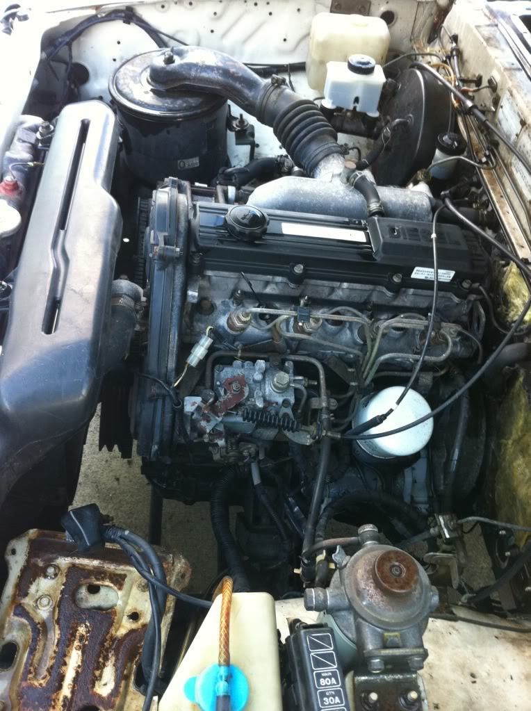

This was my bosses husband's old truck. He bought it just over 8 years ago with the intention of using it for his contracting business. He had the head and injector pump fully rebuilt, and the cab resprayed. He ended up picking up Toyota cheap as well, and decided to use that.

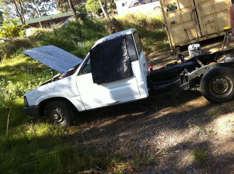

The Mazda got parked under a tree and it has sat there ever since.

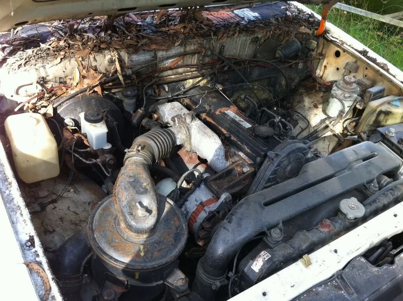

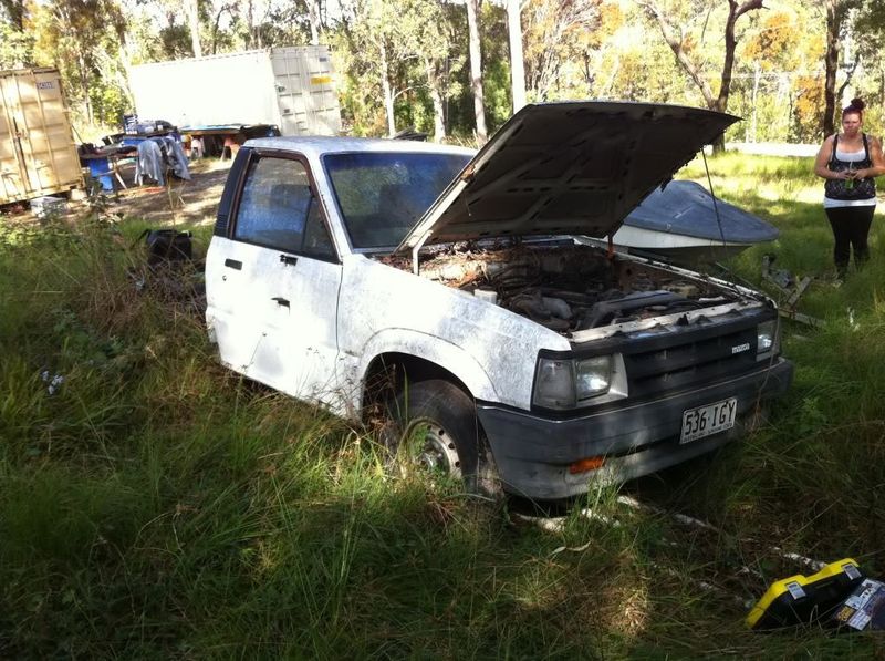

8 years later, throw in a battery and some diesel, and it fired up straight away!! The clutch master and slave were rusted solid, but I still managed to drive it back to the shop
Managed to get it out of the long grass after chocking some wood under the tyres.

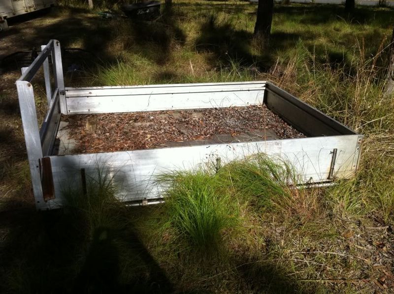

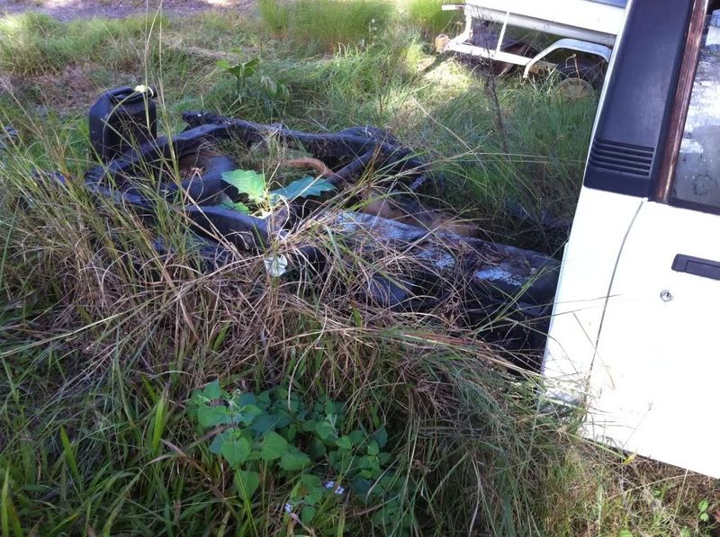

Tray sitting not far from the truck

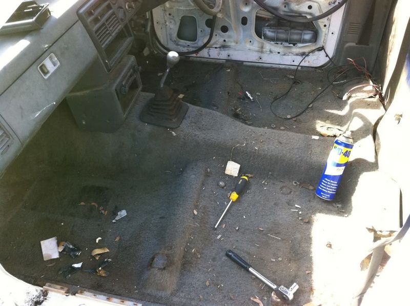

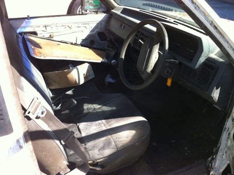

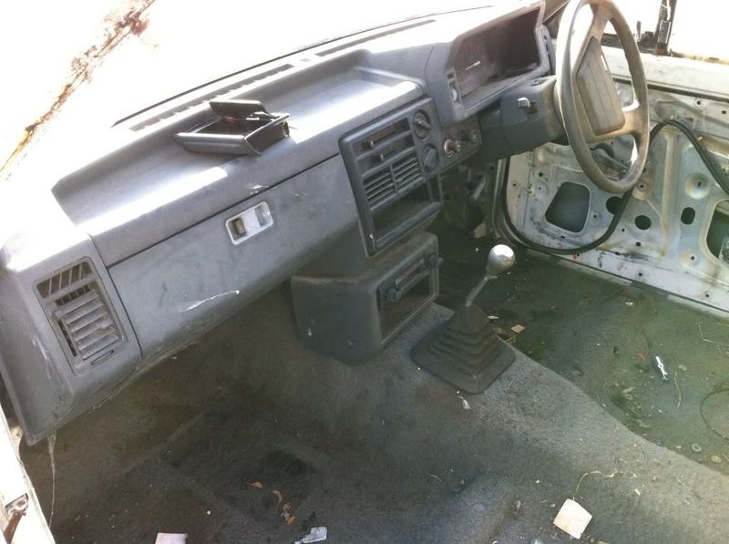

Interior. A few new parts still in boxes in the truck. The left window was missing so it was pretty dirty and wet inside.

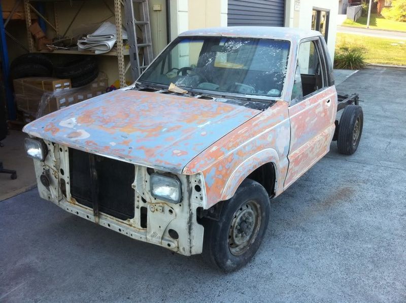

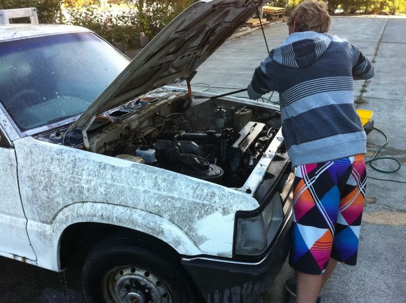

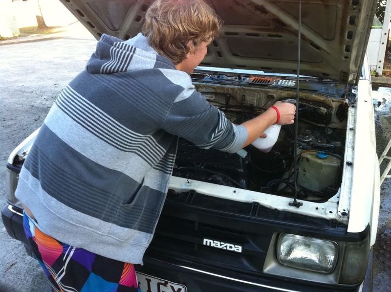

Got it back to the shop and started the clean up, and tear down.
Got out the pressure cleaner to get the 8-odd years of dirt off it!

Now it's time to tackle a few problem areas!

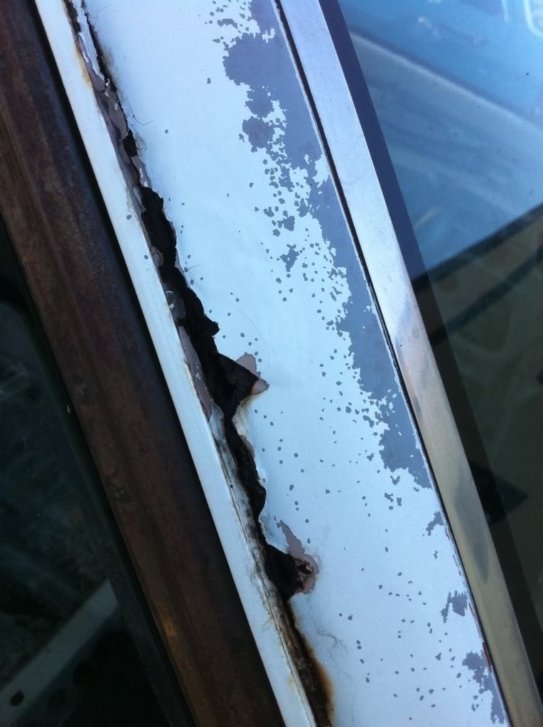

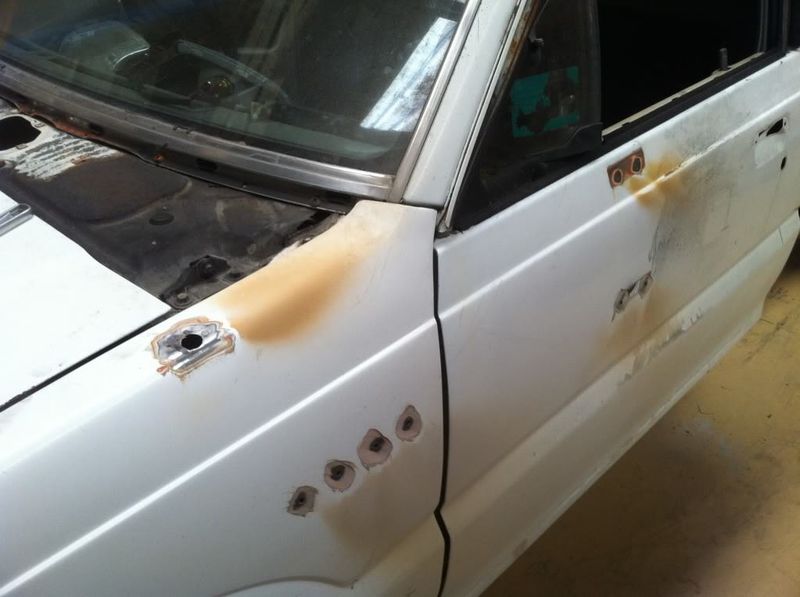

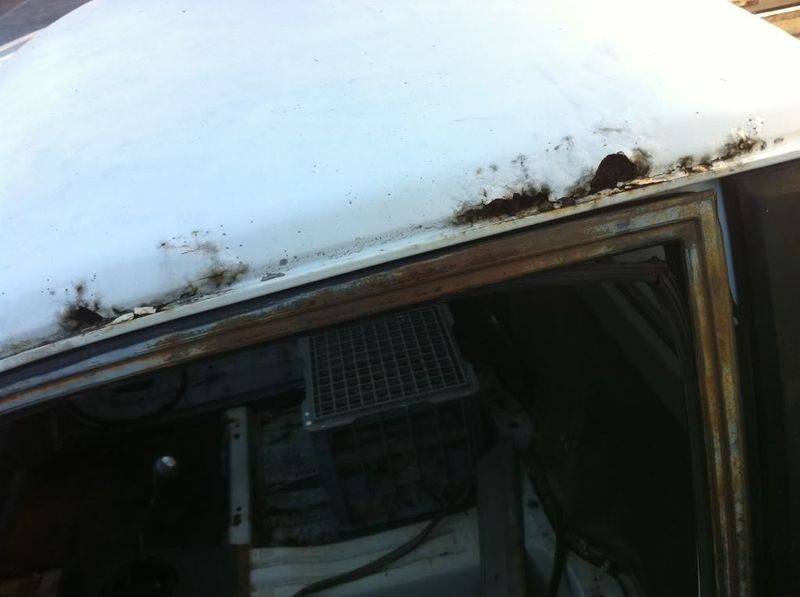

The only rust (surprisingly) is in the LH roof gutter
Drivers side A pillar
And a spot in the Drivers footwell.

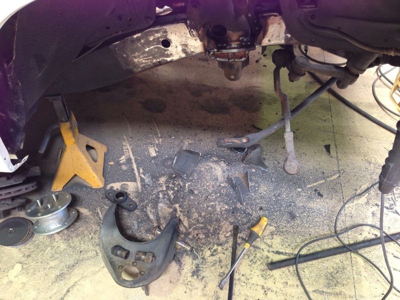

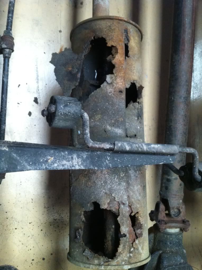

Oh, and this....

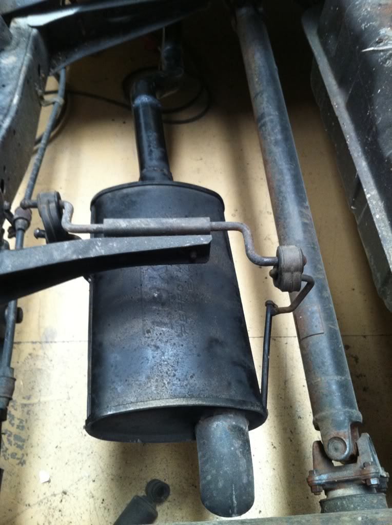

Luckily I had a sports muffler and some spare pipe laying around from my old Honda. It actually sounds pretty good for a diesel!

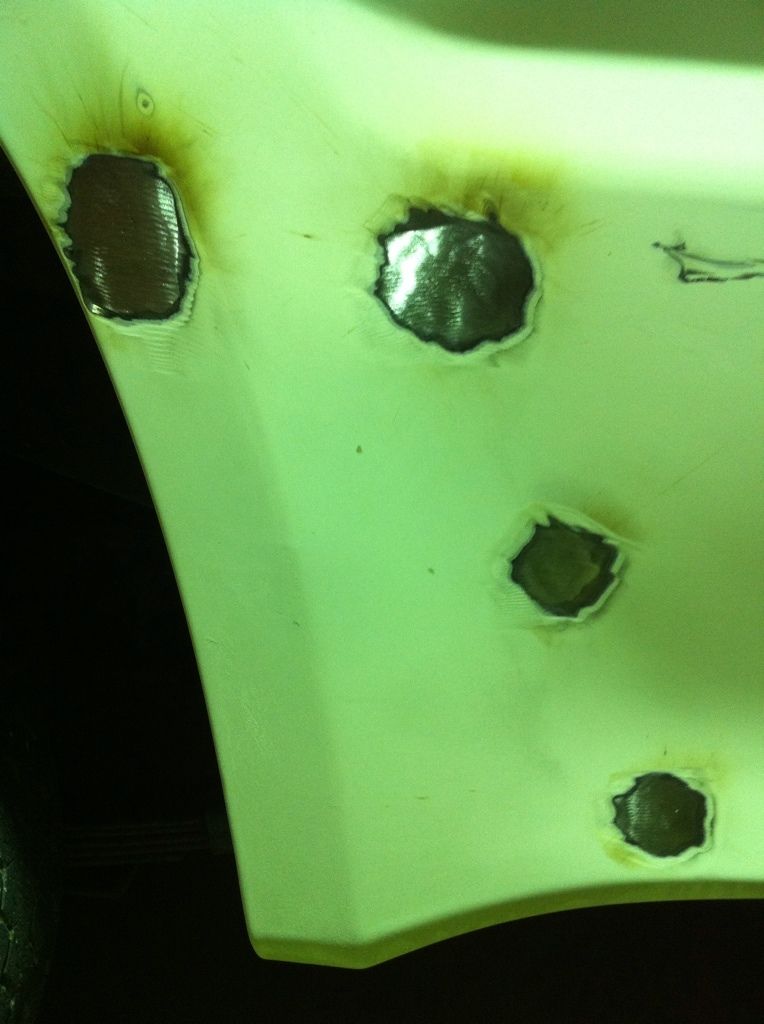

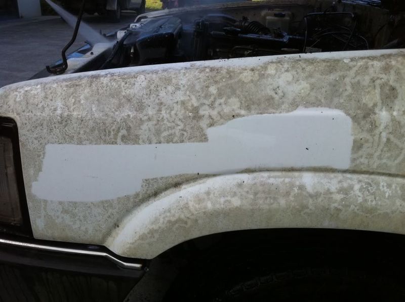

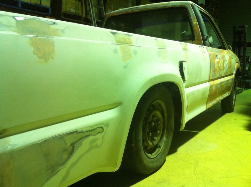

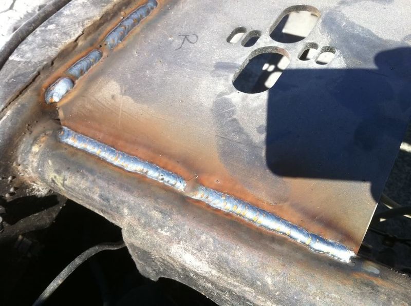

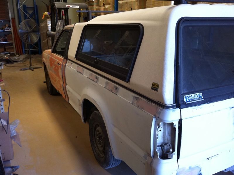

It's been a long tedious task trying to remove the shitty old acrylic paint, but we are nearly there now. All the rust has been plated, and antenna, badge, and mirror holes have all been welded up. Hopefully I will be shooting primer by the weekend.

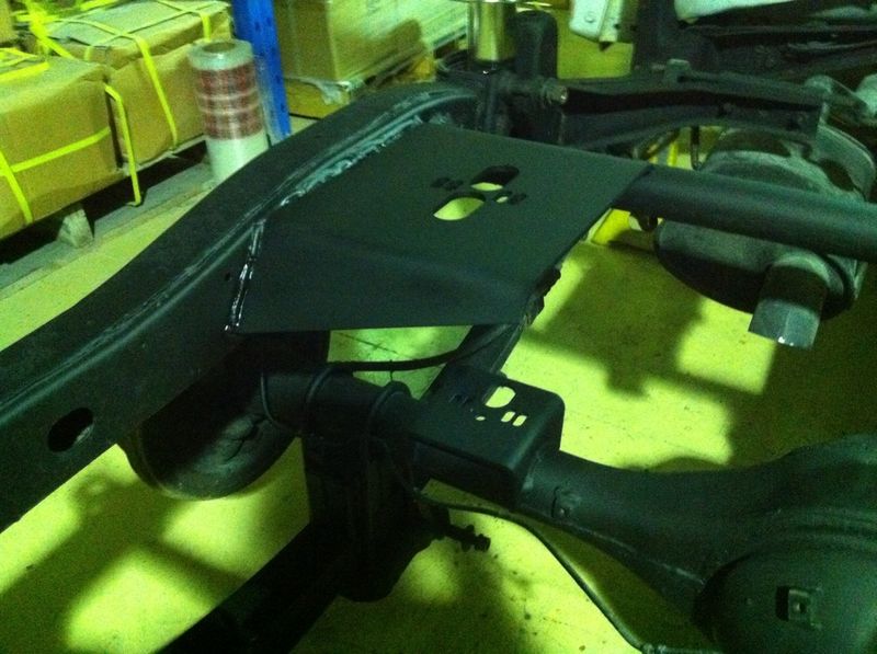

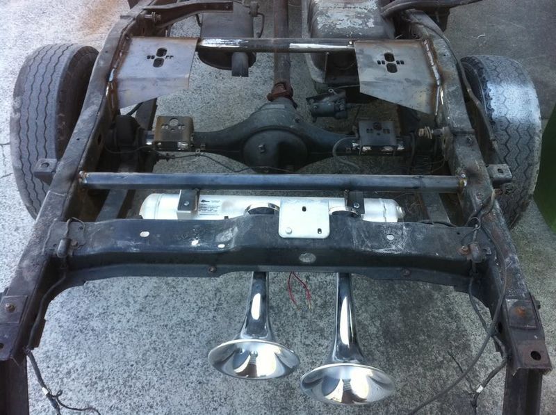

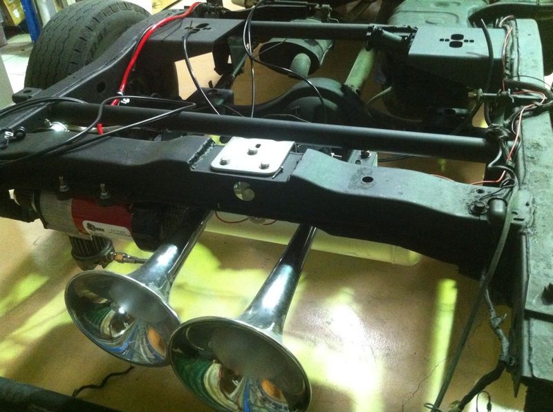

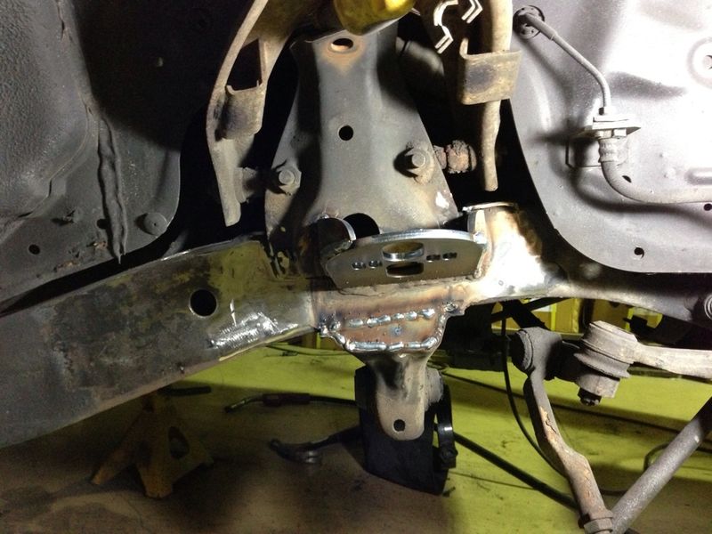

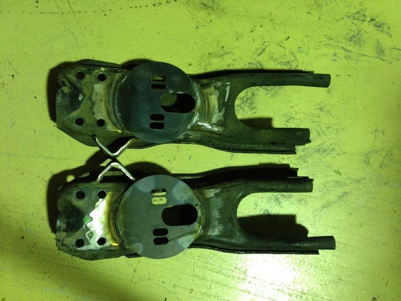

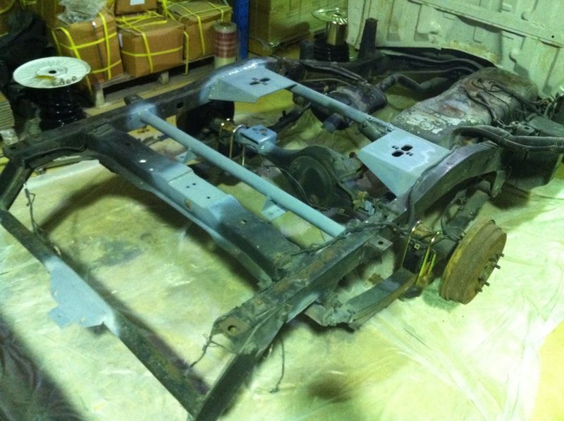

Rear bag brackets, and airtank mounts welded in, and train horns test fitted.

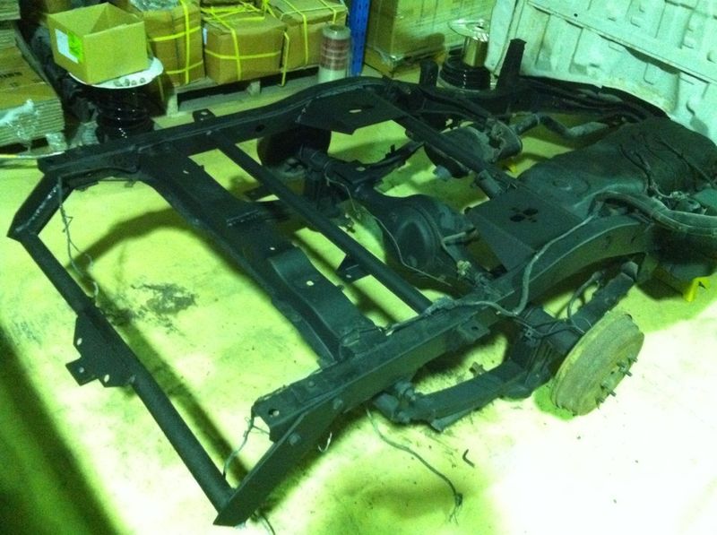

Got the chassis all painted up.

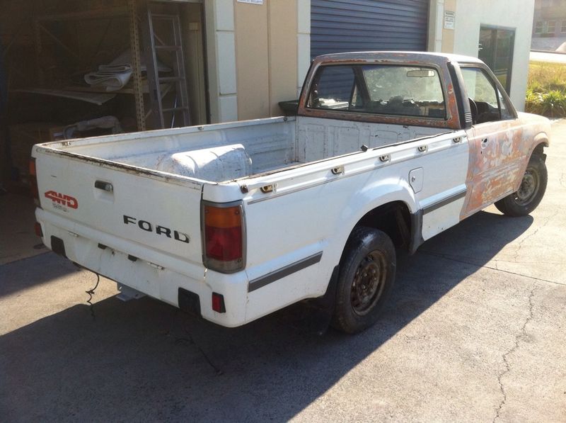

Also picked up a 4wd Ford Courier Tub, and canopy.

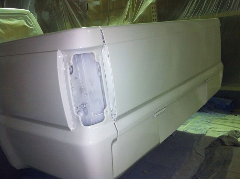

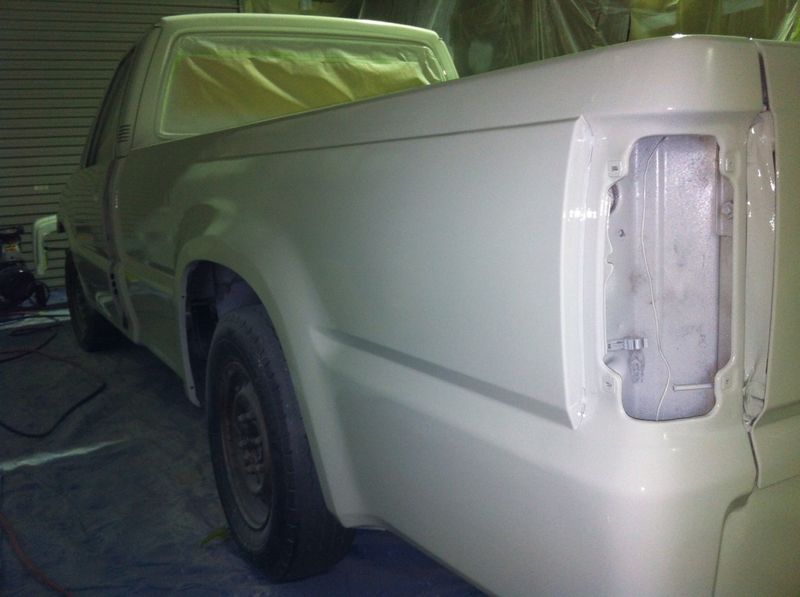

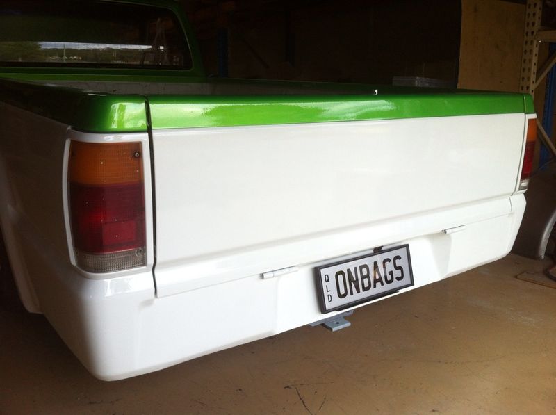

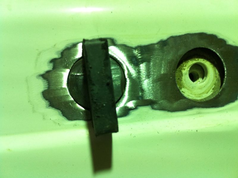

Got to work shaving a few things straight away. Stone guards, tailgate handle, tie down rails, seams above and below the taillights, and the rubber stoppers at the rear.

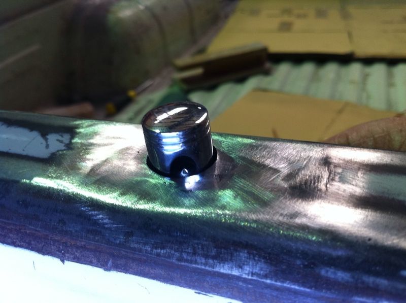

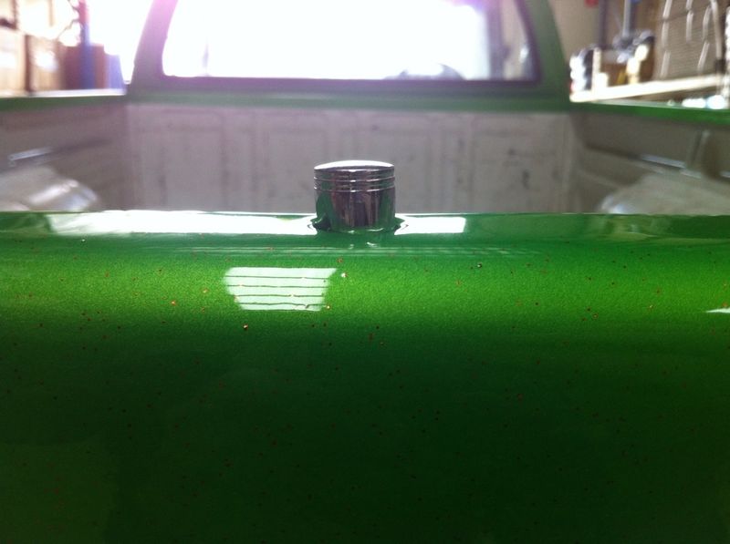

New tailgate handle...
5lam

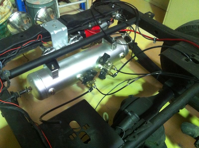

Air system installed. Front will be bagged eventually.

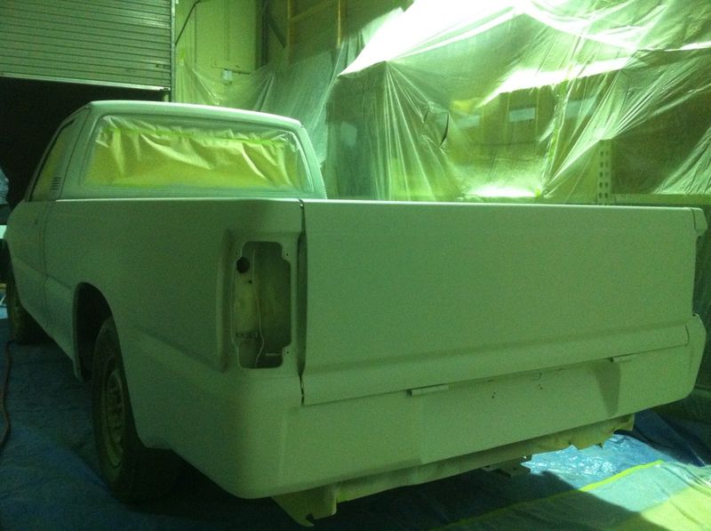

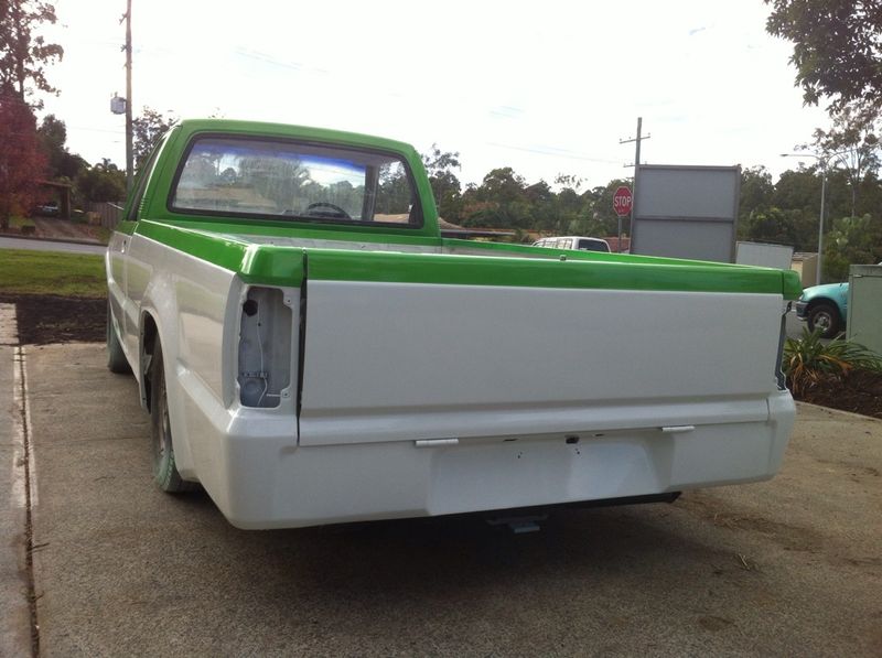

Ready for Primer!

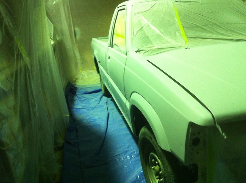

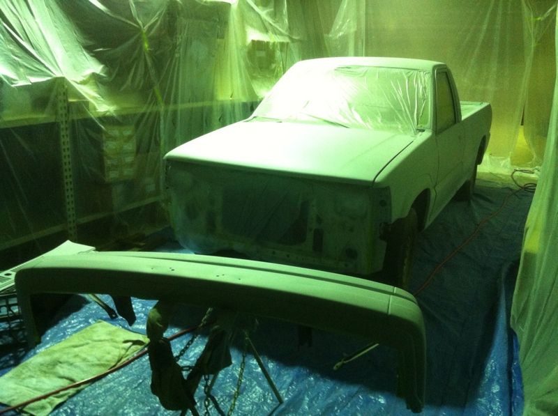

Primer done, in my makeshift spraybooth! haha Did the job though

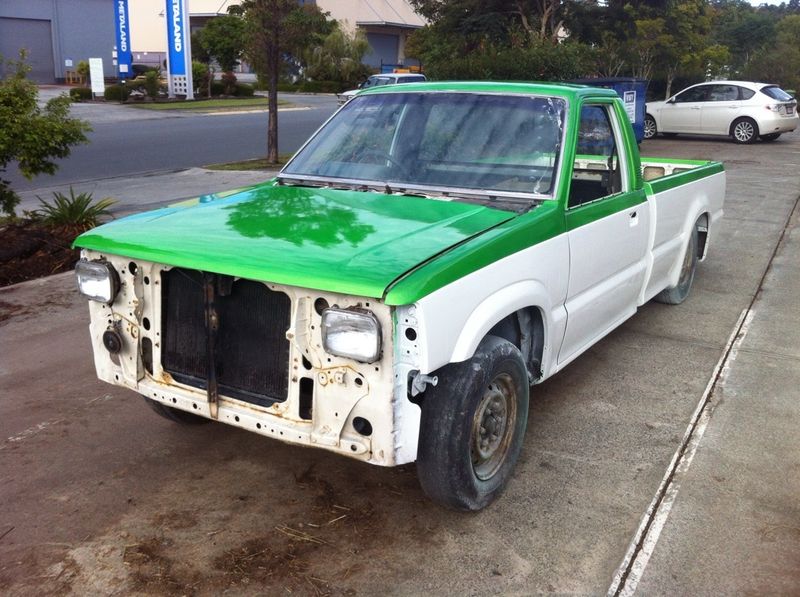

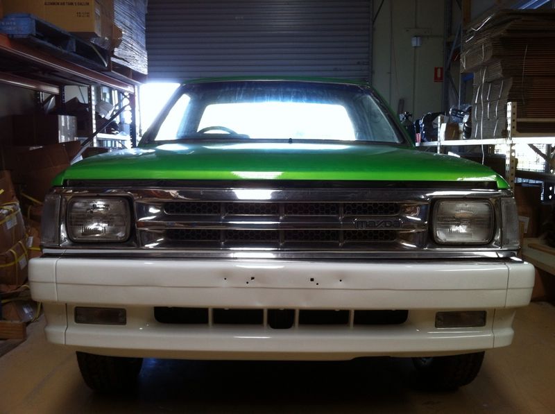

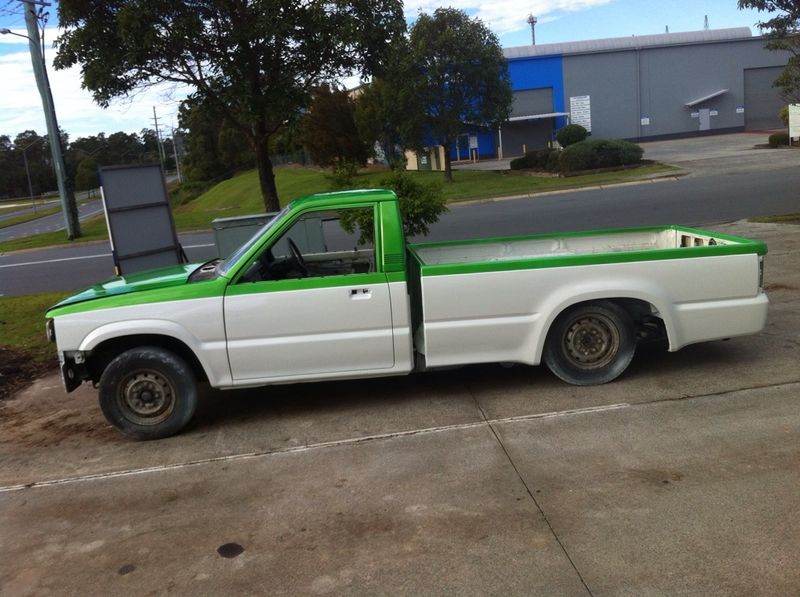

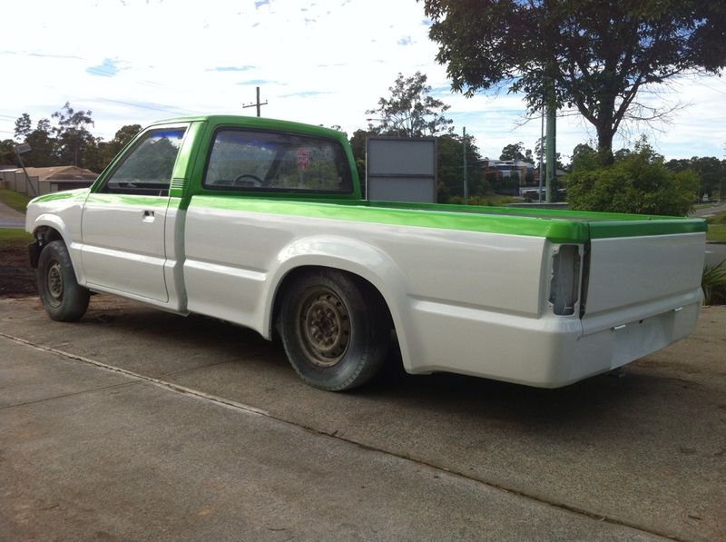

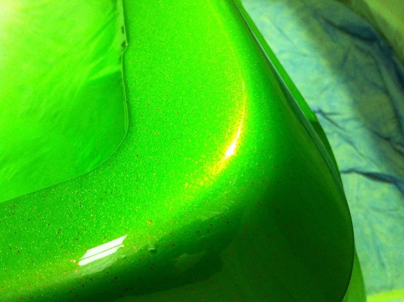

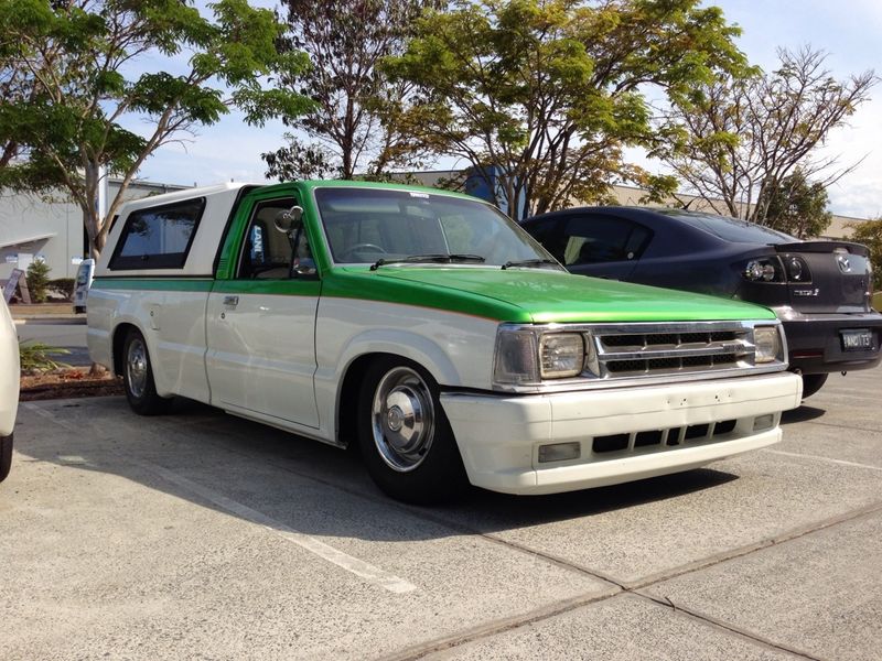

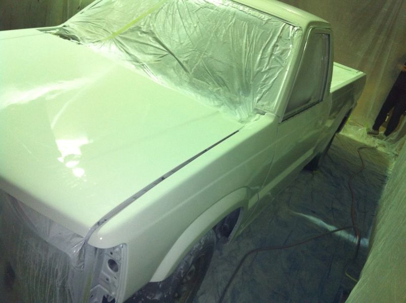

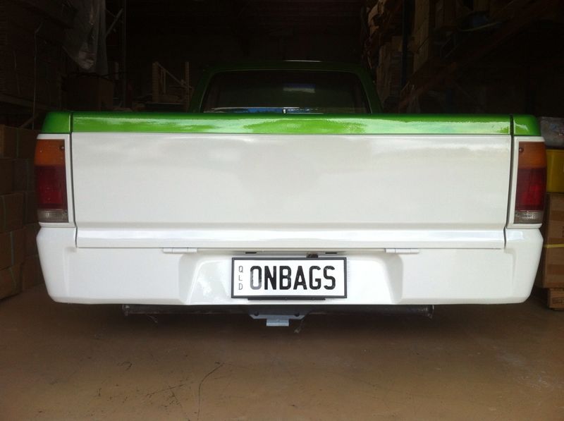

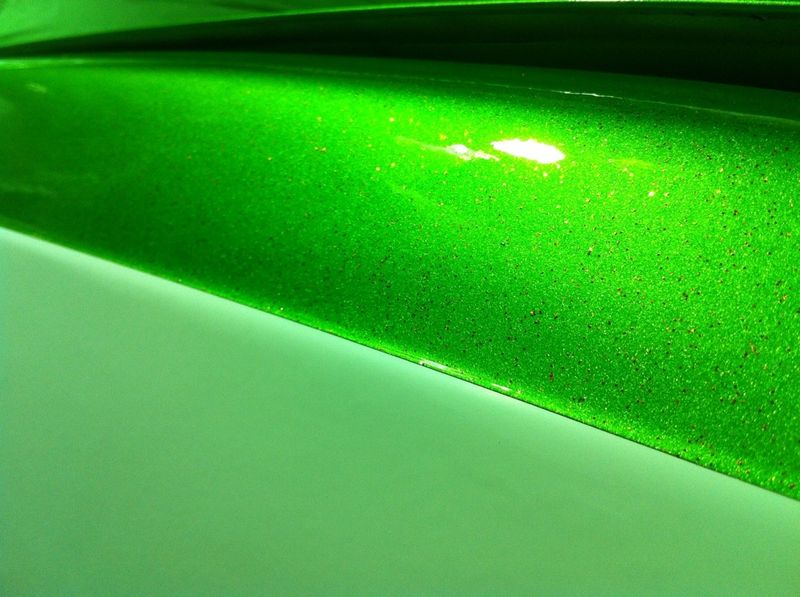

And here it is, with colour.
First I laid down some GM Glacier white 2-pac

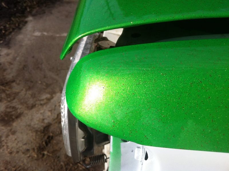

Then masked off the bottom half, and shot some Envy Green (also a GM Colour) on the top, and finished off with 2 coats of Orange metalflake clear, and 2 coats of straight clear.
And here it is outside. Its real hard to get a decent photo showing the flake.
