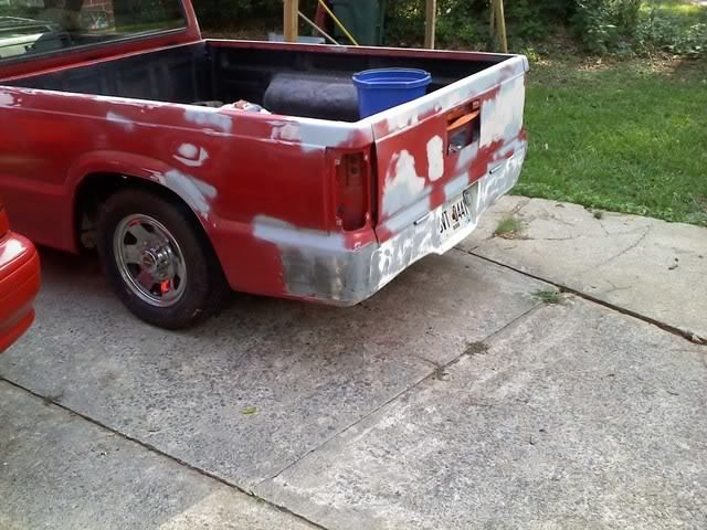

i am currently molding the rear bumper cover in and fixing all of the dents and dings and repairing the tail gate from the previouse hack job.

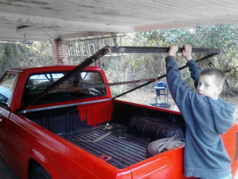

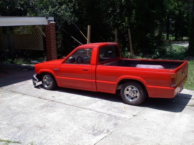

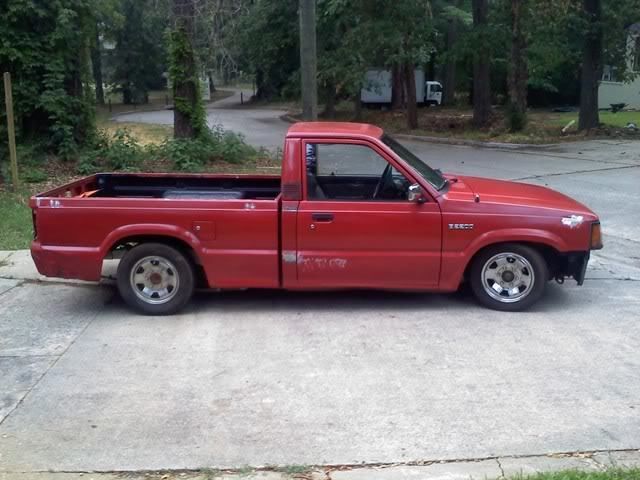

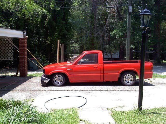

ok this is pretty much how she looked when purchased minus the bare spots i sanded to get to the rust.

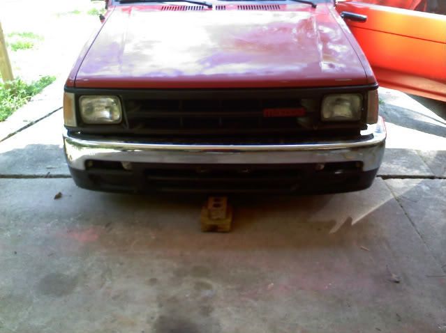

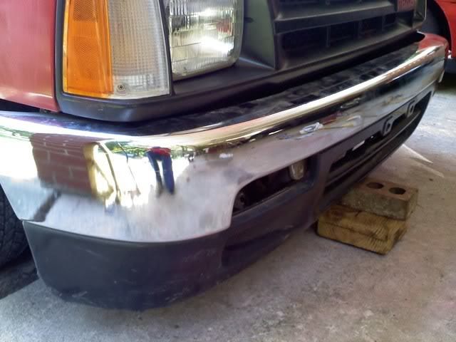

well i went to the pull apart today and scored some major parts grand total of $32.00
scored a 4runner bumper minus the turn signals.

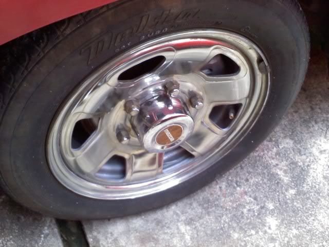

and four chrome center cap mazda covers.

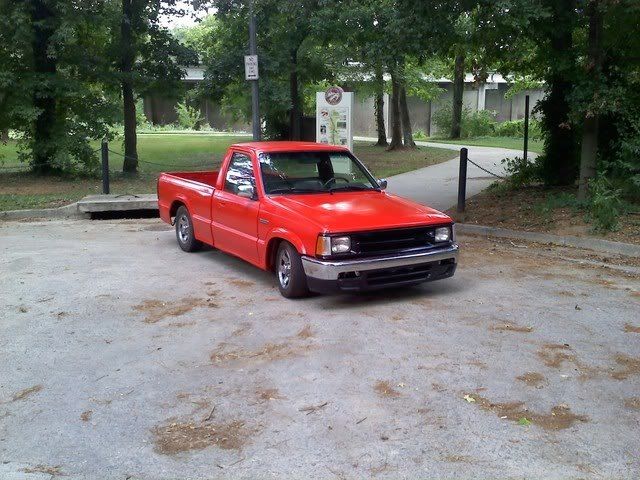

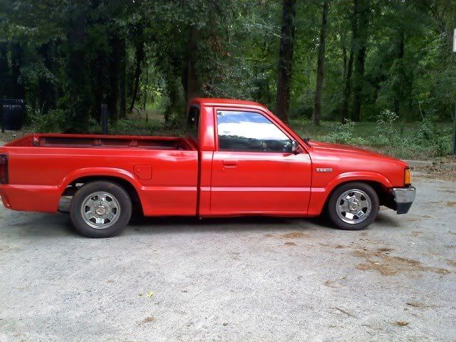

well here some more pics. this is of the molded in rear valance.
and the finishing touches on my factory chrome wheels. i scored all four for a buck a piece. ( center caps)

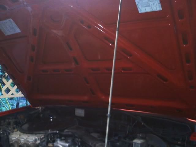

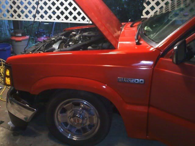

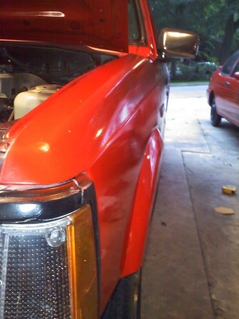

well started to paint the truck today but seems every damb time i start painting it suddenly rains.
i am painting the truck with rustoleum saftey red same as my car. mixed 60/40 paint to mineral spirits.
i lightly sprayed the underside of the hood and started jaming the truck then the rain started. so this is what i have so far.
cbegnaud
i will spray 2 more full coats over everything then wet sand and the a light coat then let it dry for 1 week then wet sand and buff.

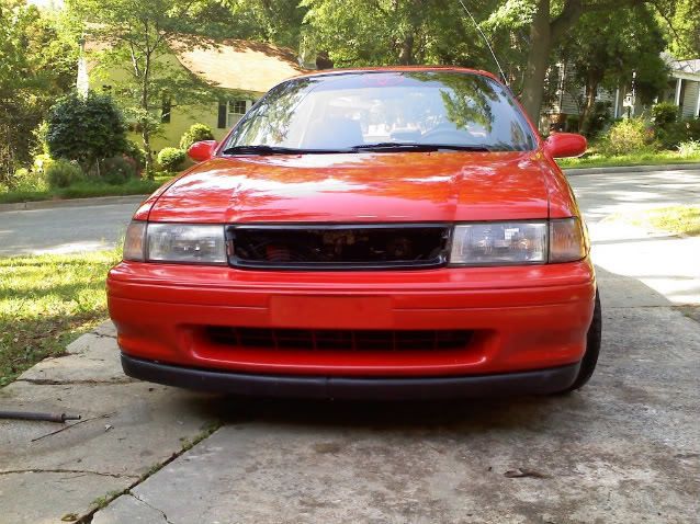

turns out pretty good for me here is what my tercel turned out when i was done.

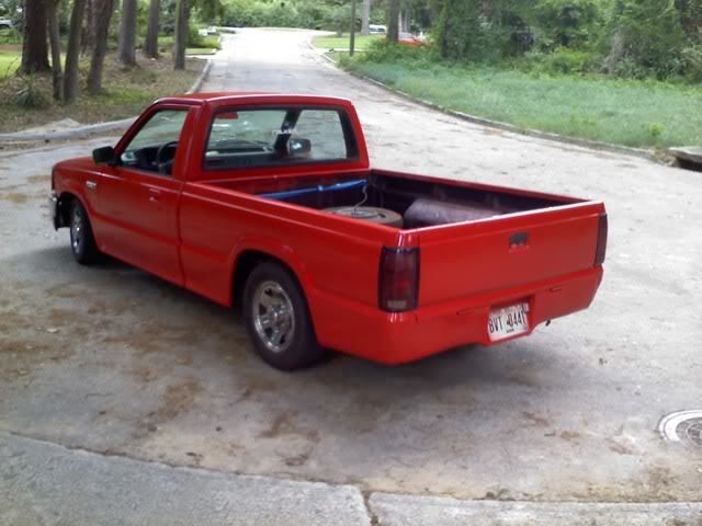

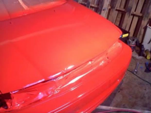

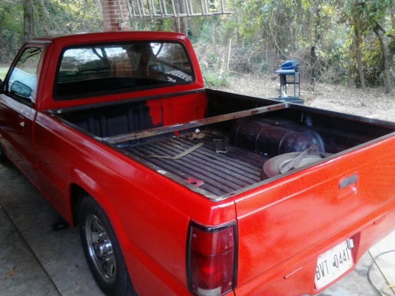

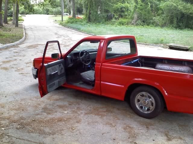

well did not have to go into work today till 2pm so i sprayed the truck last night this is the first full coat.
probably going to remove everything, weatherstripping and all and wet sand and giv it a good coat i have some sanding marks on the bed but i should be able to get rid of them after a wetsanding.
