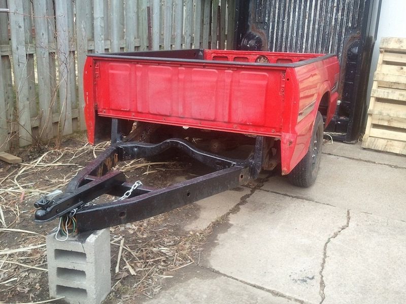

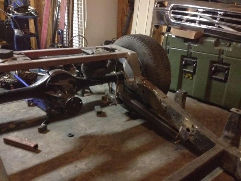

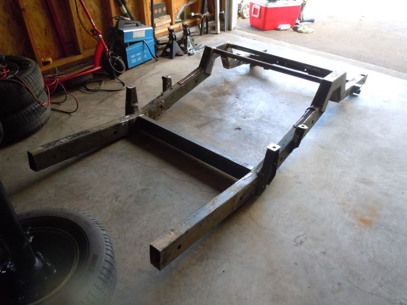

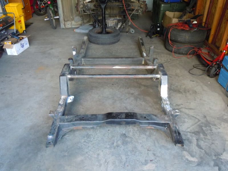

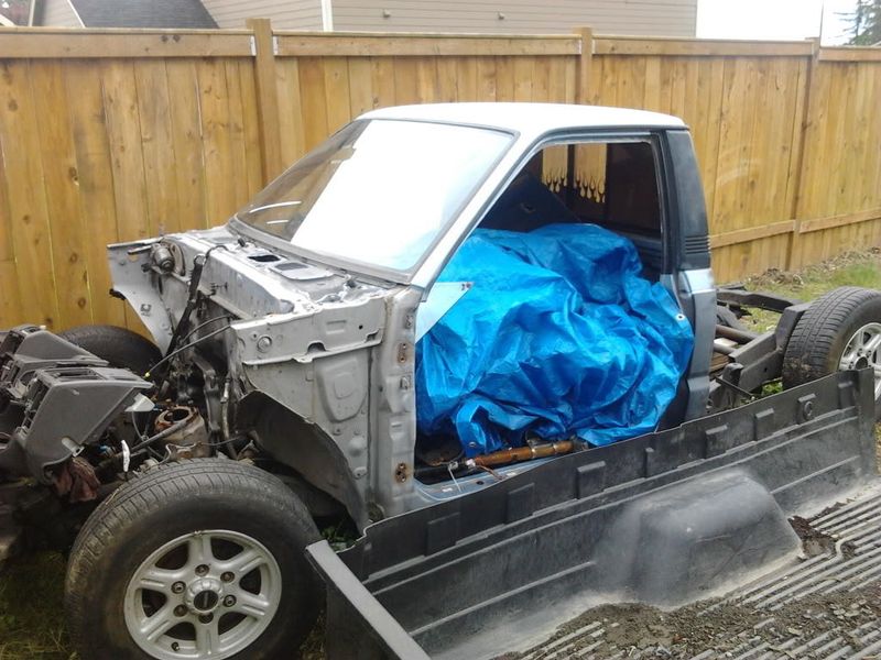

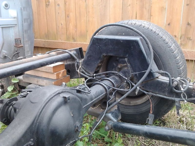

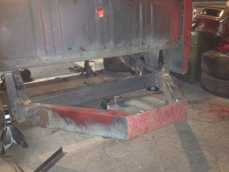

ok, after seeing the Geo Tracker and matching trailer yesterday at Relaxin, I got the itch to build me a bagged trailer matching my truck. I found this really good deal on a truck that is being parted out. still has some usable parts on it, but i'm mostly interested in the rolling chassy. The Frame is already notched with links. I have a bed here that just needs to be patched. I also have a lead on a windowless canopy, then itll be painted to match my truck and ill haul it to shows.

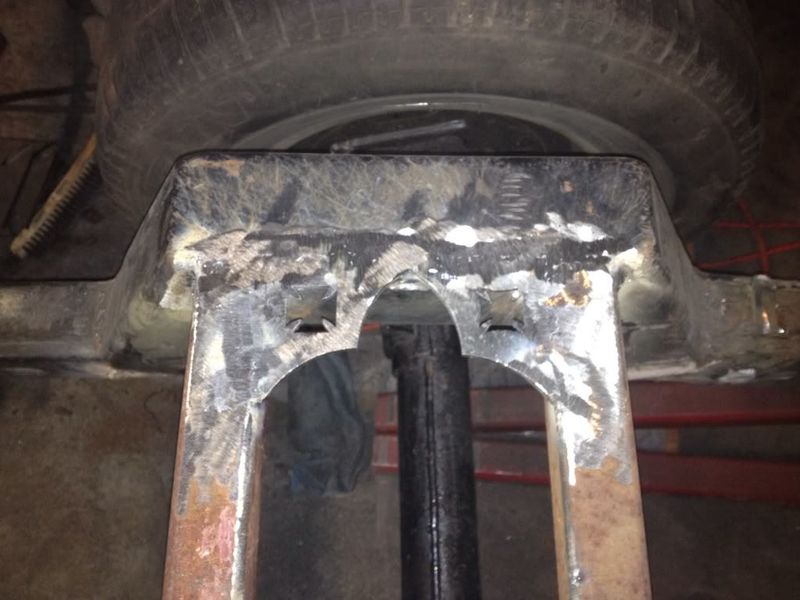

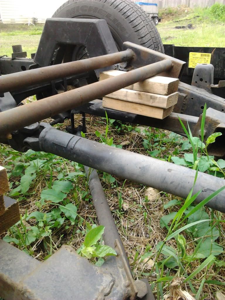

Went out and tool a look at a truck today. Looks pretty good. The welds could be cleaned up a lil bit and finish boxing in the monster notch. It currently has a 2 link set up thats ran on the inside of the frame with a panhard bar. bag mounts are set forward of the axle giving it massive lift. All it needs is upper plates, bags, lines, schrader valve and a LOT OF TLC. Im gonna use the bed I have here. Seems like a really simple straight forward build.
You think I should run a scrader or some quick connects and 2 valves to control it from inside the truck.
So here is what it looks like:
Truck
Panhard Bar
Monster notch
Post was last edited on Jun 19, 2011 11:44. Edited 1 time.

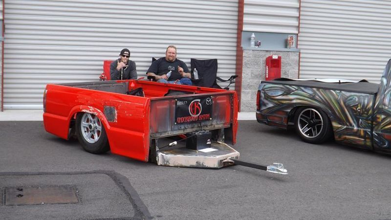

E
emjay
Like this? But of course mine doesn't have air on it yet. or currently running.....
fuel door already welded in. in hind sight I should have kept it there with a latch for some sort of light controls.
