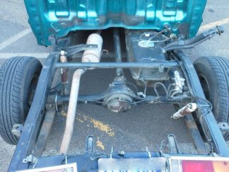

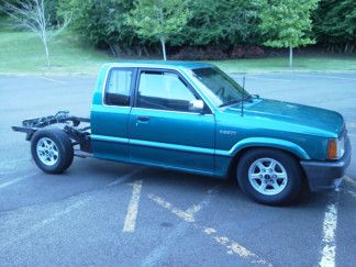

Heres a couple pictures i had to size them down for the tread. The truck is in great shape, even underneath.

Might just have to build a 4link for it If the 3link is so spendy. Also bag on bar or axle? not sure there either. Anyone got pictures of ones they built?

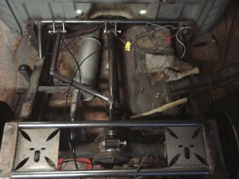

make your own three link bro...this is mine , wasnt too bad to make .

I like that3 link you got more pictures of how the rest is set up? I'm thinking that might be the way I'm going to do it.

here ya go guys easiest way , heres my build

So for now my good friend bought me some 3inch blocks and we spend most the after noon putting them on. Had to cut the u bolts shorter because they came with huge ones and only have a dremel right now. I first tried mono leaf drove it around and it hit the frame so put back in the overload springs. Love the cardomain page baddawg, I want to build a three link like that one! I'am gonna check out the local metal yard for some steel tubing. I will post some pictures from flat ground tomorrow.
