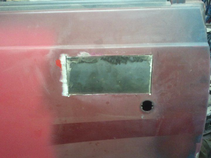

welded myh handles shut.lmao. what a pain. door skin is so thin. any good advice to not warp the drivers door like i did my passenger? its not bad but enough to be annoying. body line is stil straight thank god...

"Tack welds" best advice I can give. It's nice to get a full weld around the filler panel but in reality it is not necessary. I did a tack weld on the left side, then the right side. Top, then bottom. Now start over with the pattern about 1/4 away from the previous tack weld in that area. May not be the correct way to do it but it worked for me.
onebadkota's avatar
onebadkota
tack tack tack tack tack tack.....I like having something else to work on when i am messing with this stuff so i dont go to fast on one piece... I get antsy...So while im shaving mine currently...ive got both doors, keyholes, and a couple other things im skipping between so things have time to cool before hitting with another tack
dropped90(justin)'s avatar
dropped90(justin)
these guys give good advice. if you question at all you are going to fast then you probably are.
-Justin
bagged2.2's avatar
bagged2.2
yea i prolly was... i had it welded all the way around and filled within two hours. looks sweet tho. needs finishing touches
tterry507
You just need to take your time and skip around when you are tacking in your filler. You can try a wet rag to cool the tack down. You will not get away from it warping but it will keep the damage down.
Good luck!
E
emjay
yeah the wet rag around where you are welding, keeping it wet and cool should help keep the warping to a minimum.

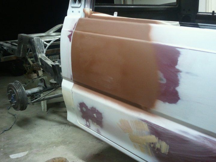

well heres the progress on the doors. driver just tacked and passenger gettin smoothed out
charlesskelter's avatar
charlesskelter
Just a tip for the future or other who are looking ti shave their doors, it's best to round the corners instead of squaring them off. It's much less likely to burn through. The body worked door looks good!
immortal1 (linn)'s avatar
immortal1 (linn)
Good point Charles on the corners. And from what I can see the passenger door looks great!
