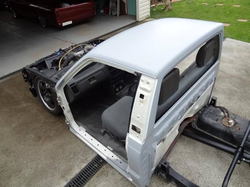

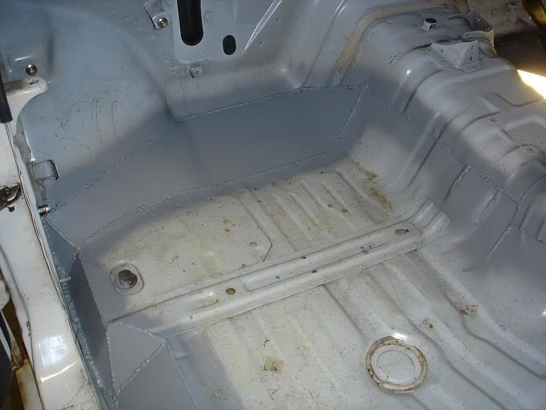

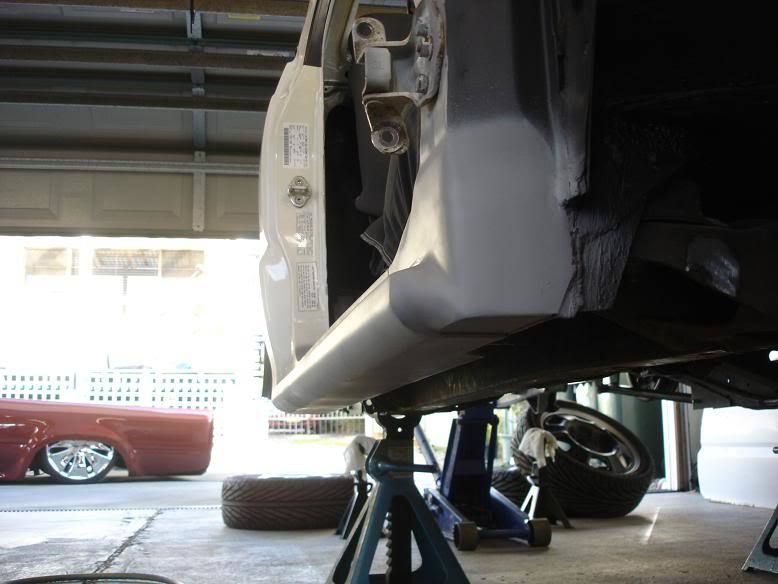

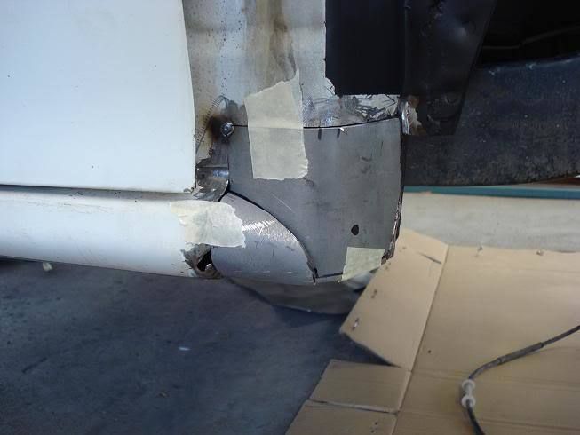

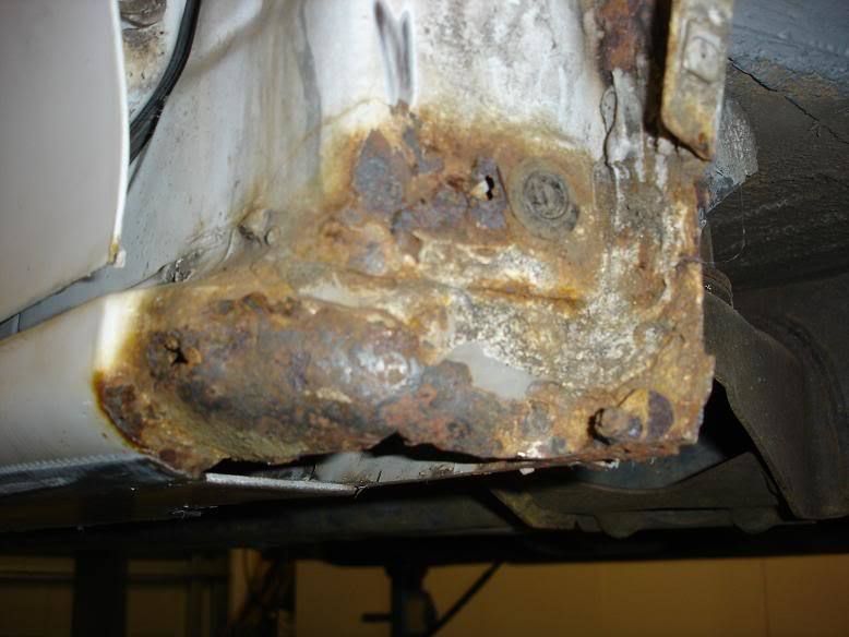

first thing i did was bodydrop the cab. i used the tech article seth did for minitruckin as a guide.

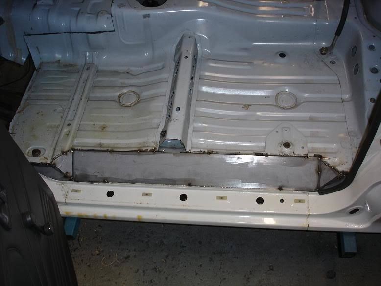

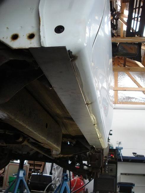

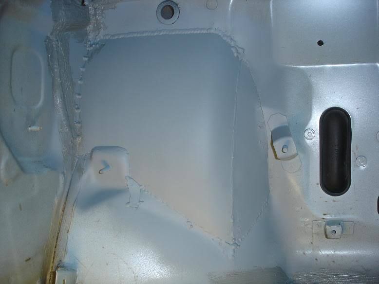

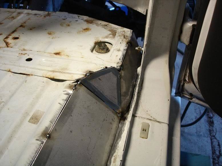

new 3mm sills
filler panels
b/d all done
modplant's avatar
modplant
Welcome to the scene, I'm liking it so far. I really like how you did the transitions for the floor, and of course the new sills.

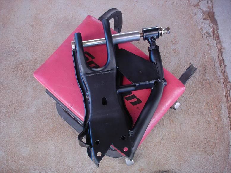

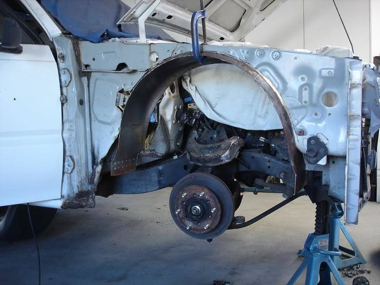

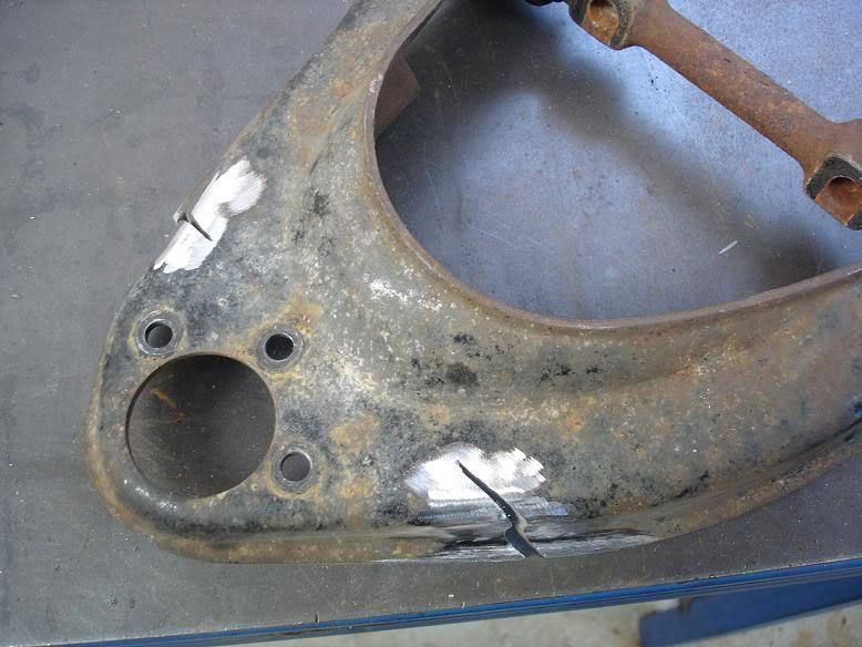

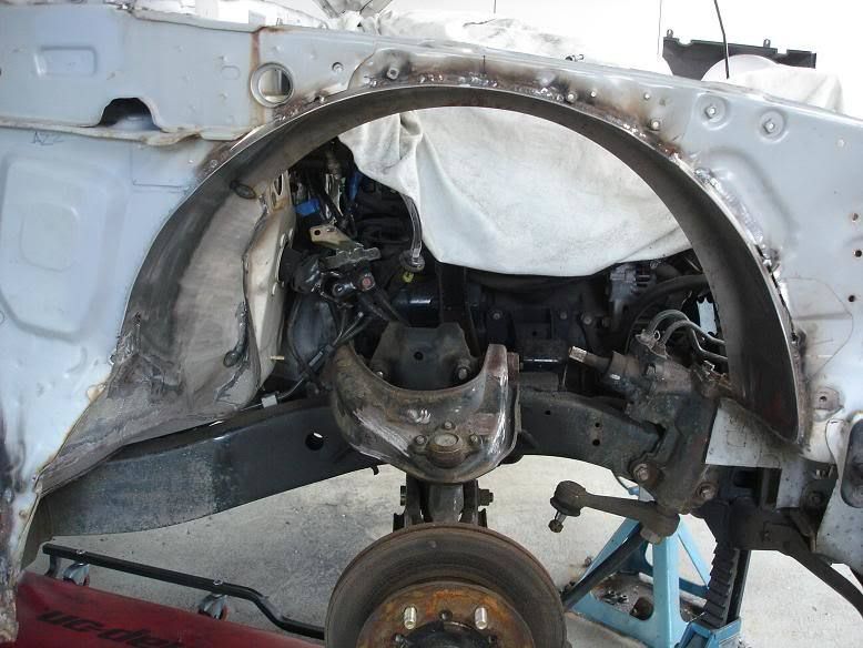

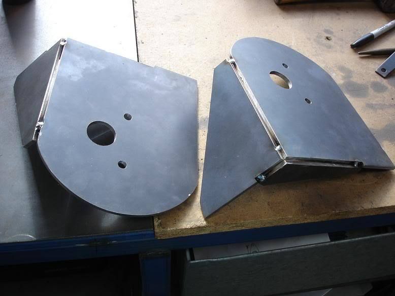

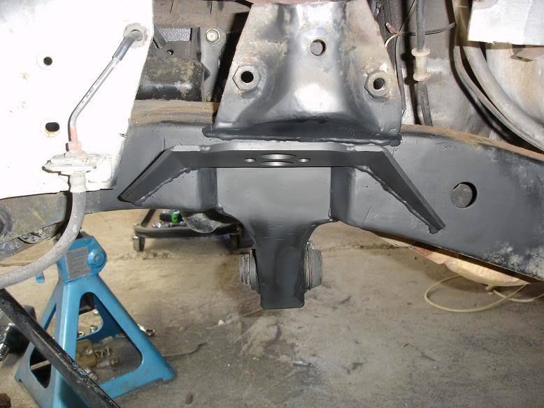

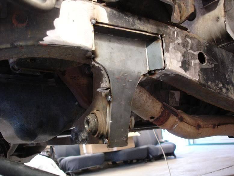

next i moved onto the bags, i copied what a friend of mine did on the front of another mazda
had to pie cut the uppers
cut some of the lowers
notched out for bag clearance
bag bracket finished
modplant's avatar
modplant
Top notch work sir! And mig welds as smooth as they are supposed to be too!

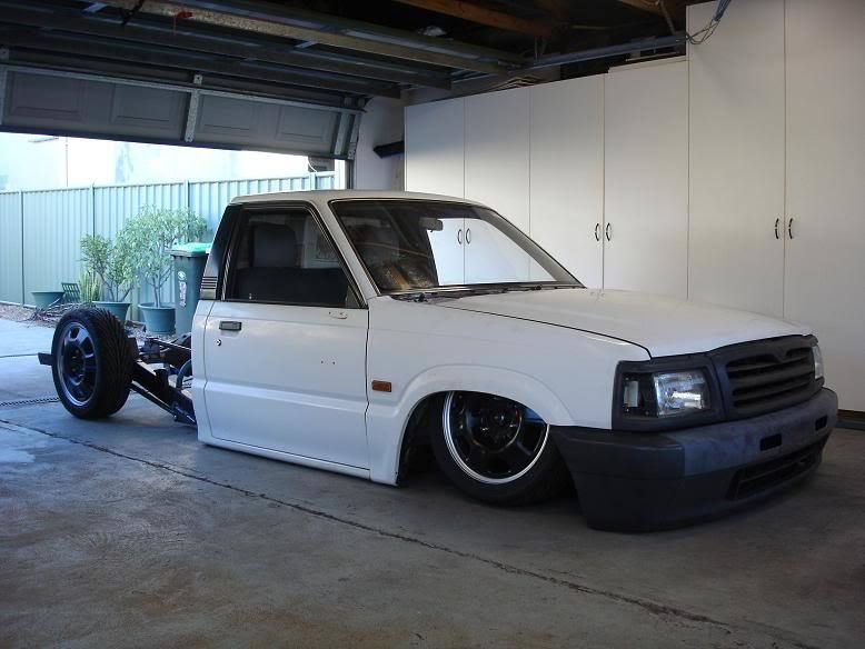

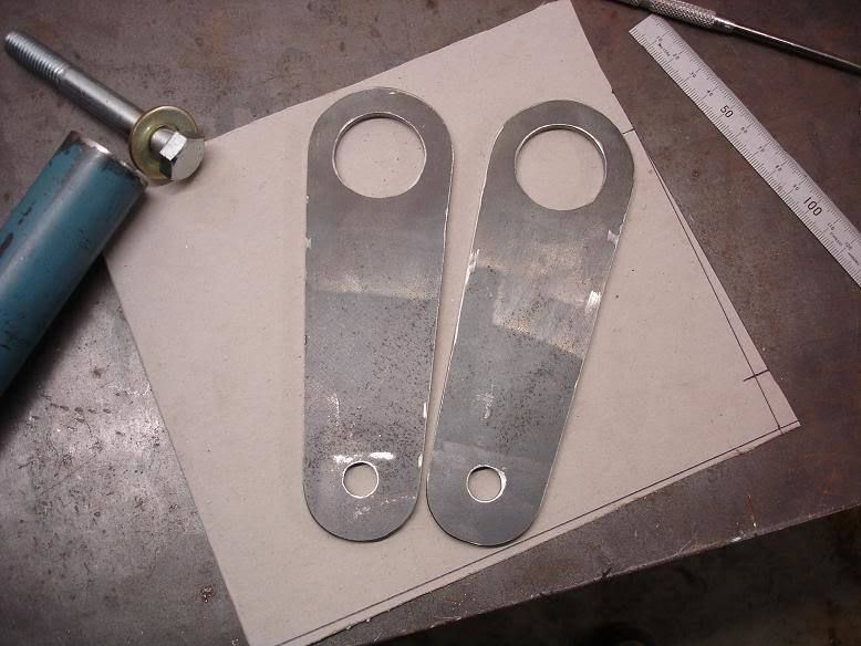

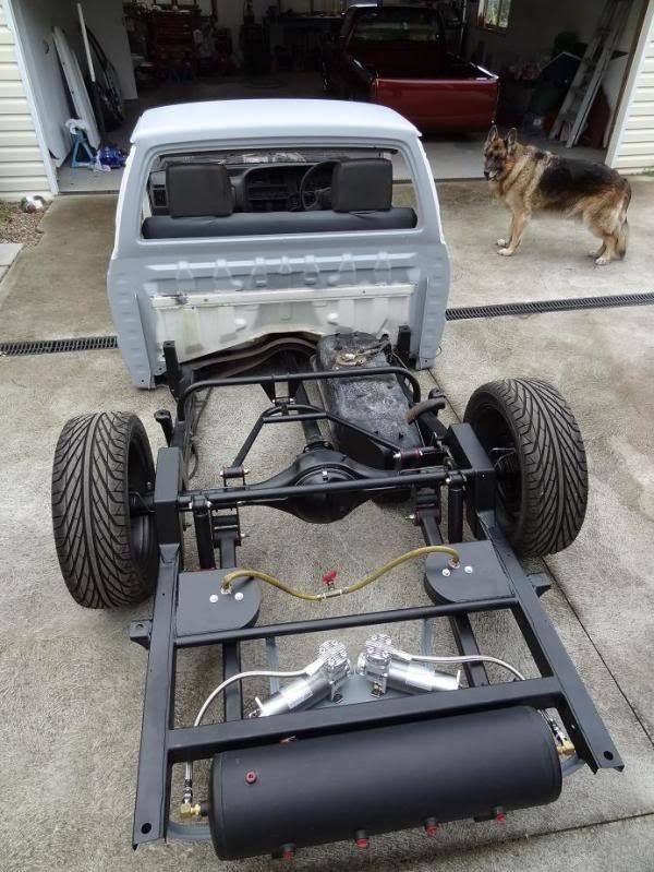

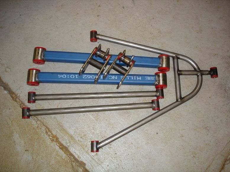

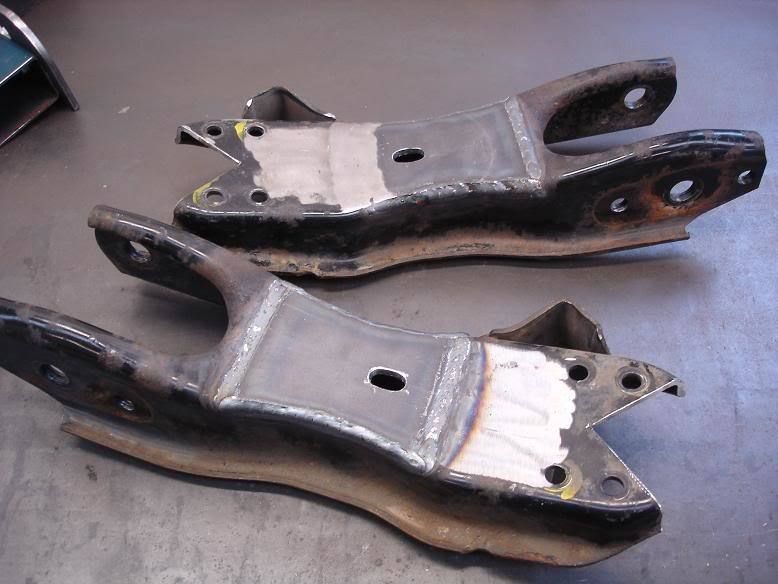

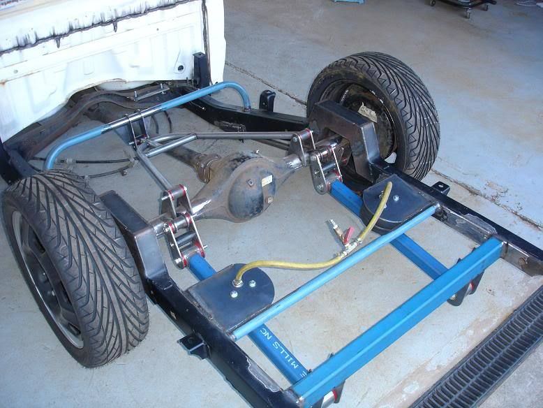

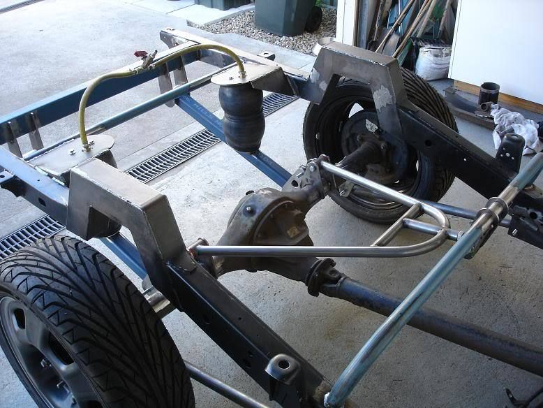

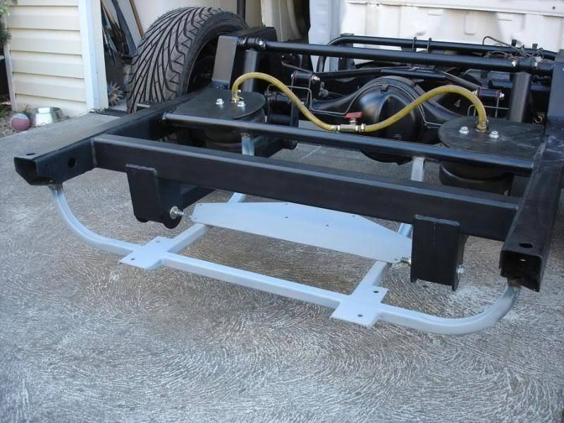

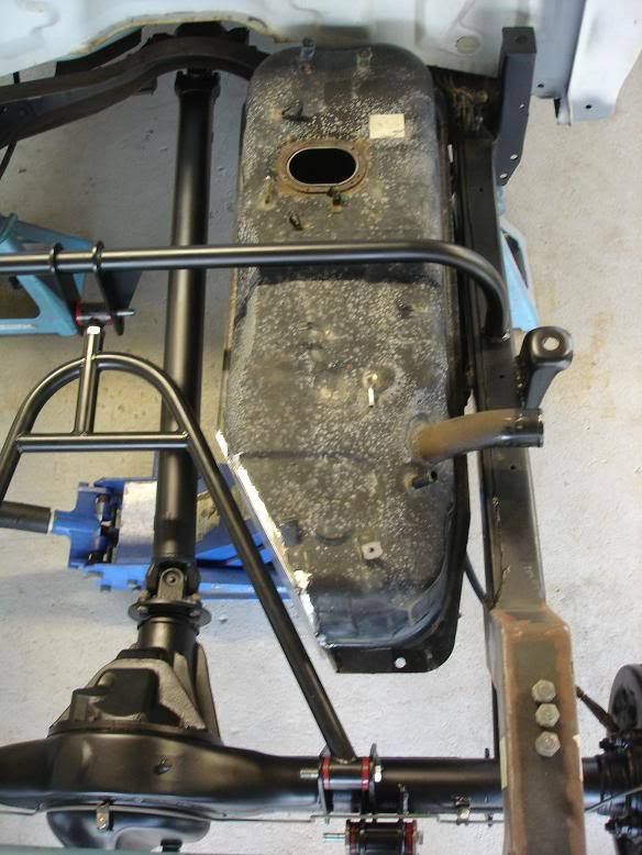

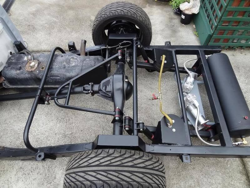

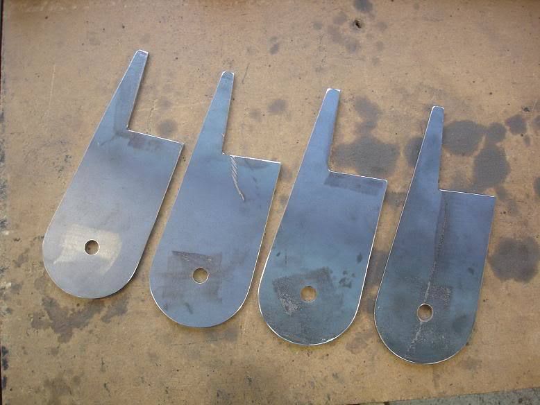

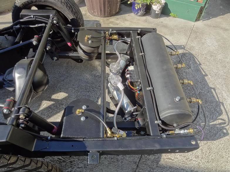

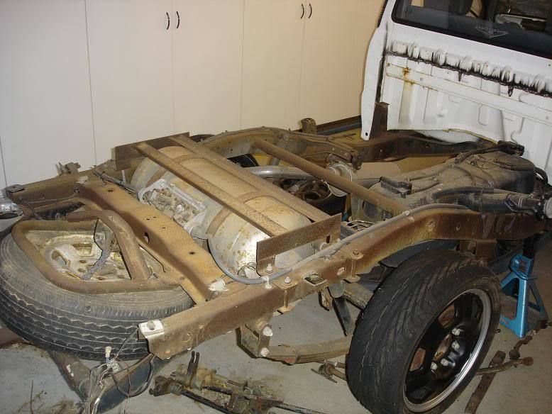

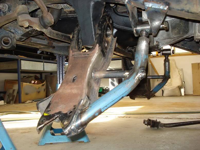

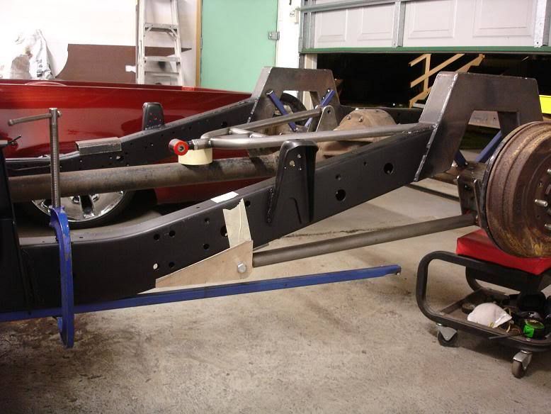

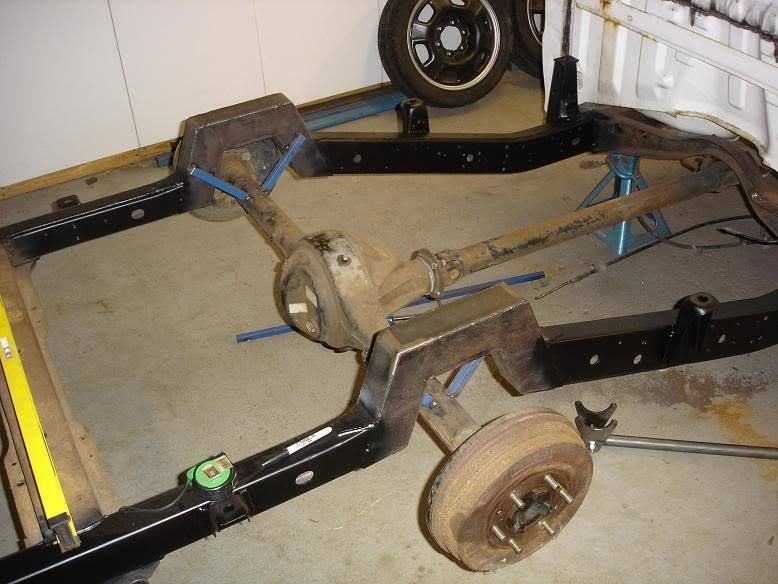

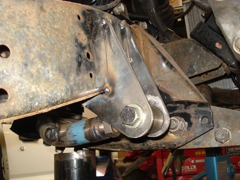

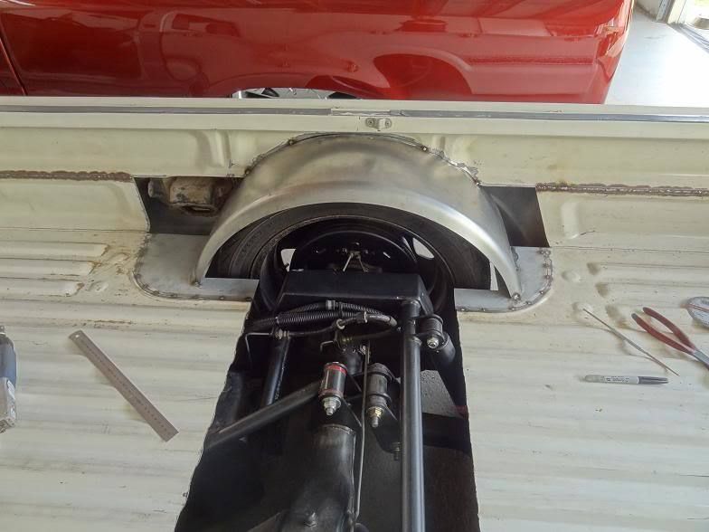

the rear was next and i wanted to keep stock tank location and have bag on bar so i designed a 5 link and had a local truck shop make it. i took it home and fitted it up. i made all the link tabs and bag brackets.
started with this mess
now looking a bit cleaner
5 link
setting up links and making brackets
top link brackets
rear lift bar brackets
azzlow

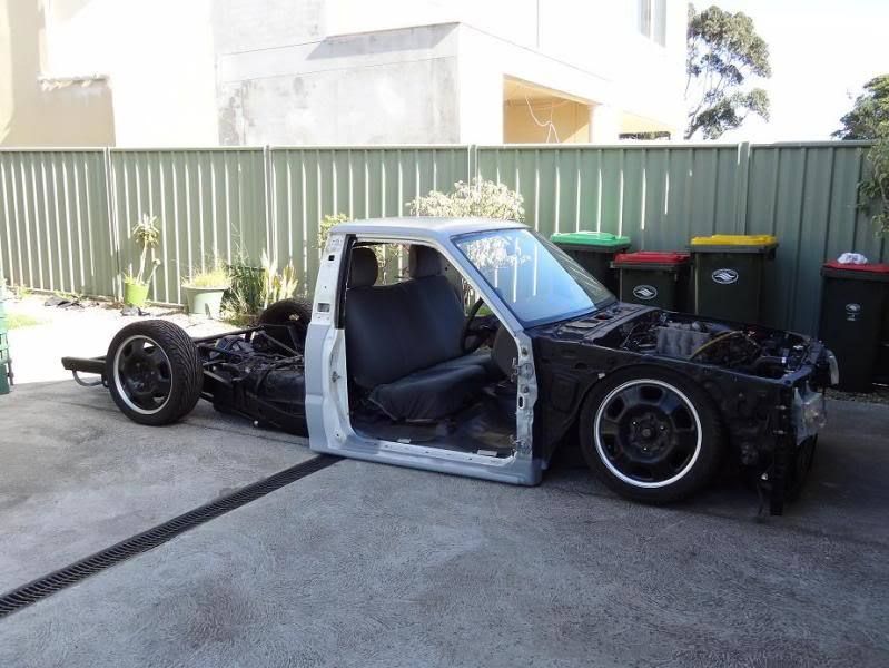

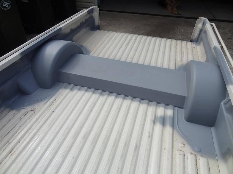

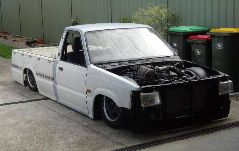

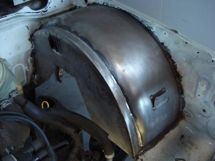

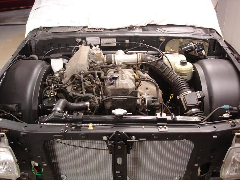

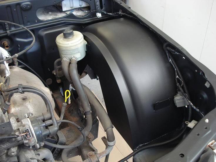

i tubbed the front, relocated everything in the engine bay and painted it.

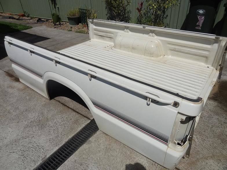

thats where i am up to at the moment. i have not got a bed for it so i need to get one asap.

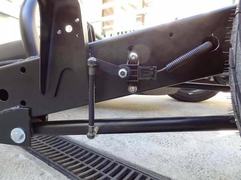

nice work......but i think you need to re-angle the wishbone so that its parellel with the lower link bars. at lift the rear end is pitching downward and messing up your pinion angle.

Very nice work. Was this truck a gas/lpg hybrid? That was a huge tank in the rear.
azzlow
The wishbone is parallel it just looks messed up in that pic. It's at 3 deg pointing down through the entire travel. It's fine at ride height.
Yes the truck was on LPG, I worked at a place that fitted lpg to cars and actually fitted this car when it was new in 98. That is how I came to own it, the owner blew the head gasket in 06 and towed it to us then couldn't afford to fix it so I got it for $500.
