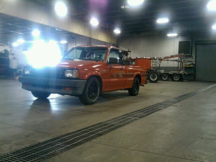

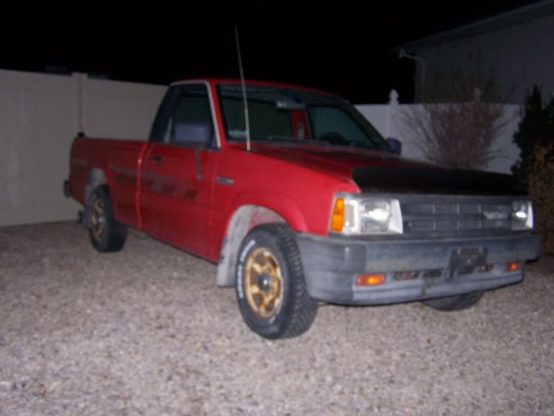

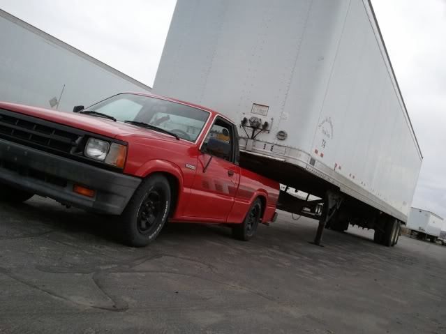

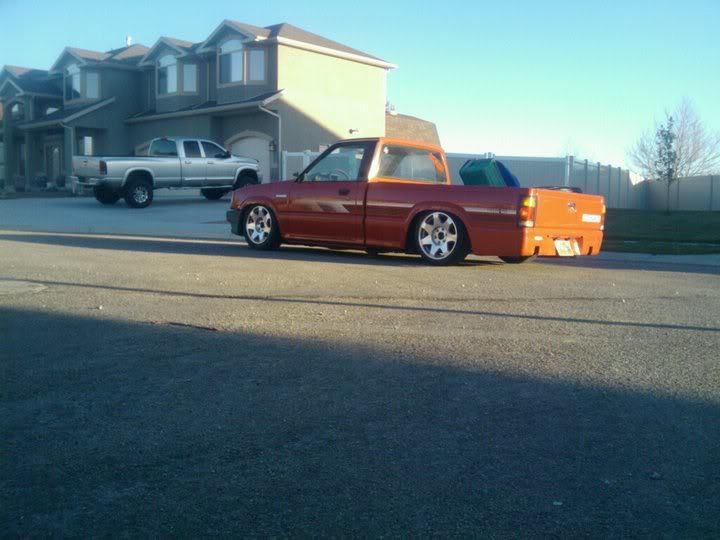

here it is when i bought it last week....

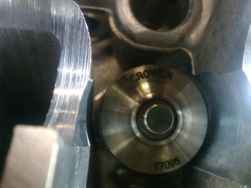

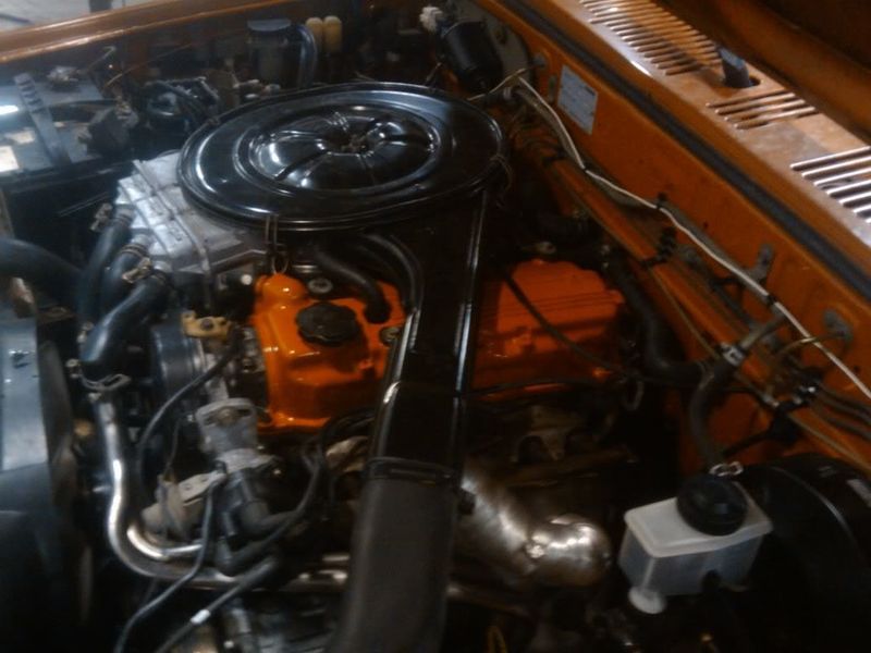

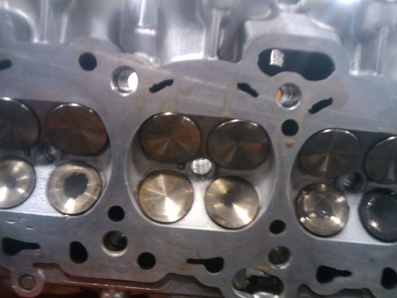

it had a blown head gasket, so i pulled the head off, found it warped.. planed/milled it flat.... took ALOT of material off... damn near got to the combustion chambers...
got it back together and she runs like a raped ape!

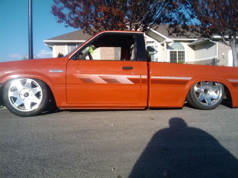

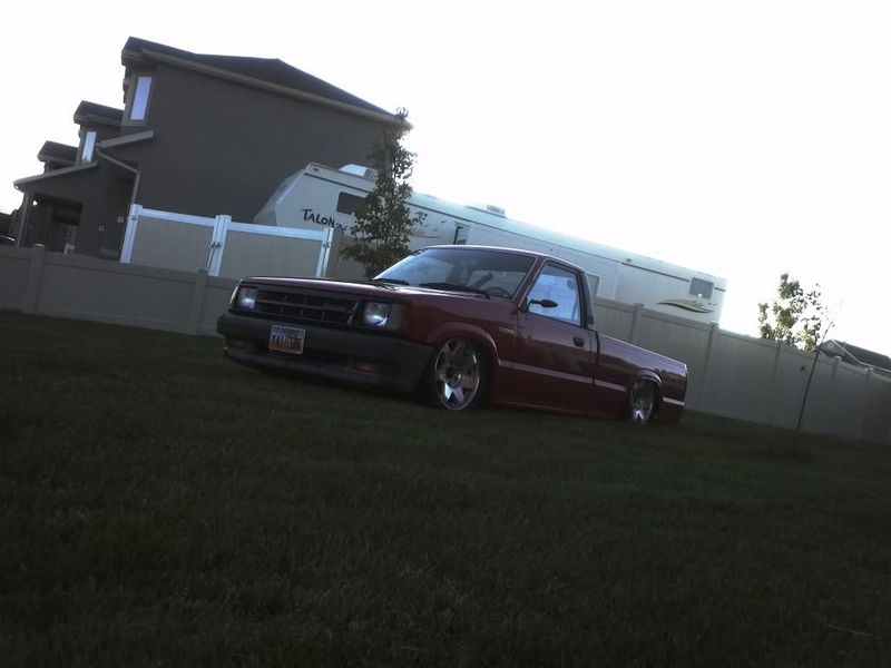

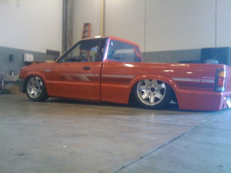

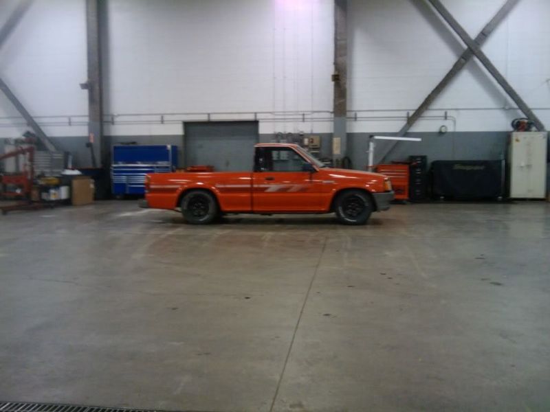

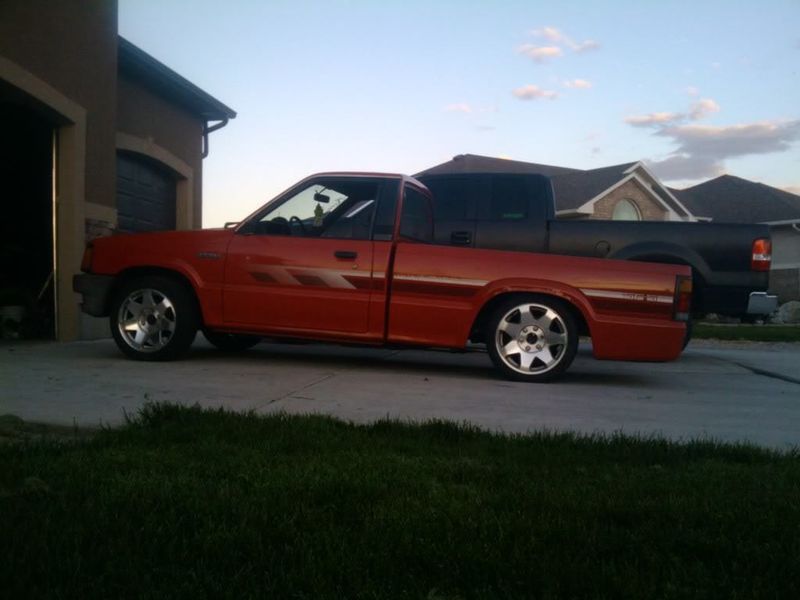

here it is as of today...

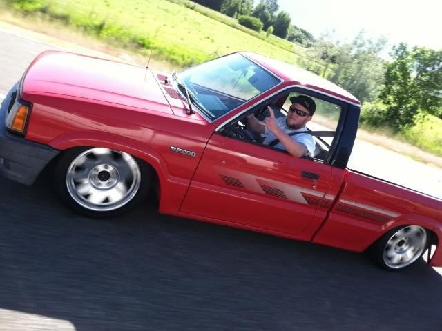

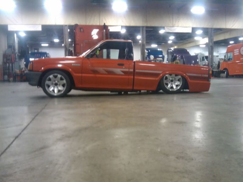

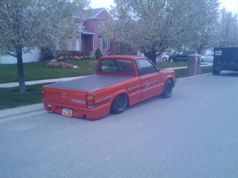

re indexed tbars up front., two leafs with a 1" block in the rear,cleaned and painted the wheels... last weekend had a buddie that runs his own detail business buff it too..
looks good im amazed it blew a head gasket with only 74,000 on the clock
rotten
yeah, the kid said at begining of winter when he got it from his grandpa the heater didnt work. it ended up getting a timing belt,water pump,all new pulleys,new tensioner too. he drove it till like a month ago, blew the bypass hose, ran outt of coolant and overheated on him. never to run again. well untill i got it im 530$ total into this truck and it runs amazing!

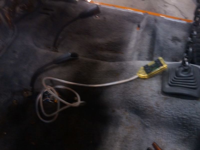

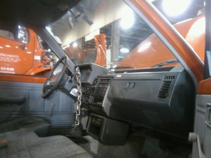

dang man i kinda like the shifter with the chain.
rotten
Thanks man. Kinda stole the idea from a buddie . He has one like it in his slammed big block powered c10
lofosho86's avatar
lofosho86
very clean truck to start with!good luck with the build!the chain shifter is sweet i made one for my father in laws 78 el camino!
