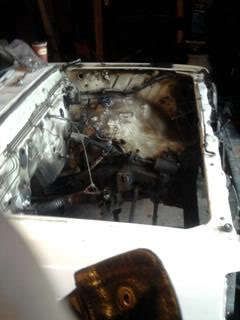

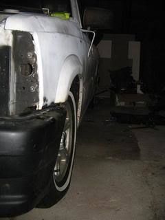

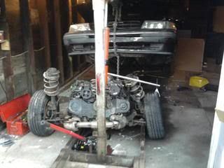

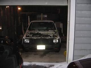

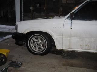

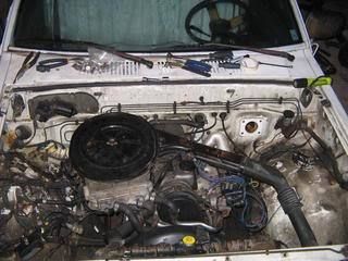

update with pics time. so from my last update i managed to pull the wiring harness out of the subaru. thursday night my dad had a great present! he got a free engine hoist from work so friday i pulled the mazda engine and tranny out, exhaust is out, took off front bumper, torsion bars and driveshaft. next to come is to push the mazda out of the garage and pull the subaru in for measuring and engine removal next getting exciting! few pics from my phone
theres the update what are your thoughts/critisism/advice let me know thanks for following

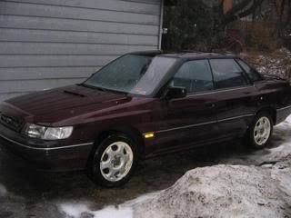

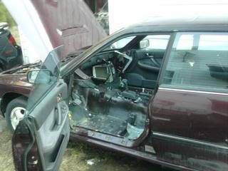

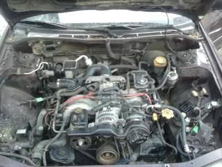

guess i never showed the subaru! heres where she lays for now
few pics i forgot to upload on the updates before

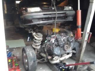

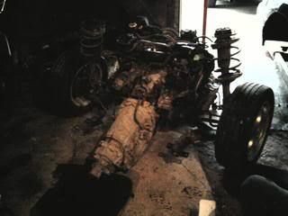

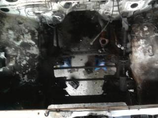

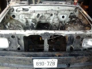

update time
subaru subframe has been pulled. it includes struts, engine, tranny and steering rack. i also cleaned out the subaru engine bay. next i need to pull the subaru out and start measuring and fitting the engine in
