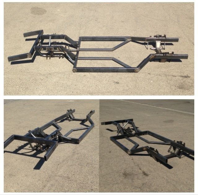

Just completed this chassis today. It's the third I've built for a customer. Got 2 more to do exactly the same
Uses c5/c6 corvette a arms, spindles and hubs, coilovers and a rack n pinion, and a new camaro differential
Looks pretty good, are they being used for kit cars?
g_e_0_f_f
No, it's for a 63-67 vette. Puts an independent rear in and adjustable coilovers.
I guess I should have paid more attention to the title lol, is the owner going to put in a LS motor too? I wish I could follow this build up.
g_e_0_f_f
I've basically been contracted to build these chassis for a customer who sells em, cross-country. He builds a few classic vettes here and there but his main business is retailing the chassis, then he adds the suspension components and drivetrain components. He's got a basically brand new LS3 with a 6 speed tranny out of a brand new wrecked camaro, 400+ horsies, and putting it into (I think) a 63 stingray style convertible. I don't know much about vettes but I think that's what he said it was
