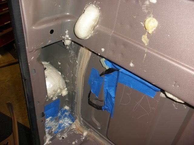

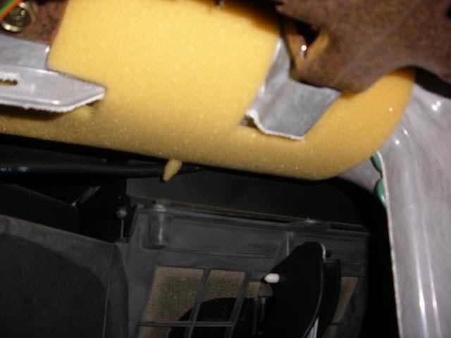

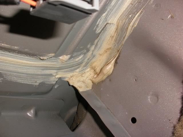

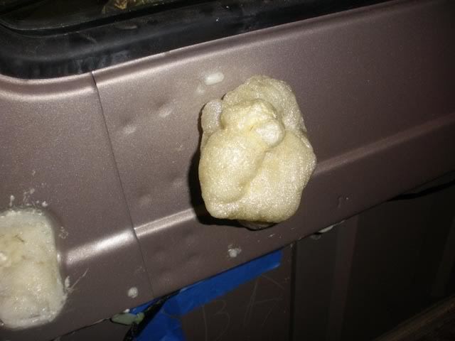

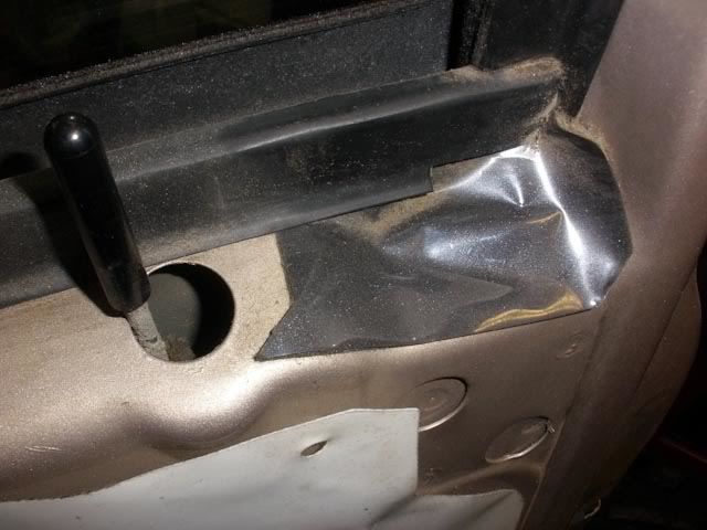

I found a leak in the back window and the cab was "extra" loud so I used a couple cans of Great Stuff to sound deaden the back wall and B pillar areas. This also acted as a space filler for better bass response from my back speakers as the cavern behind the seat belt mounts made the old stereo echo. Here you can see how much that foam expands. In the second picture you can see I backed up the holes with painters tape. That seemed to help keep the overflow down...

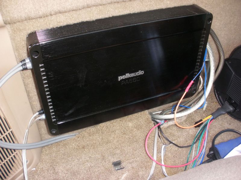

The placement of my amp, 1000w, and 250W 10" sub.

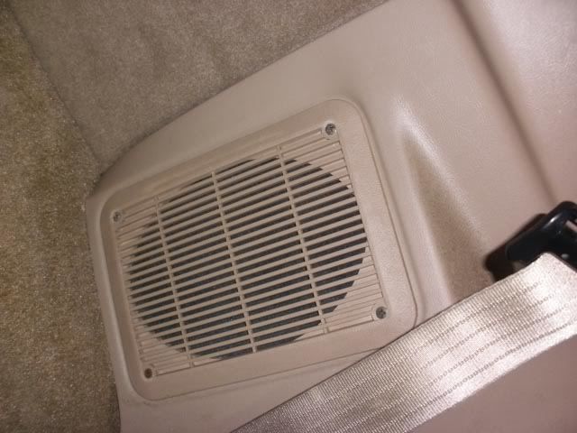

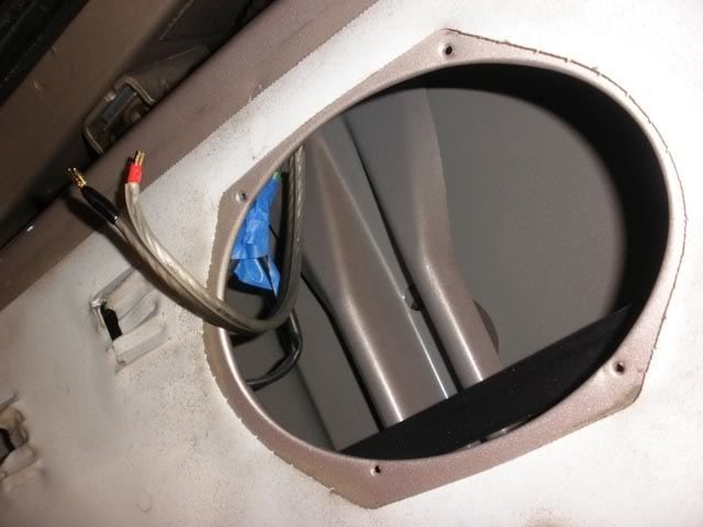

6.5" Polk marine speakers in the doors and back mounting positions you'd never know I replaced them.
The door mount...

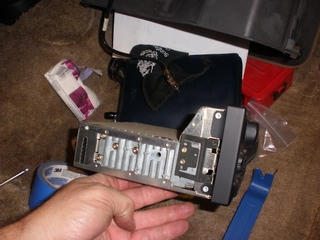

The old stereo was a double din fake!!

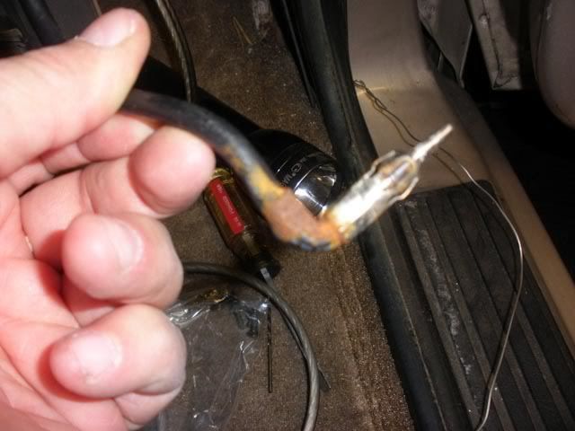

Can you guess why I wasn't getting good radio reception? I replaced the antenna too.

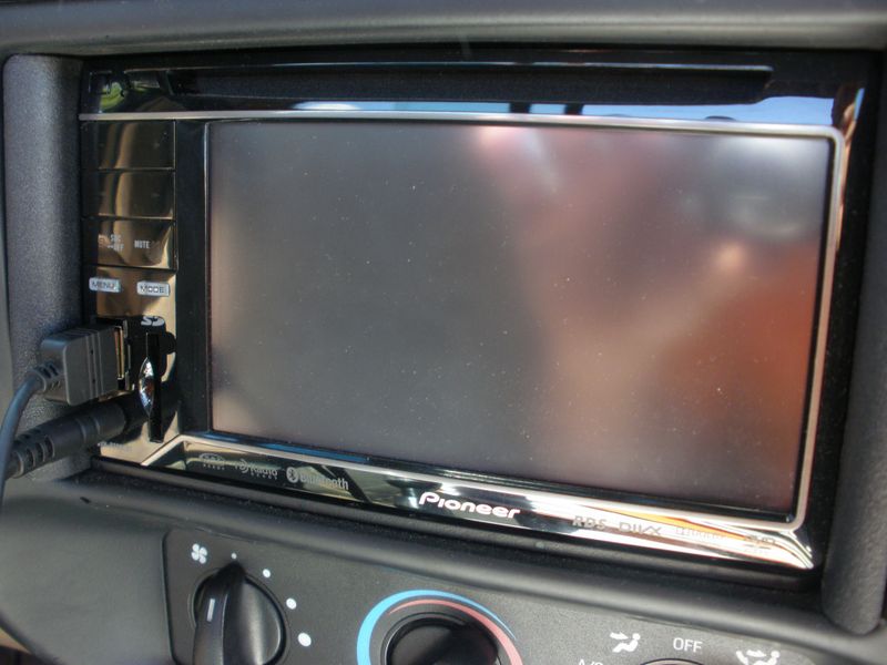

The dash mount... I used a double din mounting kit that came with the stereo, I bought a Pioneer touch screen job I'll show later.

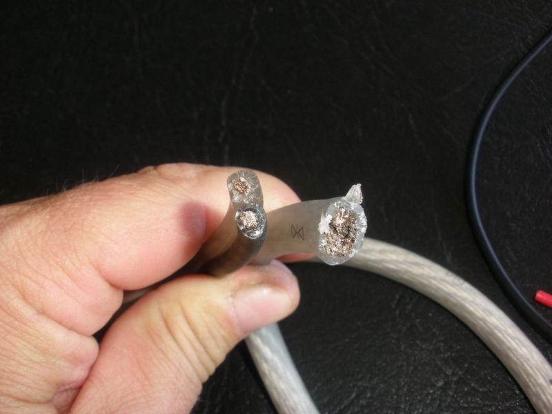

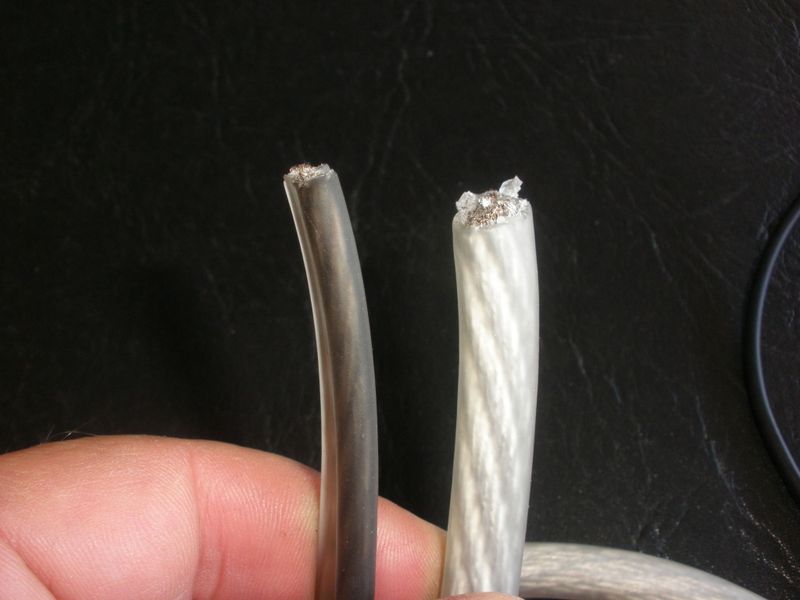

I used 10 gauge wires for the speakers and 4 gauge wire for the power and ground lines... I bought a wire kit from Best Buy but next time I'll just buy lengths of wire from Lowes. It won't be as flexible but I don't think it matters.
Here are the differences in wires from the power and speaker lines.

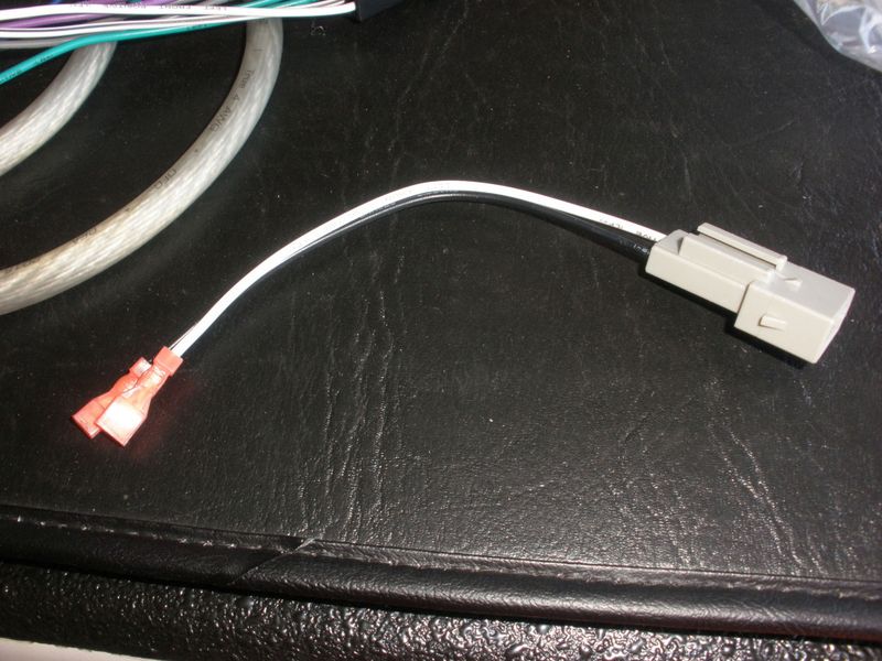

My Crutchfield kit came with wire and connectors for the speakers, which I didn't use because the wire connections on the speakers were much smaller, so I used direct connections instead. I think those are mainly revered for when you use the factory harness connections/wiring harness. I used all new wires as shown above.

Heat is a killer for these so you need to make sure you have them in a well ventilated place. Most people put them under the seat but my floor was not flat and left no room under the seat for it. I installed mine on the back wall and even with the seat all the way back it has air flow across it all the time. this AMP is a Polk Audio 660.

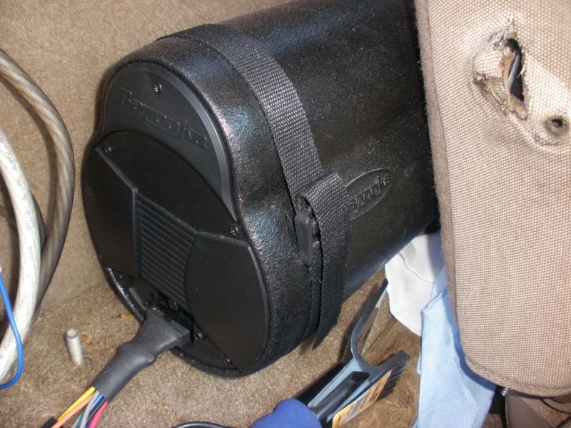

I started with a powered Kicker 10" sub but the driver seat had to be moved too far forward and was uncomfortable to drive. I changed to a powered 100W Bazooka 6 inch and installed it in the same place. It's definitely not as powerful or full sounding but it get's the job done.

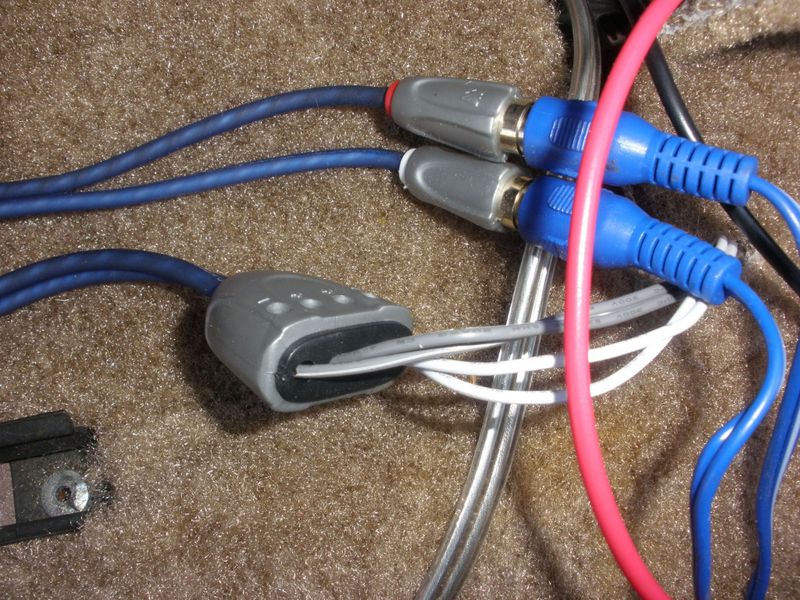

I used a kicker "converter" to hook up bare wires to RCA plugs. This worked great!!

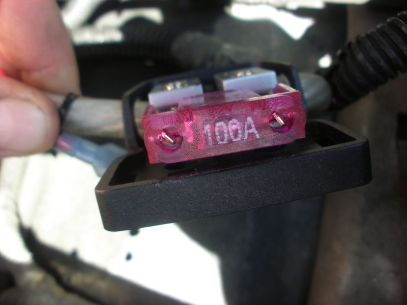

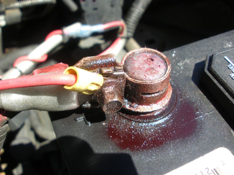

A 100 AMP fuse to protect things... a new battery with anti-corrosion spray on the terminals.

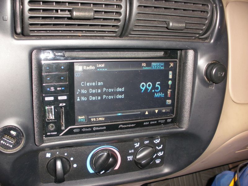

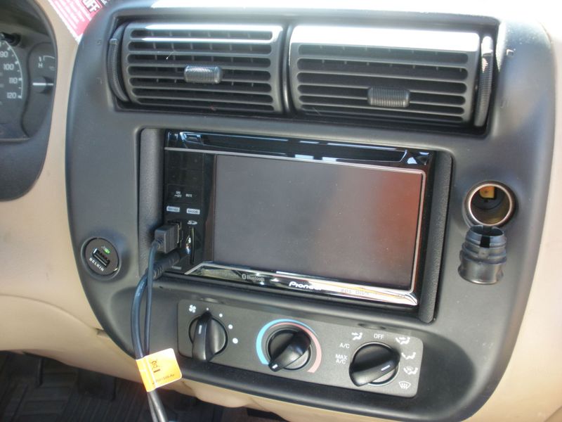

The finished product... It looks as though it was always there.
I picked this unit because it had:
Touch Screen
DVD
CD
DVIX
Sub preamp outs
Main preamp outs
BlueTooth phone control with hands free operation.
RDS
Satallite radio - If I choose to use it.
Full Ipod control
Video playback
USB and SD card readers
and a lot more...
I love this head unit!!!
The old stereo...

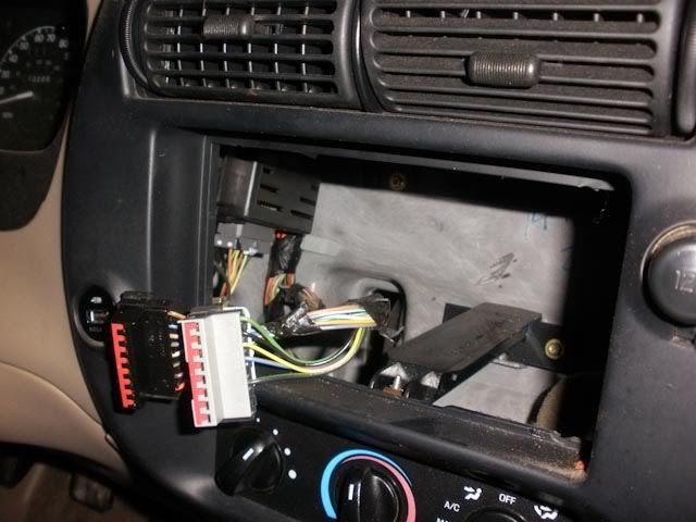

You need these to take it out, if you don't remove the entire radio bezel.
See the small back support piece in the middle, I had to loose that because the new unit didn't fit.

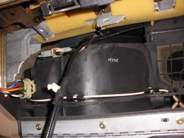

You also need to loosen the dash, yes the entire dash to get the new antenna installed. It has to make a really tight turn to get the line past the back of the air duct behind the glove box. It too has to be taken out - the glove box and door that is.

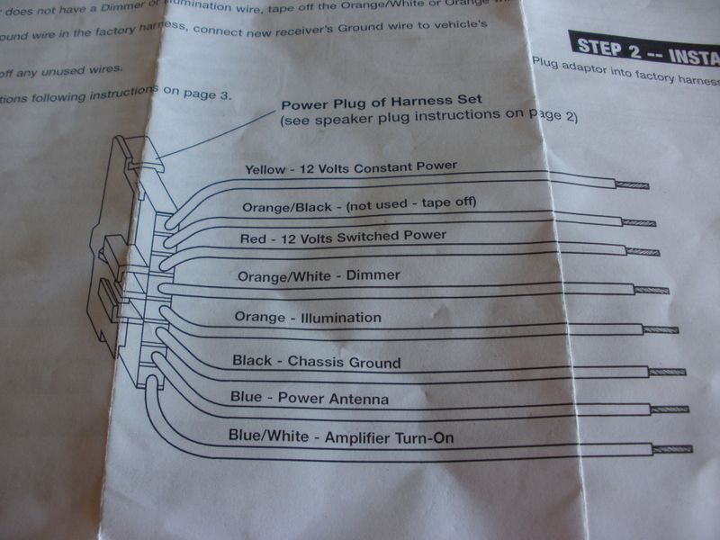

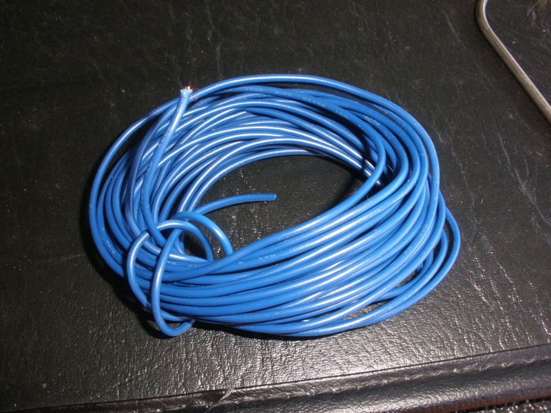

If your route your wires around past the doors you may need more "remote" turn on wire, I just bought a big spool because I knew I'm going to redo my B2200 too. This is the line used to remotely turn on the AMP and sub so they are only one when the head unit is on, not draining your battery.
