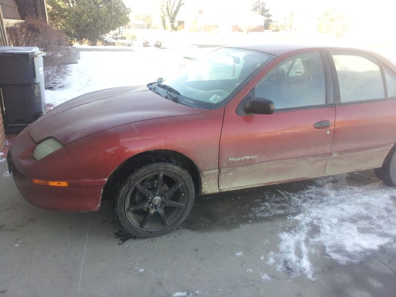

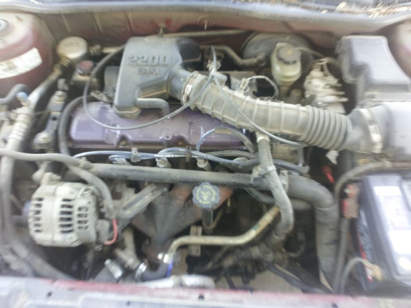

Well my wife has a 99 pontiac sunfire se 4 door with a 2.2 liter ohv motor.
The issues we're having: 1 power steering issues: I have PS but it whines and kind of makes a grinding noise. 2 transmission: it has an auto tyranny that is about 4-5 yrs old. It doesn't engage into drive 2nd or 1st gears when it's cold whenever it warms up it shifts right into gear. Also I've noticed that when I turn a corner fast the trans slips it doesn't slip any other time but it does then.
The good: 1 well we've had this for 4 yrs and it's never left us stranded... It doesn't leak fluids or smoke and has about 250*** miles. I know we should just get something newer but it's kind of a part of the family now...
Anyway here's a few pics sorry it's so dirty ;
