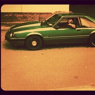

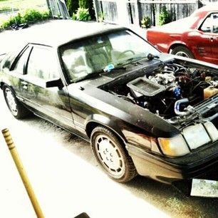

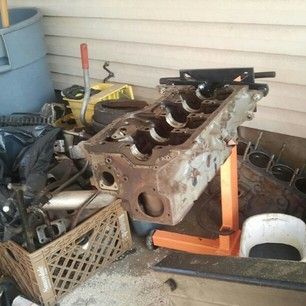

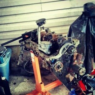

bought the car earlier on this year with a blown motor essentially it was a box of performance parts and a spare block and i rebuilt the bottom end and head myself... heres the mods ill start with suspension first

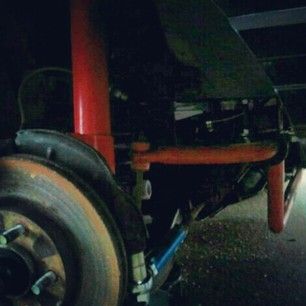

suspension:
-koni front and rear sway bars(real beefy)
-koni adjustable shocks
-eibach springs
-energy suspension poly urethane bushings all around
-steeda adjustale caster/camber plates
-bump steer kit
-factory 5 rear control arms(what beautys)
-94 gt front control arms,spindles etc
Brakes:
-94 gt brake assembly
-stainless steel lines

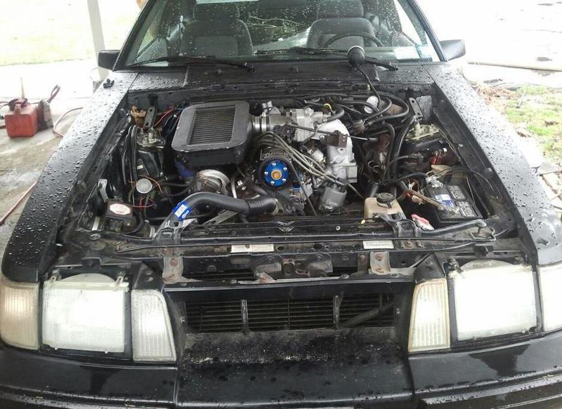

Engine: 2.3t

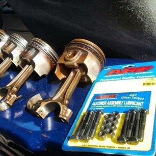

-fully rebuilt using federal mogul bearings,hastings rings,fel-pro and mr gasket gaskets
-stock bottom end only modification was ARP connecting rod bolts and high flow oil pump
-ported and polished head machined for manley oversized valves 1.89 intake and 1.59 exhaust
-esslinger 2277 cam
-esslinger valve train dual coil valve springs,retainers,keepers, followers,mouse trap springs etc...
-esslinger round tooth timing belt set with adjustale cam gear
-ported upper and lower intake manifolds
-60mm throttle body
-turbo coupe top mount intercooler for now front mount eventually(have one of a starion)
-garrett .60/.63 t3t4 turbo
-ported and gasket matched e6 exhaust manifold
-stinger 3' downpipe
-magnaflow 3' highflow cat(removing soon)
-magnaflow straight through mufflers
-stock 35lb brown tiop injectors running with a walboro 255lph fuel pump and an adjustable fuel pressure regulator
-alternator relocation kit
-big electric fan
-stock VAM
I feel like im missing some stuff but thats all I can thing of that ive done to it as of now car needs some tlc as for as paint and body work no rust

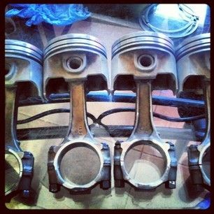

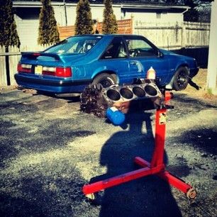

heres the headwork and pics of the one other foxbody i owned prior to my svo i had 3 in total and i have a 66 coupe as well
