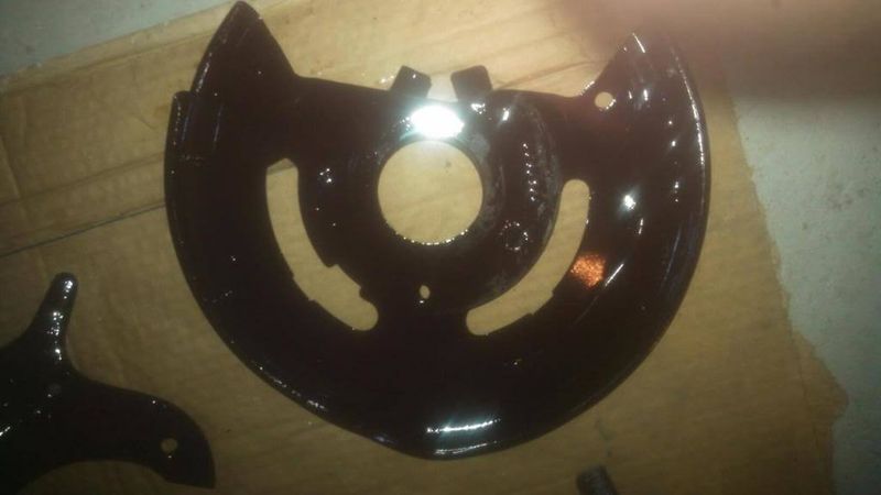

Well update! The frame is painted and cured, and made its way to my home

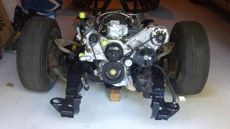

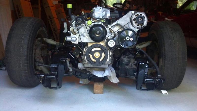

Anyways, I got the motor set in (just resting in its place)
You can see its just resting and leaning back, which also caused a few issues with hitting on things

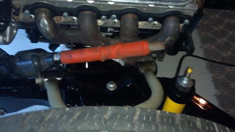

The manifold JUST clears the UCA bolt currently
The passenger manifold had to be removed completely...
I'm hoping figuring out the drive line angle will fix these issues and the motor is in the middle for adjustment. So i have a good amount of room for moving it around. Just can't tell where to set it until the cab is on or if anyone used the CP poly mounts for there LSx swap can give me in sight

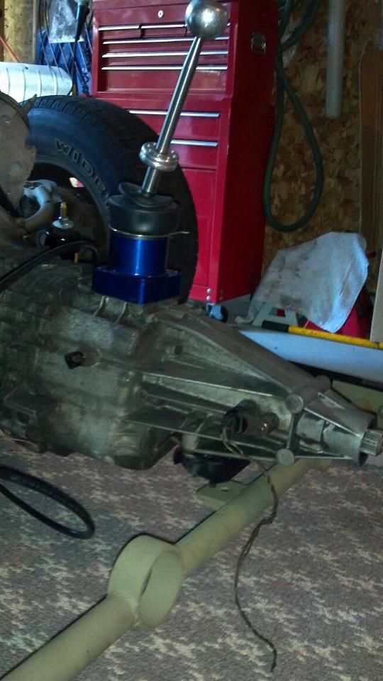

Trans is in,
STS they haven't made in ages! lol

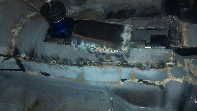

Trans tail sat up higher so gotta raise the drive shaft tunnel
revised trans tunnel.

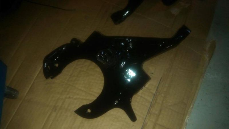

Before paint
AFter paint

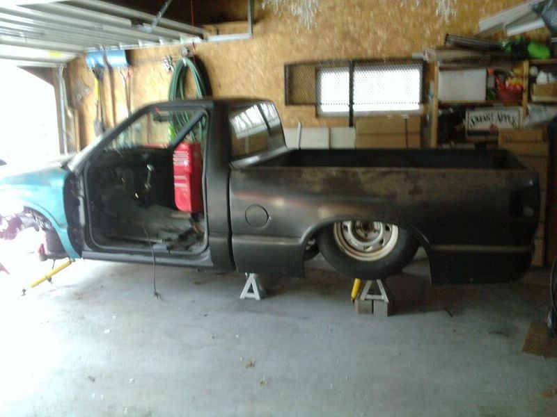

Bodies on!

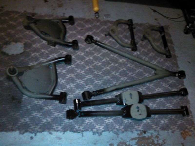

Last for frame/suspension for paint (going gunmetal)

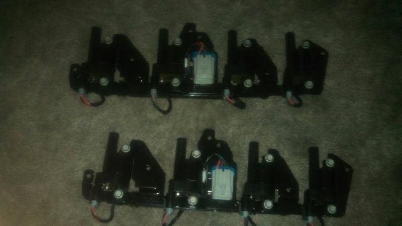

New coils/brakets

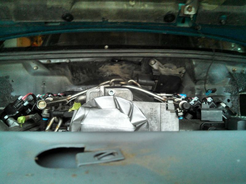

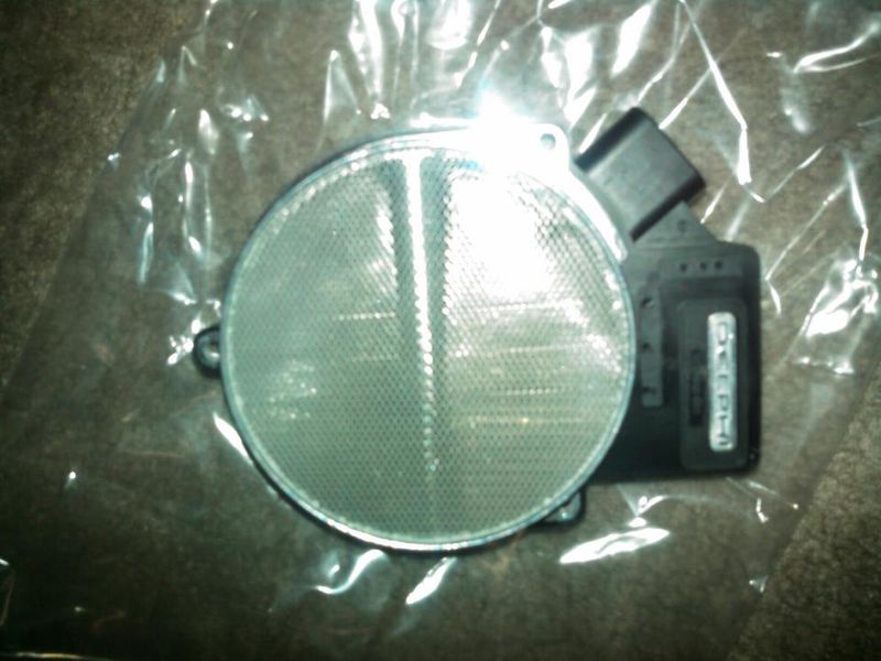

MAFS
