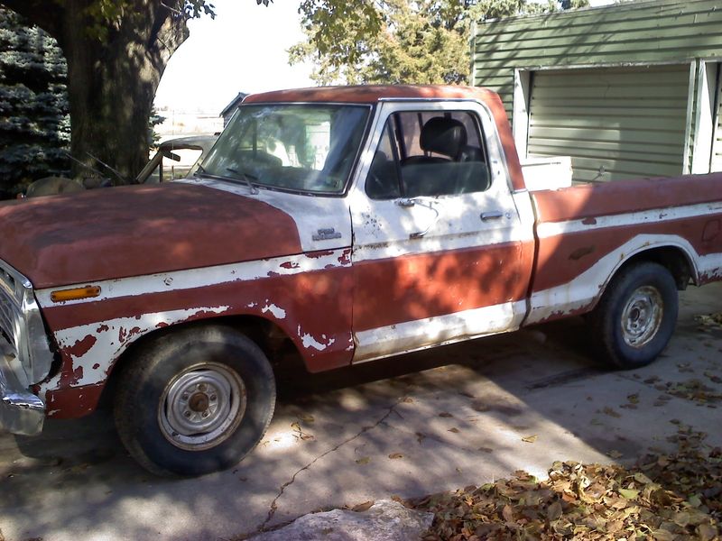

Here is what I got, a 1977 ford f100 with a 400m and an auto tranny.

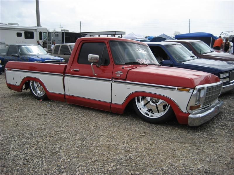

What I am kinda going for
I would love to run 24 x 15s in the rear and a 22 in the front, but I doubt I will ever have the coin for that.

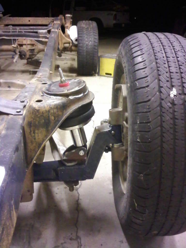

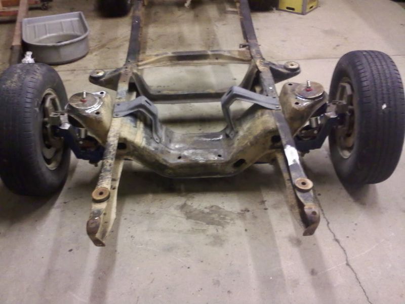

Now I have available a 70's chevy c10, I am thinking of cutting off the front suspension to graft onto the front of my ford. I figure the track widths are almost identical, at one point the frame widths are the same, and people bag the c10's on huge wheels all the time so it should make for an easily modifiable platform.

Hey man looks like a cool project. I am doing a 69 f100 right now. I am going a bit diffrent direction than you but I am very familar with these trucks and would be willing to help with any ????. If I were you I would go mustang II in the front, there are a couple companies offering kits for the front (Fatman Fabrication, and Chassis Tech both have kits). If you run those kits with drop spindels you should be able to lay frame. I did mine before they made kits for these trucks so I have bagged i beams but I am not trying to lay fram just get it a bit lower. Here are some pics of my project.

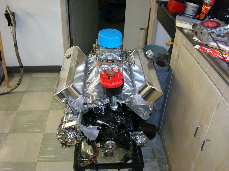

Sweet engine! Looks like a windsor of some sort.
Not a fan of the mII for bagging something, there just isn't a lot of room for stuff btw the control arms, and hard to get good lift. The kits are way over my budget and usually not really designed for "laying out". I want to still use it like a truck, so I figure a truck front suspension would be a safe bet. From the measurements I have taken it actually looks like it should work really well.
