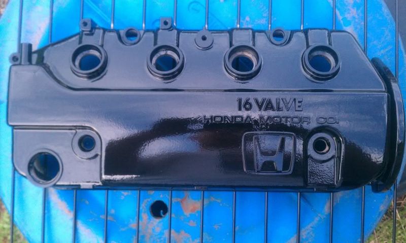

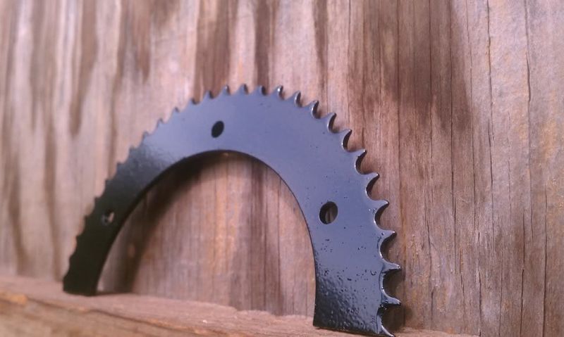

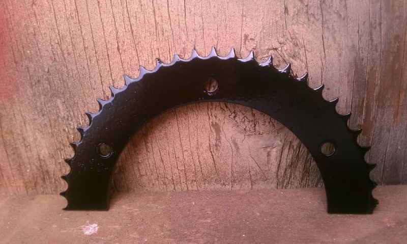

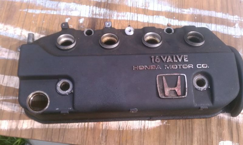

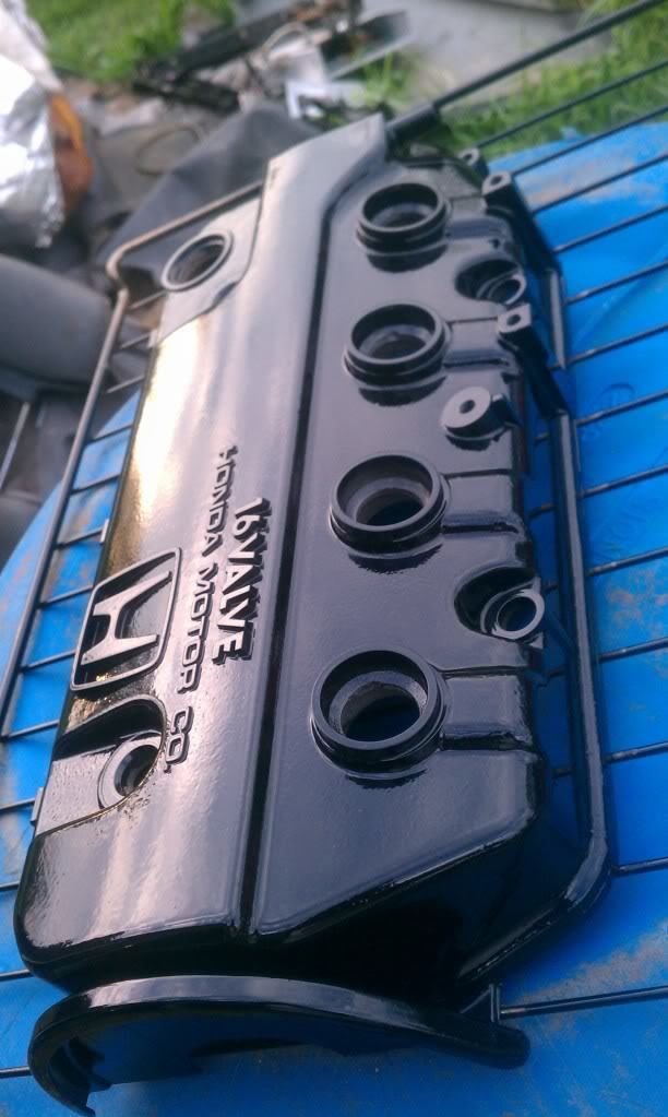

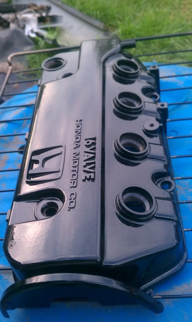

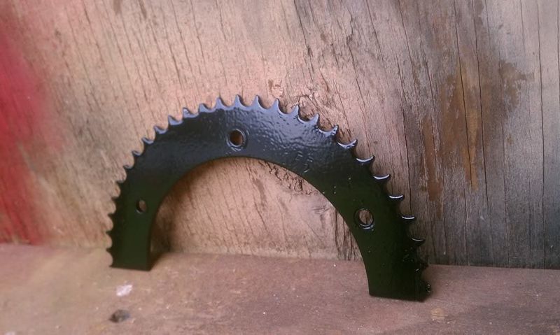

So i have decided to pursue another business adventure that i can do at my shop on my days off from work. I have been buying up materials and tools needed to do the job and i have decided to do powdercoating. Here are the first two things i have done. The first thing i did was the go kart sprocket and then decided to use the valve cover to experiment with off my old honda engine since i swapped it out. All comments welcome.
-Justin

Also keep in mind that i did nothing to the casting marks on the valve cover, so those imperfections are from factory.
-Justin

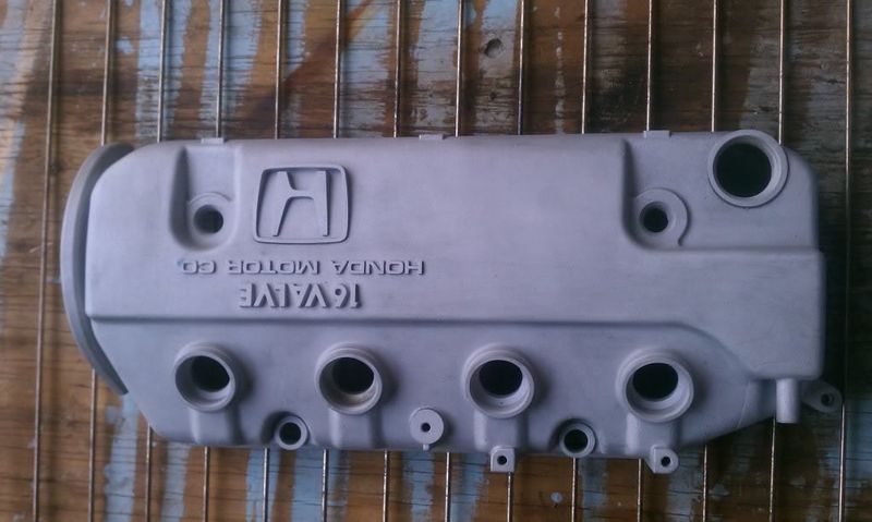

How are you preparing the surface?
dropped90(justin)'s avatar
dropped90(justin)
degreasing, media blasting, cleaning with a wash, air spray, preheating for outgassing, cleaning with a wash, air spray again, then coat
-Justin

that's a proper pre-treatment!
