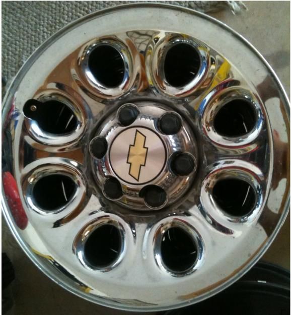

I'm looking to put Cat Eye wheels off a Silverado on my B. I have a couple questions. One is will i need spacers. Two is what size tire do i need. Below is the Wheel that im looking at. I know its probably not what is common on these trucks but I like going against the grain.

You will have to shave the tabs on your axles to run those wheels. The center bore is not big enough to clear.

You could pay to have the wheels bored out too, but I shaved tabs on 3 trucks... was easier to do, and then you don't have to keep paying to have new wheels bored out if you want to throw a different set on. What size are those chevy wheels?

they are 17's they are off a 2wd and I believe the stock tire size was 245 70r 17 for this wheel and the 4wd i believe is 265 70r 17.

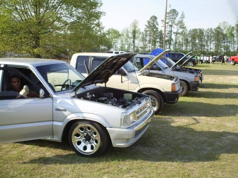

i ran a 225/45R17 when i had this wheel on mine and they fit pretty good
