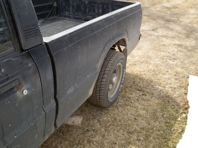

Maybe picking up some new wheels 15x7 and 15x8
Thinking bout going with a 55 or 60 series but not sure on width, I want something that isn't stretched but sidewall won't hang over rim pretty flush any ideas will be appreciated

No truck is already lowered may do a 50 series if I can find some used ones

whats the width of the wheels? if you have 15x7 you can go with 195/50 or 205/50. 15x8 will work but 195 will give some stretch... My bro rides on 195/50 with about 3" drop
E
eroticlarry
The front is 15x7 rear is 15x8 I'm not looking for a stretch I want sidewall flush with outer lip
